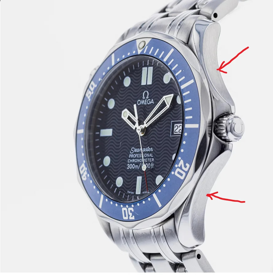

For watches with brushed side flanks I use a bench top polishing lathe with a 4 inch Bergeon 6723-240-LP wheel to get a nice brushed finish. However, the wheel is too large to finish case flanks if there are crown guards (like the Seamaster Professional 300m).
Does anyone have tips for the proper tool or wheel to finish that area of the case? Does anyone know how an OSC does it?

And I'll add this: I know I could use a scotch-brite type pad by hand, but there's no way that's what Omega uses.

I'm not talking about a dremel. See 1:19 in the video below. But you can't use this wheel for the parts I'm asking about (see photo at the bottom).

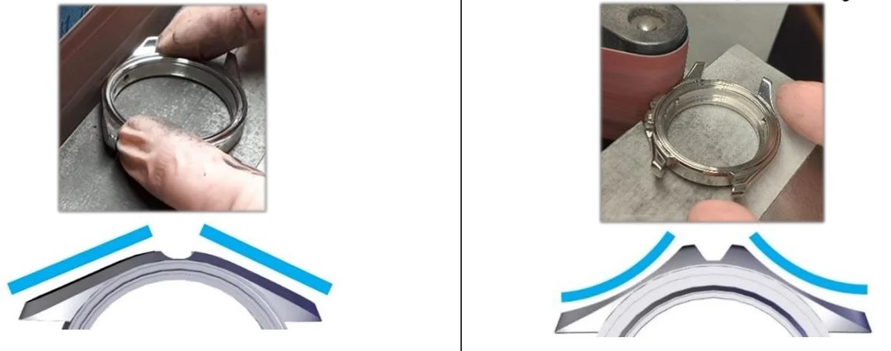

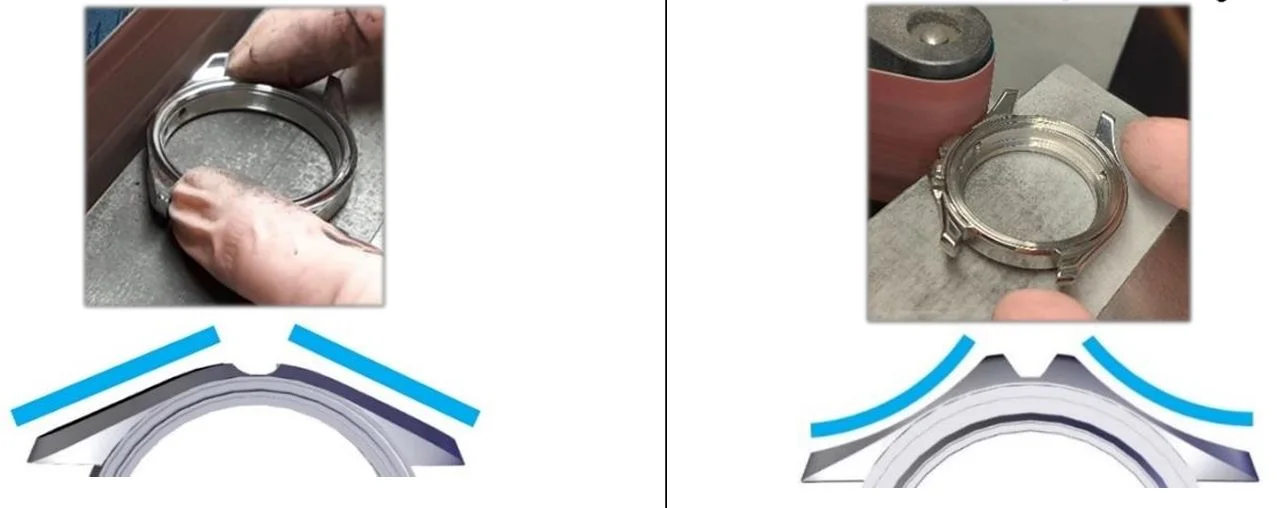

That finish is applied using a belt sander sort of arrangement. The presentation of the case to the belt looks like this…
As you can see for the crown side you use the rounded end of the belt. If you don’t have a machine like this, you need to recreate this same sort of method with alternate ways.

Excellent. Exactly what I was looking for. Could you let me know what grit is used to replicate the Omega brushed finish? Or what grit is a close approximation? I'm guessing 240 or 320.
