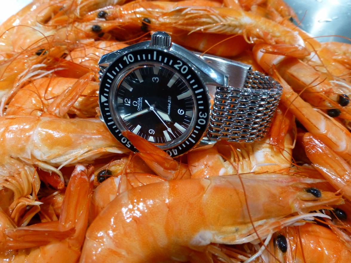

    And to keep you fired up for your grail, here's a pic :D
    watchme likes this.

    I appreciate the responses, but please PM me if you might have a movement that would fit my needs. i want to keep this thread on topic, which is advice on movements, what to look for, what to avoid, etc.
    JimInOz, how dare you stuck that 300 with the fishes! :) What a beauty.
