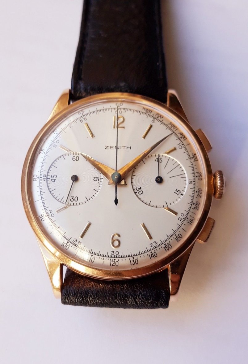

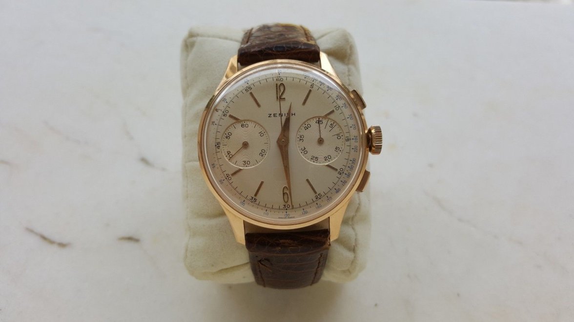

    I'm in the market for a gold 37/38mm cream dial 2 register chronograph (3 register would be nice but probably outside my budget for now.) Looking at Zenith or UG (and I will post a WTB now). Just trying to educate my self, I came across these two.
    Just a coupe of questions - should they all have a "Star" on the dial or does that depend on when the watch was made? Also, of these two, they look like redials (not too bad tho ), these are unfortunately the only photos I have of the dials. I would appreciate any thoughts or advice
    1. First one - no "serifs" on the Zenith font and sub reg fonts seem a bit thick
    2. Zenith font looks ok, but again, sub register font also look a bit thick
    red crowned, ELV web and 89-0 like this.

    The second one looks like a redial. A lot of numbers don’t match. 3 in 30-35. Sub dial numbers uneven and off center and the etched lines aren’t sharp and defined

    Thanks for confirming my suspicions! The second was described as an untouched drawer find.... what did you make of the first? It’s described as near NOS and also untouched..

    Second one is definitely a redial.
    First one is difficult to say. A better photo is needed to be sure.
    No serifs in Zenith, the 3s in the subdial look different to the seconds scale.
    Personally, I would not buy unless I could see it in the flesh.

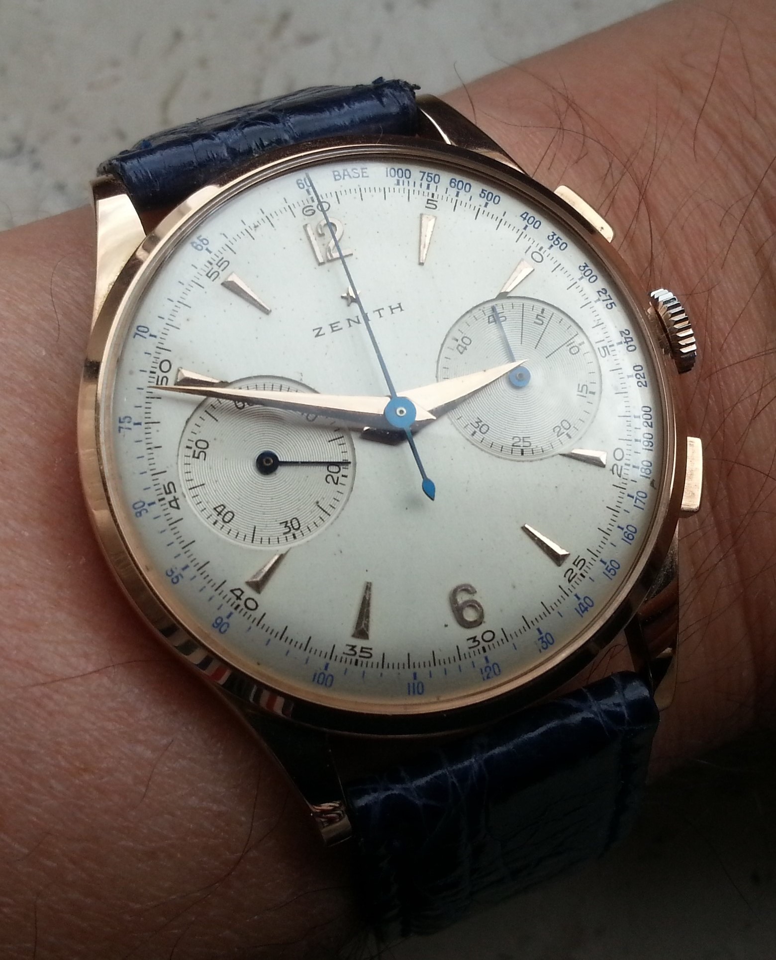

    and for comparison my UG and my Zenith:
    Indexes in the subdials of your first watch seem to be too short.

    Thank you... I also wasn’t sure about the “3s” on the subdial, and they look different to @bigsom (I’ve asked if he will see his, let’s see :)

    Personally, I would avoid the second one.

    I forgot: The first one most probably has the wrong crown.
