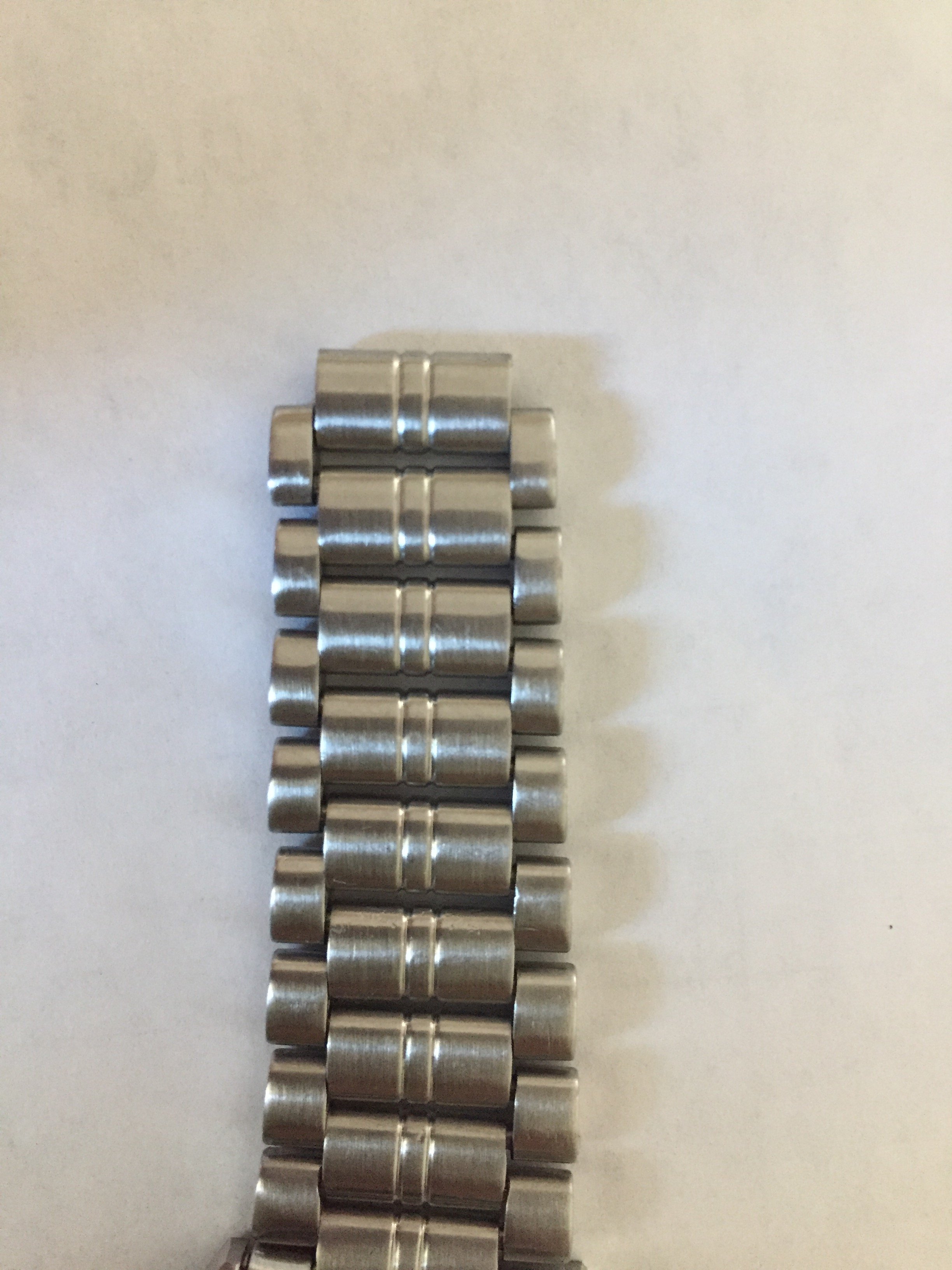

    The Omega 1069 bracelet attached to my watch just broke (fortunately while I was in a chair and not over a hard surface floor). I found the broken pin which is pictured below.
    Are there current replacement pin parts available? Where might I find these?
    Thanks for any help and guidance you can suggest.

    Thanks for the eBay suggestion and term to search! And I’m functional again until the part arrives thanks to the mention of the similar beads of rice spring pin issue. I have extra links and pins for a 1503 BOR with identical pins so I used one of them temporarily. I’m going to replace all the spring pins on both bracelets from the eBay purchase since I don’t want to repeat this episode of a broken part and watch falling off my wrist.

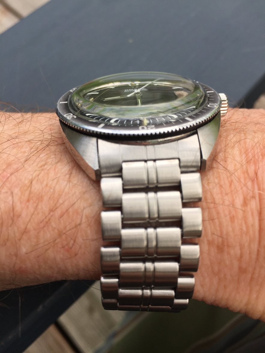

    Here it is back to functioning:
