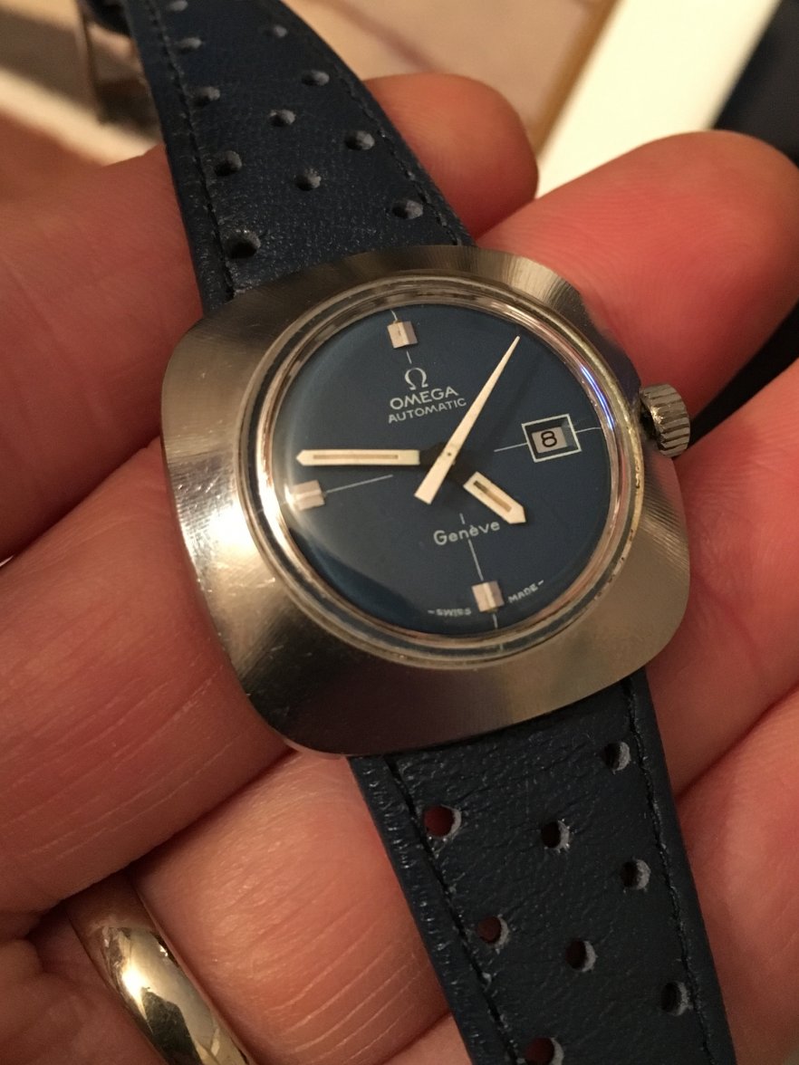

  9. Omega1 Dec 30, 2016
    3,029
    38,291
    Don't up give on finding one I found this on eBay a nice tv shaped dynamic 1960's nos strap cost more than the watch but my wife loves it.... IMG_7842.JPG
    Edited Dec 30, 2016
    ahartfie, blackstripe77 and Vitezi like this.
