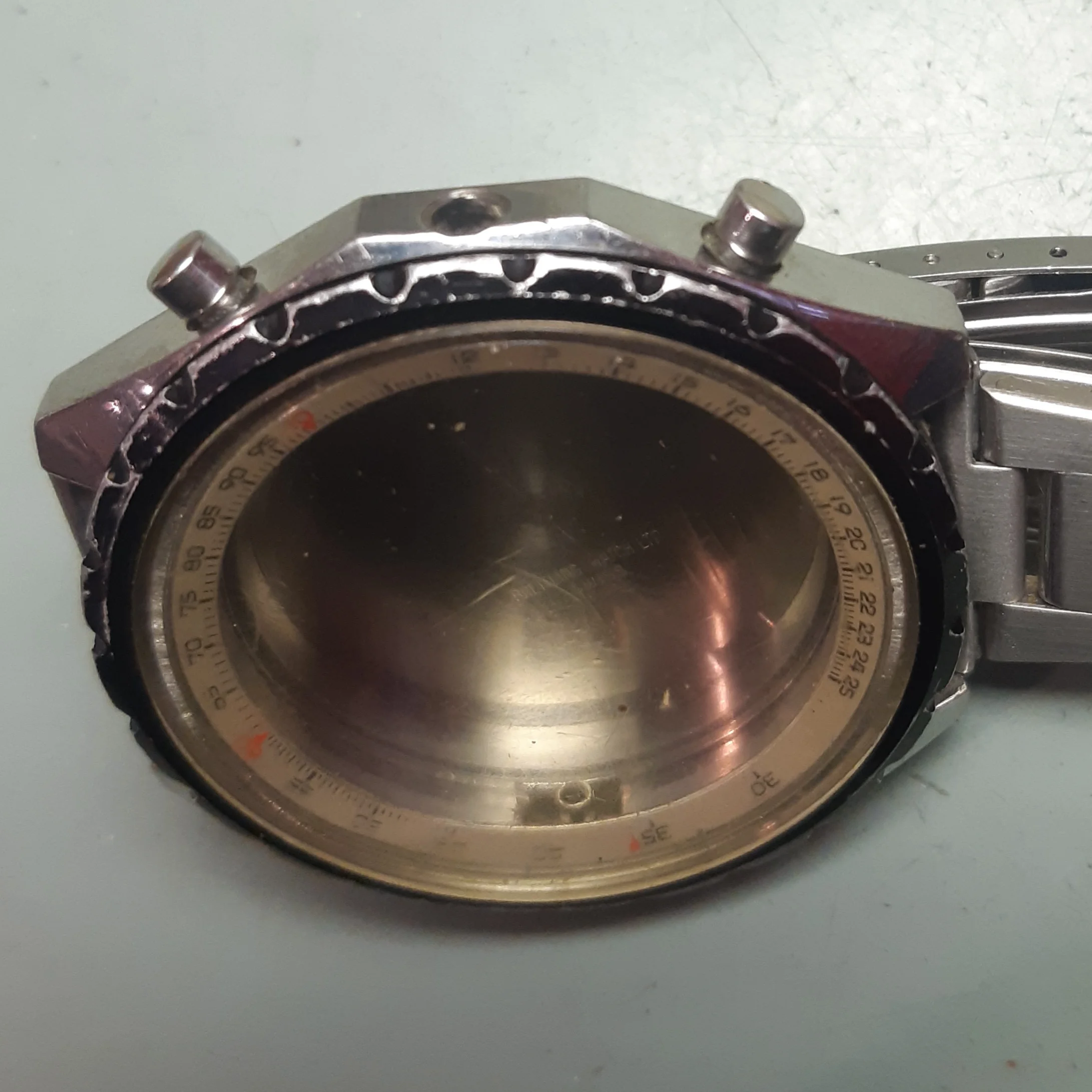

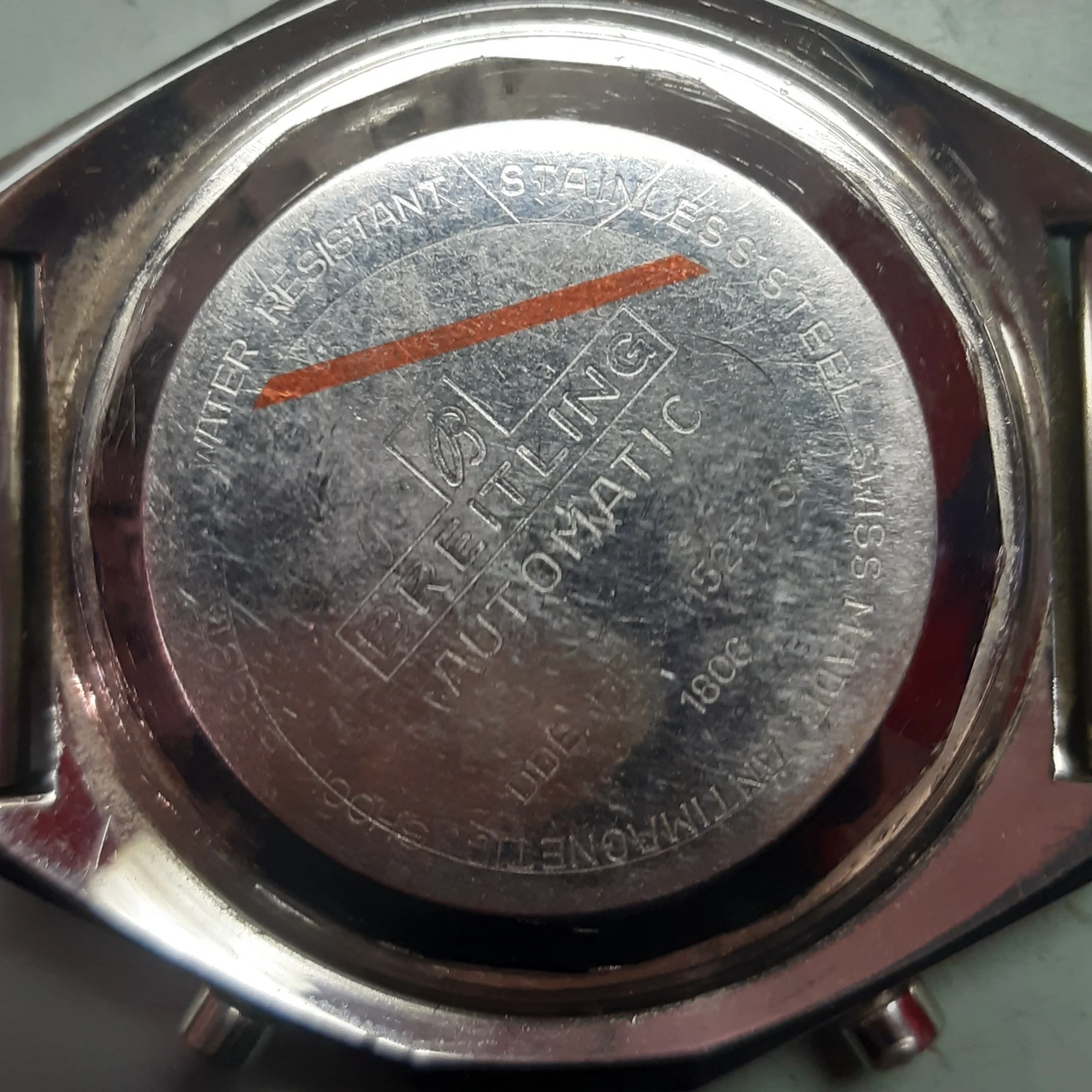

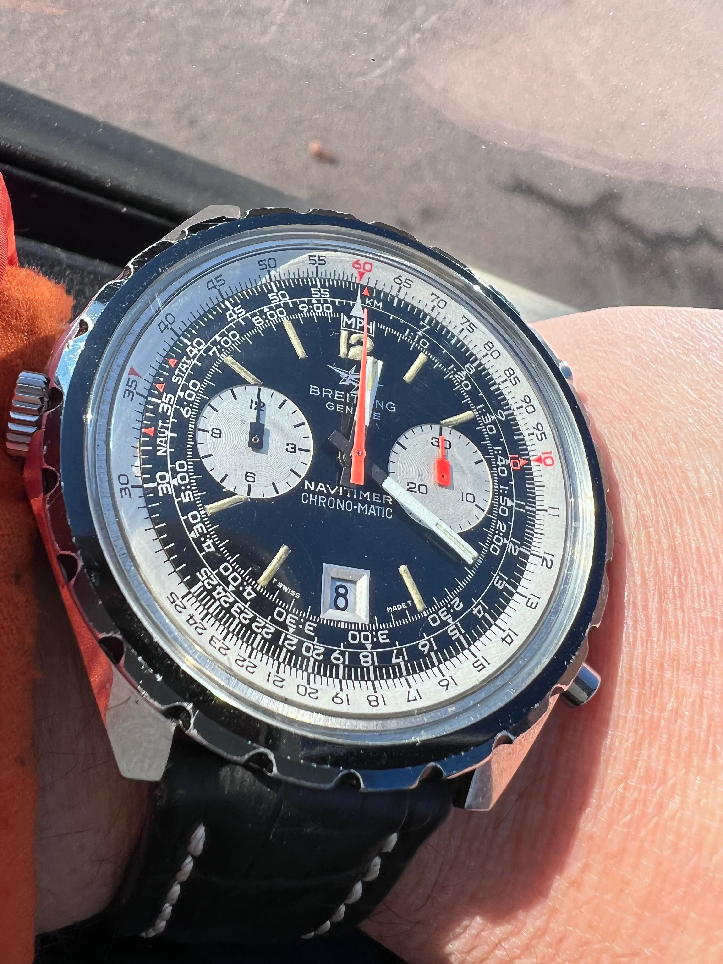

Hello,

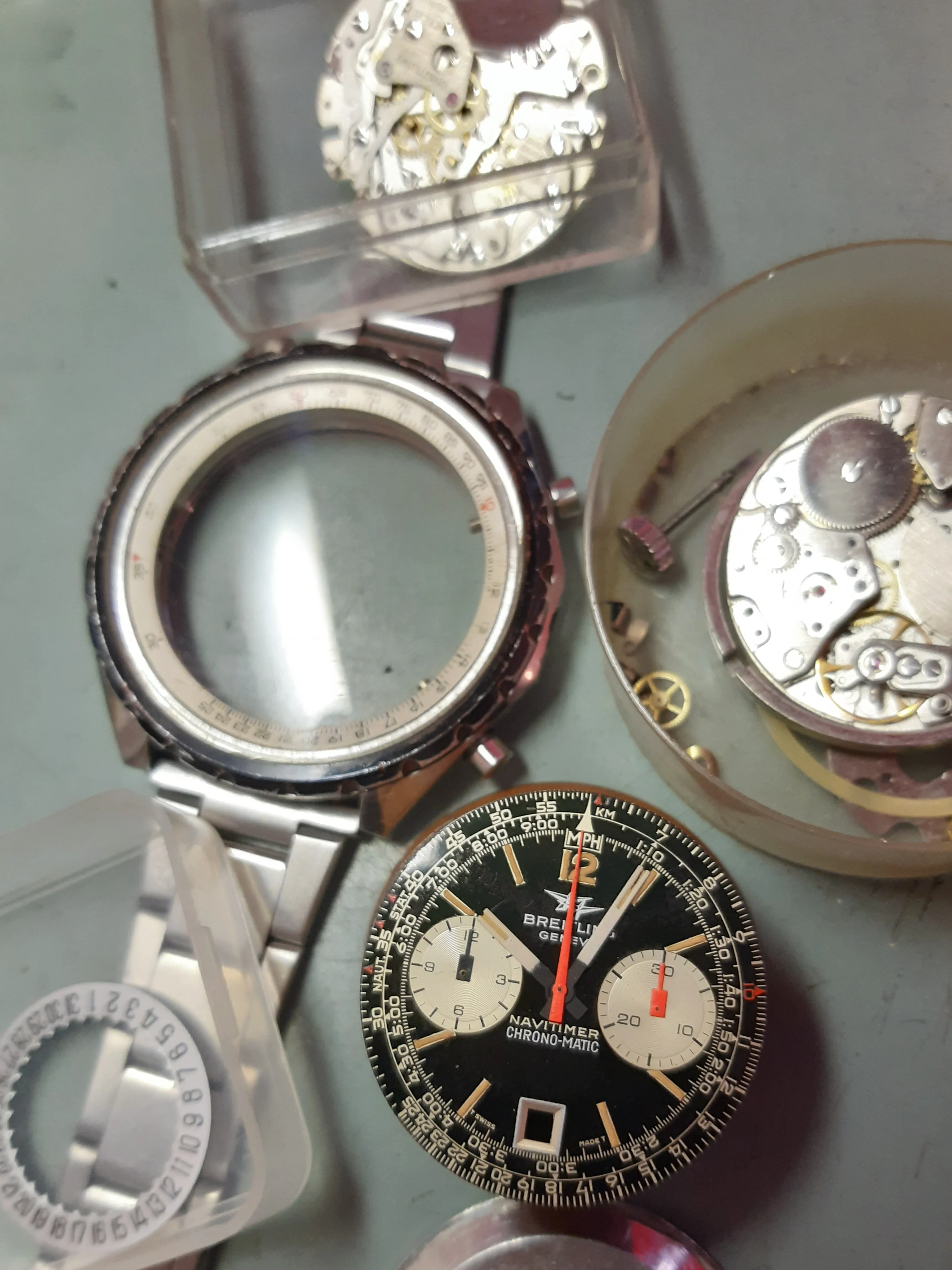

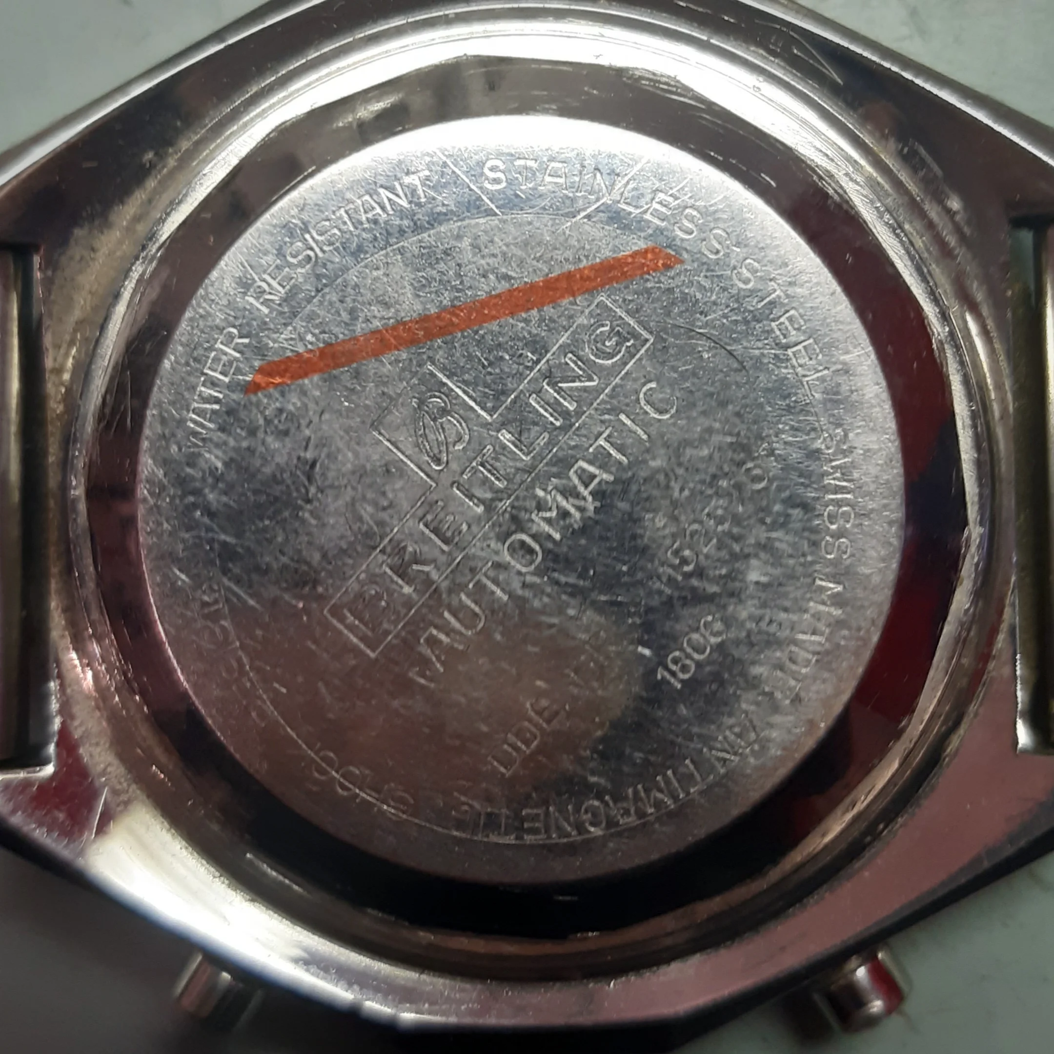

I am buying the remnants of a watchmaker's workshop, not much to see but I still found this:
The serial being 12543xx and with an all black bezel, am I right to assume this is an early 1969 model ?
I would then need a Buren 11 white movement and the early handset to rebuild it convincingly.
Any suggestion is welcomed...
718
2,107

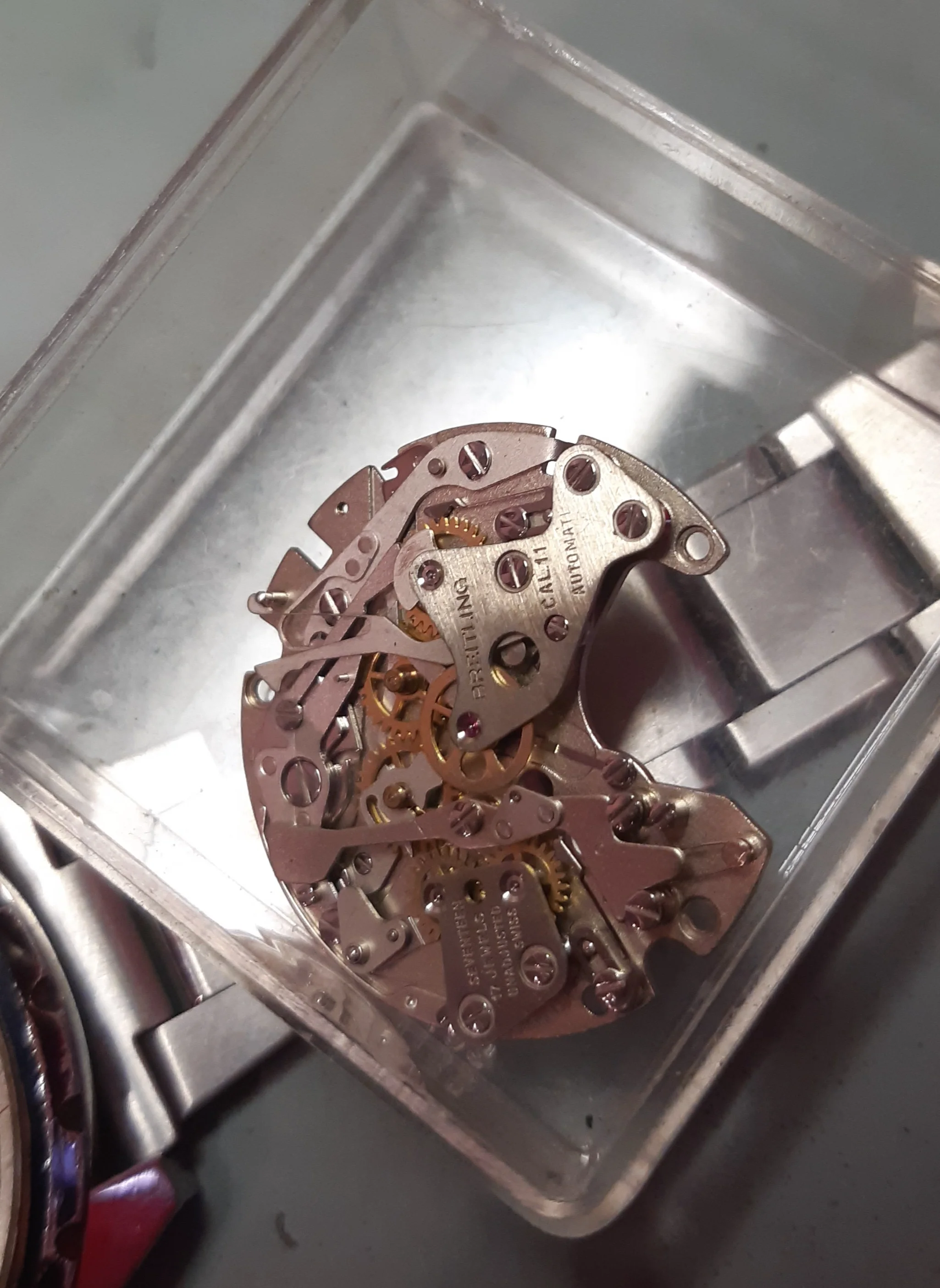

If I recall correctly, the 1968 pre-series (prototypes) had a 1253xxx serial. The serial on your case should put it on the first production run of 1969. As you suggested yourself, I would also consider a cal. 11 and an early handset, those with "open" tops.
1,615
3,862
Great, thanks! That is the confirmation I needed.

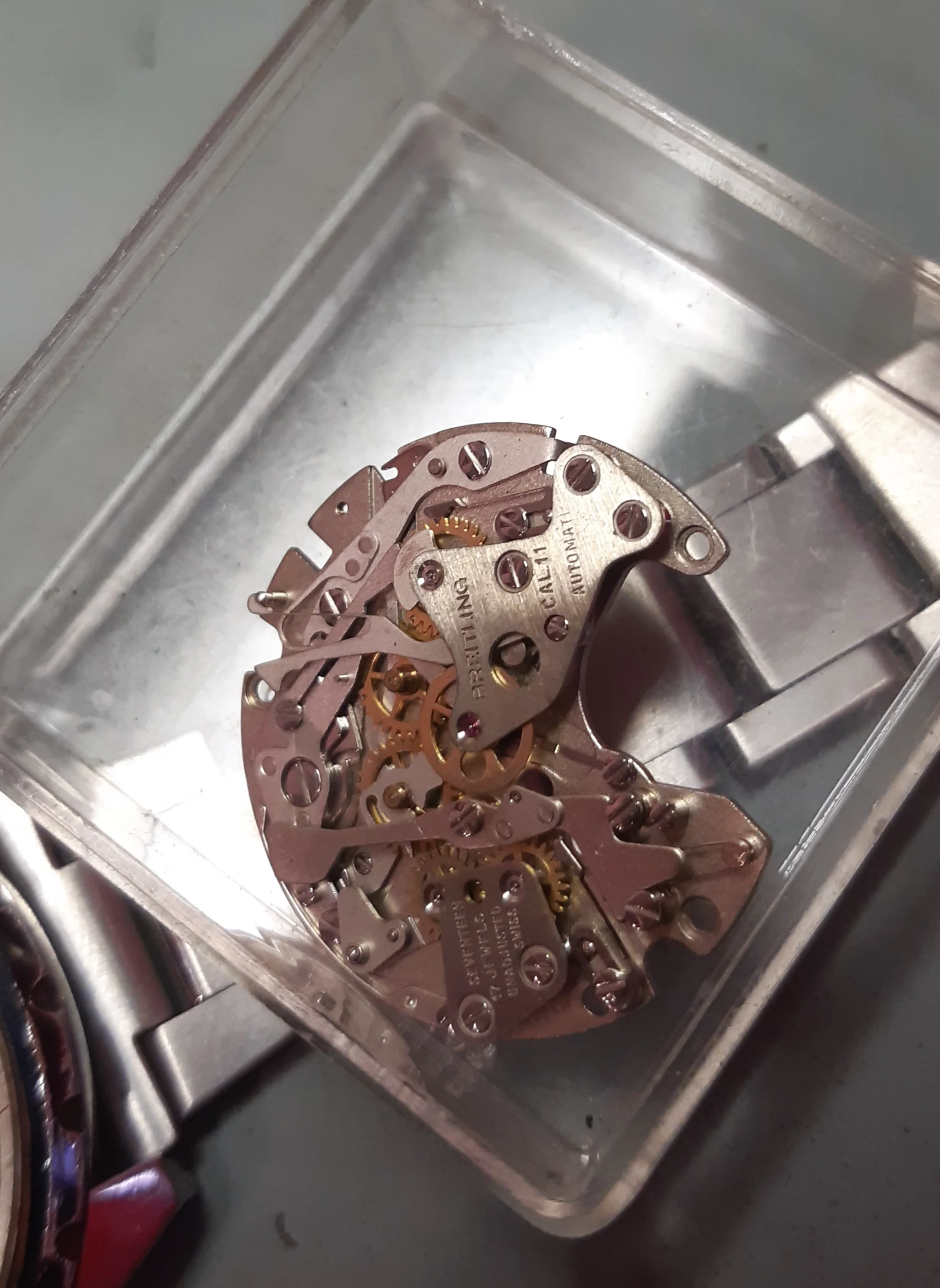

Lucky me: I came back and asked harder about movement / hands and ... we found it in little boxes under a thick pile of dust. I'll report back with pictures but it is the same black/white handset and open ends, black date ring. ::psy::

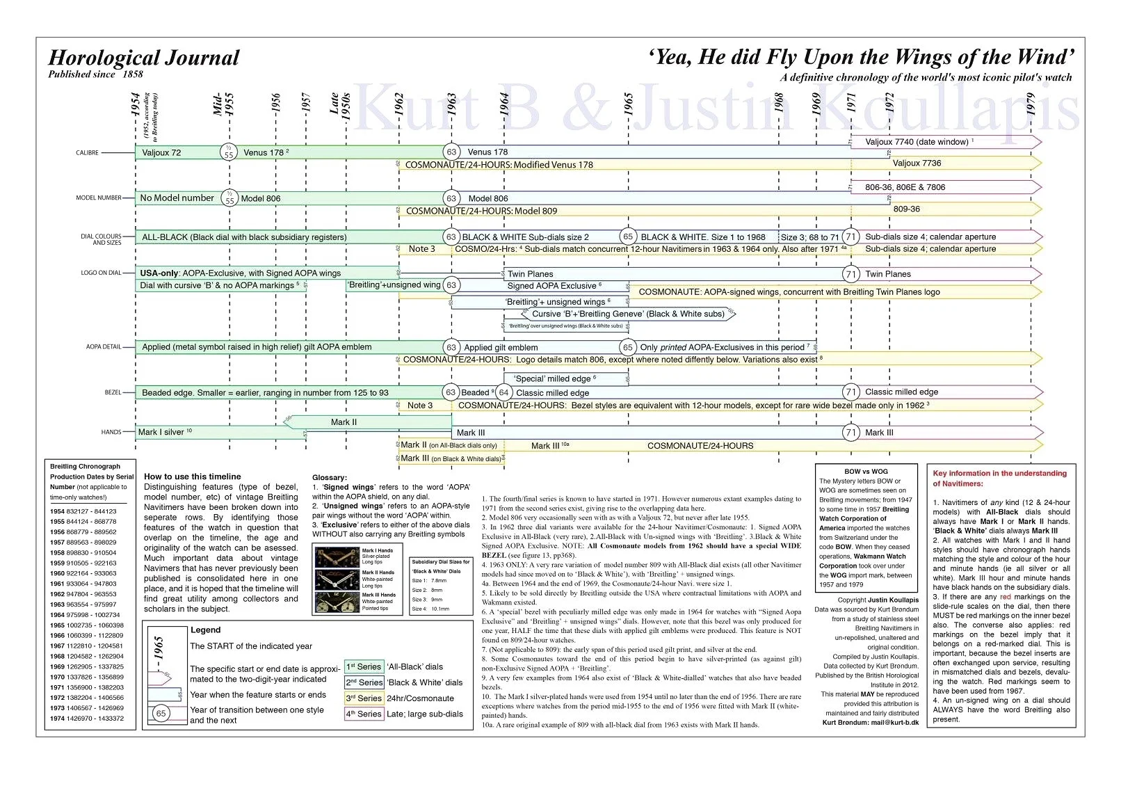

Is there a web page somewhere summarizing the 1806 variants? The 806 are well documented but the big cases... I mostly find for sale adverts when I search for watches nowadays.

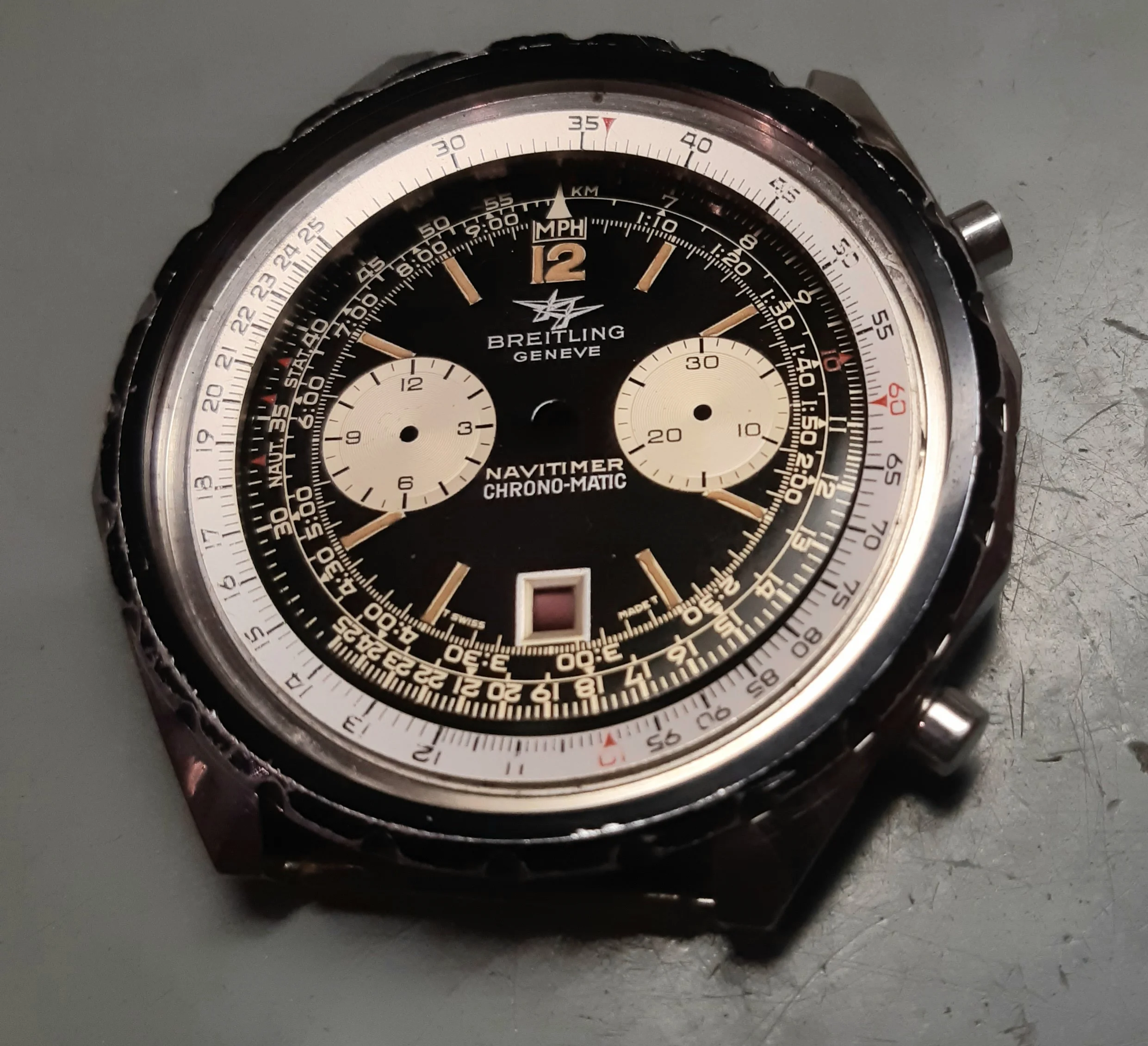

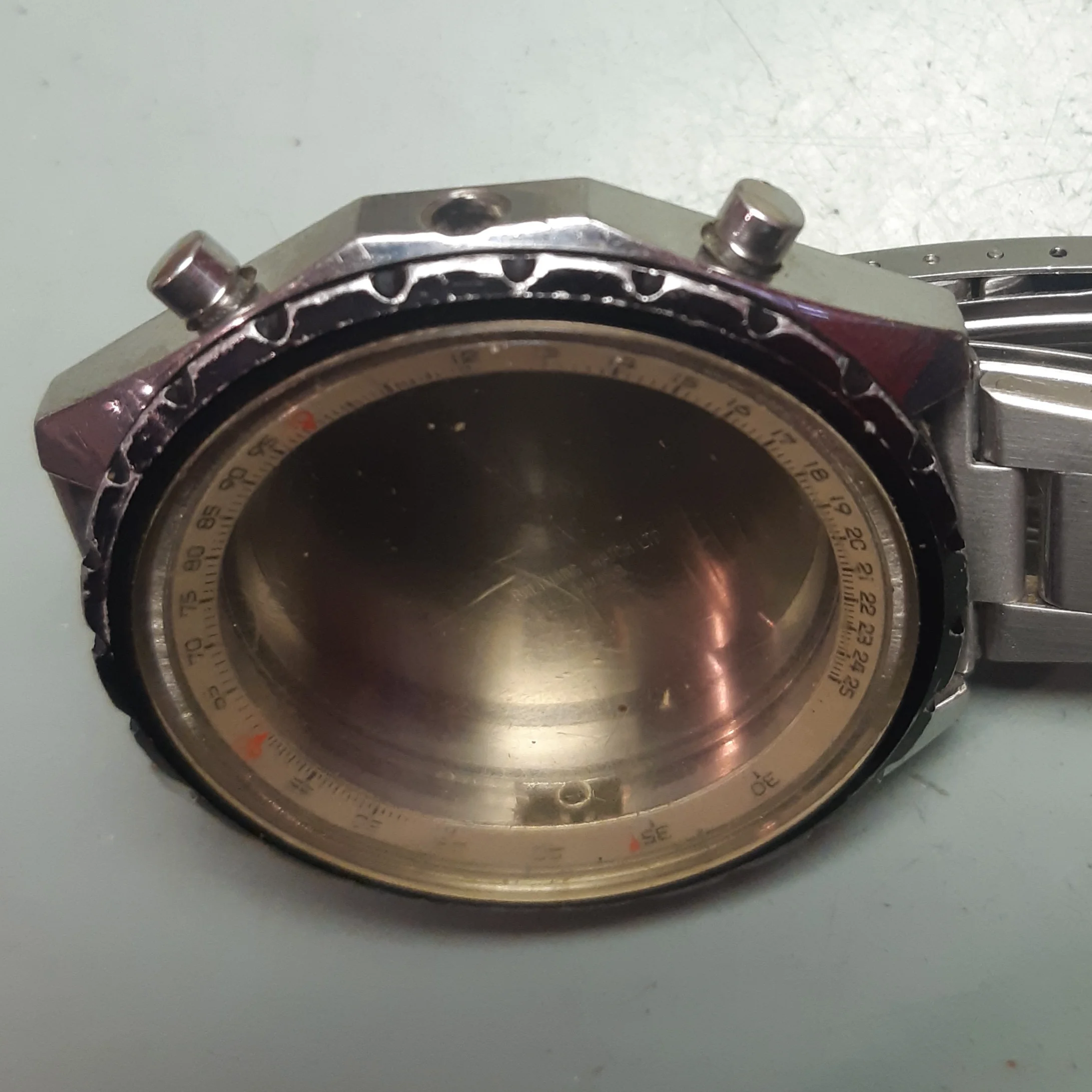

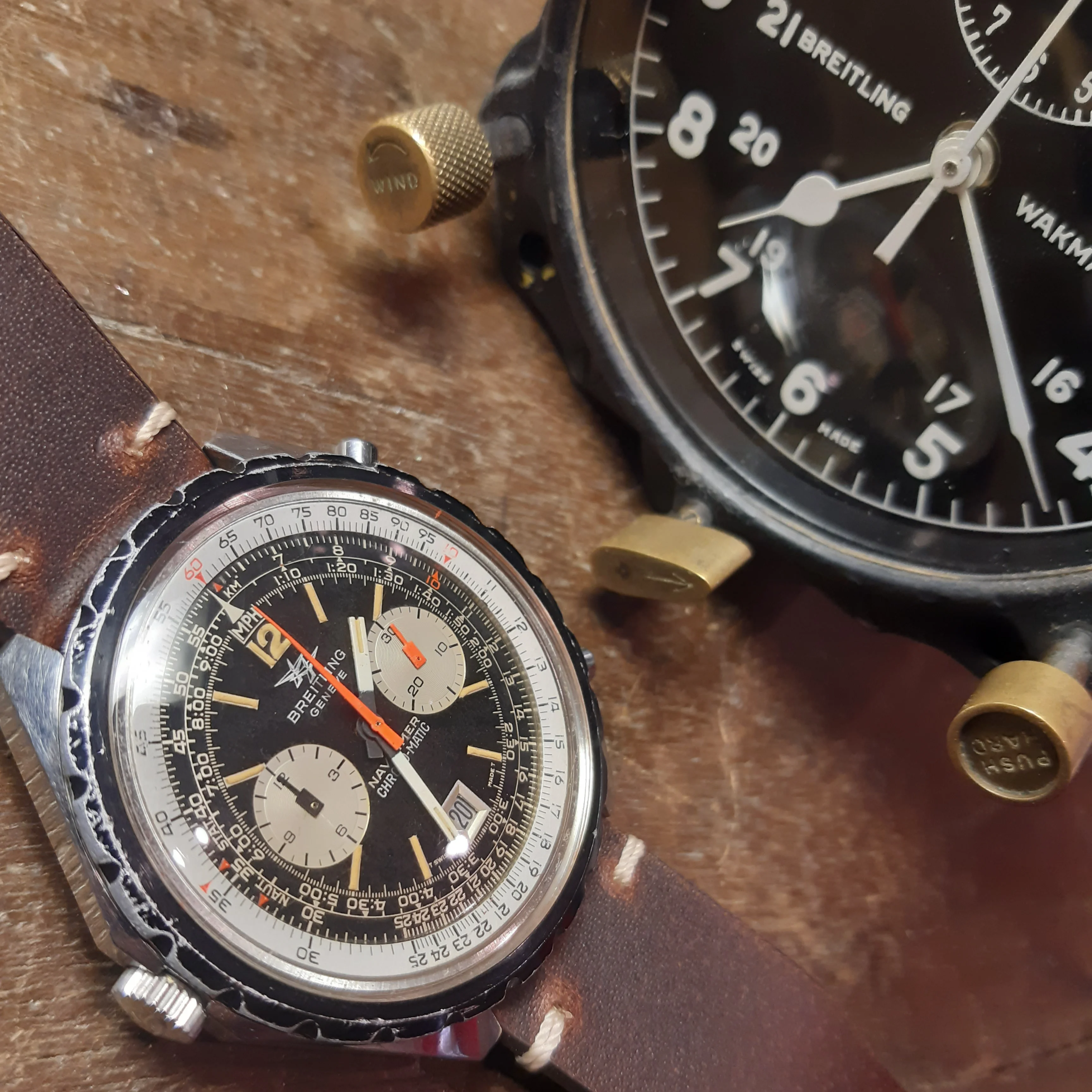

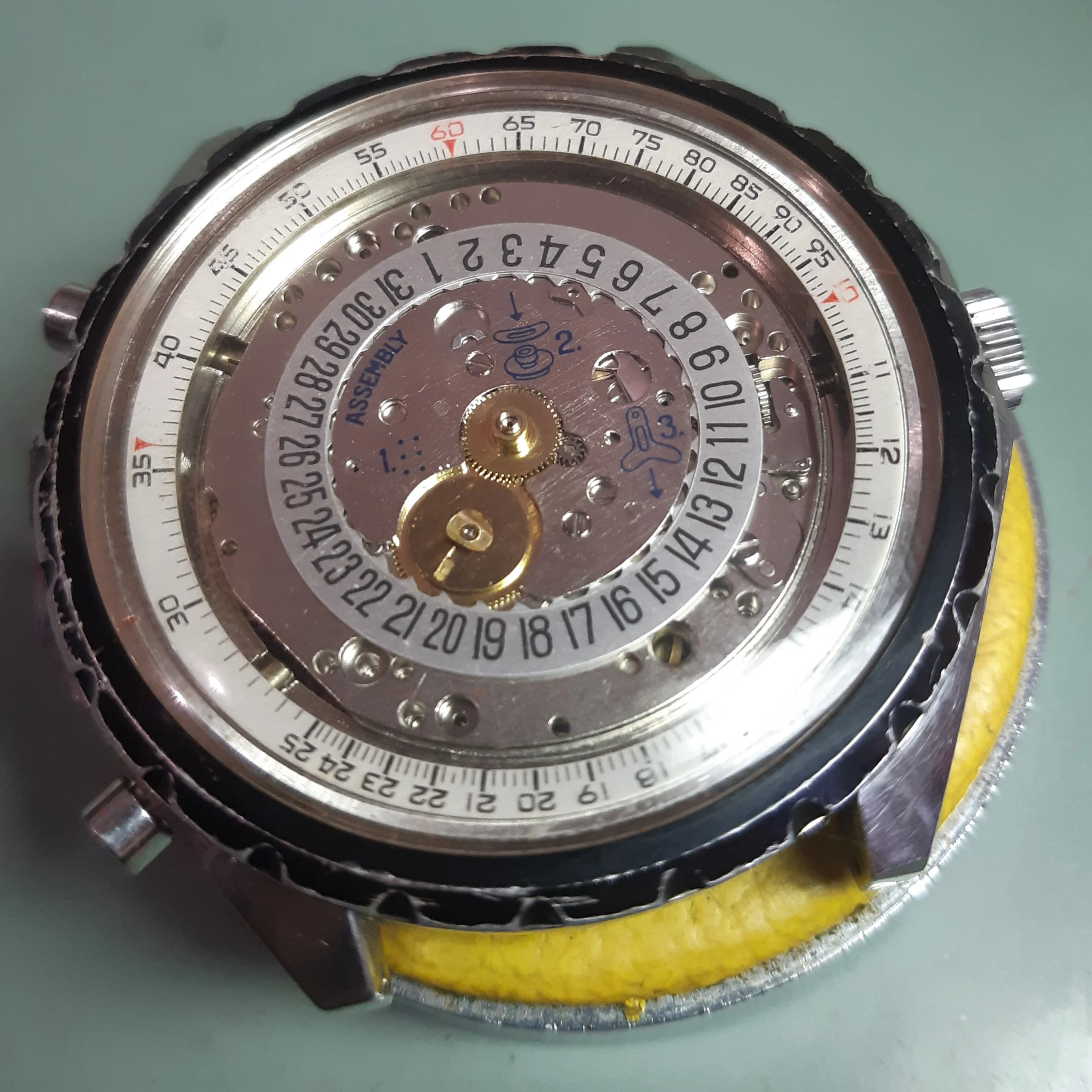

Quick picture of this build your own Breitling kit:
Quite promising! Only the inner scale would have to be replaced. I'll see about the inside later.

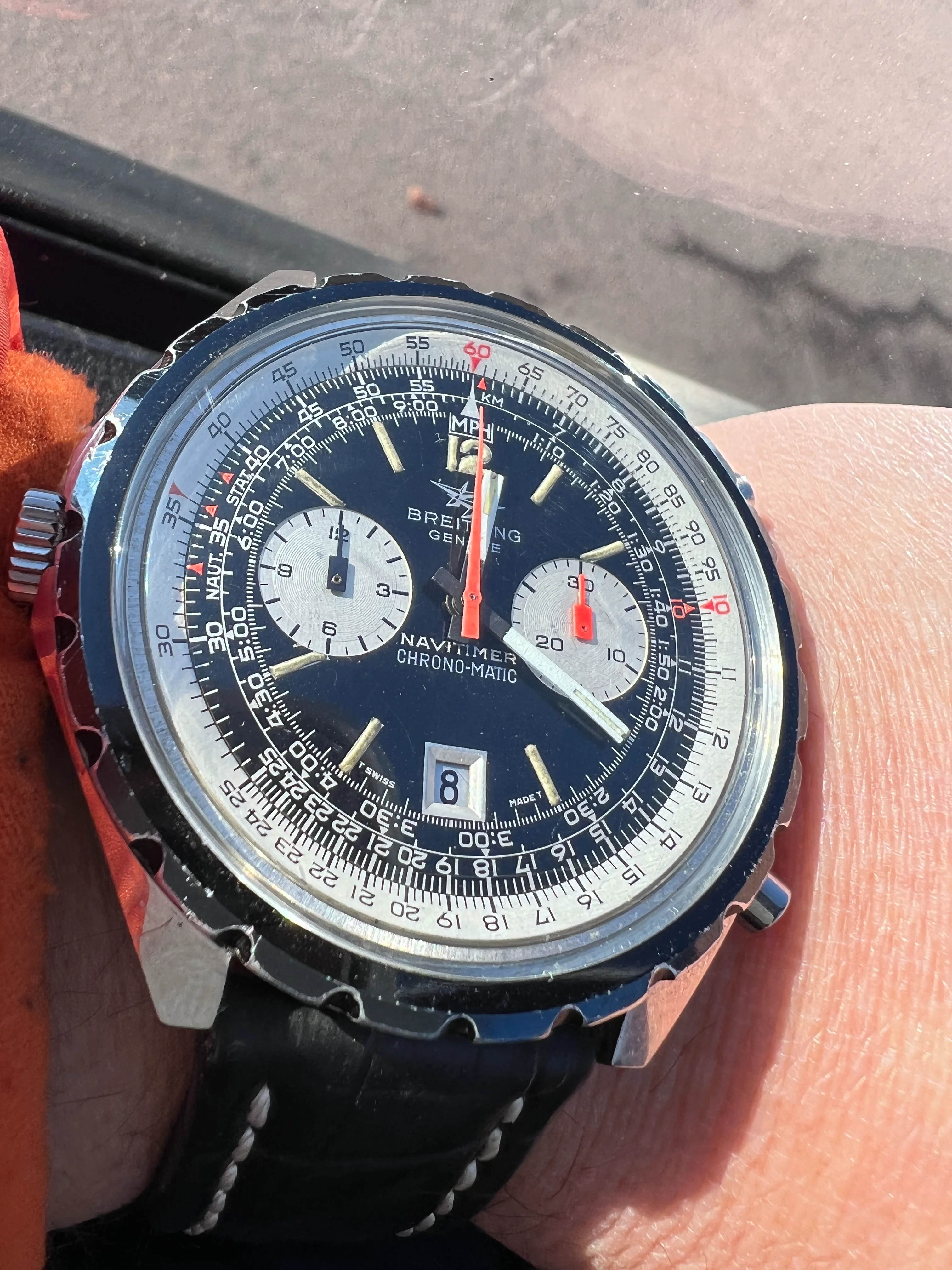

Mine can't wait for his brother to be complete 😂. Good luck with the project.

1,615
3,862

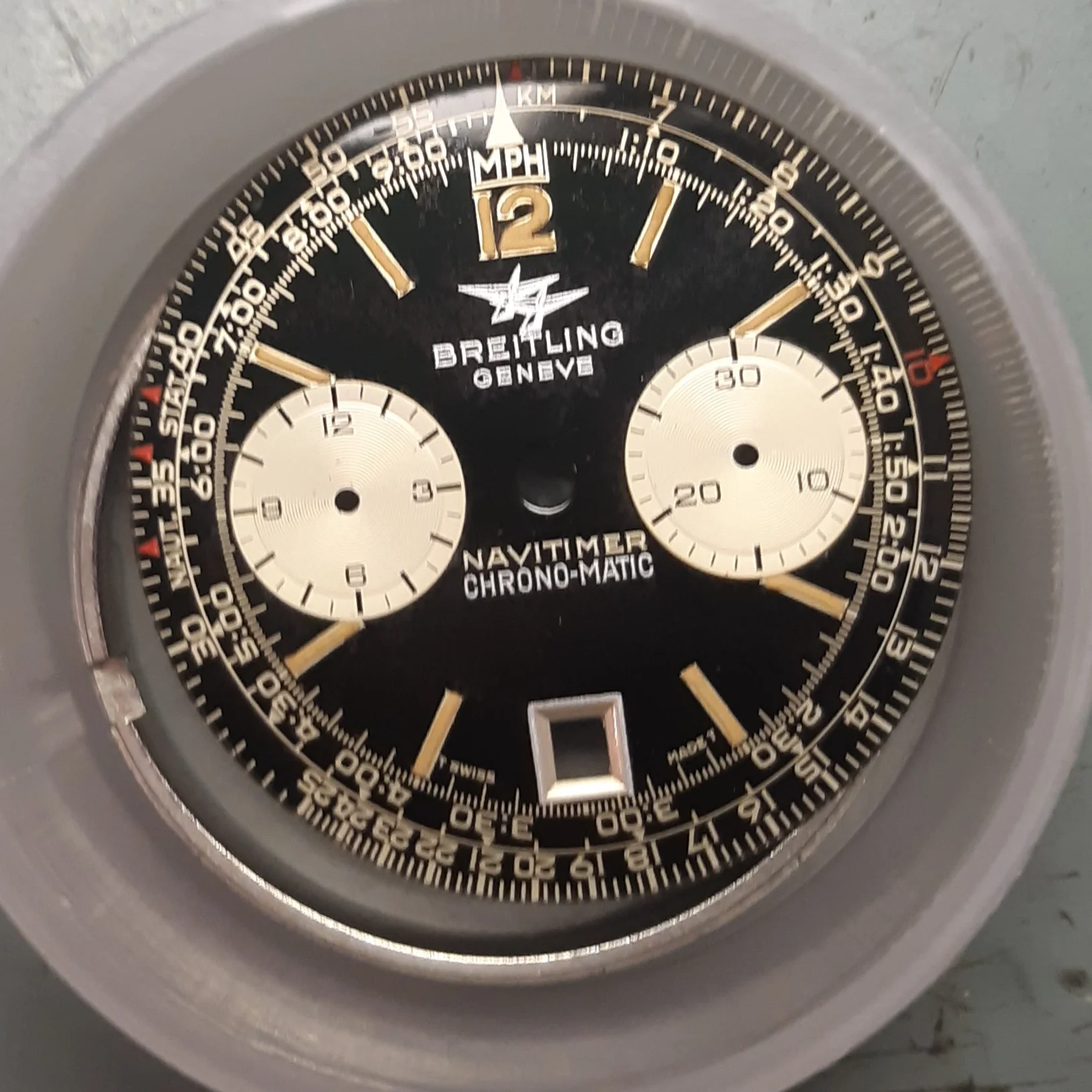

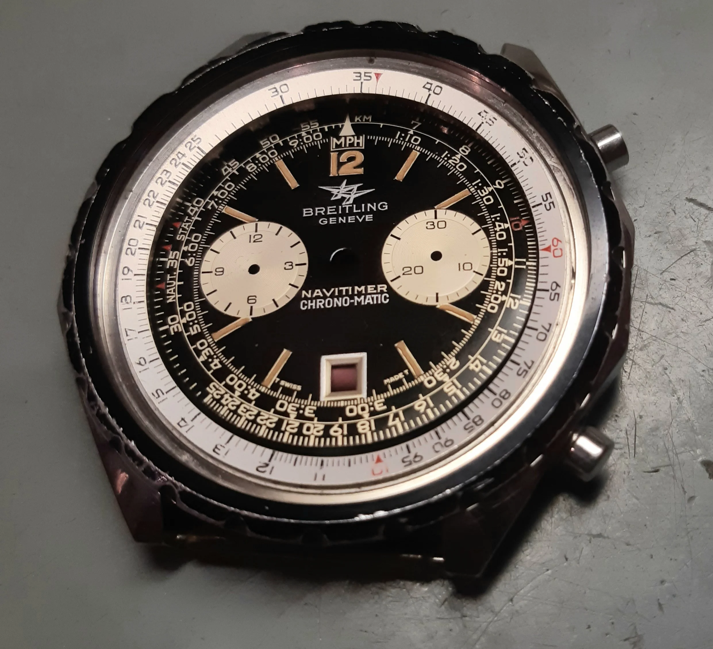

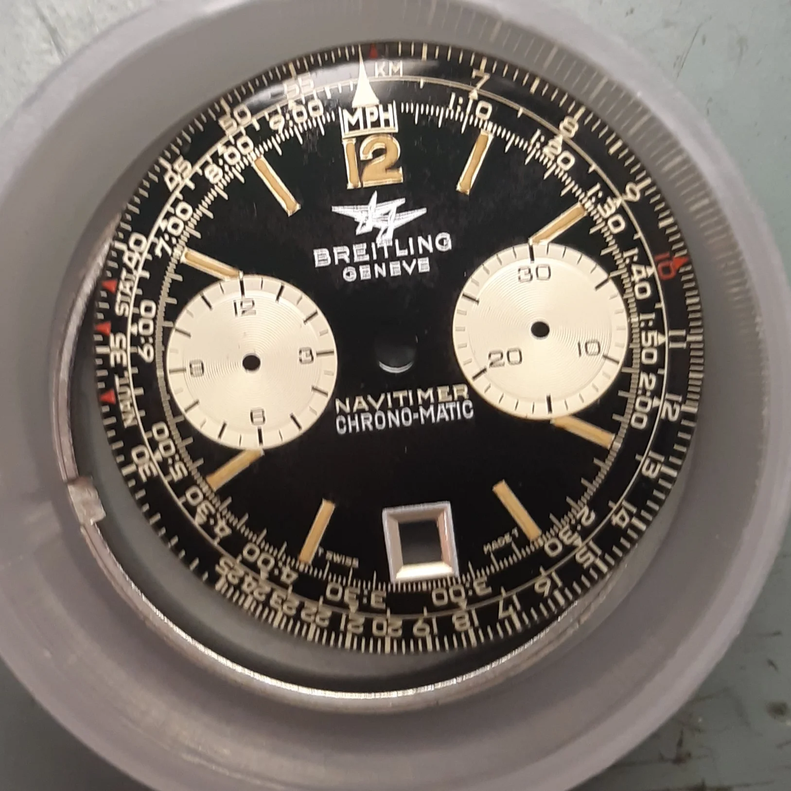

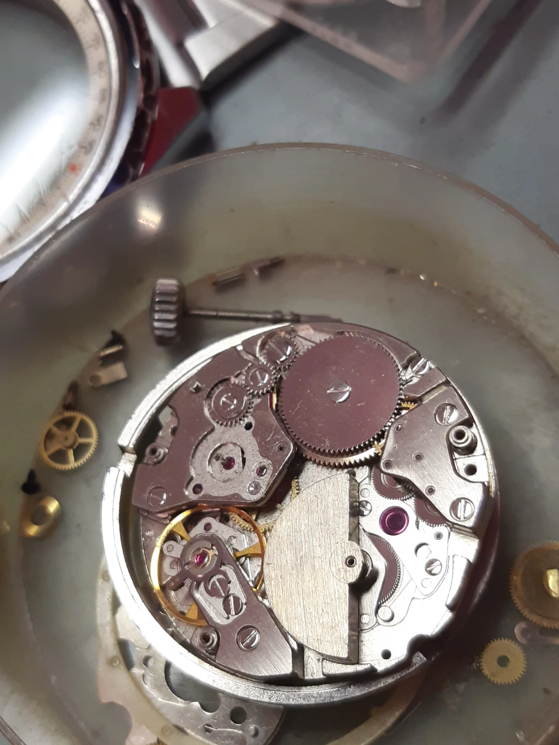

Well, a small update:
Found an inner scale in better shape. Costly but the dial is so nice I think it is worth the expense.

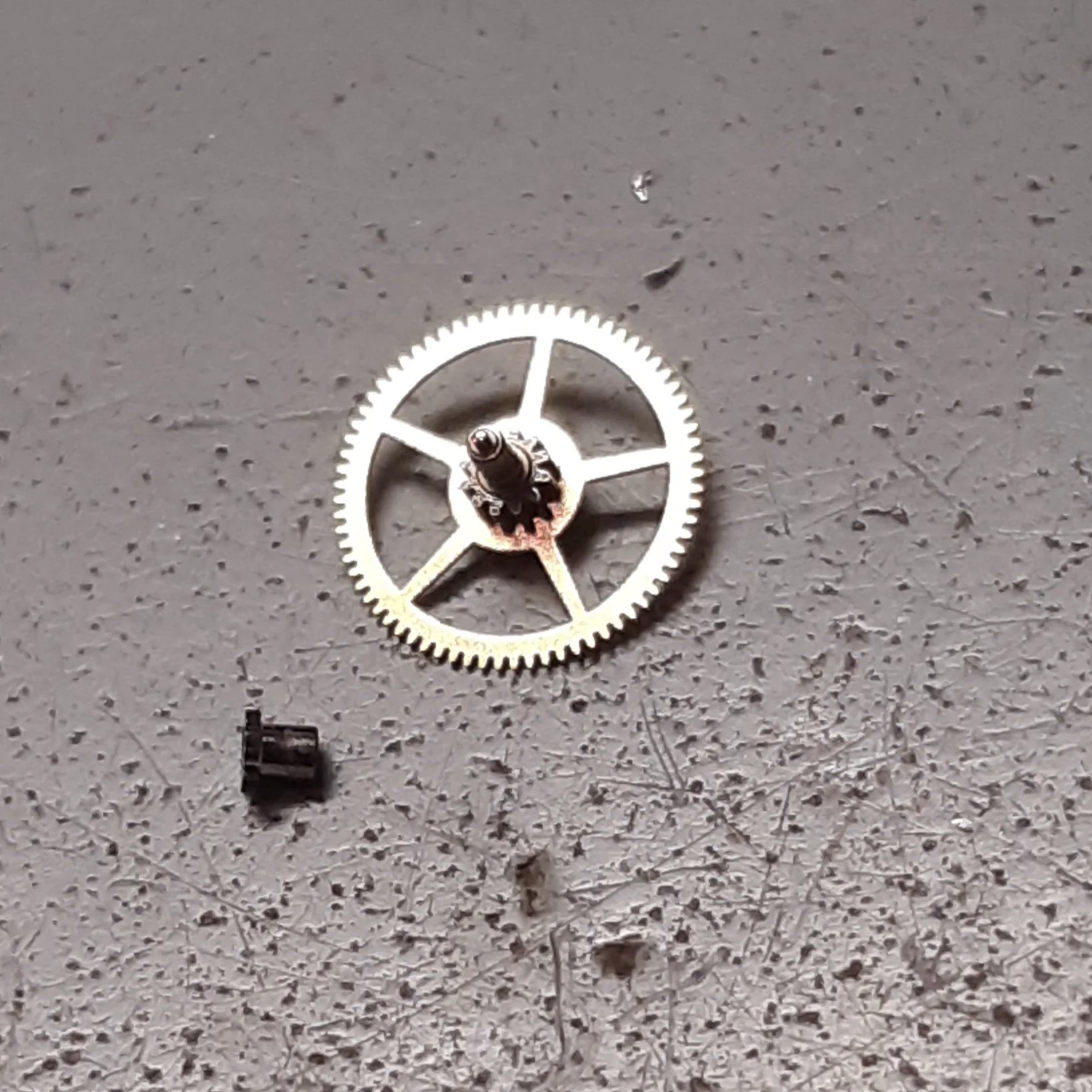

Cleaned the case and replaced the damaged pusher cap. Luckily I had one.
The movement was missing the big driving wheel 200/1 so I ordered one.
Pleased with myself so far...
1,615
3,862

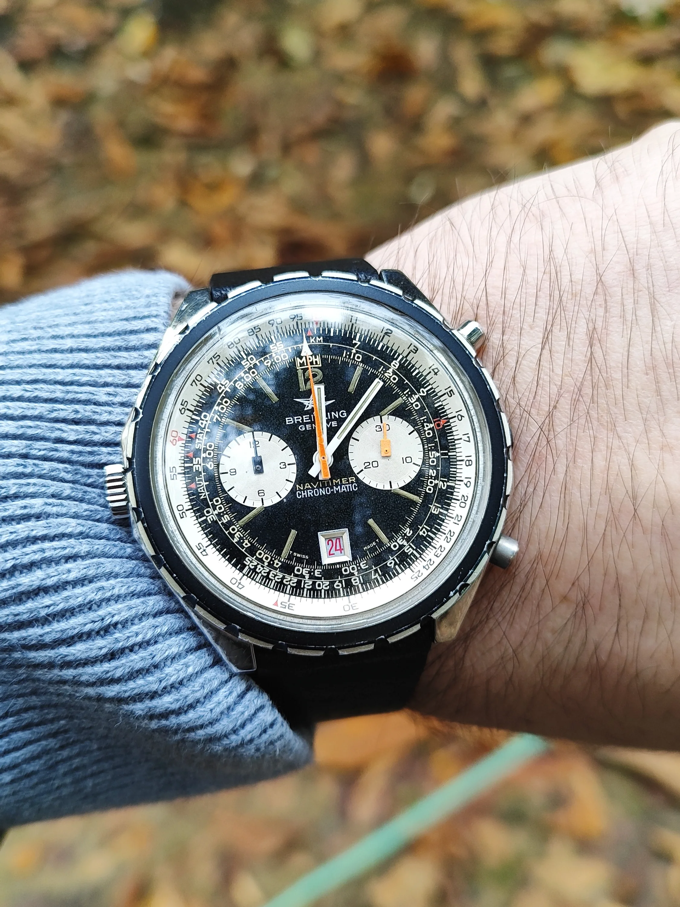

Parts have arrived. The inner scale is looking so much better 🥰
1,615

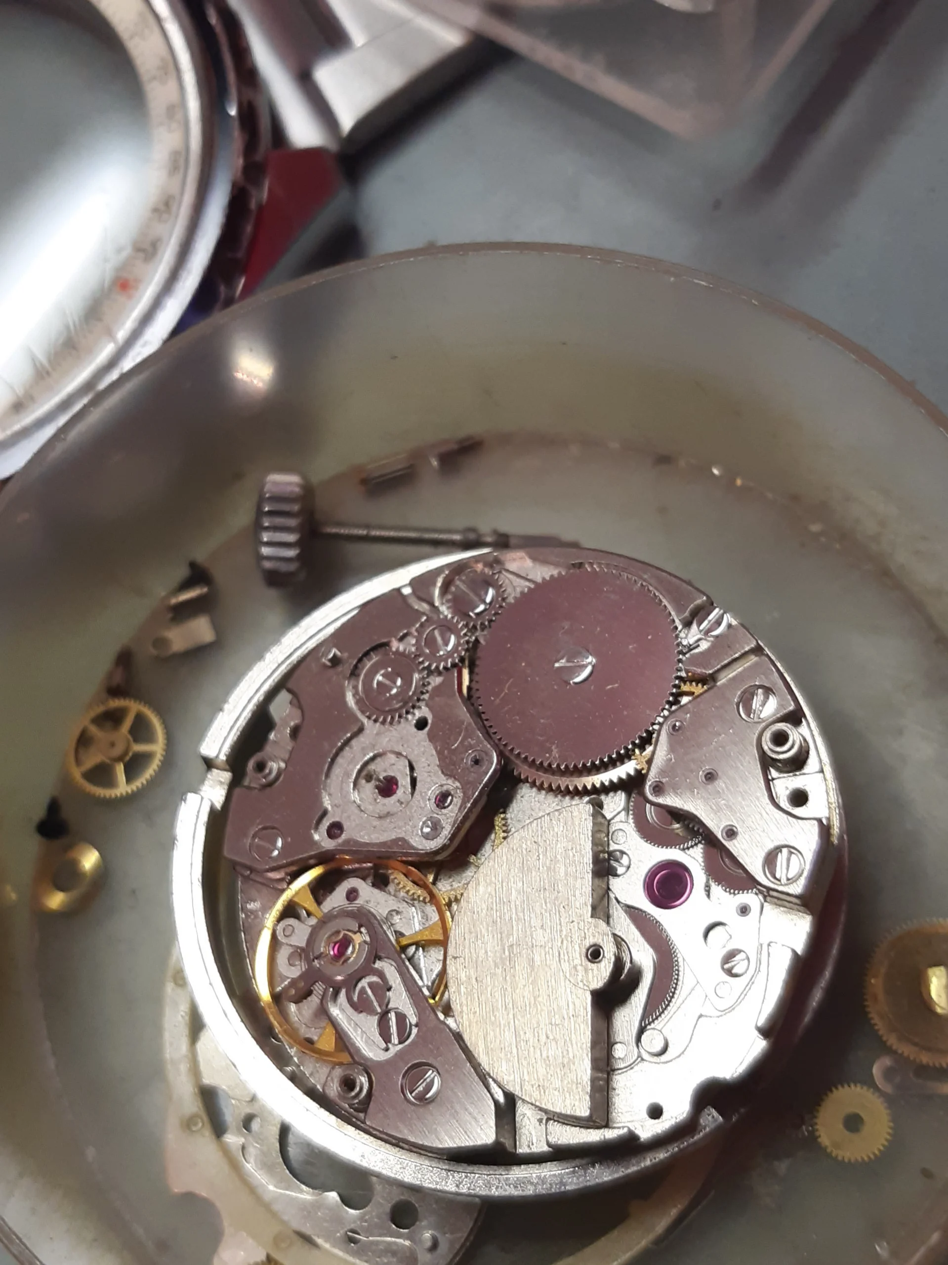

3,862

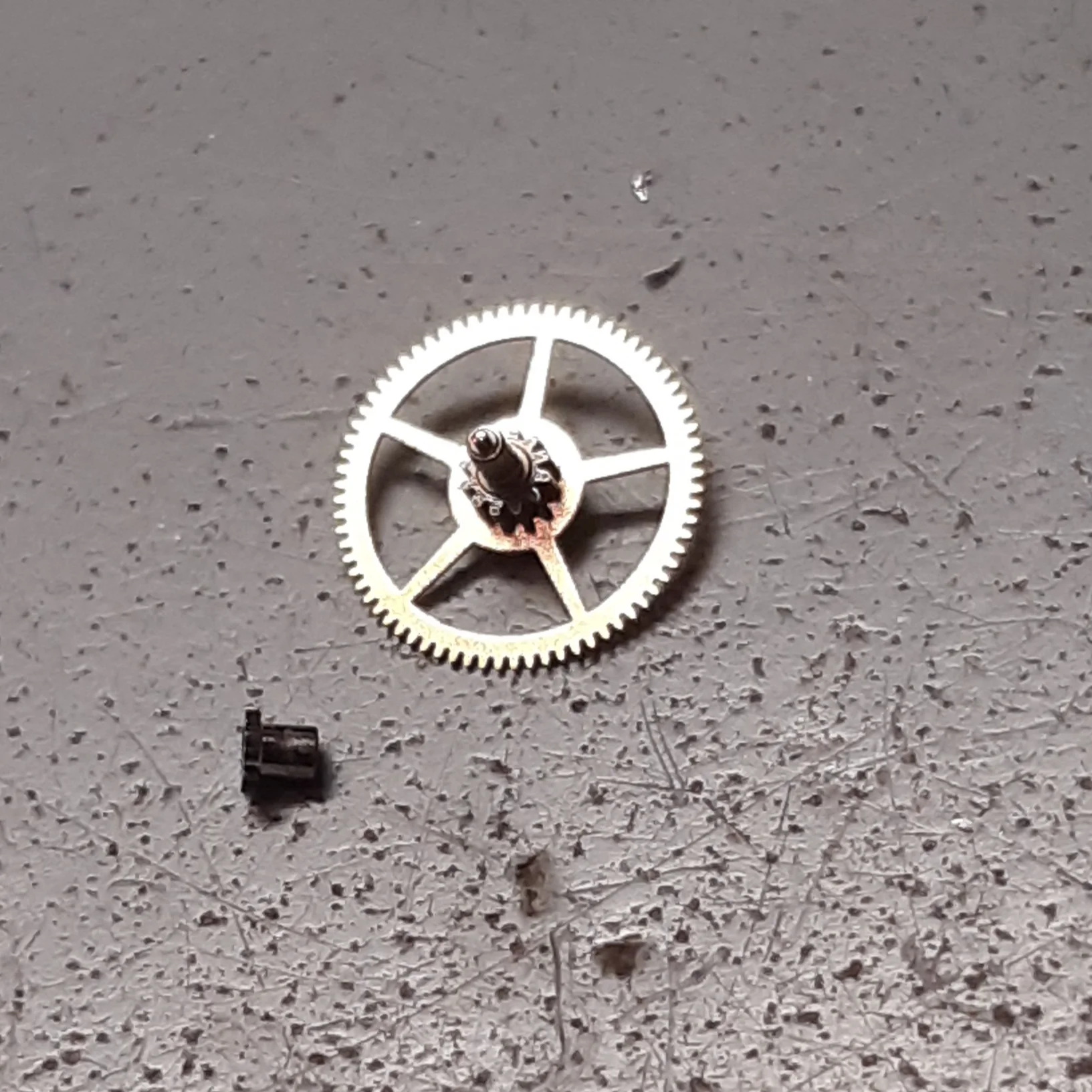

The internal parts that were missing, I had to add friction to the cannon pinion.

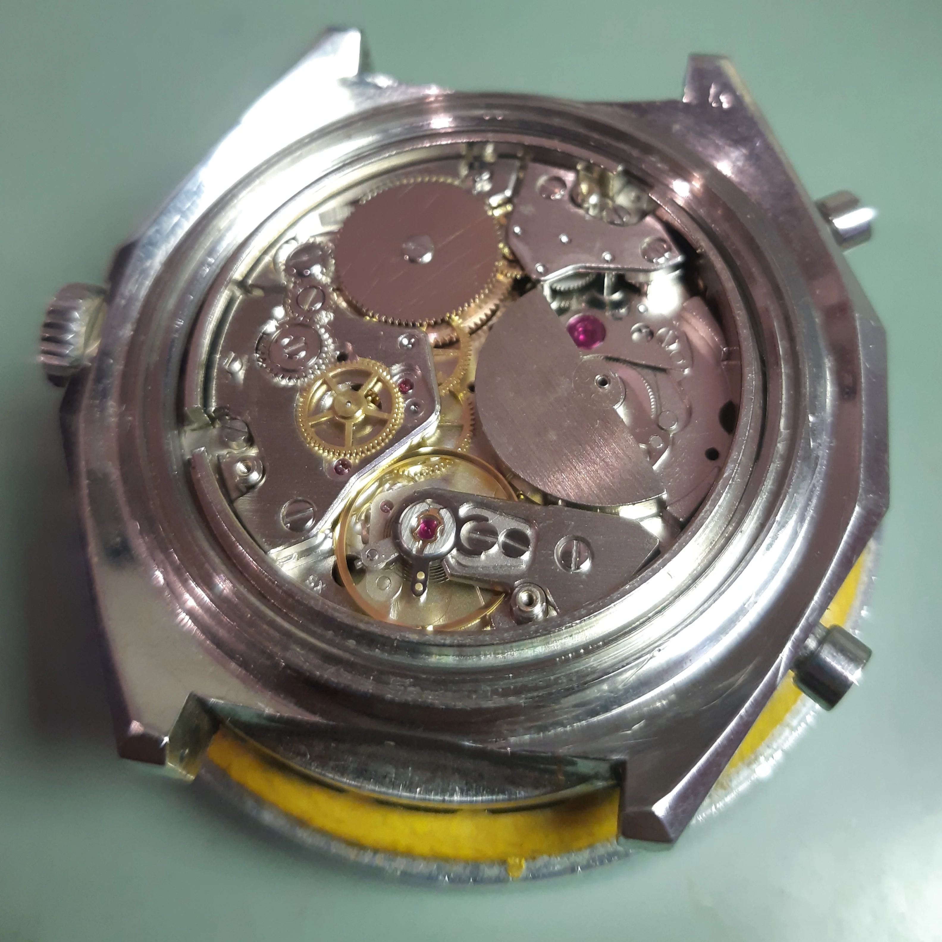

Base movement looks ok now after service but I cased it to double check the automatic winding. I don't trust it too much and I'd rather not have to fiddle with it once the chrono module is bolted on.

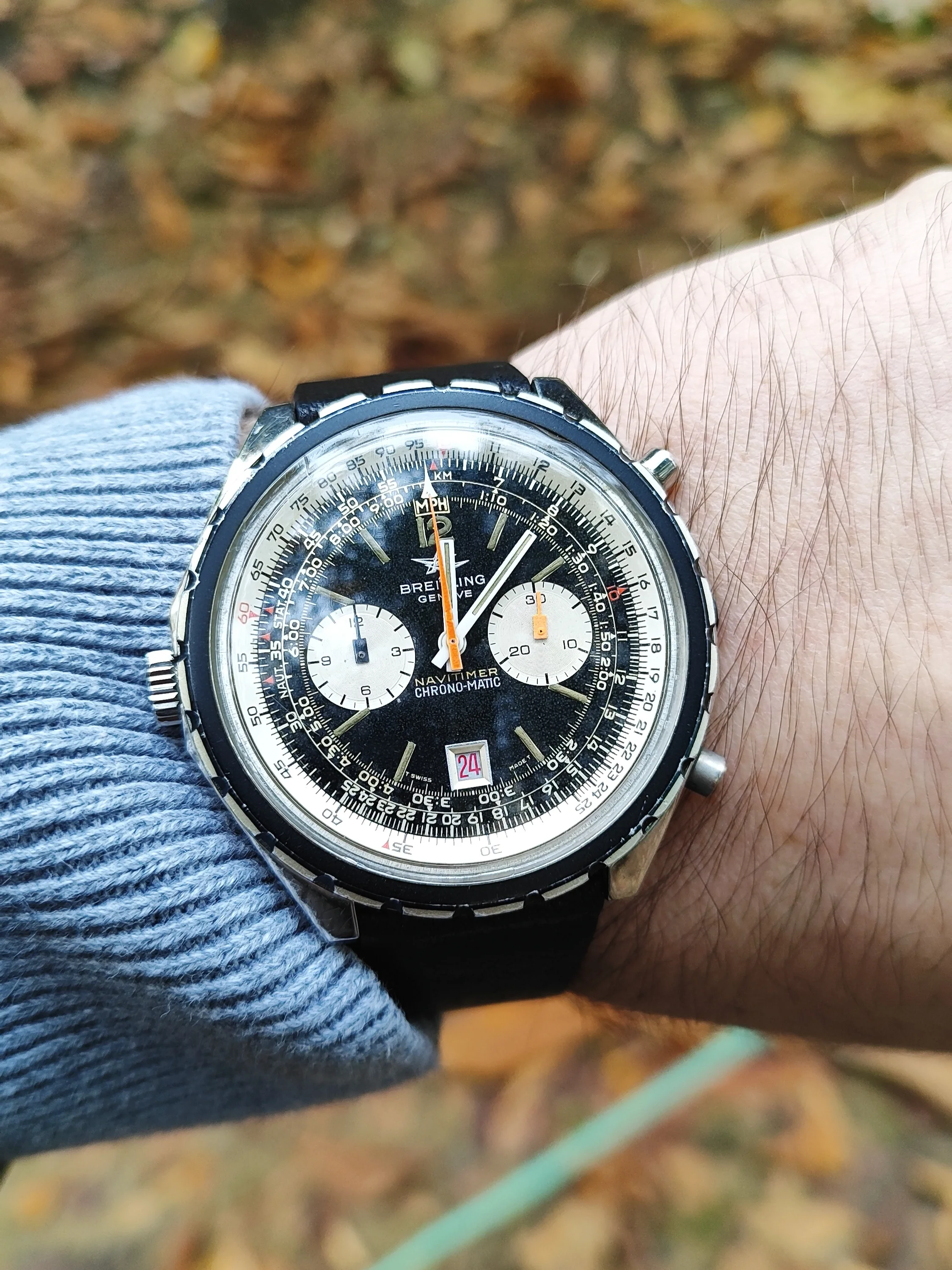

2,625
5,862
😀 Christmas pizza
Amazing results, and what an effort to bring back the watch!
