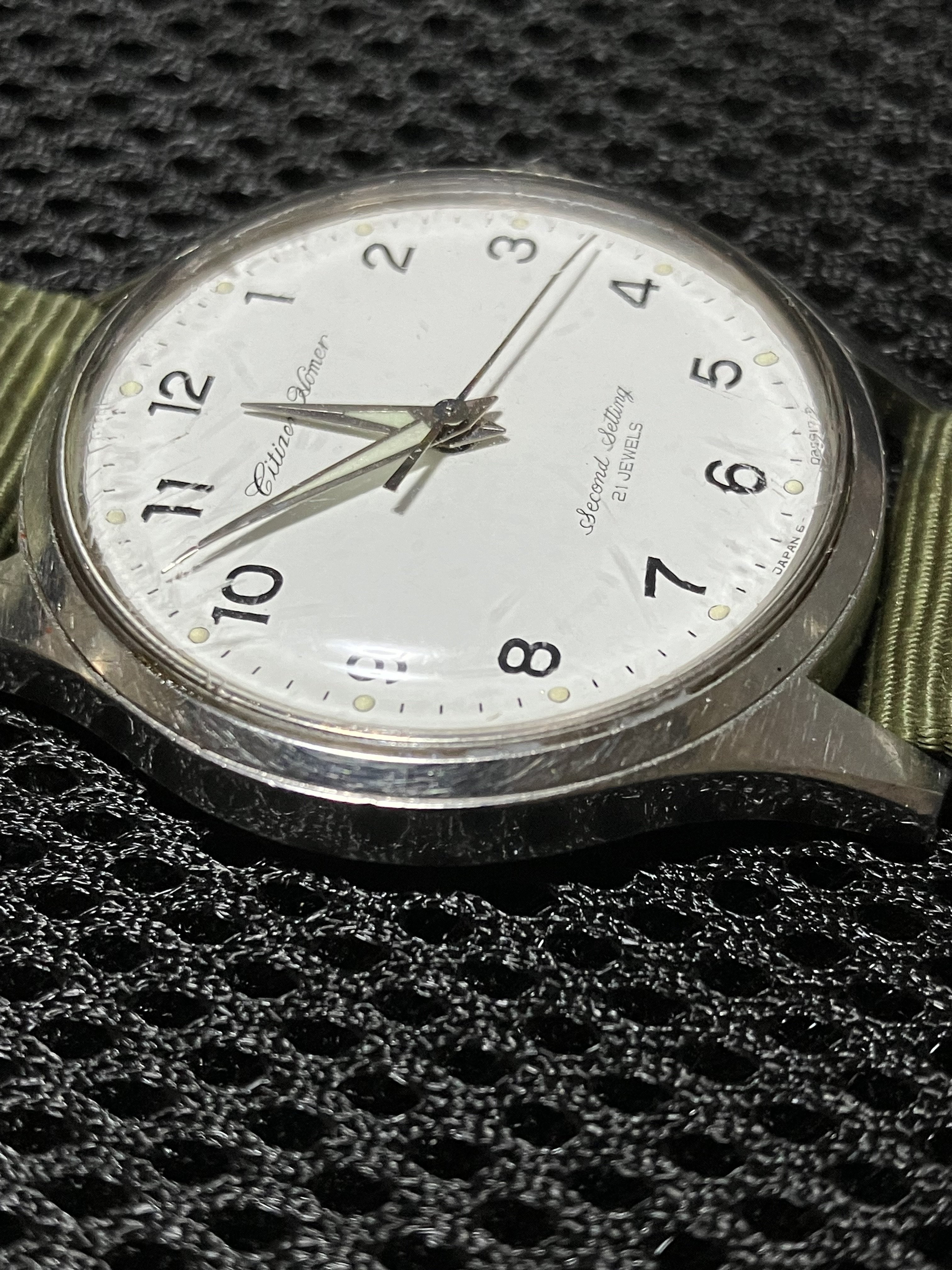

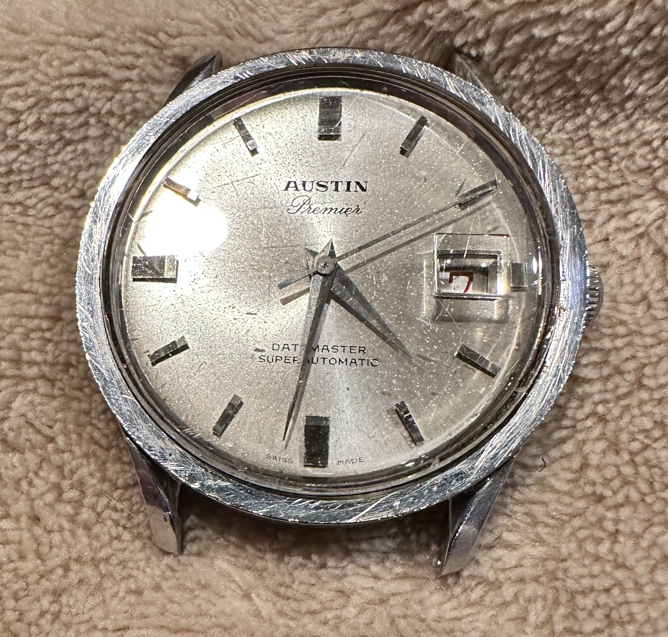

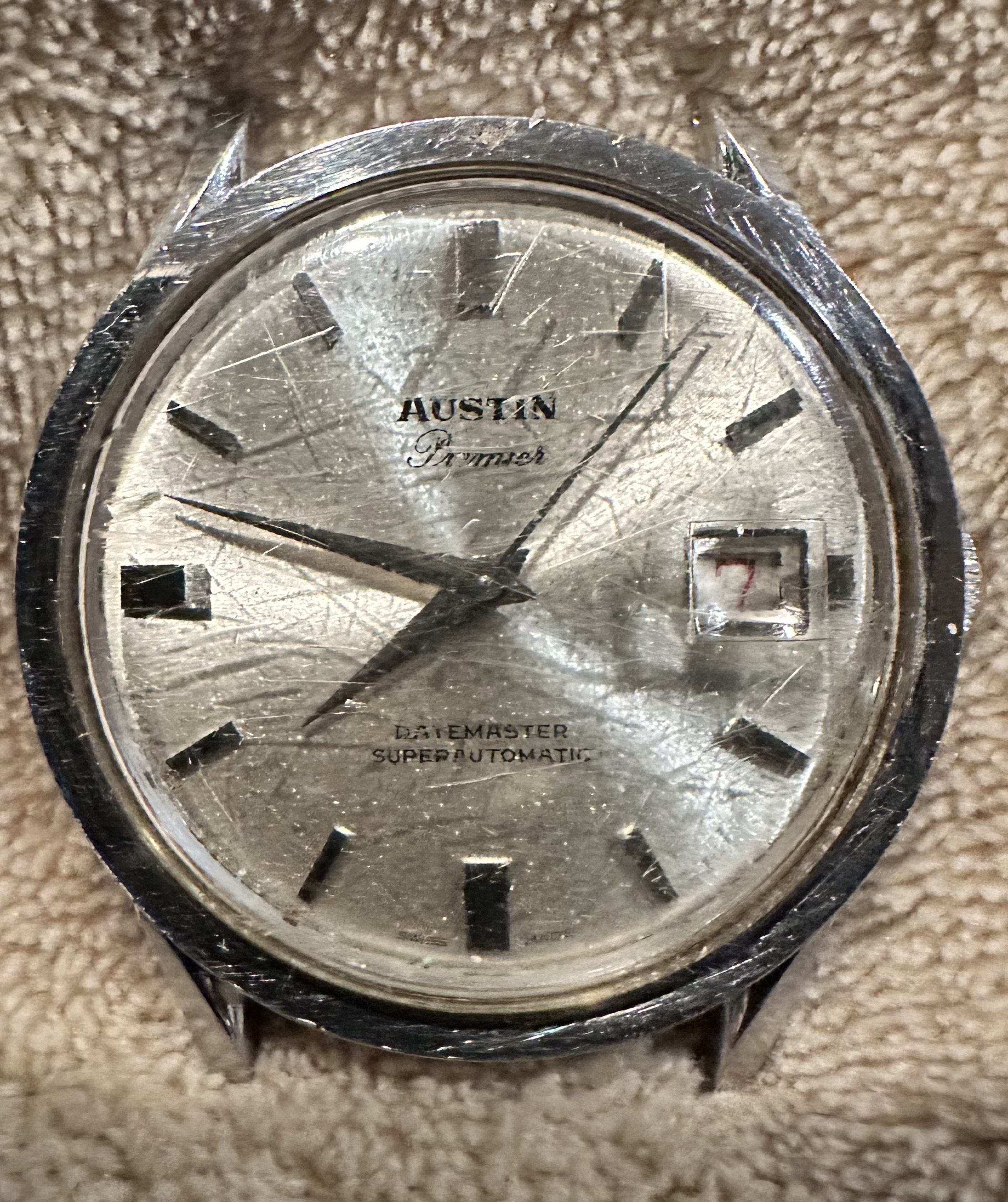

First attempt using Polywatch. Still some polishing to do, but that stuff works. Pretty amazing results in a short amount of time. Hat tip to the one or ones who suggested this stuff back in September.

Just to add to @Scarecrow Boat really detailed thread. I typically dry sand starting from 600 grit, to 1000 and finally to 2000. With a lot of scratches like the watch in this thread, 600 will do quick work of it. Less damage and you can start at 1000.
2000 grit leaves a very smooth finish. You could go higher if you have it, but there's no real benefit. If done right, the polish will be 95% complete in this phase, with only slight fogging. A bit of Polywatch (or toothpase, polishing compound, whatever works for you) and it'll shine like new.

Not sure if you鈥檙e wet sanding in addition to using poly watch, but regardless, you鈥檙e making good progress.
If you want to save money and enjoy minty freshness, toothpaste also works 馃憤
https://omegaforums.net/threads/pol...aper-toothpaste-wet-sanding-pic-heavy.121033/

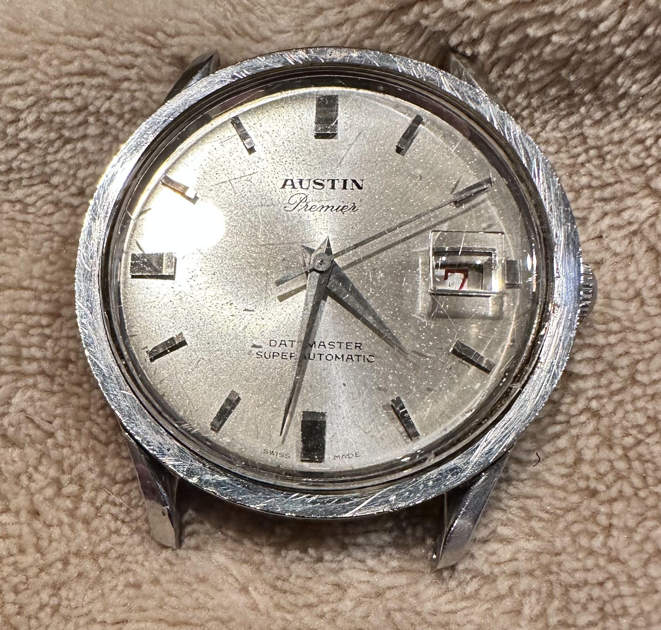

Not doing wet sanding鈥ot that brave. Just Poly and a bit of pressure. Might give the wet sand a go. There鈥檚 still a deeper gouge that I鈥檓 not sure I can reach.
You can give it a shot first on a rando piece of plexi or plastic, its not as scary as it sounds. I generally mask off the case if going with sandpaper as the post sandpaper polishing really can take some elbow grease. Also, depending on the bezel removability / height, I'd try to avoid going too far away from the flat "plateau" of the crystal.
You and @GuiltyGear have obviously done this with success. Are you sanding in a circular motion at all times or can you do some straight line work as well in the beginning phase?

You will definitely need to use sandpaper for that crystal. Don't overthink it, I do it all the time and it's easy enough. It really doesn't matter if you do wet or dry sanding or how you do it, as long as you progress gradually from coarse to fine grits.
As @Dan S said, no need to overthink it. The final pass with 2000 grit will get rid of all the scratches done by the previous grits, and polywatch will get rid of the micron sized scratches of the 2000 grit. It's hard to mess up, even on your first try. Just go through the grits in whatever motion you're comfortable with, apply minimal force, and check your progress frequently.
It probably doesn't matter, but I do a crosshatch, turning the watch. I finish with a super high grit, at least 2K.

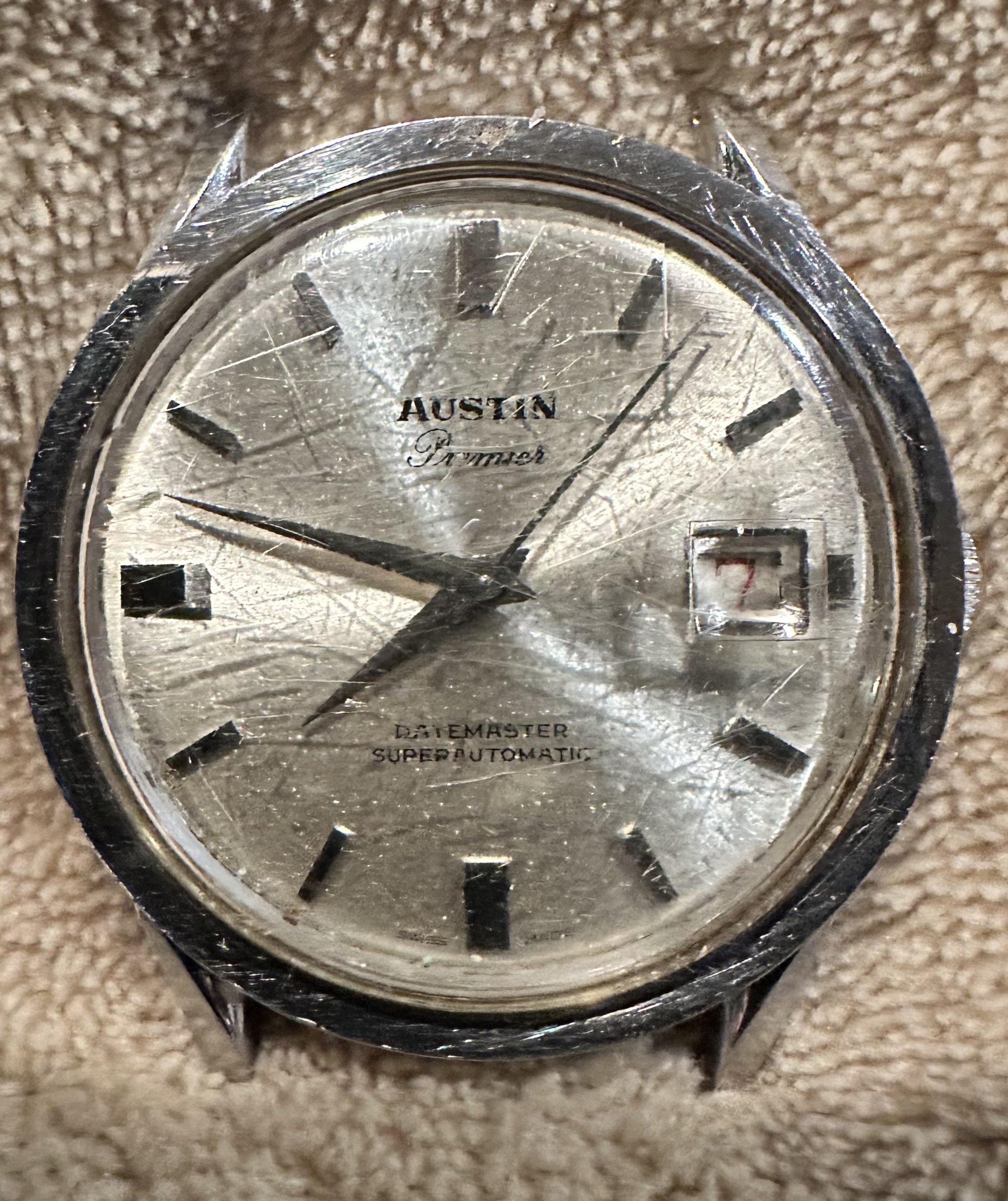

I have a rare few hours to myself on Saturday or Sunday so I鈥檒l be taking a trip to the hardware store to apply some wet sanding to this new project.
