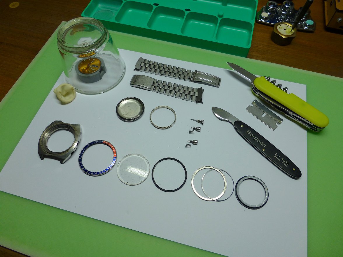

    So after cleaning around the bezel and caseback, a strip down and movement removed.

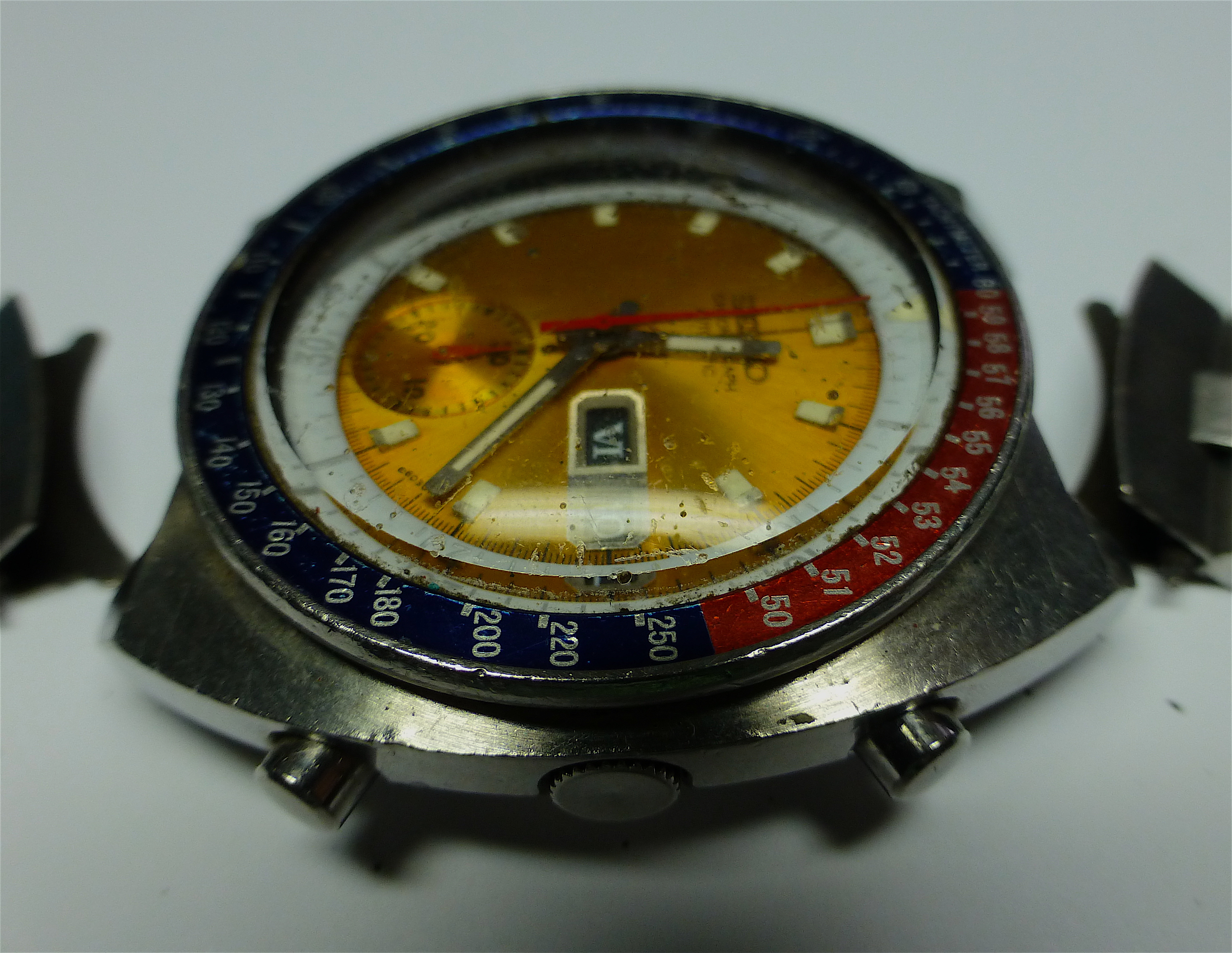

    Condition report:

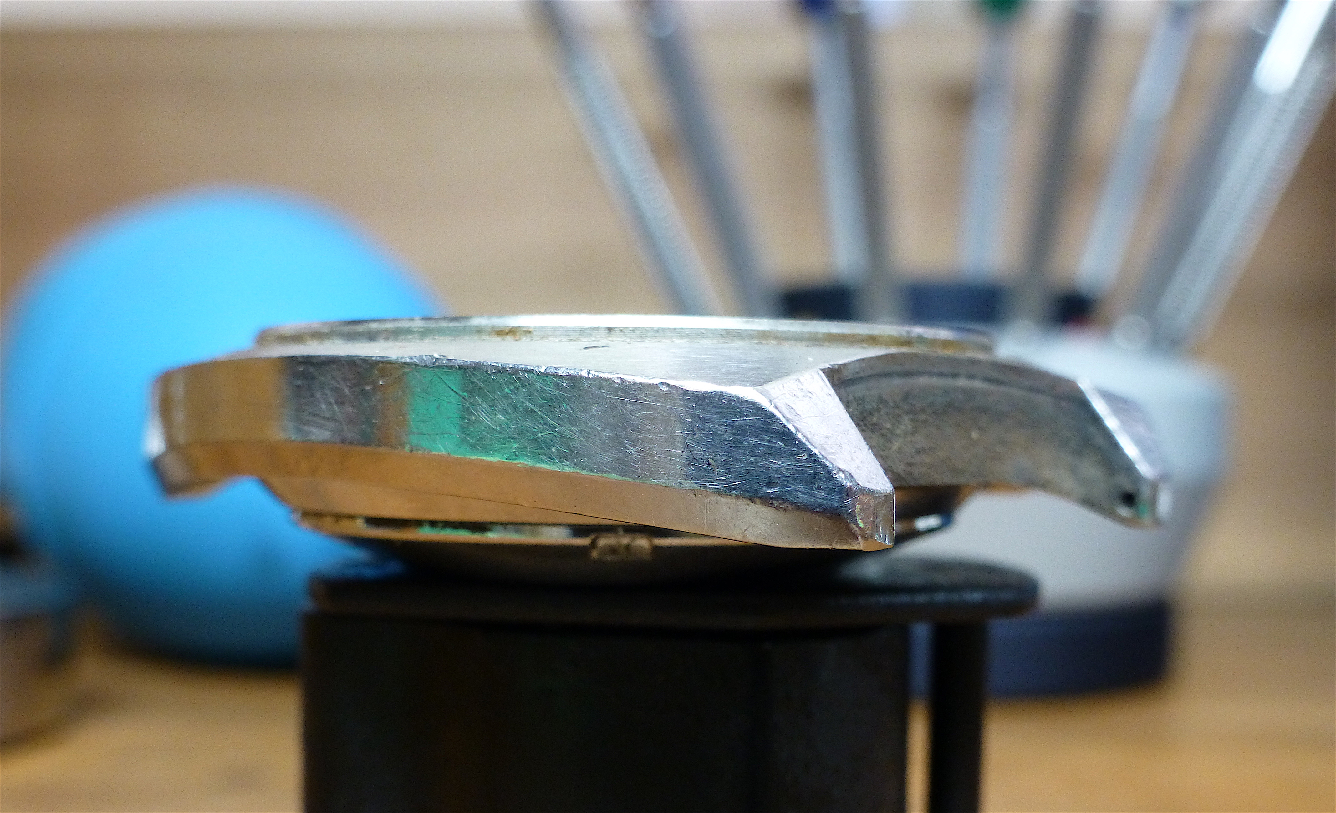

    Case: Heavily marked and covered in welding spatter but original finish just visible.
    Crystal: Looks like the surface of the moon, heavy weld spatter.
    Bezel: Not too bad, will be cleaned and retained.
    Crown/Pushers: In good condition but sticking badly.

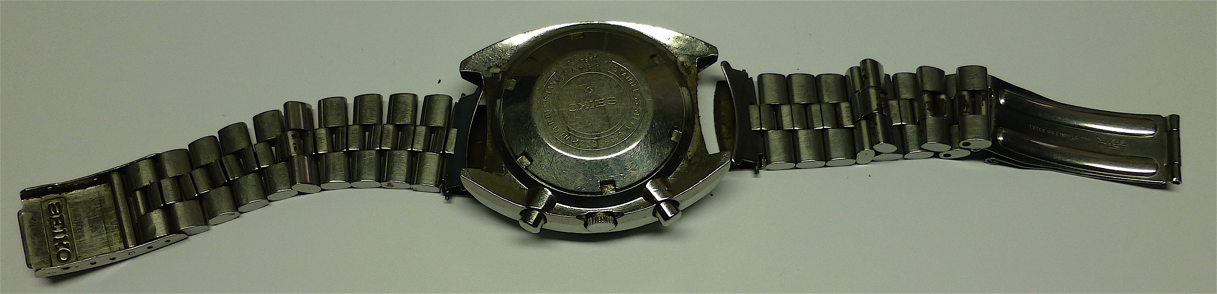

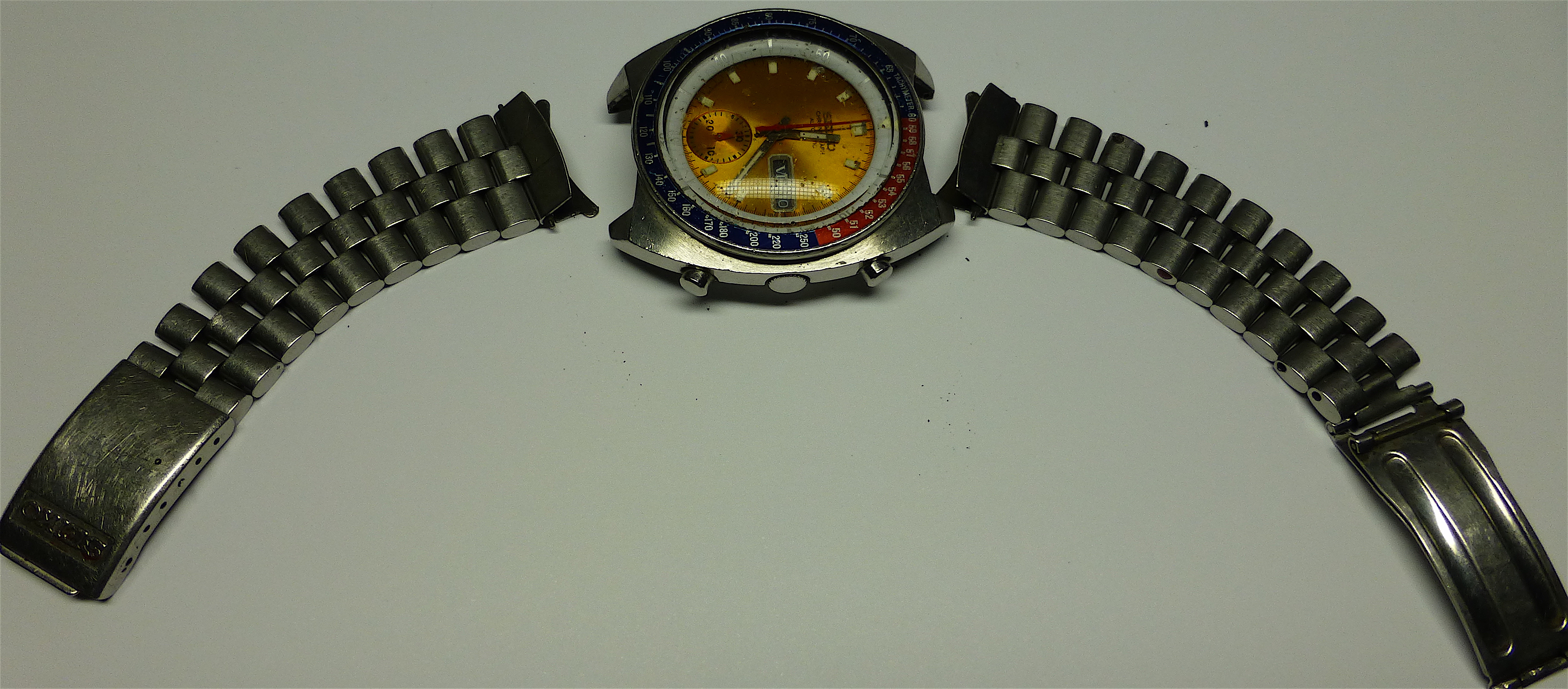

    Bracelet: Original STL Stelux bracelet, not too stretched, covered in weld spatter, gunk and scratches.
    Dial: Reasonable condition original with faded inner bezel.
    Movement: Good to very good condition, no corrosion and appears untouched.

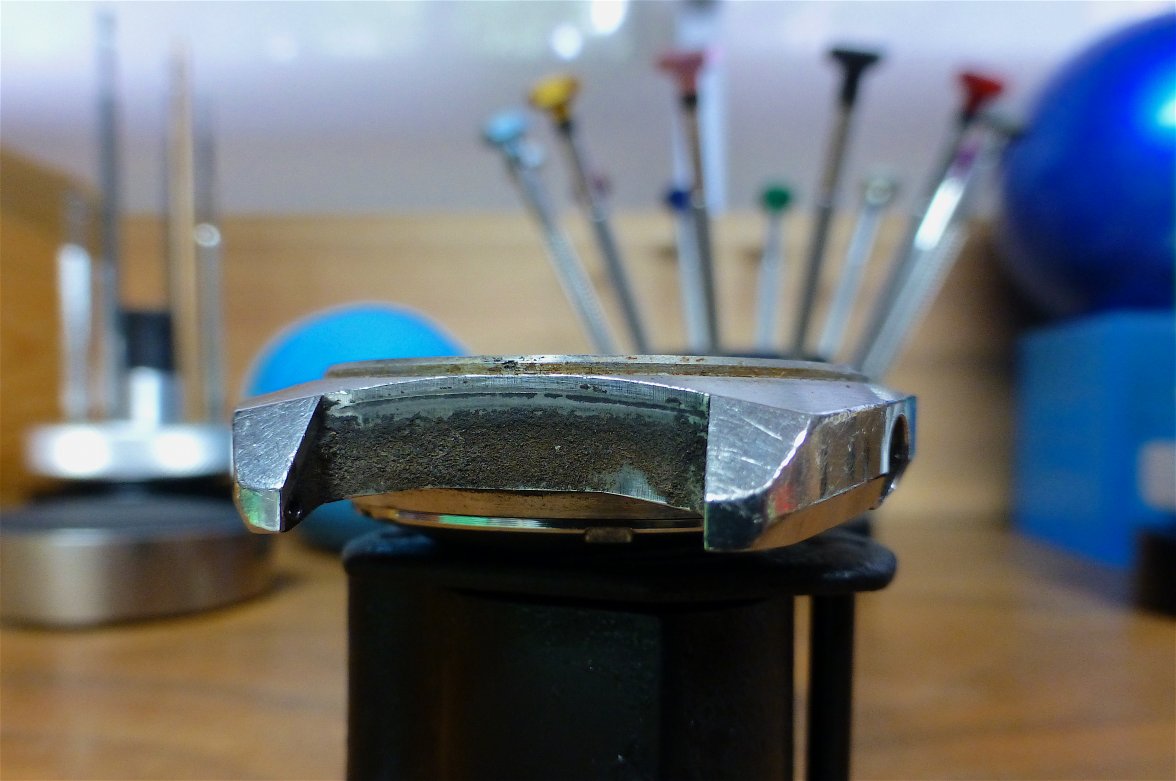

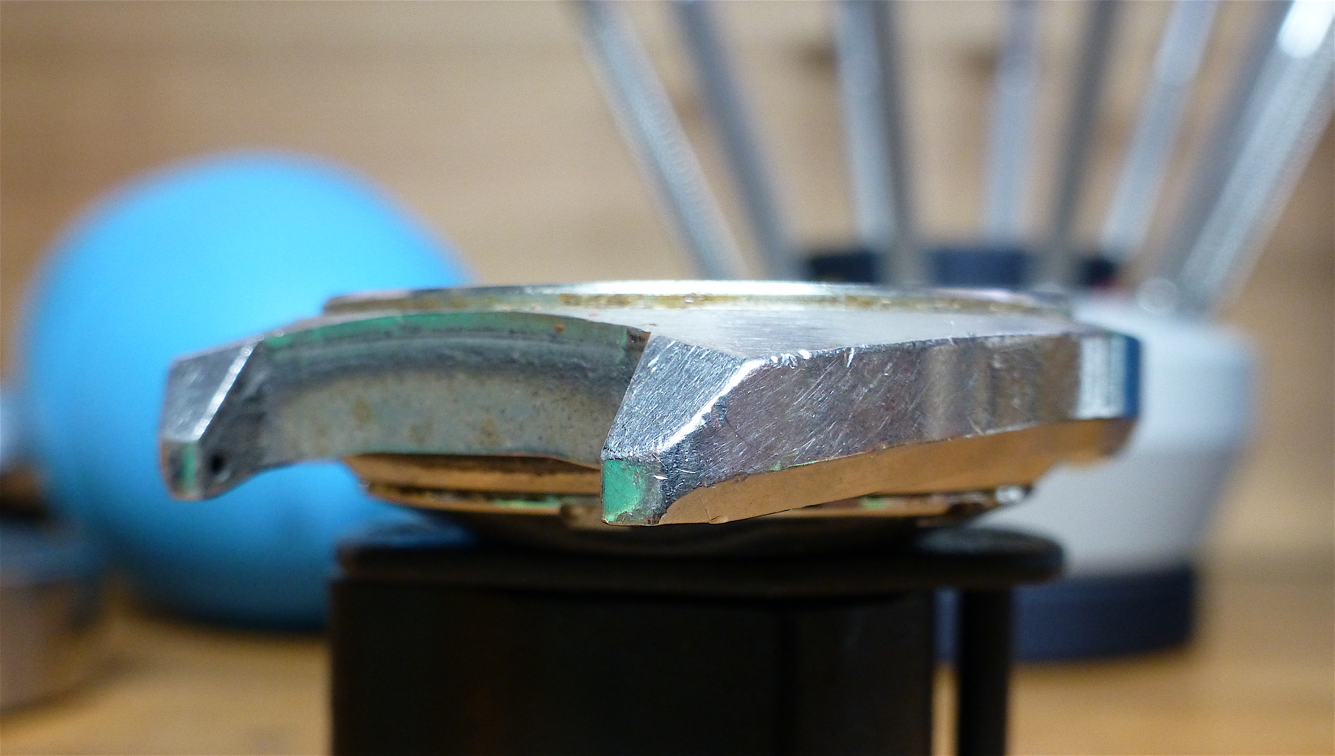

    Concentrating on the case for the first part, here's what I have to start with. Starting at the crown side and going clockwise.
    So now it's a test of my skills to see if I can bring the case back to acceptable condition without making it even worse.

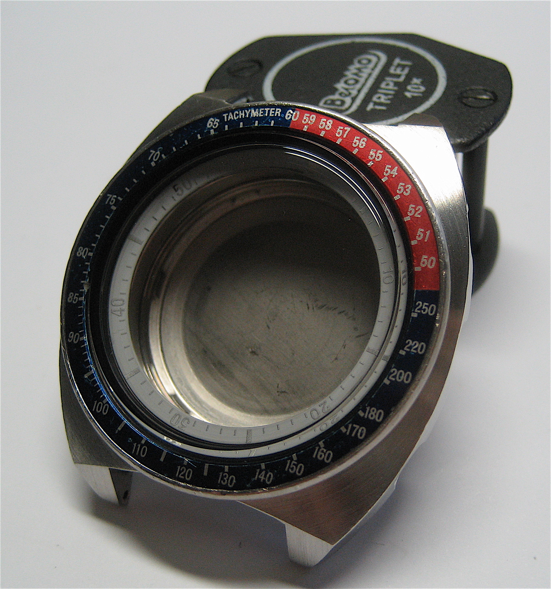

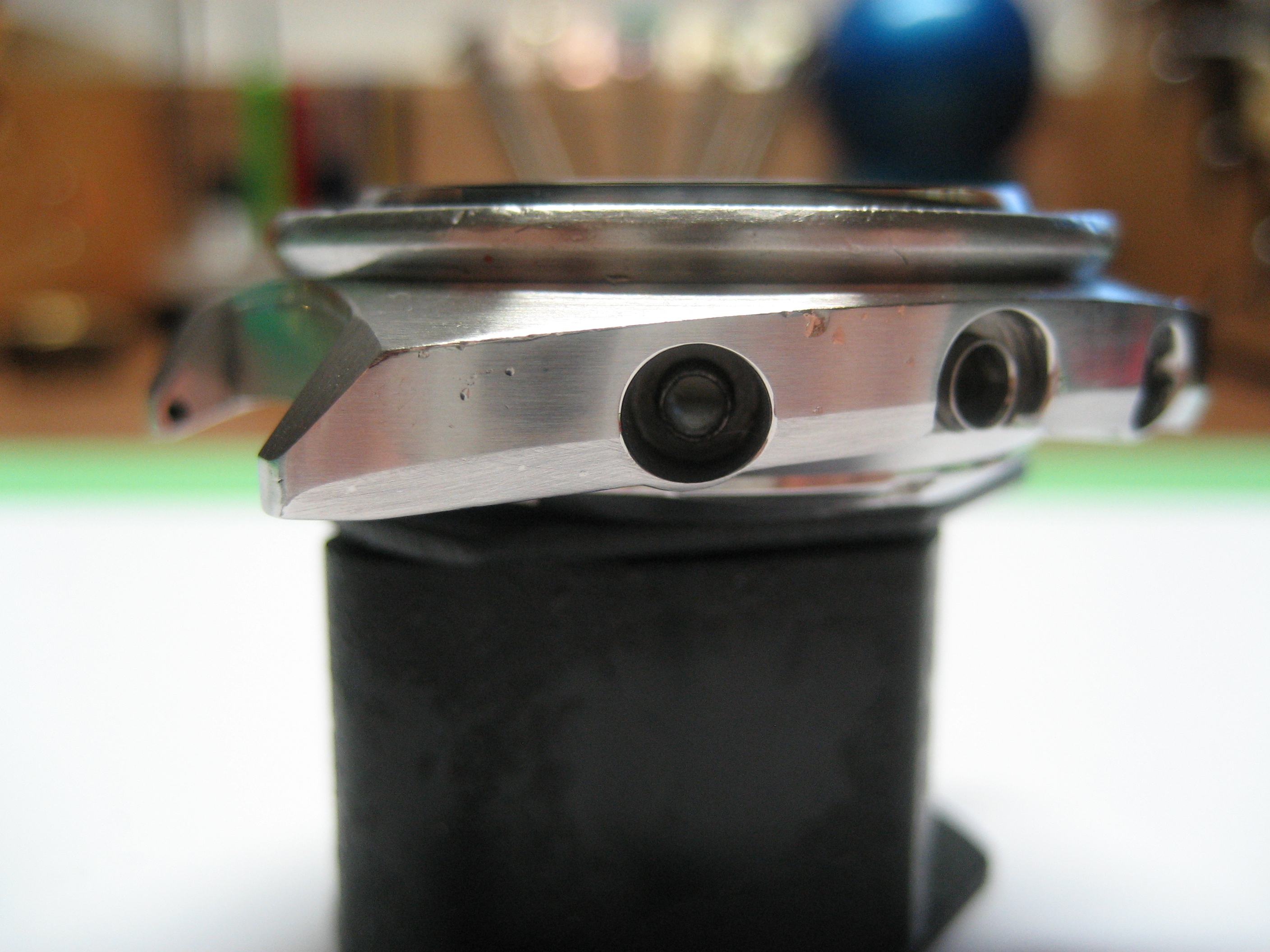

    Finally got around to finishing the case cleanup. Minor re-finishing to remove above surface bumps and scabs, all pusher/crown tubes cleaned and internally polished, bezel left untouched, new crystal fitted.

    That looks awesome. How much metal did you end up taking off to get there?
    Dubby likes this.
  10. JimInOz Melbourne Australia Apr 24, 2016
    14,200
    29,143
    Very little, I only used 800 and 1200 grit paper on hardwood blocks for cleaning the surfaces (on a wood jig to maintain angles) and 2000 grit for the finishing the sides which were originally mirror finish. The intention isn't to produce a "NOS" case but one that was much cleaner than I started with.
    In the end I want the watch to look "lightly worn".

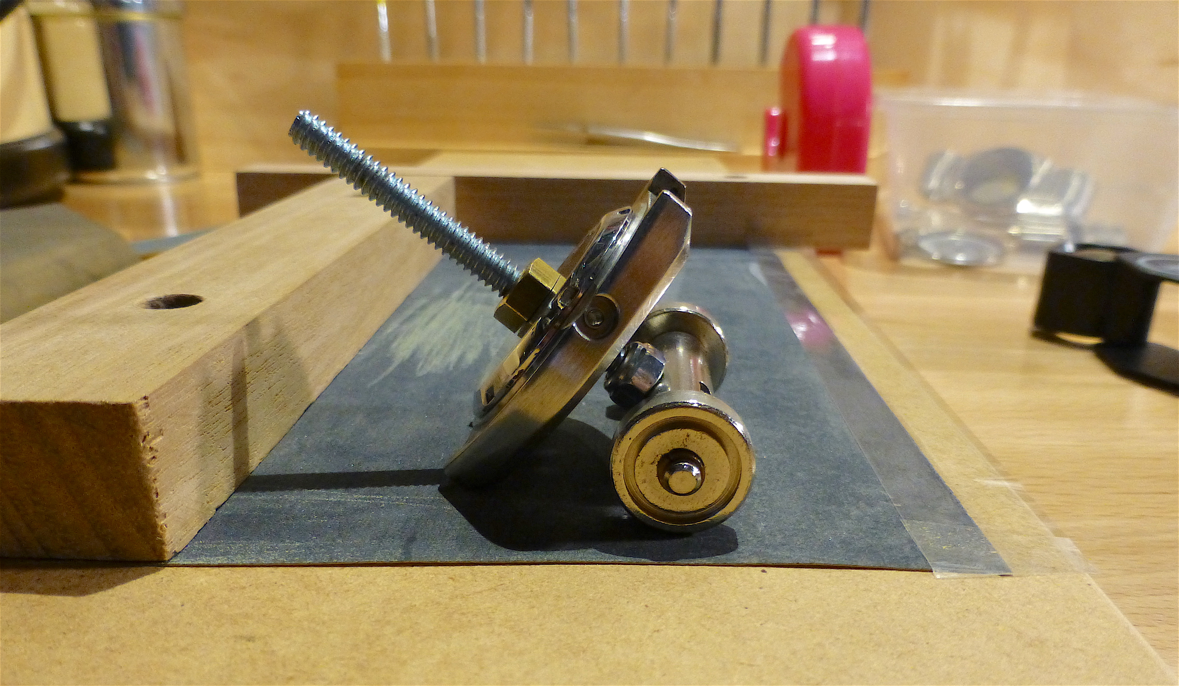

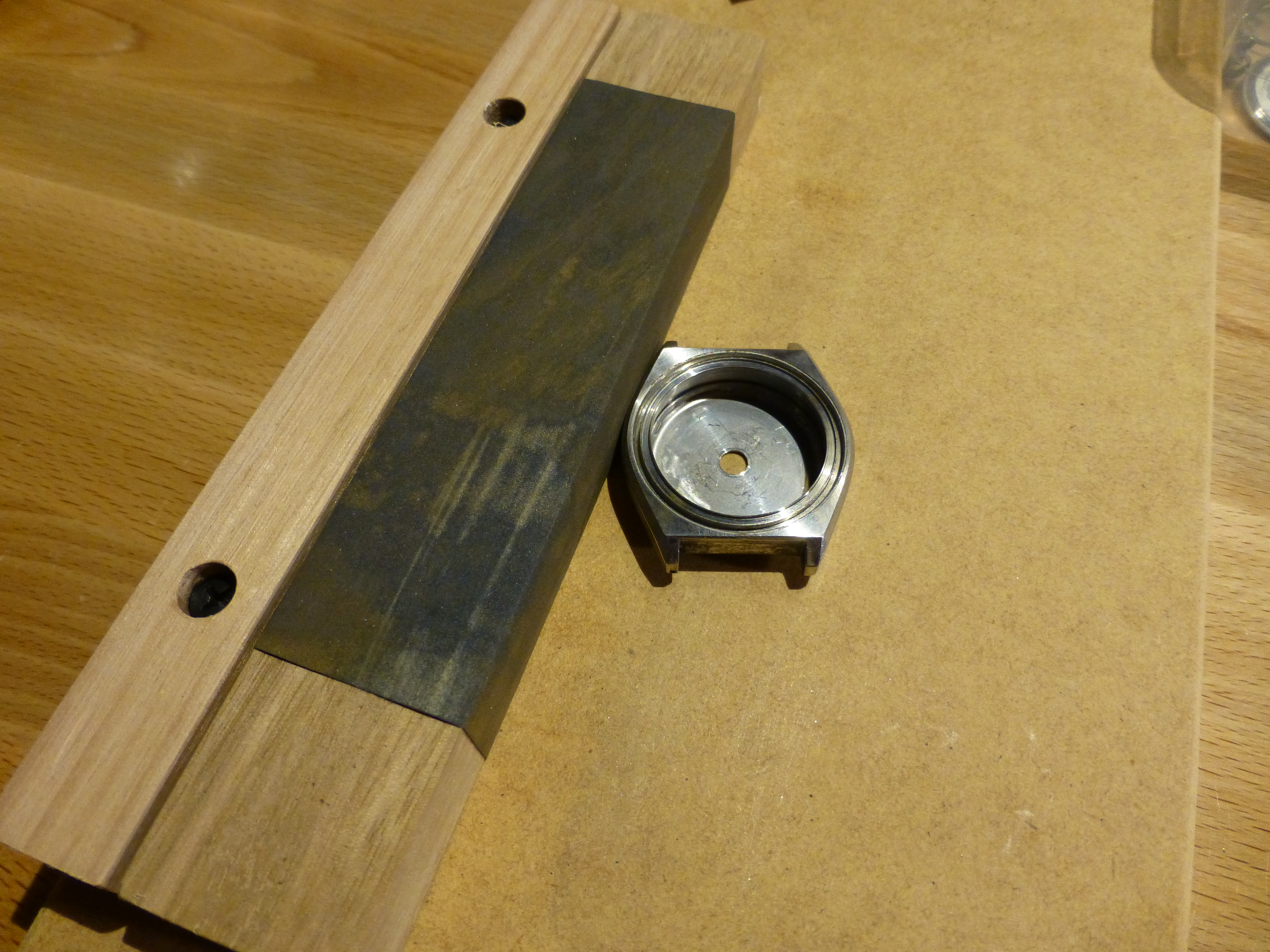

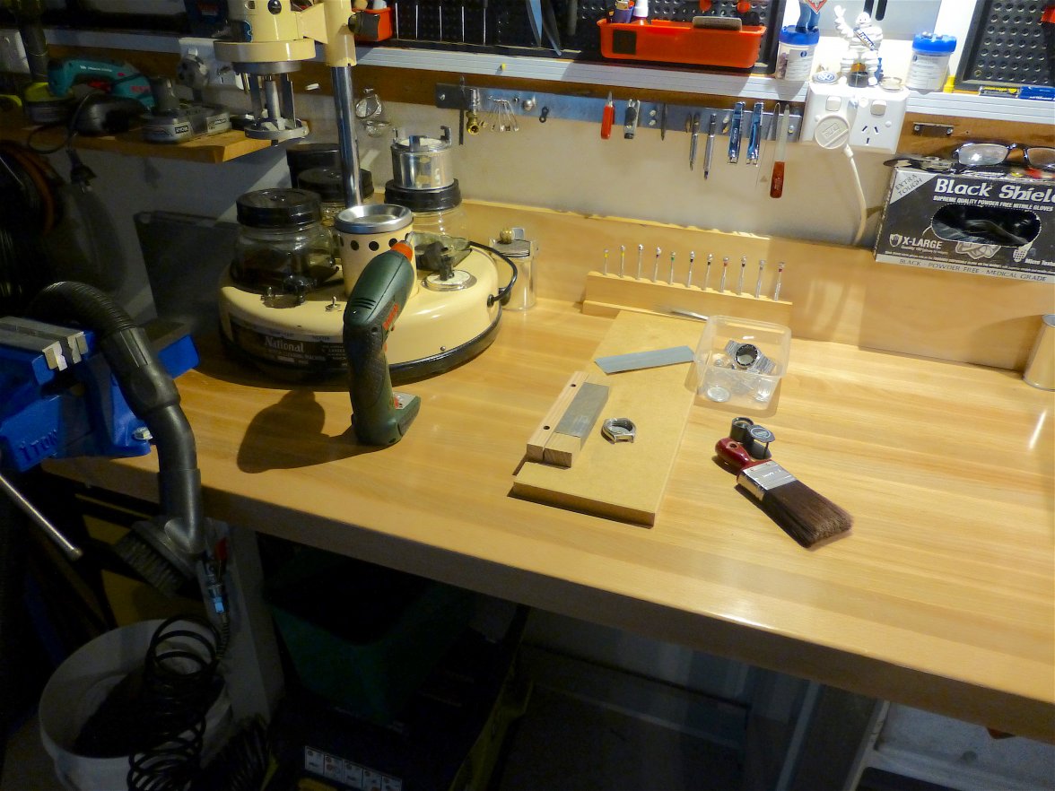

    Had to set up a replication with an old case. My setup is nothing fancy, just hardwood blocks, MDF board and wet and dry paper.
    No buffing or polishing machines were used in the production of this etc etc......
    Note that this is an old watch case for demo, so not all angles etc will be what the 6139 was like.
    Basic setup.

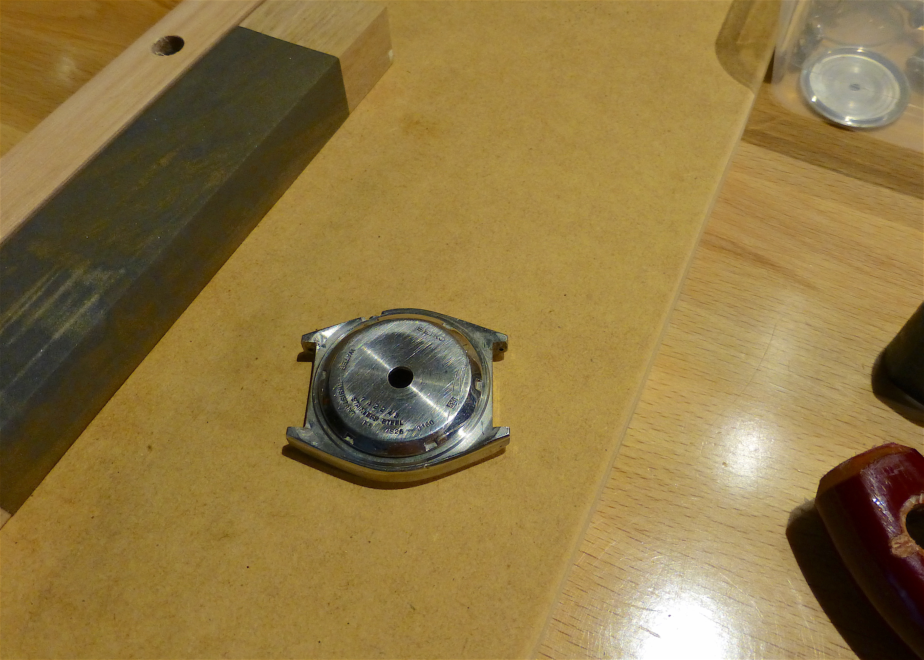

    For doing the sides of the case I used an old caseback from a Seiko quartz as the bearing surface, it's flatter than the one on the 6139.
    The paper is clamped to the board with the wide block and pulled down tight with the narrow block.

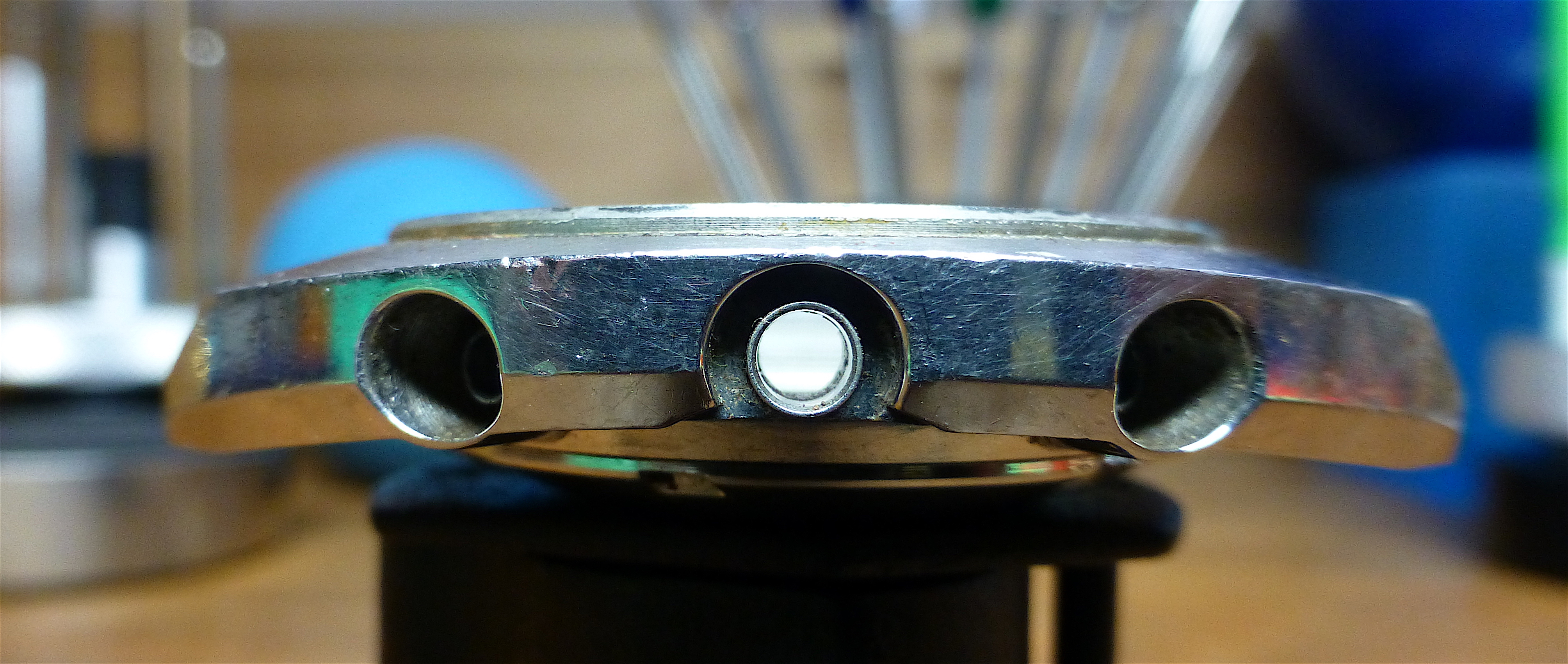

    The case is then bought to the vertical surface and the sides wiped along the blocked paper. Start with 400 grit and work down to 2000 for a final finish. The mirror finish will be done with thin leather glued to a block using metal polish.

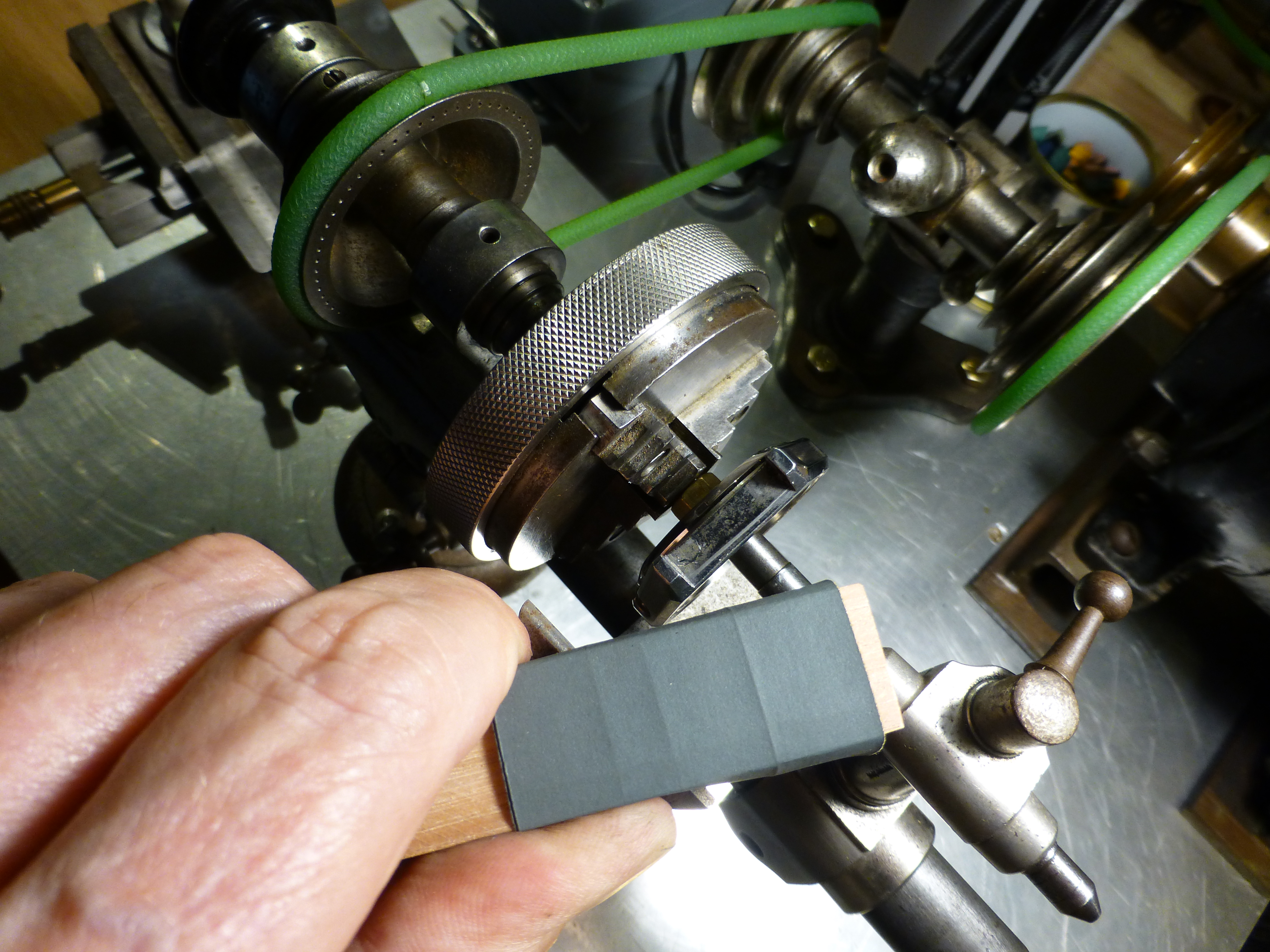

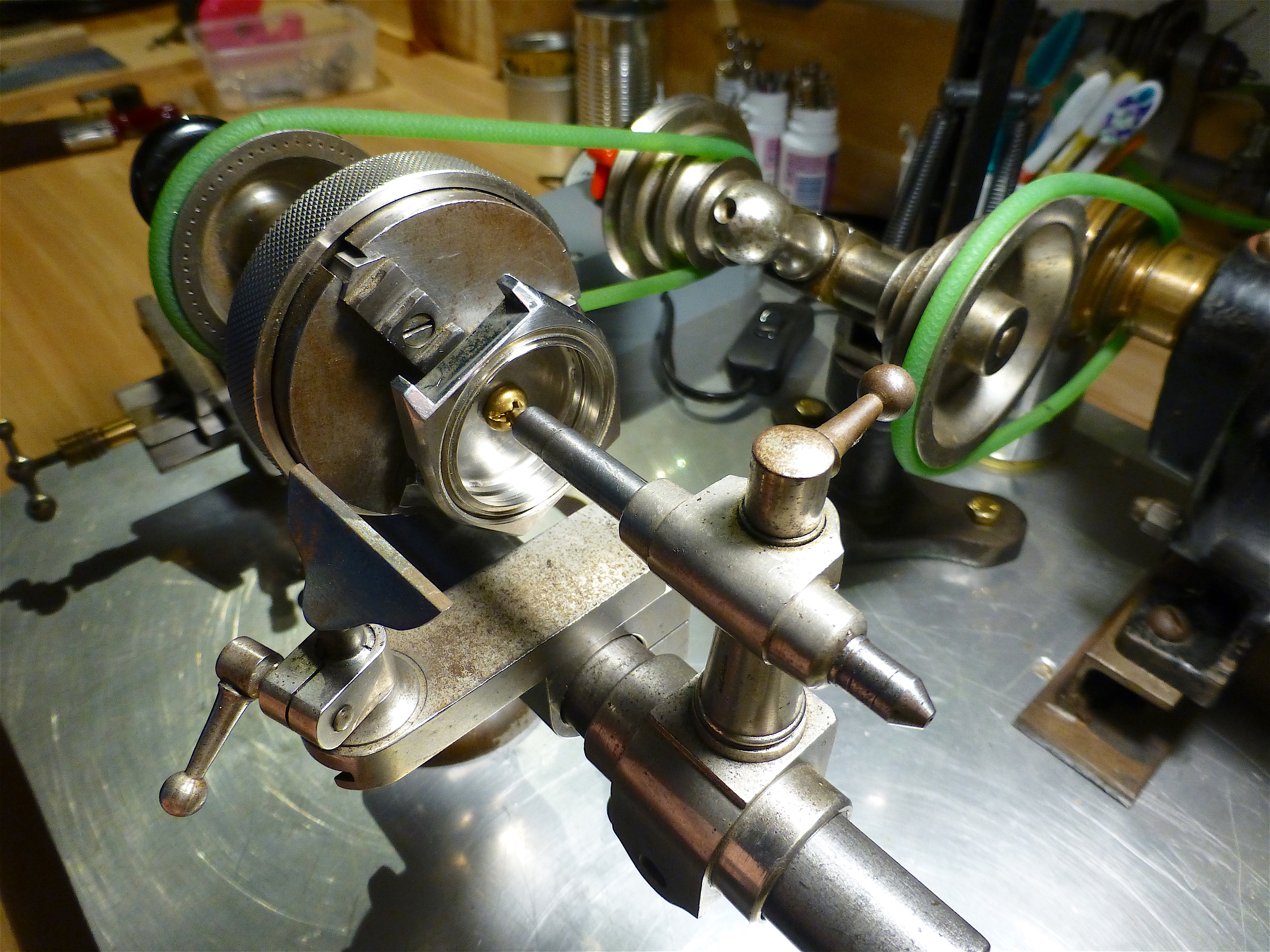

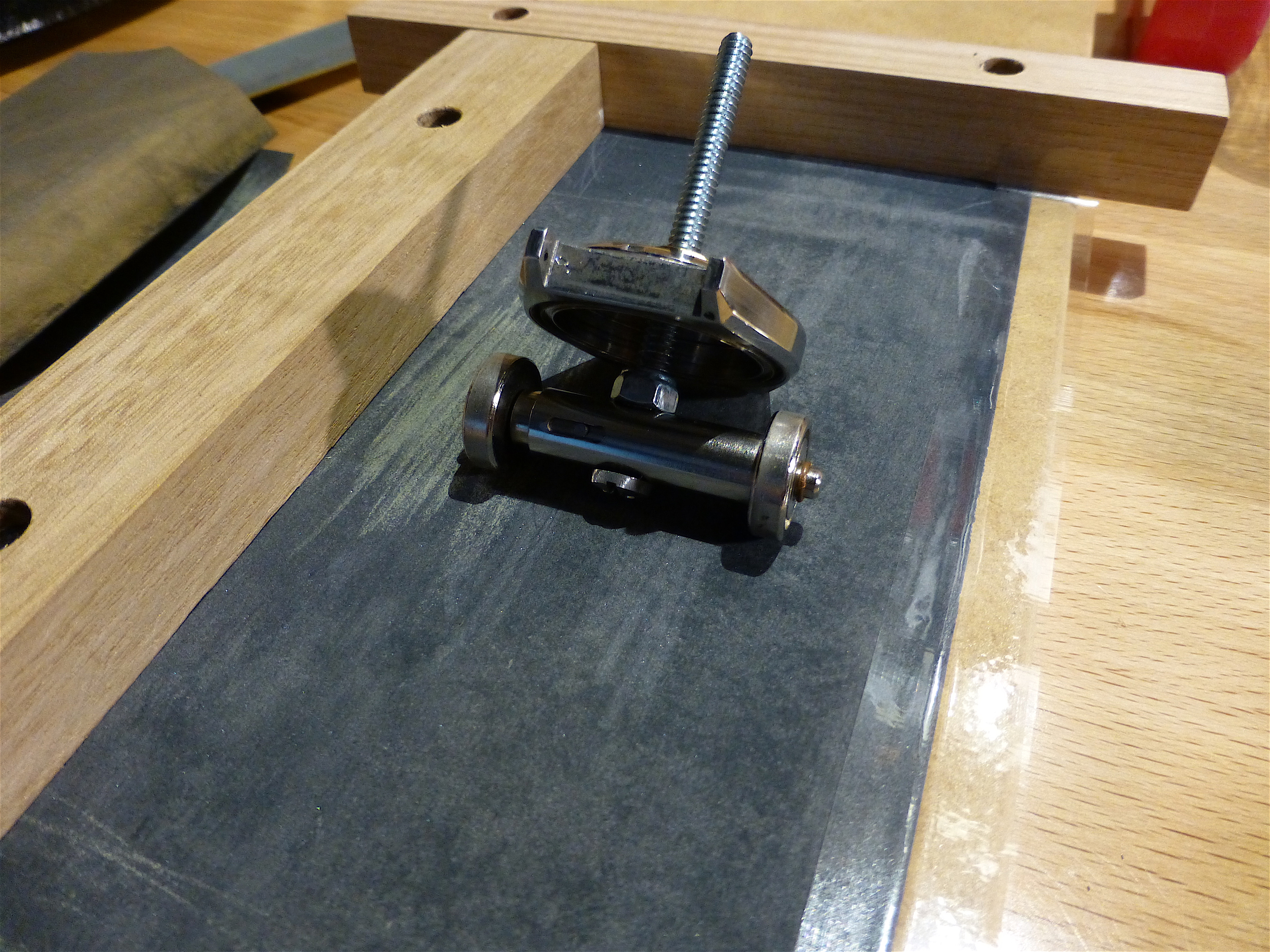

    The facets were harder. I used the caseback again, adapted it with a blade sharpener and a machine screw and nuts. The lugs were marked with a sharpie, wiped on paper to see what got taken off, adjusted and checked until the marker was removed in one pass, then it was onto the grit doing about three passes and checking, repeating until a decent surface was revealed and then one or two passes with 800 grit.
    The radial patterning on the top of the case was done by using the caseback again, mounted in the lathe and spun at low RPM using 600 grit paper on a hardwood block to remove as many dings as I could without removing too much.
