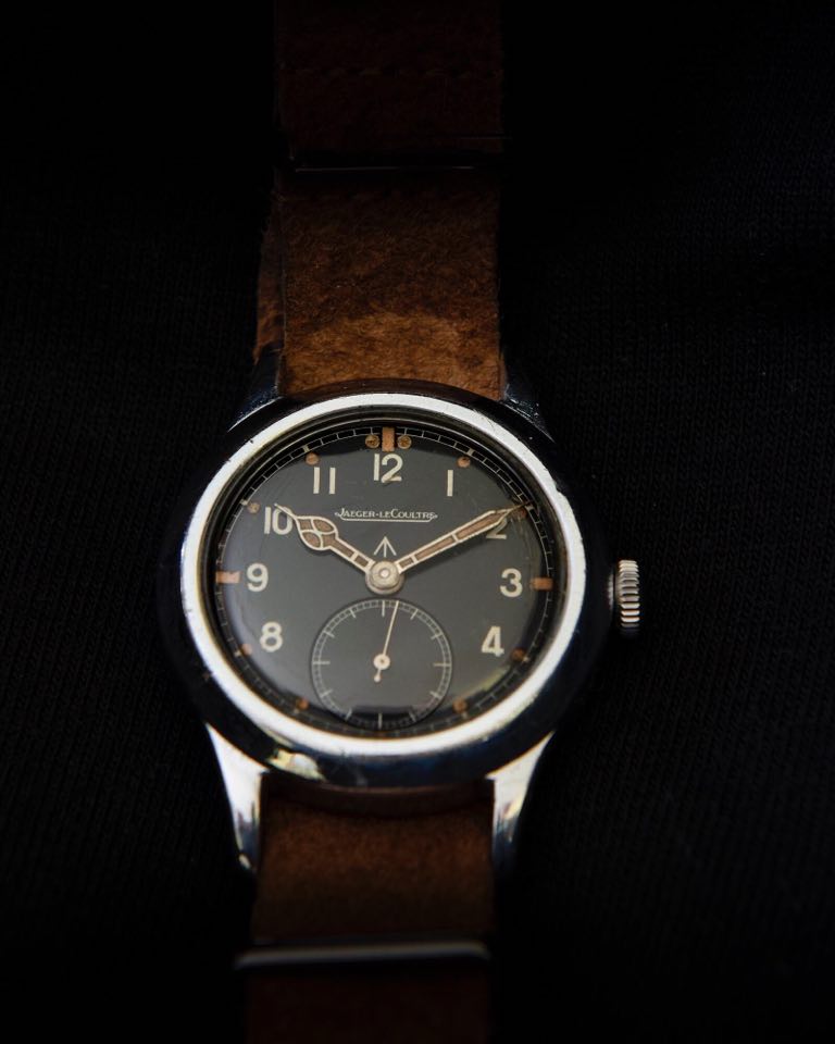

Interestingly enough I actually checked a lot of my early radium watches yesterday - most were in single digits but a recently acquired JLC WWW from WW2 recorded 115 uSv/h. That measurement was directly on the crystal and when I measured the caseback and around 8" above the watch both readings dropped to 7.5 uSv/h. Those figures would not stop me wearing the watch but I would think twice about wearing it non-stop for a long period of time! That said I also measured a 40's Heuer that I had worn daily for around one year and that was measuring 10 uSv/h
1,565
3,678
115 µSv/h is a lot for a watch.
