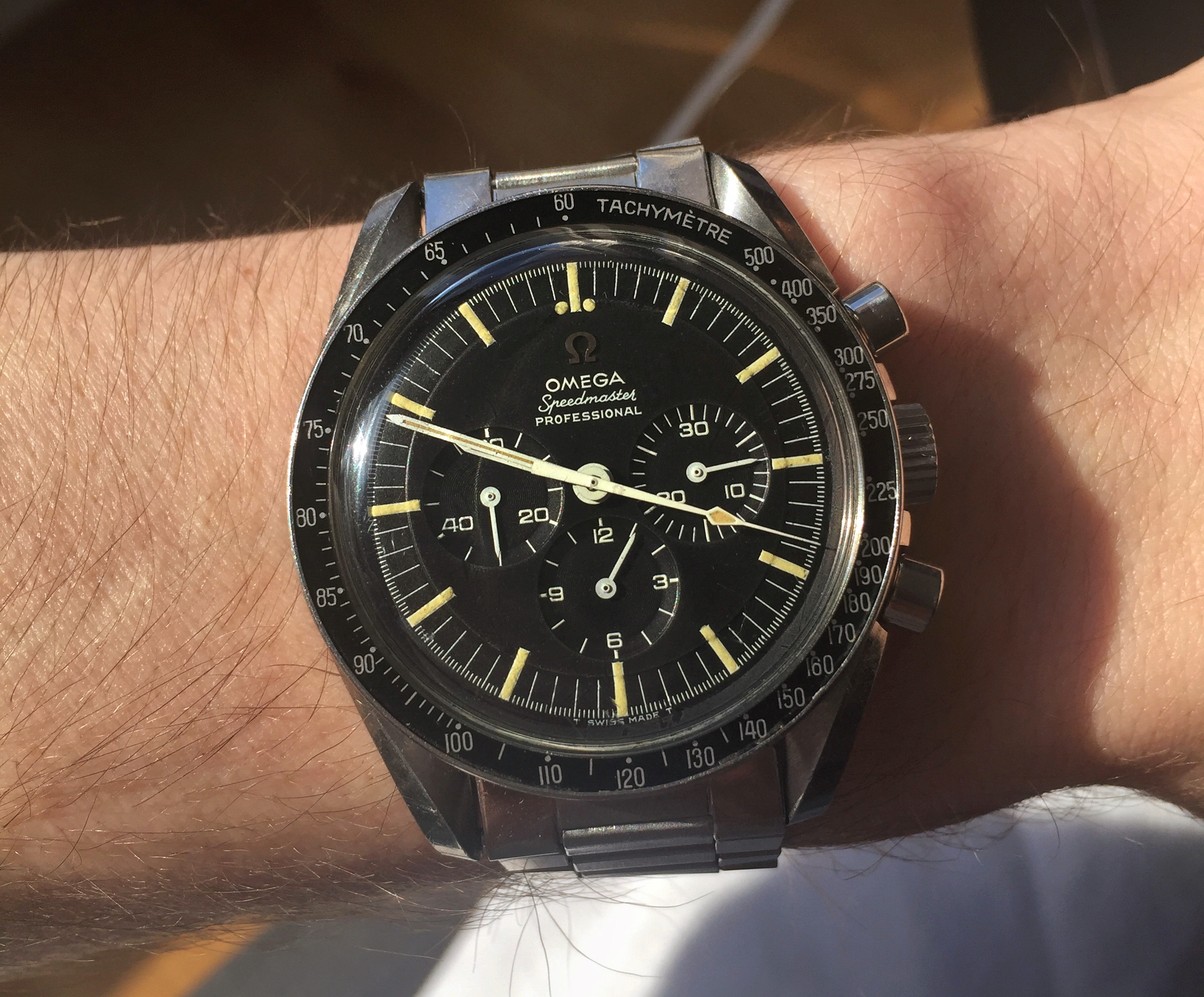

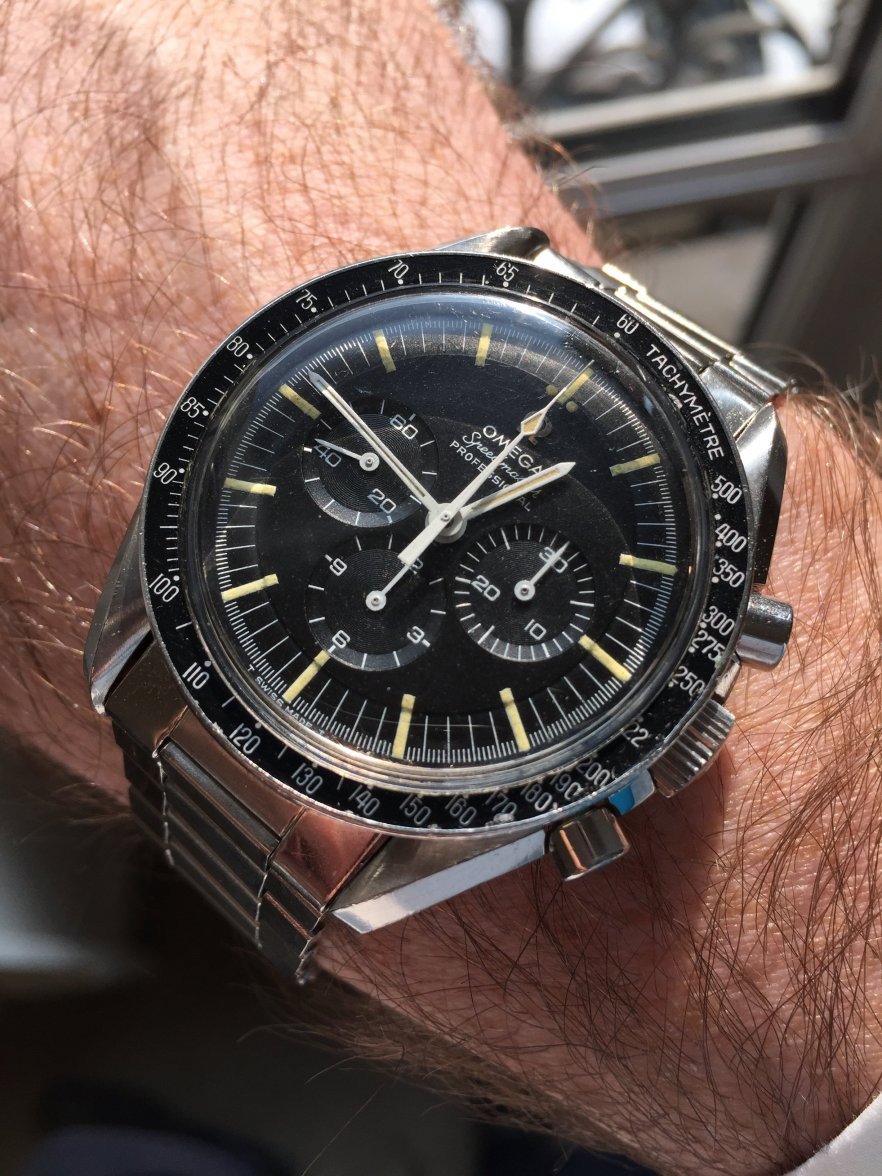

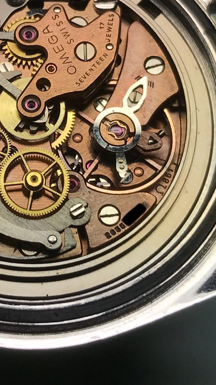

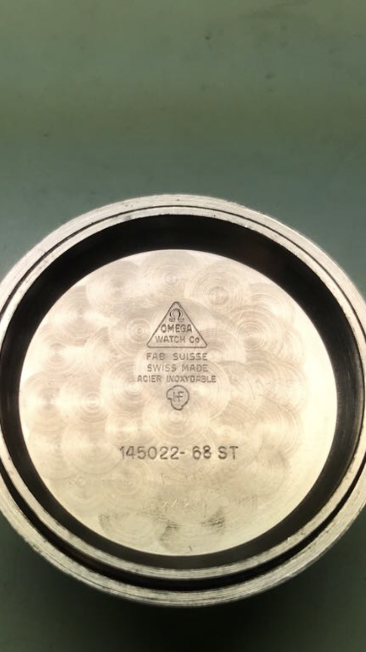

    Now, you guys hooked me on getting into the Speedmaster Game and right now I'm looking at a Transitional. Here is how I see it, but it would be awesome to hear your expert view on the matter.
    - 145022-68 (also stamped in case back)
    - Serial # in range
    - correct 861 cal movement
    - correct, stepped dial with applied logo. (Logo is a little faded, face seems good)
    - correct hands, but chrono hand probably replacement (patina doesn't match)
    - correct DON bezel, but this is probably the most challenging. I'm far from sure whether that is still acceptable condition…
    Price is a little higher than sp101's "good" range.
    Thanks
    fuchs
    IMG_6256.jpg IMG_6257.PNG 7751c5c8-e8ff-4ea7-b272-dc4440c1049a.jpg 26067697_179493656120127_1327587722772086784_n(1).jpg

    This 68 looks OK overall, all period correct. The dial looks very good with matching lume, which is cool but raises a bit of a question on the lume colour (I haven't seen many 68s with a greenish lume) so just make sure (via UV lamp, macro shots) that it has not been relumed. If it has been relumed, it does not mean that the watch is worthless, but it will have an impact on value.
    The movement is clean even though some screws are a bit chewed, but nothing major, the pushers seem OK but no info on the crown. The DON clashes with the rest of the watch, it's a bit knackered vs the clean dial & case.
    I'd say that the one major element lacking from these pictures is the state of the case: it does look OK from the pictures but you can't know how the sides look...
    Finally, the watch looks nice but not "good", or at least the bezel doesn't look good. The dial does, provided that it has not been touched up.

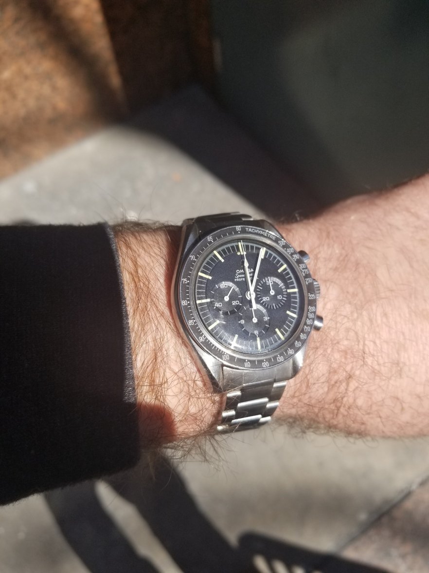

    Another - 68 to compare lume colour.
    Edit to add that I think the light hello lume colour is more common on these later references whereas the darker Brown colour appears more often on older models.

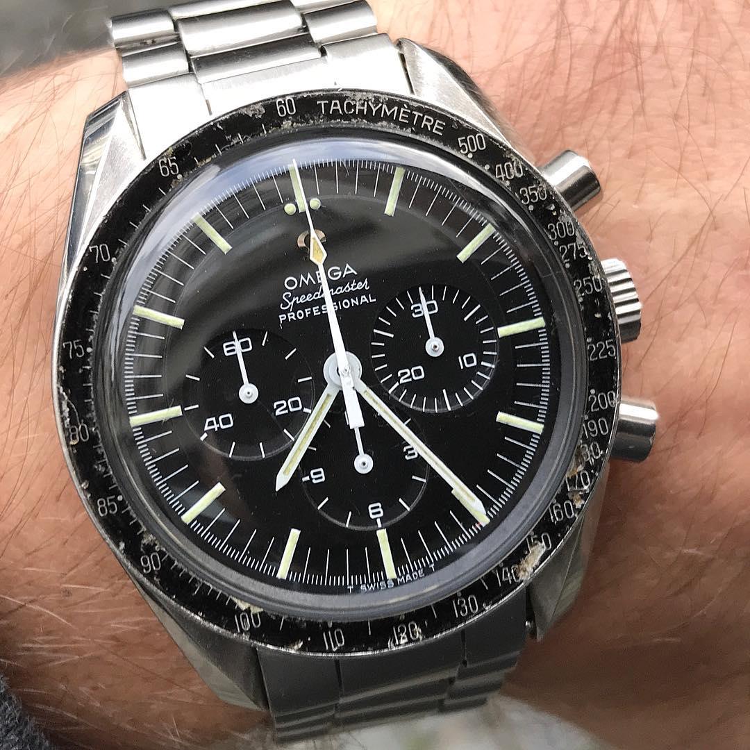

    My 145.012-68 for comparison, since we're showing ours off :D
