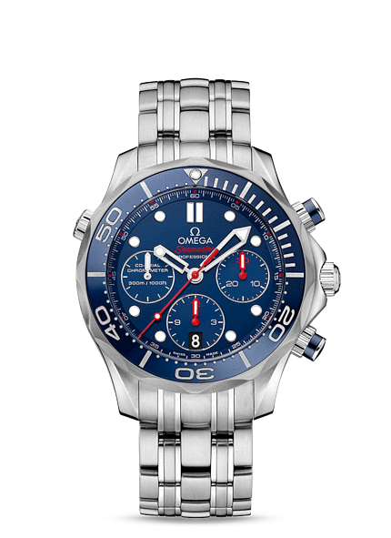

  14. Prieto9000 Sep 21, 2013
    345
    1,722
    I´m really confused right now. For what I can see the 1164 has the inside markers aligned vertically on the opposite side of the crown. When I went to the store the salesman showed me one that had the markers on the bottom like the one on dsio´s picture and told me it was the newest version of the seamaster diver 300. Taking a closer look at the picture of the 3330 on Omega´s website I can see that in one of the markers it says Co-Axial Chronograph.
    What is the MSRP for the 3330??

  16. Archer Omega Qualified Watchmaker Sep 21, 2013
    26,343
    65,047
    Maybe you need to contact the store and get the reference number of the watch you were looking at to be sure which version it is.
    The 3330 has the small constant seconds at 9 o'clock, the hour counter at 6 o'clock, and the minute counter at 3 o'clock.
    The 1164 has the constant seconds at 9, the hour counter at 6, and the minute counter at 12.
    On the 3330, Omega has done some jigging of the minute counter on the dial side with some intermediate wheels to relocate it from 12 to 3, so with the layout changed it has confused quite a few people.

  17. GrouchoM Sep 22, 2013
    127
    96
    Other new "features" of the 3330 model: ceramic bezel, Si14 (antimagnetic) balance spring, free sprung balance, lumed hands on the subdials, lacquered face instead of the wave pattern, 4 year warranty instead of the 2 year, continuous (non jump) minute counter. These may or may not be improvements; it's subjective.
    By the way, the 3330 lists for $6k.
