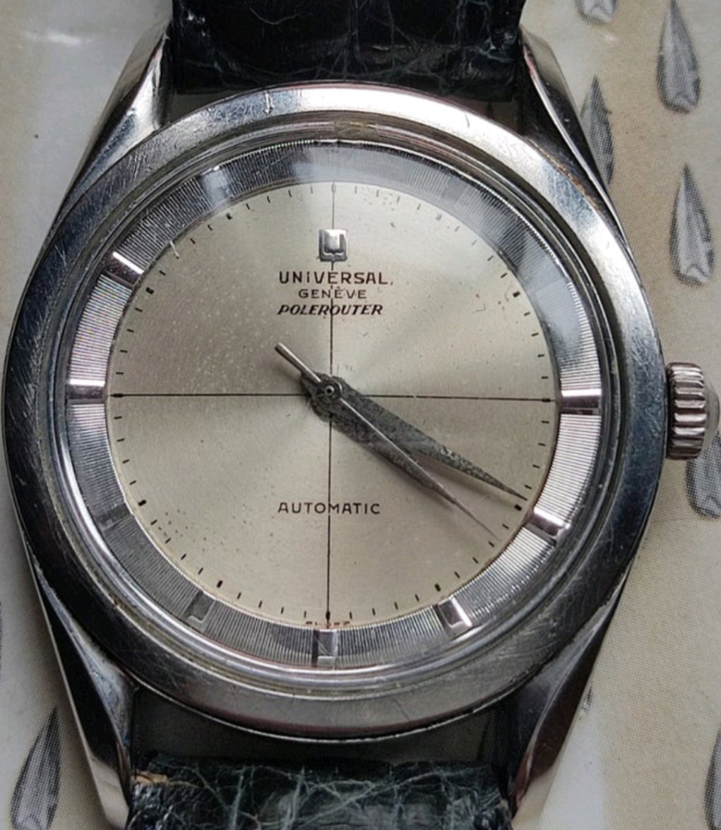

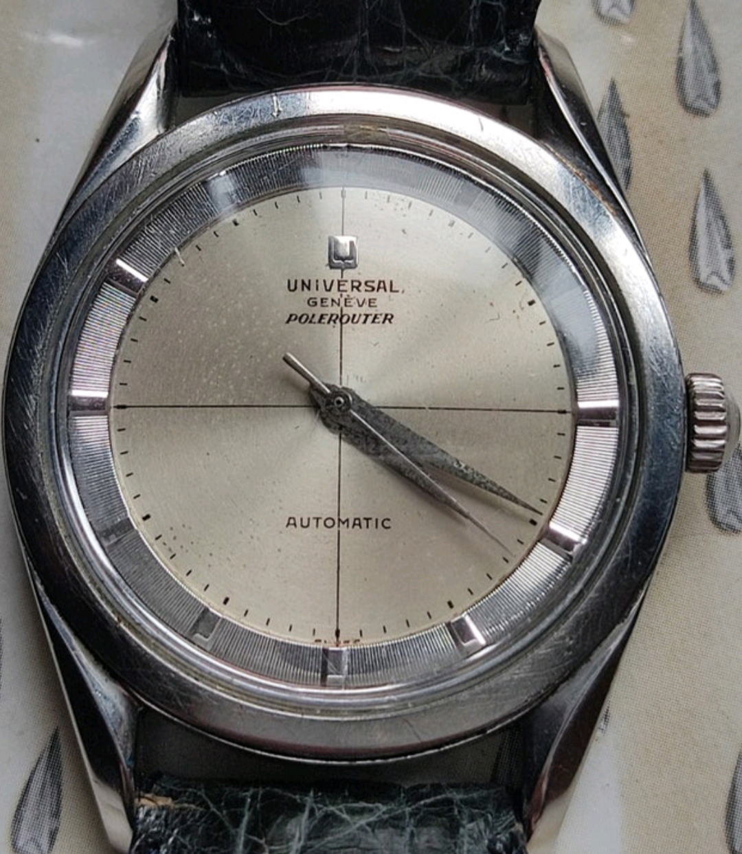

Good morning. I am asking for help regarding this polerouter dial. the reference is 20217-3 therefore without tritium. Today I compare a series of dials on the web and everything seems to be in order (fonts, lines, etc.) I ask for an opinion from the more experienced. Thanks in advance
4,010
45,007
Do you have other pictures? Maybe higher resolution and with hands not all placed together.
As @Gav1967 said, you definitely should refer to the Polerouter website.
Hard to tell based on that single picture, my first impression is that the minute marks should be nearer to the silver ring.
I also find the font to be a bit too thick, and I don't like much that S shape of the Universal.
Other experts will hopefully provide better input.

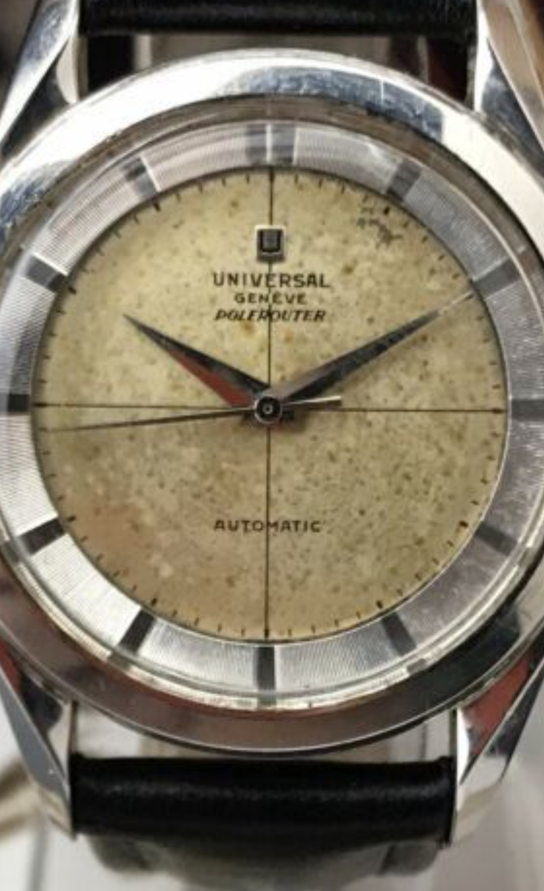

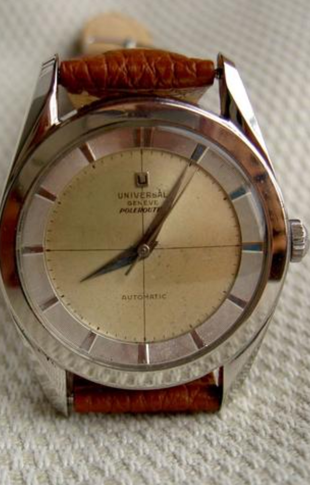

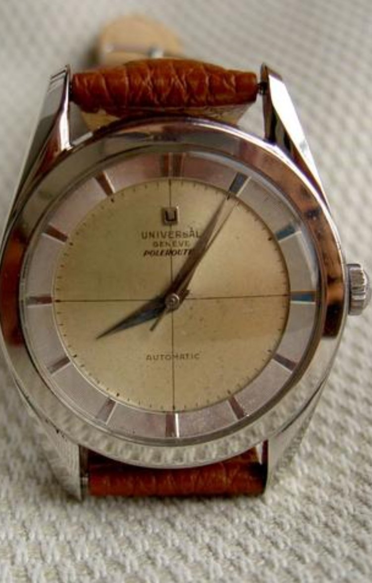

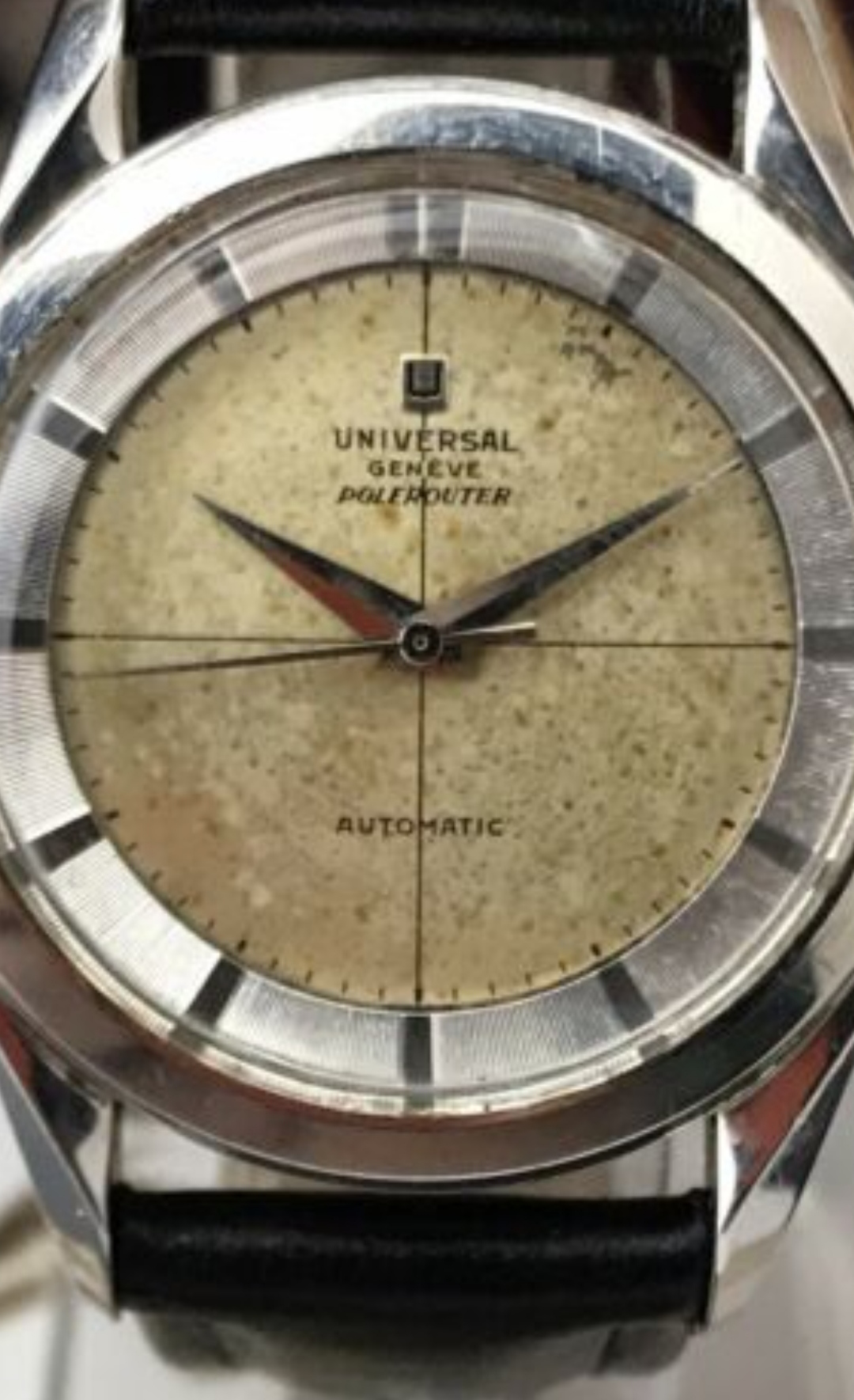

I compared fonts and indexes with these two and honestly I don't see any differences. what do you think?

What do u think about the dial?

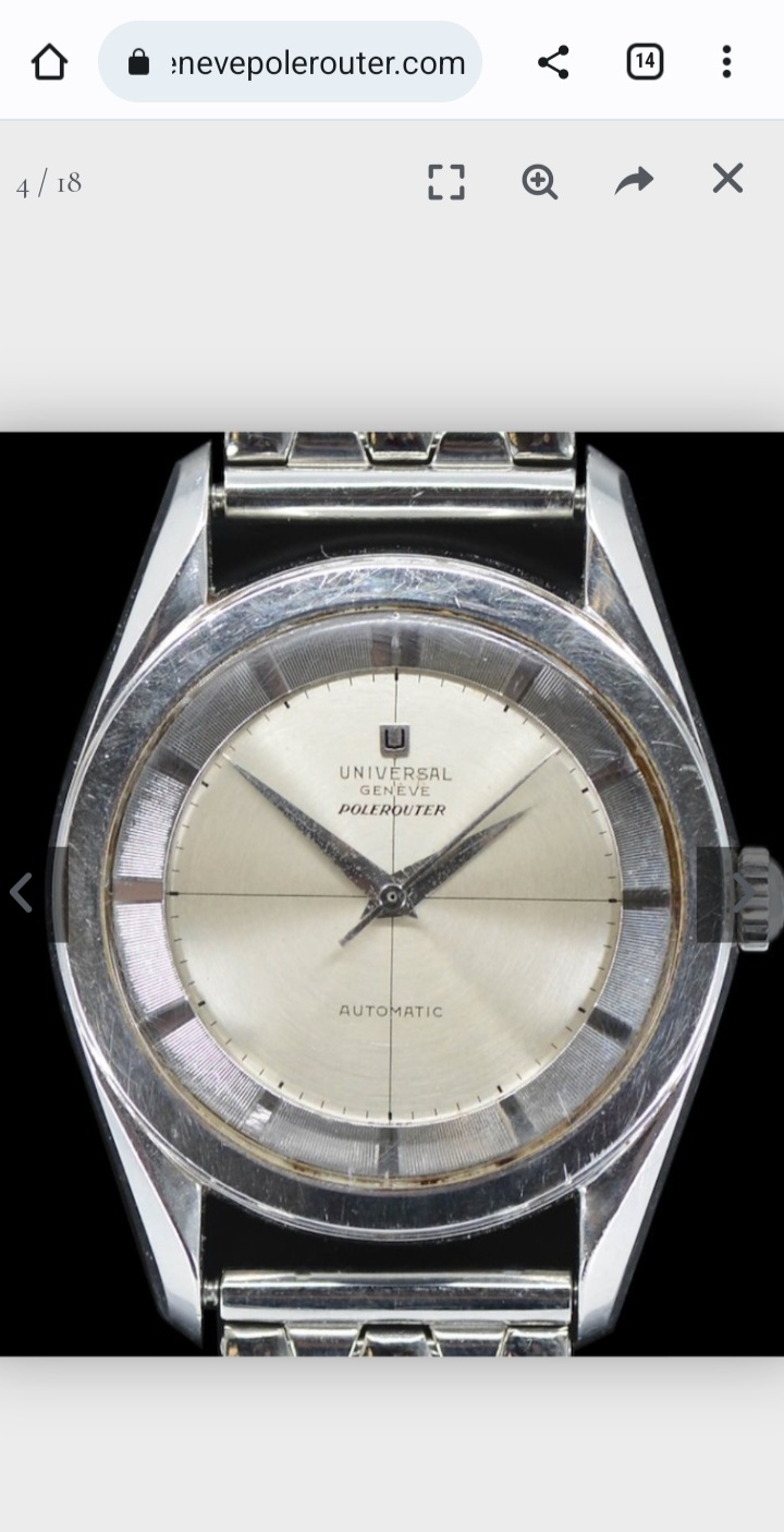

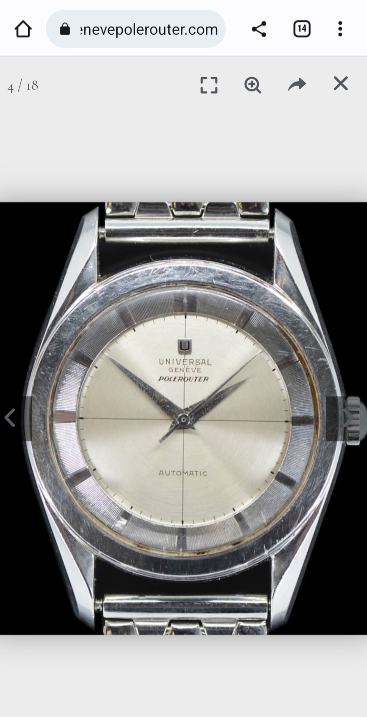

There are much better experts than I am on OF such as @Mazoue who may give n opinion. For my eyes the thickness of the cross hatch lines and boldness of some of the type on your picture makes me a little suspicious when I compare to the one below
Original IMO
And @CafeRacer surely could provide valuable feedback
