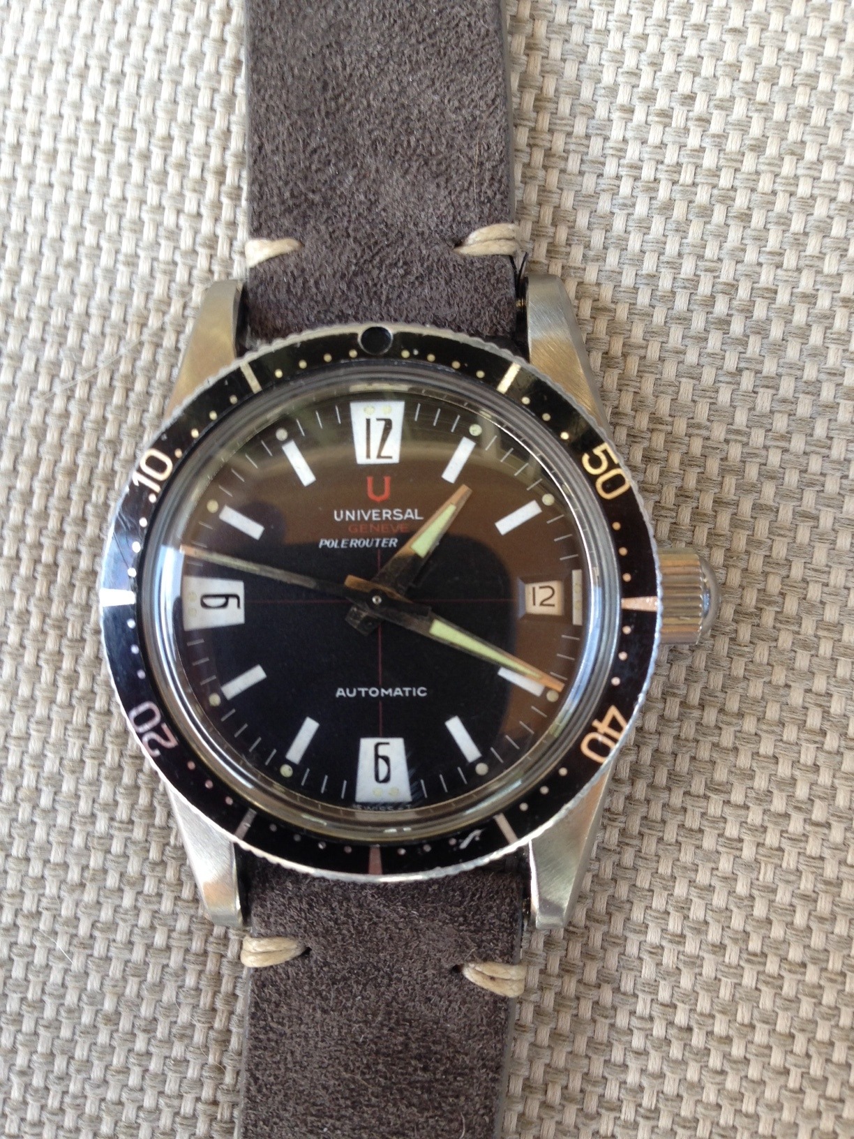

  7. Escargot Man, look at that S car go! Sep 7, 2014
    36
    6
    Bluepoint, if this is a pic of your watch, where did you get the strap? That looks comfortable.
  8. ELV web Sep 7, 2014
    2,668
    24,651
    I assume he got it from Matthew Bain, I used to buy a watch from bain too and it came with the exact same strap, but there was nothing written on it to explain its origin.
  9. Bluepoint Sep 7, 2014
    61
    344
    You are correct. I did purchase it from Matthew Bain. There is nothing on the strap that would indicate who made it.
