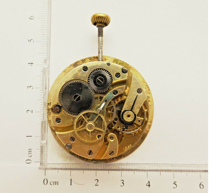

Great article Tony! I suppose that centre second cal 37.9 must be rare. Are most of them 12.68z calibre?
7,994
28,030
Depends on the era. Here are some early calibers:
2,804
4,886
Centre second caliber 37.9 are not common, though they are what was used in later 47 mm Lindbergh and Weems, and in the Swissair. They probably could be described as rare in other applications such as pocket watches.
When you write, "most of them," to what are you referring? Centre second caliber 12.68Z (not to be confused with caliber 12.68N) are somewhat uncommon in wristwatches, and I cannot recall if I have ever seen one in a pocket watch (not to imply that the watch you posted is incorrect). Do you have photos of the dial of that pocket watch? It is quite an intriguing piece.

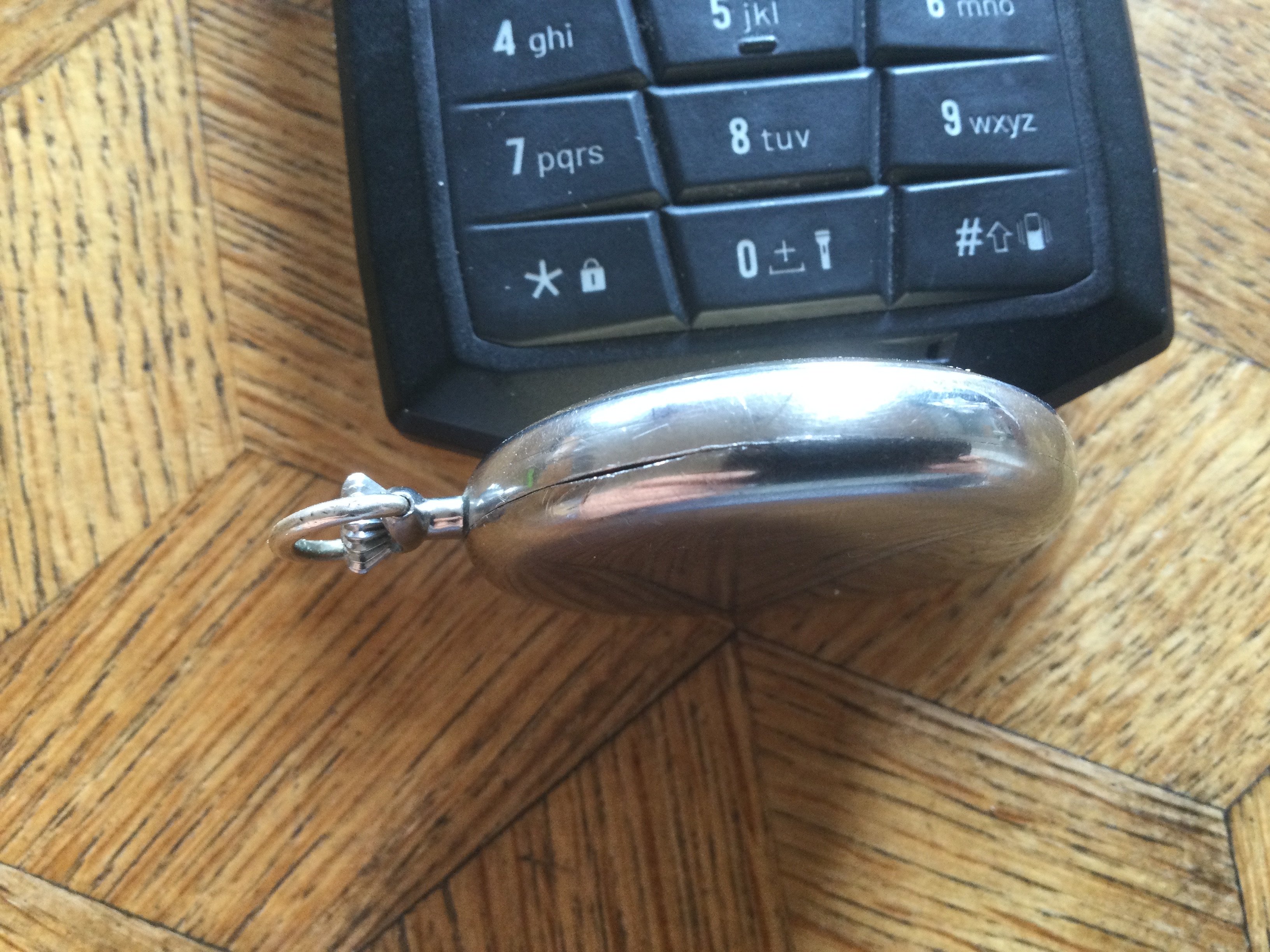

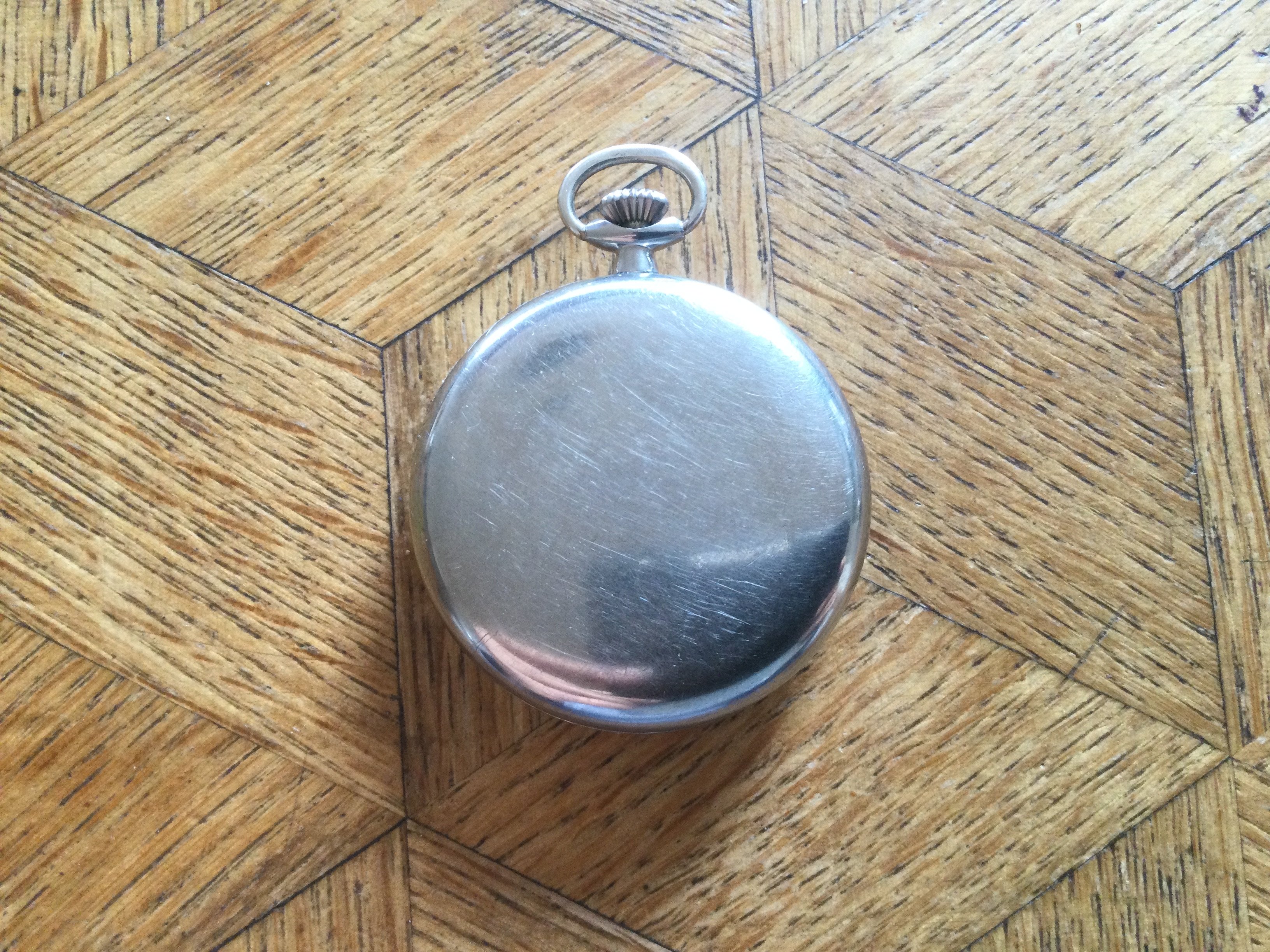

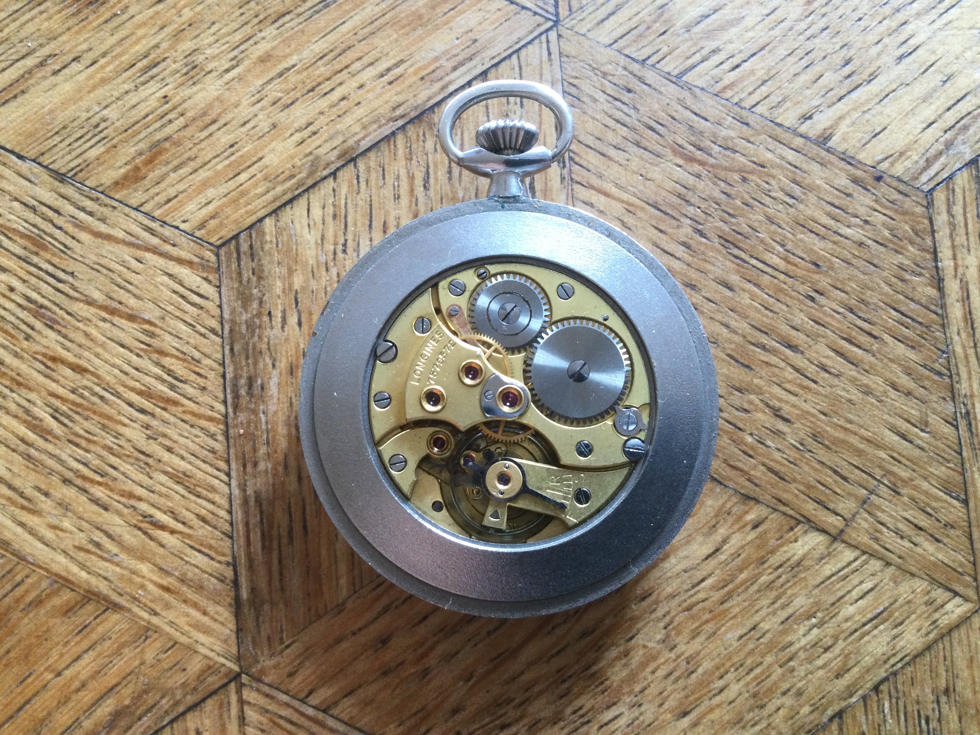

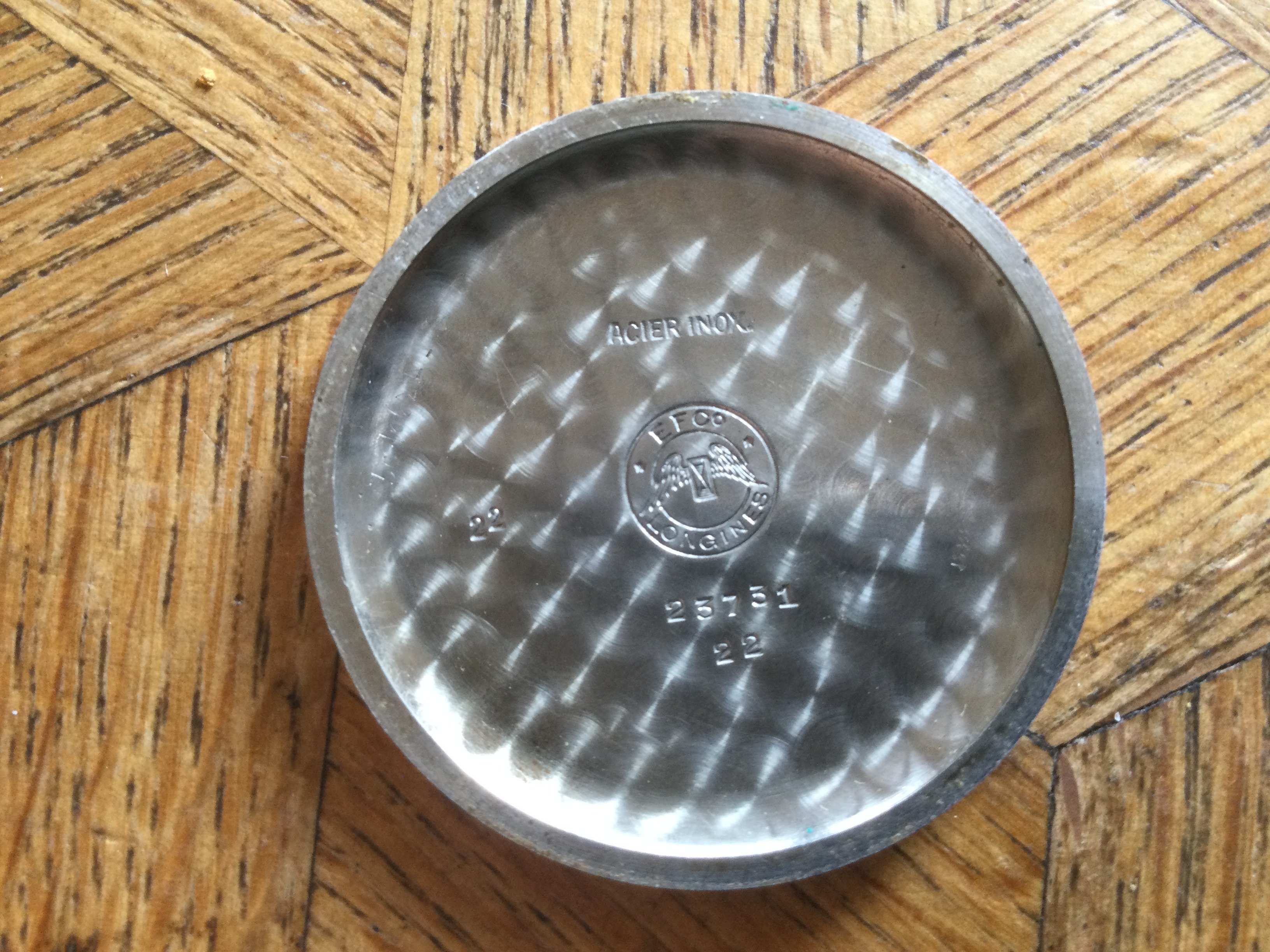

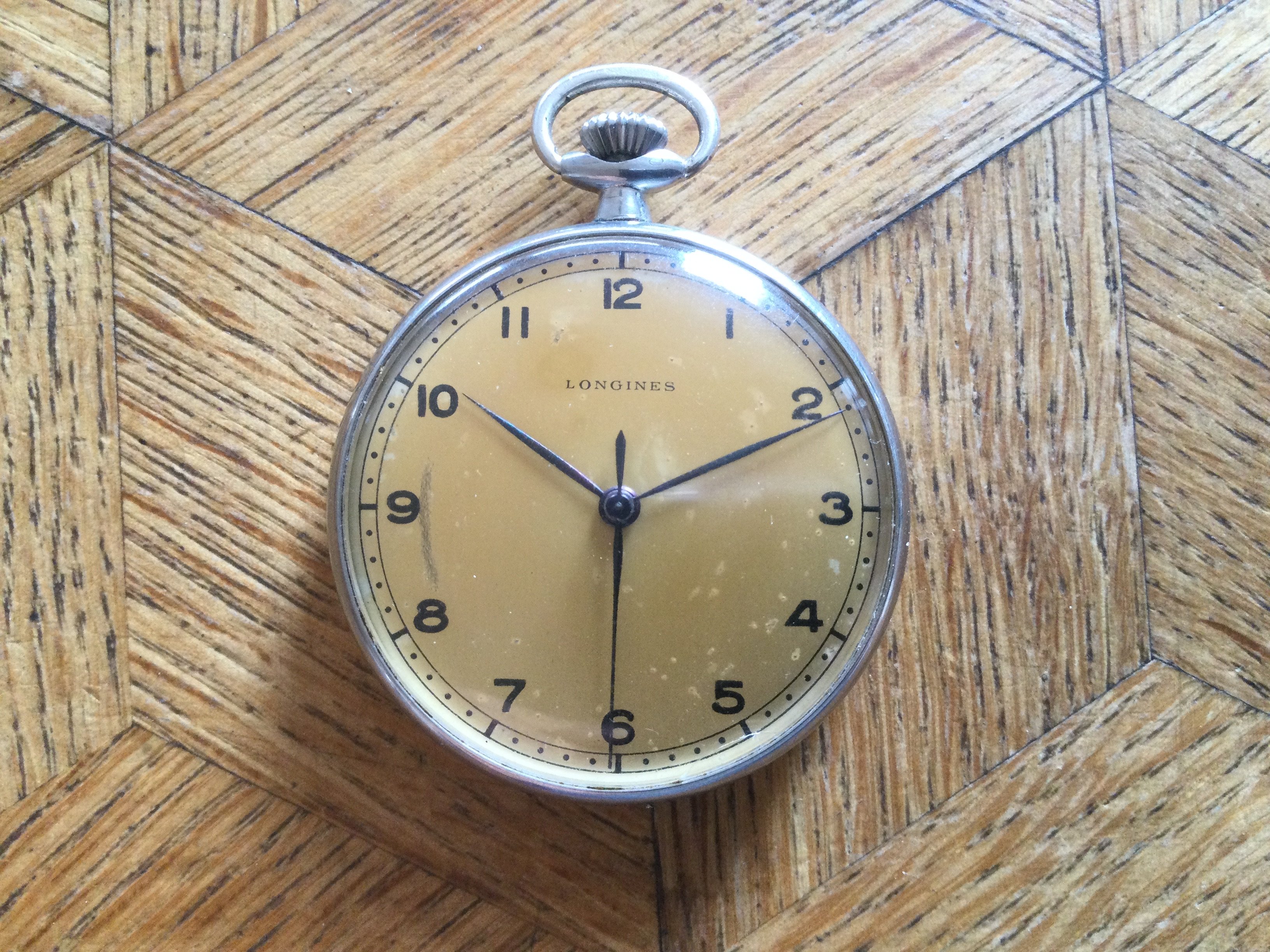

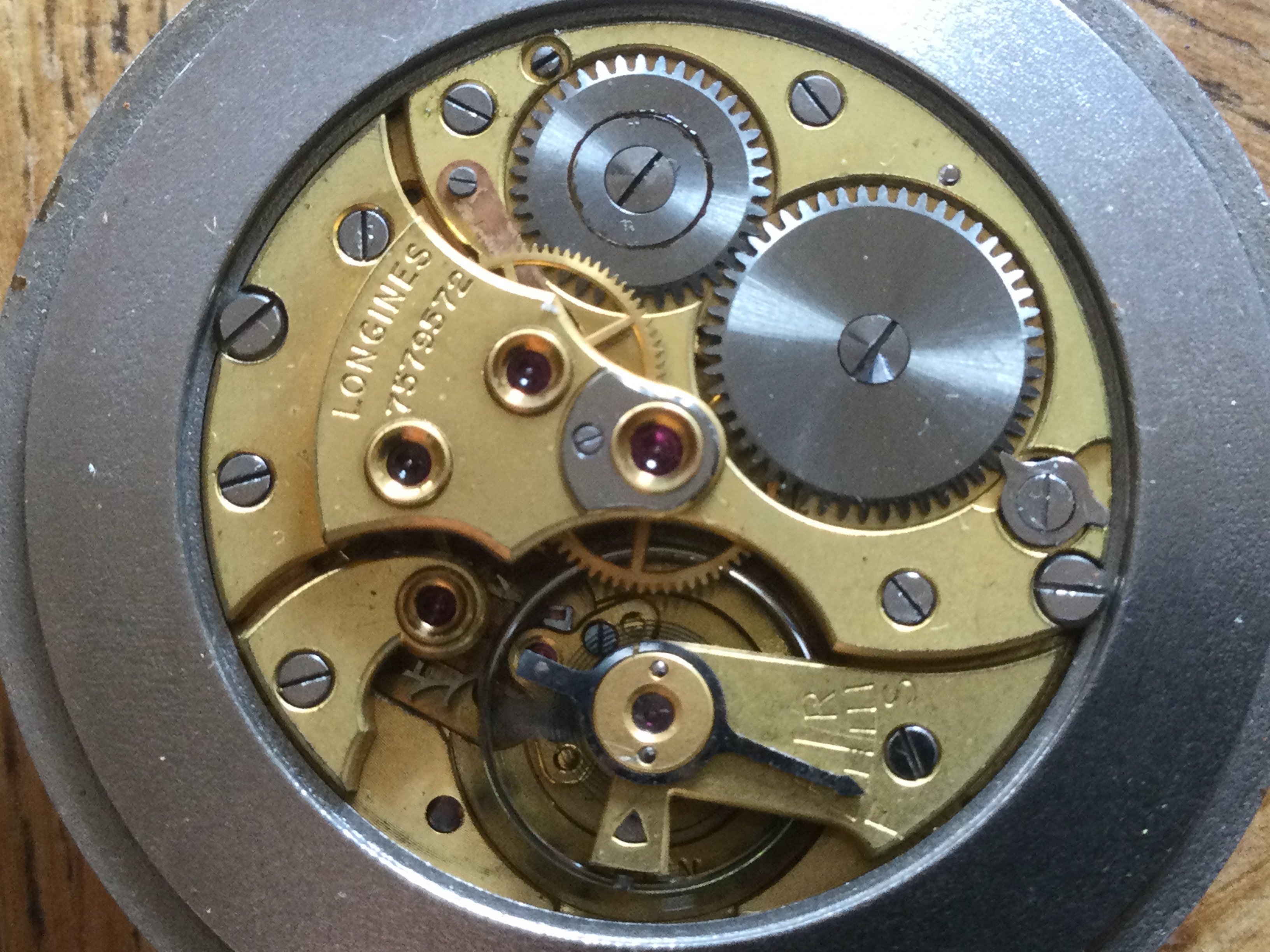

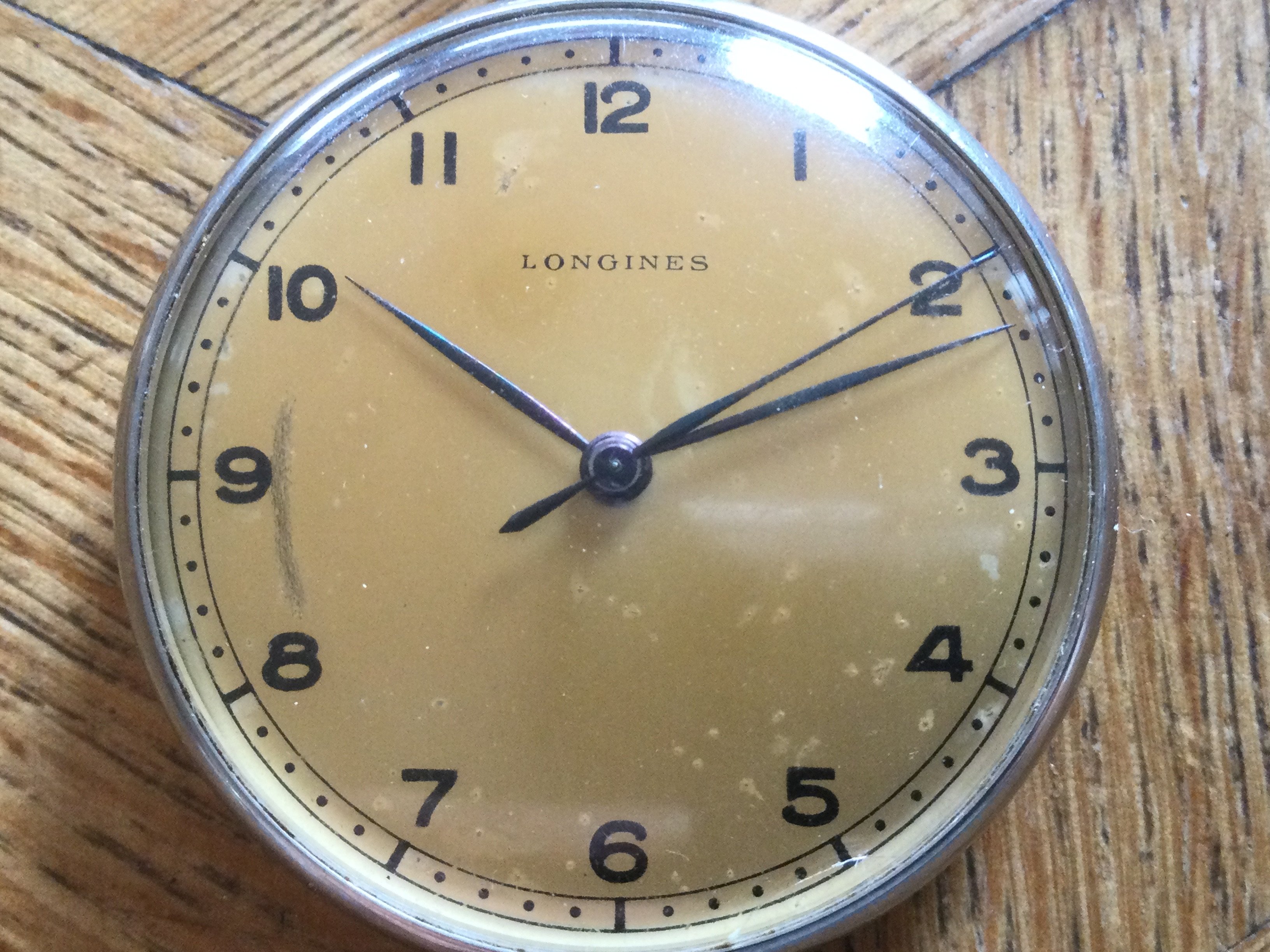

Here is a Longines pocket watch with cal. 12.68N. It is 39,8 mm. in diameter. Reference is 23731 with a serial number 7.579.572.
I have no other information.
If you have additional information, please share.
