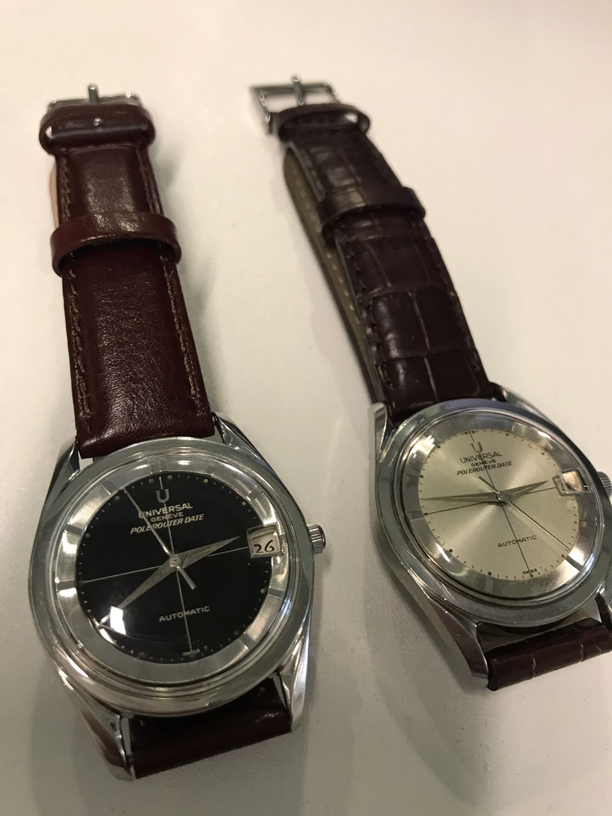

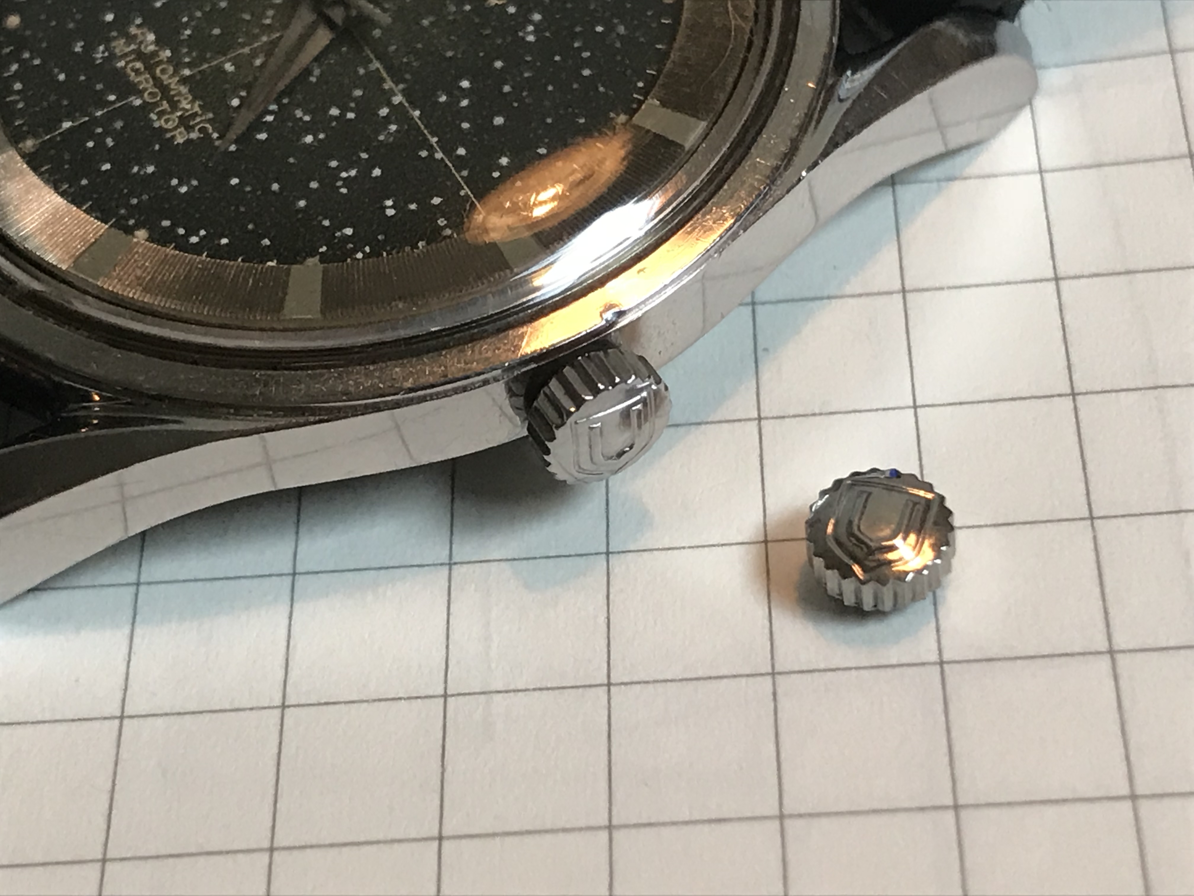

I recently acquired not one but TWO UG Polerouters from separate individuals through OF.
The black dialed one obviously came with an incorrect crown. Seller provided an original crown as a replacement but did not have it installed. I brought it to my watchmaker to have it replaced only to realize he could not because the winding stem installed was incorrect (too short).

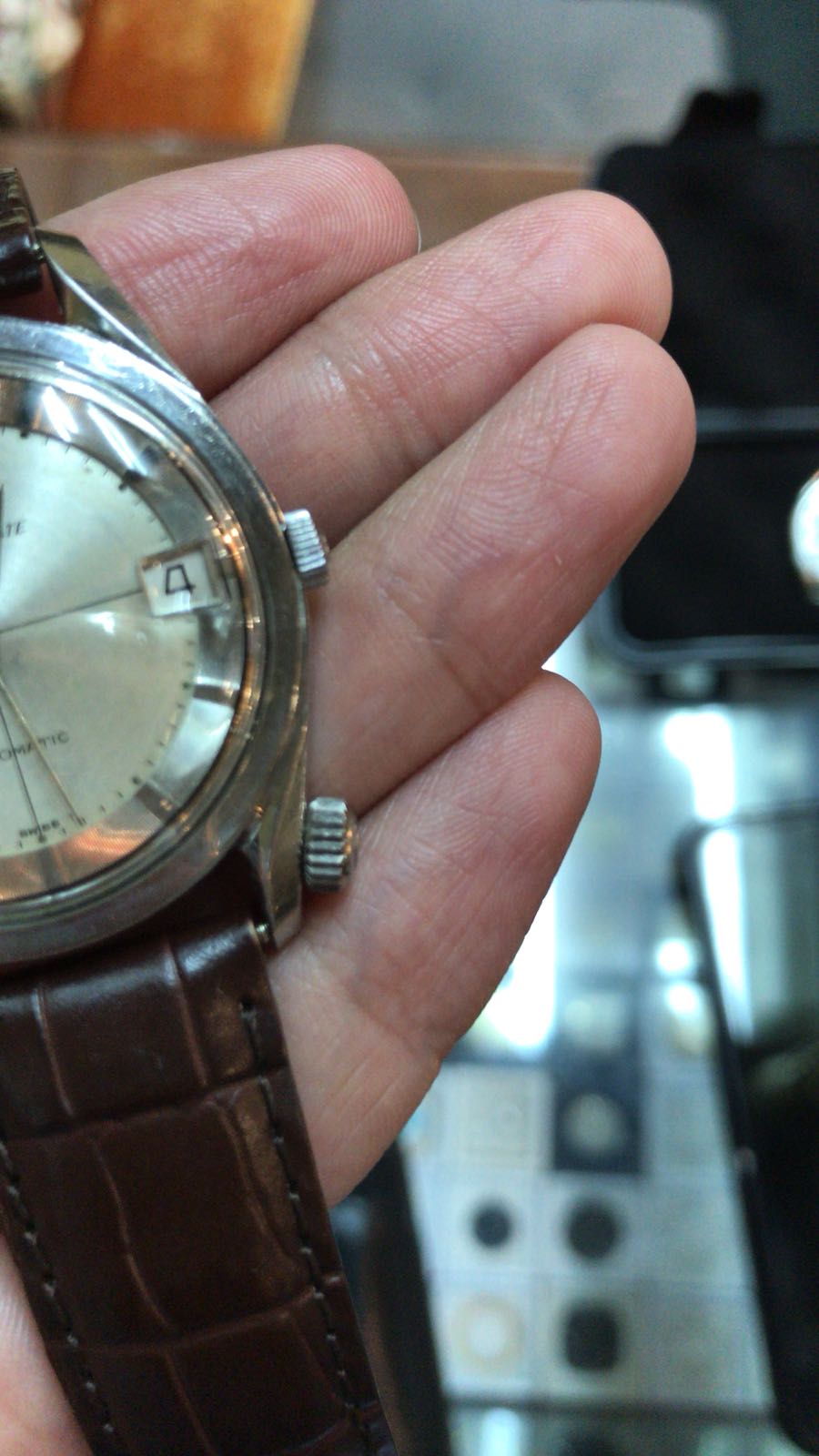

That made me question the other Polerouter I had received as well. The Silver dialed one you see in the pictures. Compared the 'original crown' provided by the seller of the black dial Polerouter with the crown that was on this silver dial piece. Thickness was different.
My watchmaker insisted the only crown original to these Polerouters was the replacement one I have. So both crowns currently on each of the Polerouters are incorrect.
Can someone shed light and share? Would love to finally understand if any of these are correct at all? - Source two correct crowns/stems for these beauties. Or in the worst case, return the watches to the sellers.

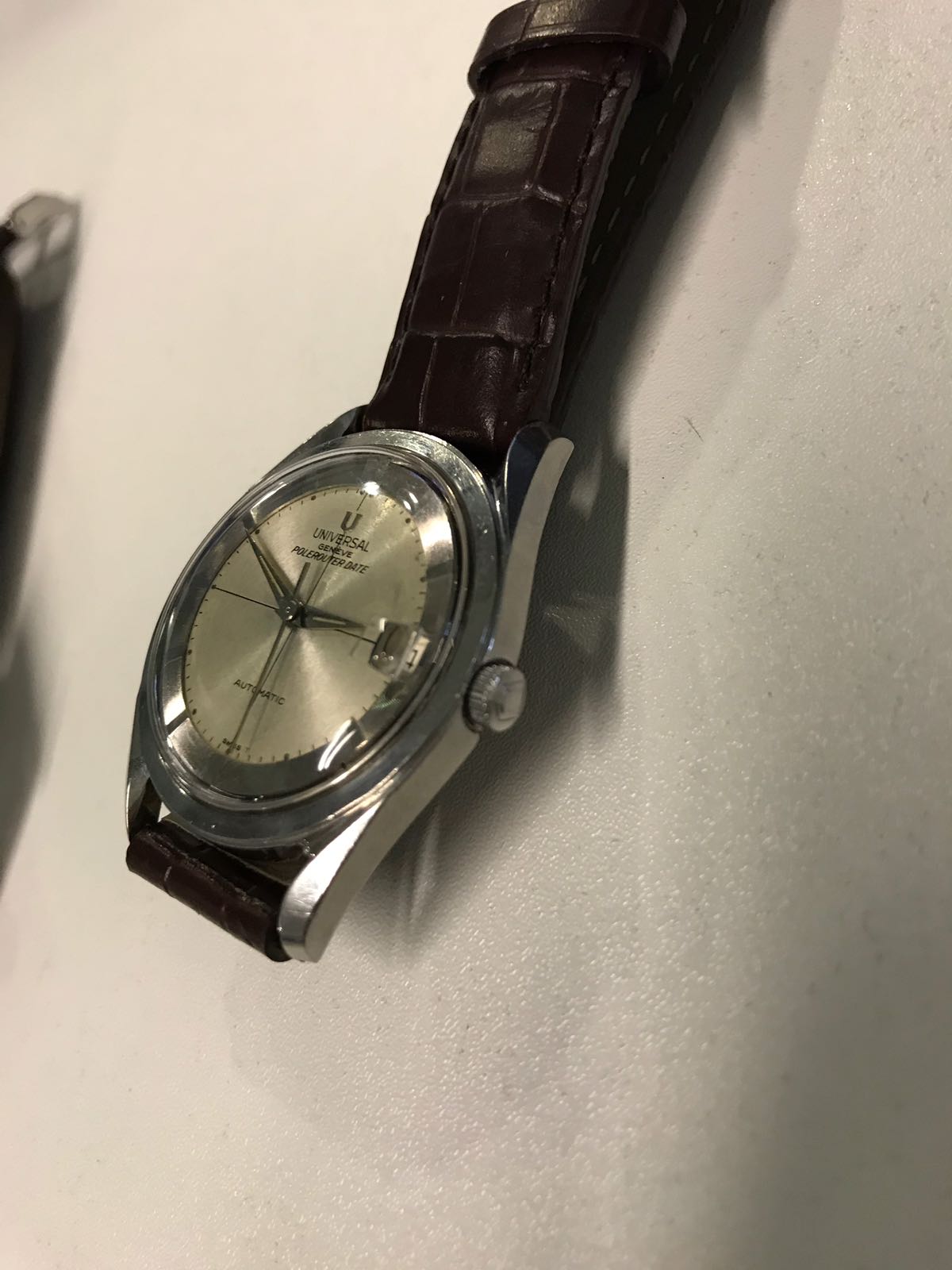

I would tend to agree with your watchmaker. I think both crowns are wrong. The crown currently on the silver dialled watch looks to be too thin but also not wide enough as it looks to be quite a bit smaller than the recess in the case.
I think the original crowns would have been one of the two types shown and discussed in this thread
https://omegaforums.net/threads/2-polerouters-arrived-today-215-vs-218.40591/
Good insight. Thanks @Mazoue !! Will probably have to start sourcing some crown/stems. Where best to look? This seems to be the best place. If anyone has extras!! Let me know.

Are crystals original with the etched "U" logo in the center?

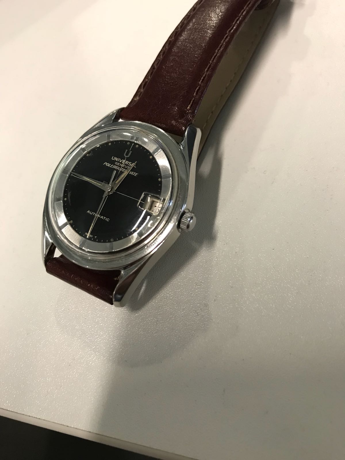

At least, the black one has the logo. Look at pic 3.

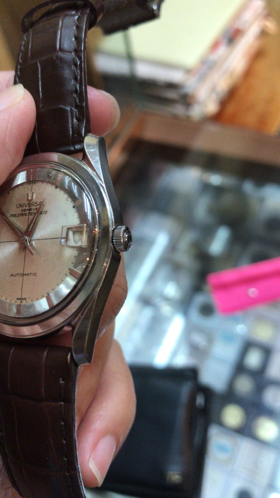

I've had a 215-1 gold capped Polerouter since mid last year and have been on the hunt for a crown from the on.
What you will find is that the crowns need to be recessed in the inner edge so that it fits over the crown tube of the case.
This also means that most of the crowns online, though they may be the correct diameter (4.5mm) will not fit correctly as they are not thick enough.
Yes, the black one does have the logo, signed crystal. The silver one however, I'd argue is original as well? The trapezoid is almost perfect.

A wealth of knowledge being shared here. Big thanks to @gop76
We've found the original stems now just missing ONE period correct original UG Polerouter crown.
I figured where better to ask than OF? If anyone happens to have a spare.. please let me know!

Apologies for the late input Xeer - The first crown is correct if the case reference is 869111/02
The spare crown you have in your hand looks to come from an 869113 or 204612 reference.
