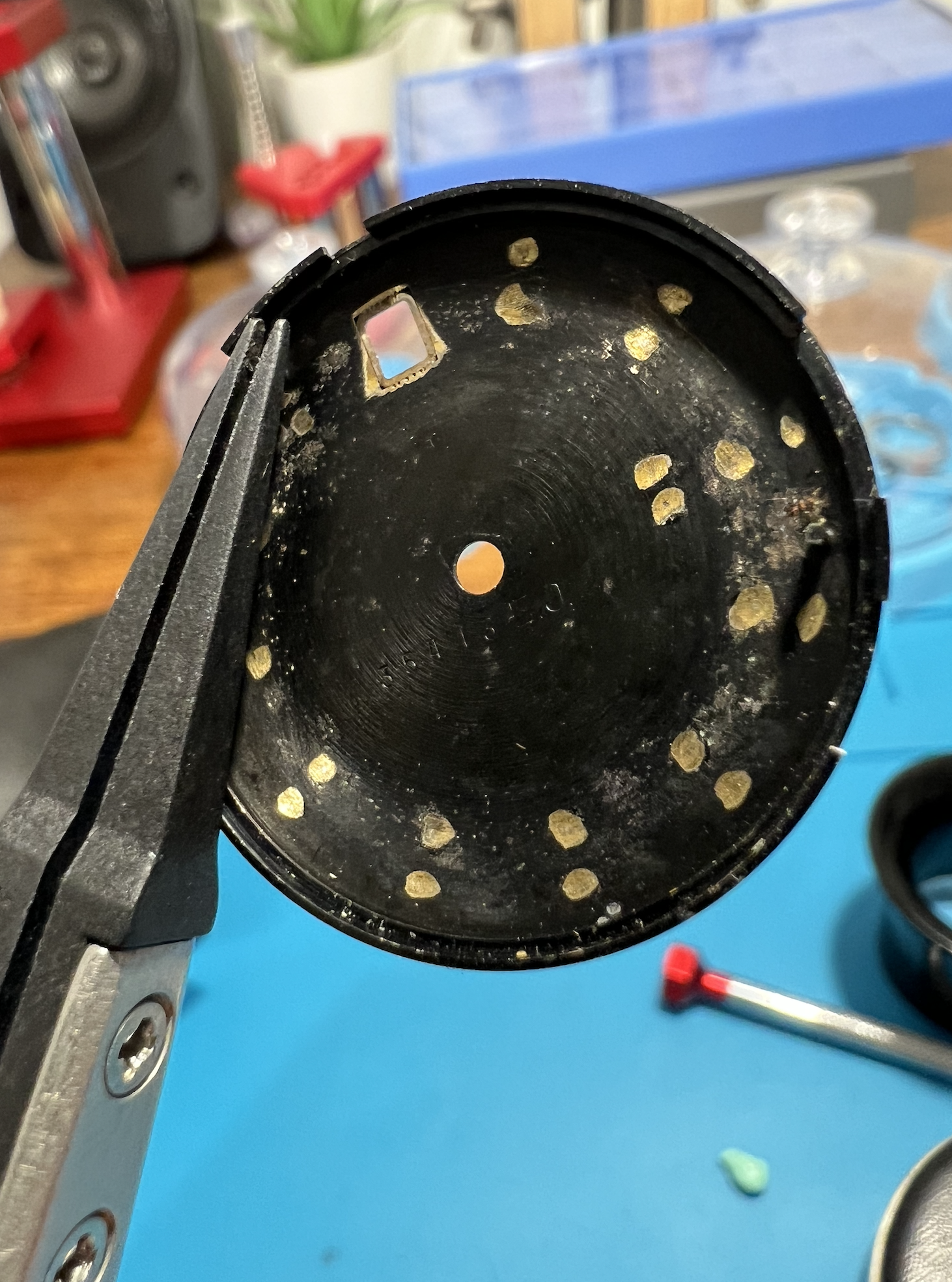

The dial on this thing is also unlike anything I've seen. I have a hands puller just for patinated dials but with this dial that has the spacers integrated to the dial itself, I couldn't think of a safe way of locking the movement while outside the case. Best idea I had was to remove the crystal and use the case as a holder, to be able to pull the hands without touching the dial
Anyway when the time came to re-lock the dial, it was another challenge inserting the dial screws, and again, one slipped and fell, this time slowly and it fell near me.
I started sweeping again and to my surprise I found the pallet fork bridge screw, yet the dial screw was long gone, decided to let go and used one from another donor

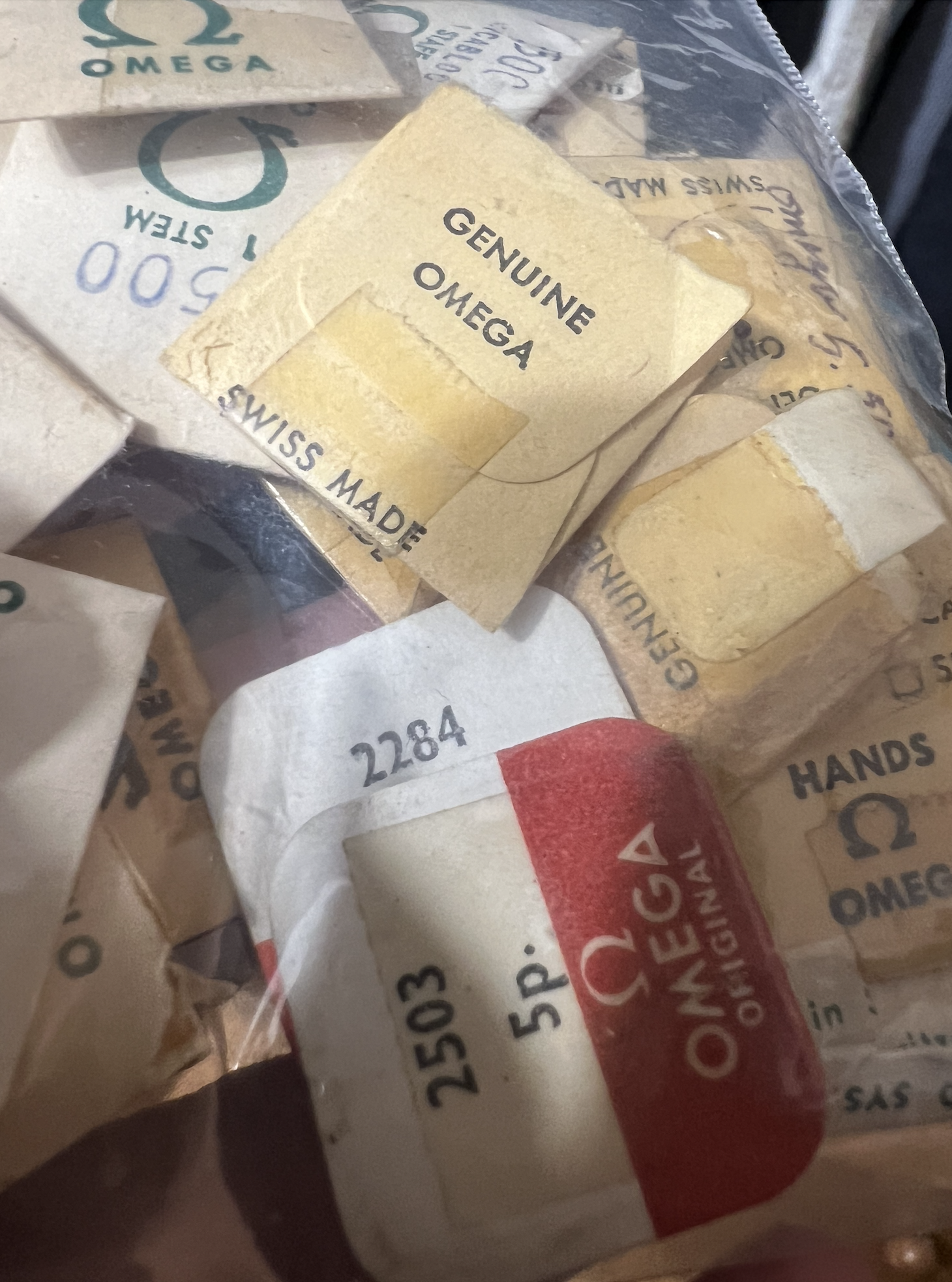

Luckily on my pack of random parts, I found a bunch of dial screws!
I don't have an idea yet how these differ and why there are multiple dial screw numbers for 550 series, but at least I can forget about that little screw

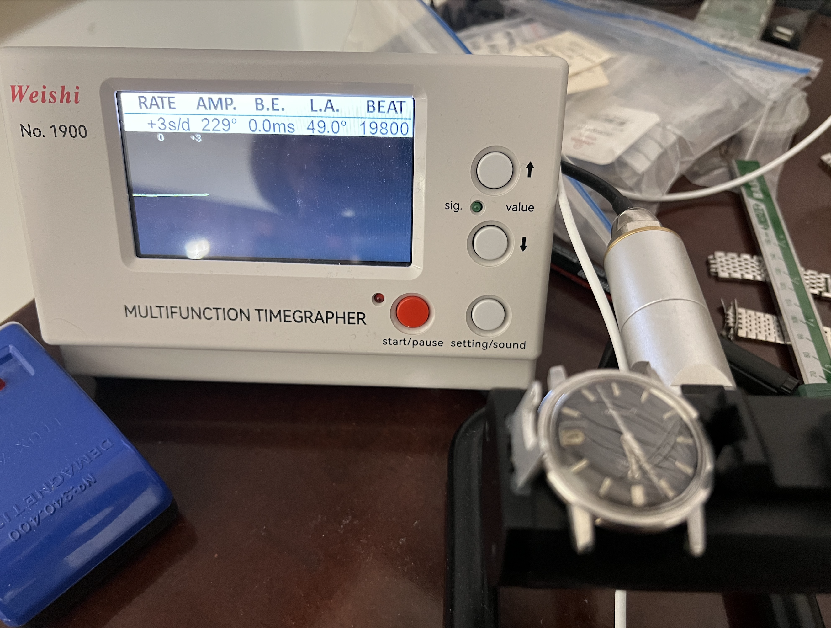

The watch ended up pretty satisfactory for my low performance standards, ordered a light grey strap I've been eyeing from Nomos and excitedly waiting for its arrival! (They have free Fedex shipping!)
