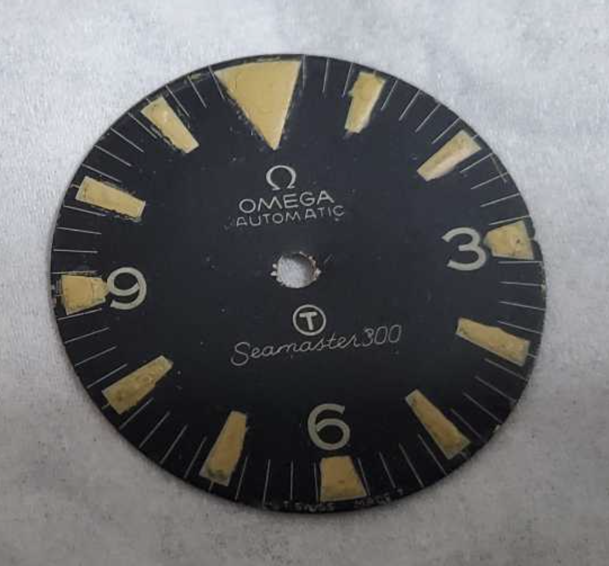

Hi everyone,
I recently bought a 168.029 dial just to have a project dial around, there was a bunch of other dials in the pack that I didn't pay attention to, one of them is this dial that now piqued my interest
Is it genuine, does it have any value?
Ignoring the condition, just a surface look at the guides online, the 9 and 6 seems to close too tightly - would be nice if it's value would offset another unnecessary bad purchase of mine 馃榿
Looking at it now, the "m" looks very weird, even though I found this example with the same "m"
Can I cross "Buy a re-dialed SM300 and sulk" off my bucket list with just this dial 馃榿

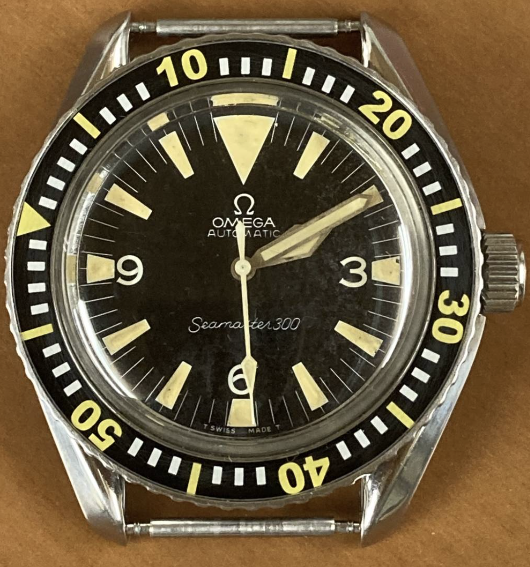

...........even though I found this example with the same "m"..........
and it also has the same stubbies.

Fake. Stubbies, poor lume, bad printing. Toss it.
you bought it. no need to toss it, if you want a fun project to finish. as long as you do not pass it on as genuine; it will fit . Maybe write on the back what it is.....
