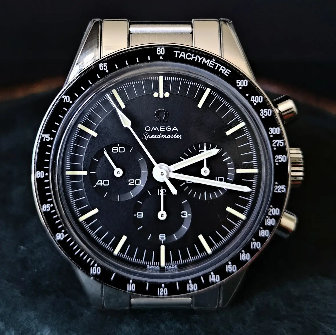

This is my Omega Calibre 321 and I absolutely love it. But yesterday, something happened that genuinely alarmed me, and I’m hoping to get some insight from the community.
I'd previously documented an issue with the chronograph, which I just simply ignore because it rarely happen at all anymore.
I’ve been wearing the watch throughout the whole week, leaving it at 9H (crown down) every night, which I know to be a time-losing position. With this setup the watch averaged an amazing +3.5 spd.
I wore it the whole Sunday and, before switching to another watch in my rotation (the Speedy ’57) the next day, I gave the 321 a brief rinse-and-dry and put it on the timegrapher for a quick measurement. At this point it was about 10 hours after a full wind.

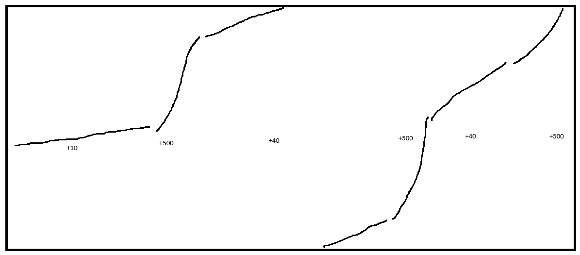

At CH (dial up), it was measuring the usual +10 spd before suddenly jumping to a crazy +500 spd at its peak. My heart fibrillated for a moment…
(I forgot to take a photo of the timegrapher, but it would look something like this, with a lot of frantic dot around the main line as well.)
Naturally, my first thought was magnetization, so I promptly put it on a demagnetizer. NO LUCK.
The next few minutes were a blur. I think I tried different positions, flipped the watch over to inspect the movement, and probably looked mildly deranged in the process.
Then, still in a state of panic, I wound the crown a dozen or so turns - and bam! The timegrapher stabilized again at +11 spd.
I kept it on the machine for another hour before going to bed, and measured again the next morning. Everything looked normal. No more crazy speeds.
Upon careful measurement, I noticed these positional differences:
Before -> After
CH: +10spd -> +11spd
9H: -4spd -> +3spd
6H: +9spd -> +9spd
CB: +14spd -> +14spd
3H: +7spd -> +8spd
12H: -5spd -> +2spd
Most positions remained the same, but the 9H (crown down) and 12H (crown right) positions are no longer negative. I’m 100% sure they were losing time before. I left the watch in these positions for a week each and check the timing differences.
This post has two purposes: one, to share what was honestly a very alarming experience, and two, to get a bit of group therapy and see if anyone knows what on earth happened here.
At this point, I 'm pretty sure I should send it in for service. The issue is that I’m from a Little Red Dot of a country, and the boutique told me the only option is to send the watch to Bienne, with a turnaround time of around 6–9 months…
Thanks for sticking through my ramble. I truly love this watch, so I’m hoping this was just one of those vintage-movement hiccups rather than something serious. Any insight from the community would mean a lot.

Your graph appears to me the watch is knocking due to the balance wheel having too much amplitude. This typically occurs in dial up (or dial down) position and after being fully wound.
29,184
75,412
When you move a watch around, you impart forces to the balance. This can add to the balance amplitude, and cause rebanking - this is also called knocking, galloping (as it sounds a bit like a galloping horse). It happens when the balance turns too far and the roller jewel impacts the outside of the pallet fork horn (where it should never contact) and the balance bounces back faster than the balance spring would normally return it. This leads to a very fast rate.
This can happen momentarily after the watch is disturbed, or it can happen for very long periods if there is another issue, such as the mainspring being too strong, pallet fork jewels not set properly, etc. Based on what you are seeing, this was just a momentary disturbance, so absolutely nothing to worry about.

What timegrapher are you using?
It's a Weishi 1000
Hi Archer 😀 indeed it may seems so. I forgot to mentioned but usually the amplitude I see at dial up is always on the high side around 325~335 (even 340) though this is the first time I saw it translate to this insane rate.
