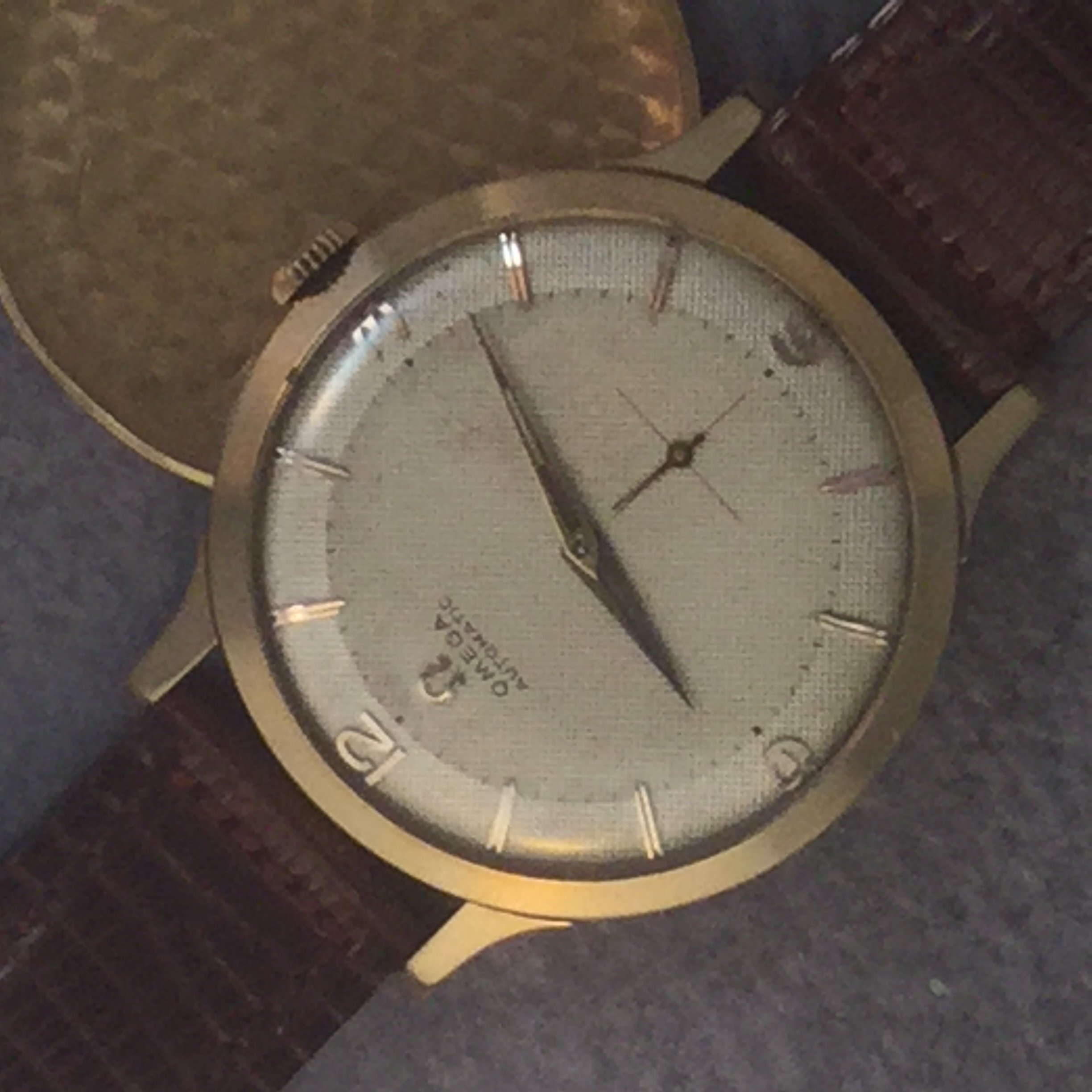

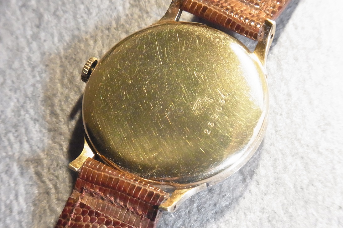

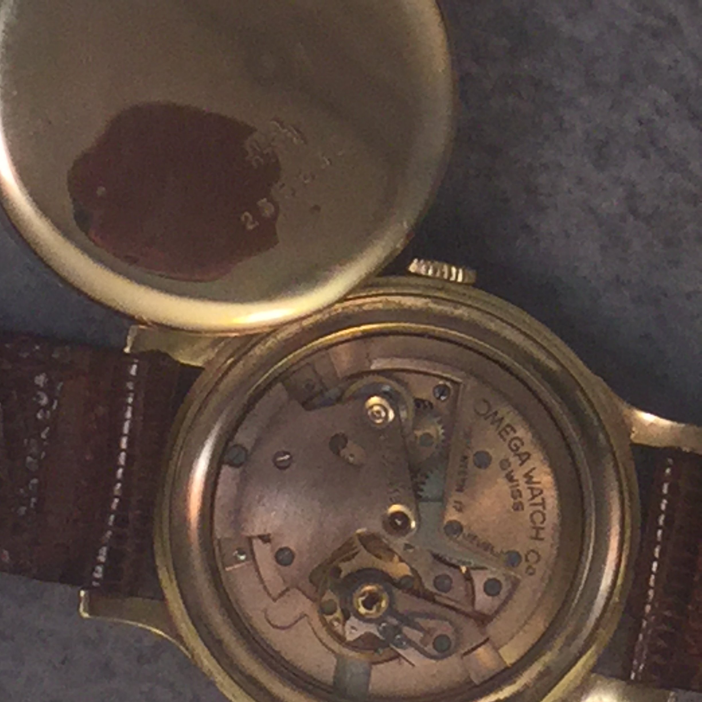

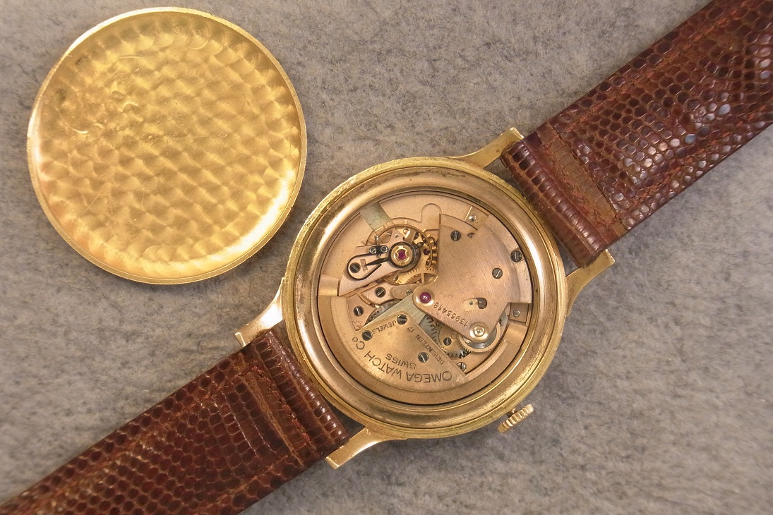

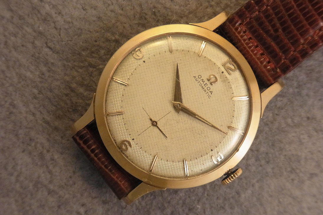

    Hi.
    Any thoughts or insight on this one?
    It belongs to a friend.
    No case ref?
    Cheers.

  2. TNTwatch Nov 17, 2016
    2,876
    1,950
    Not the usual Swiss/French/UK or US case, but purportedly made somewhere in South America. I would get the case checked for gold content if I really like the watch.

  5. TNTwatch Nov 17, 2016
    2,876
    1,950
    I did some research but found no proof that any SA countries actually have had that style of hallmark - which looks similar to part of a Swiss hallmark. That's why I said "purportedly". Best just to test for gold content.

  10. ulackfocus Nov 17, 2016
    25,983
    26,974
    My bet is the watch was cased in Switzerland in a stainless steel. When it got to the destination, the guts were installed into the locally made gold case. These often are real 18k gold, but not completely solid all the way through. Many times the gold is built up around a brass or bronze ring.

  11. Canuck Nov 17, 2016
    13,477
    38,011
    The dial appears to me to be too big for the bezel opening. Something might have been swapped! Dial? Case?
    Northernman likes this.
  12. Northernman Lemaniac Nov 18, 2016
    4,424
    18,135
    Guessing the case, perhaps having been made locally, might be the culprit?
    It could also be the angle/crystal, but it does appear a tad tight.
