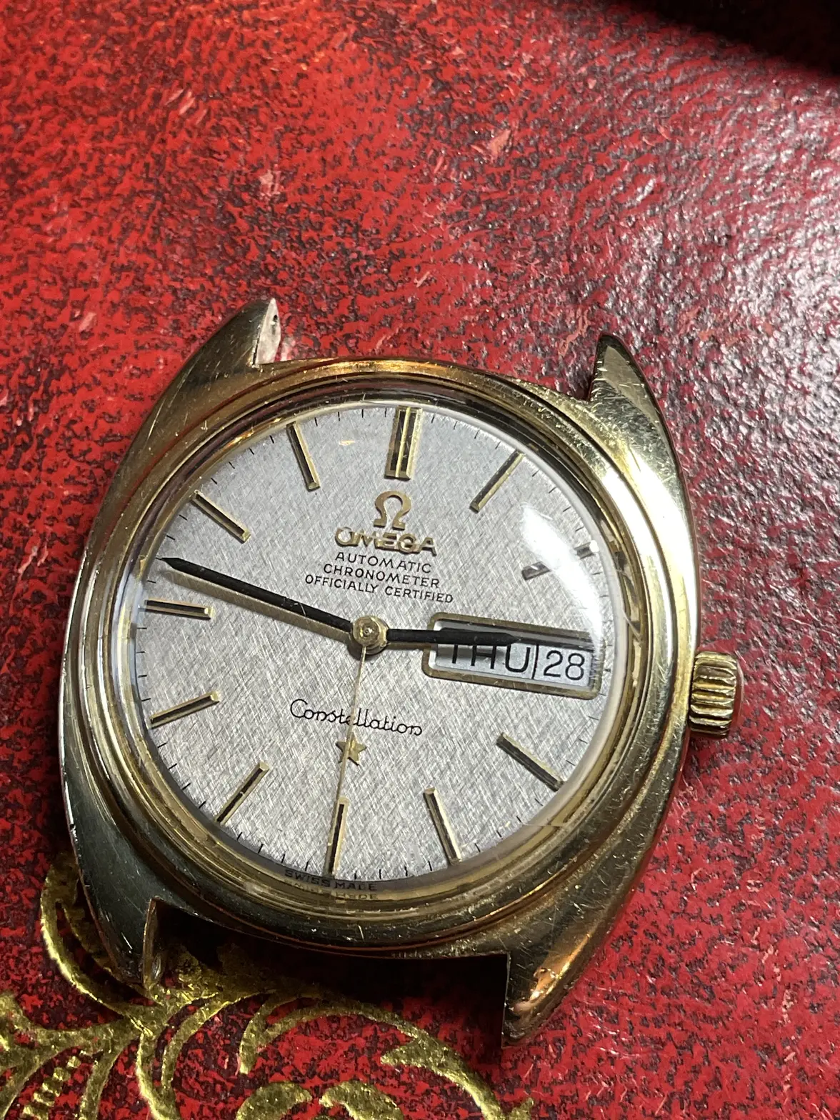

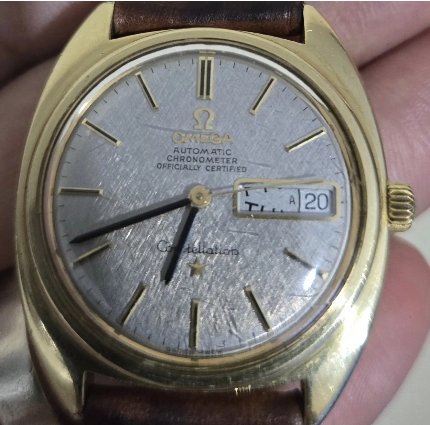

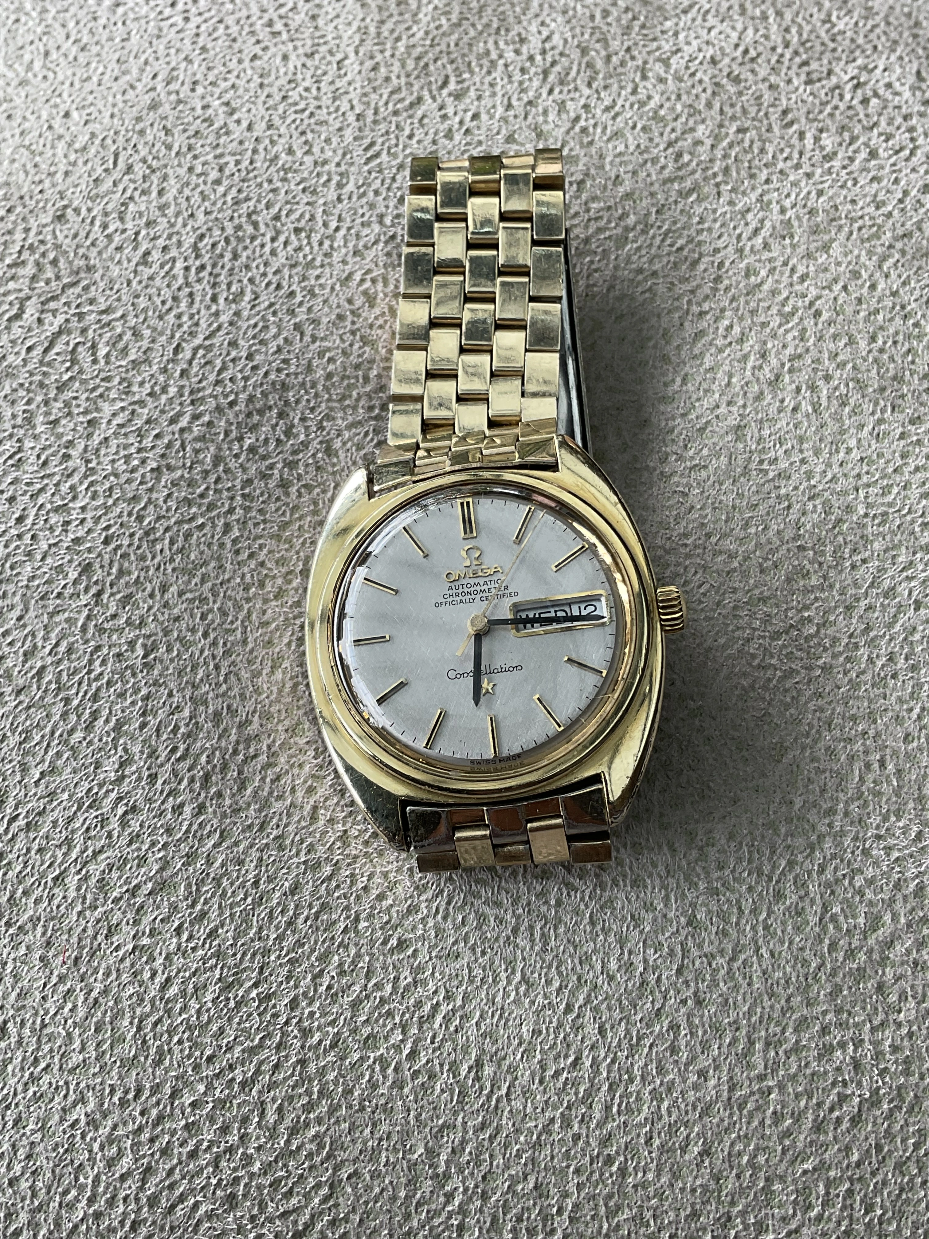

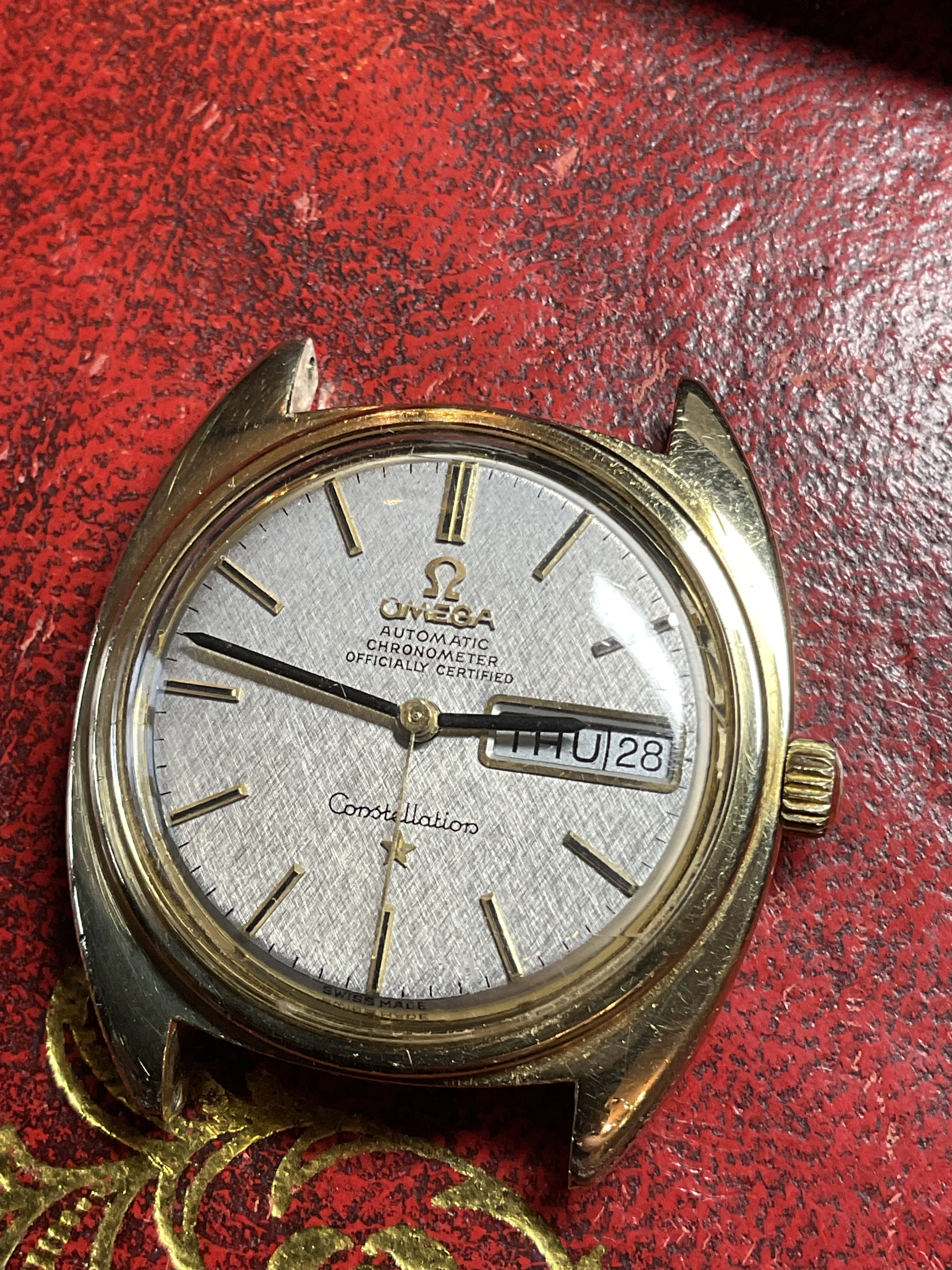

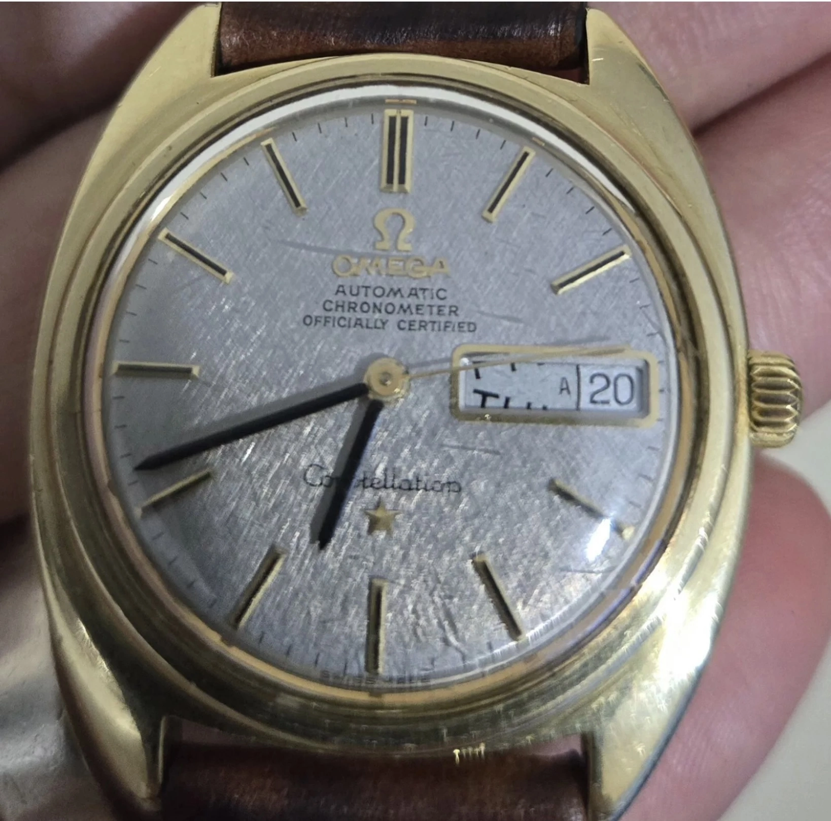

·Pick up this omega constellation as faulty the watch is fully working but needed looking at

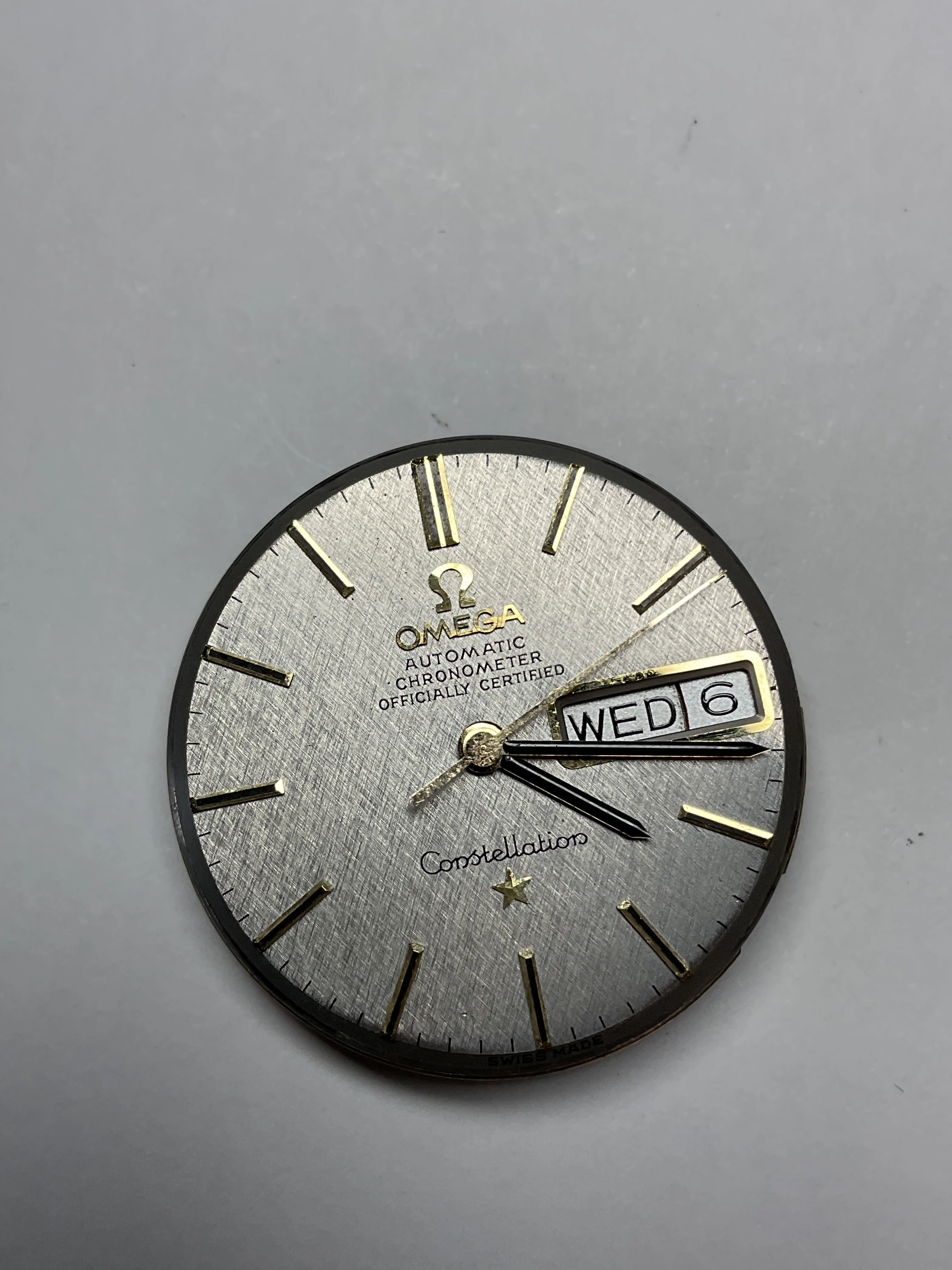

As you can see the day wheel is stuck but the rest of the watch was operating perfectly

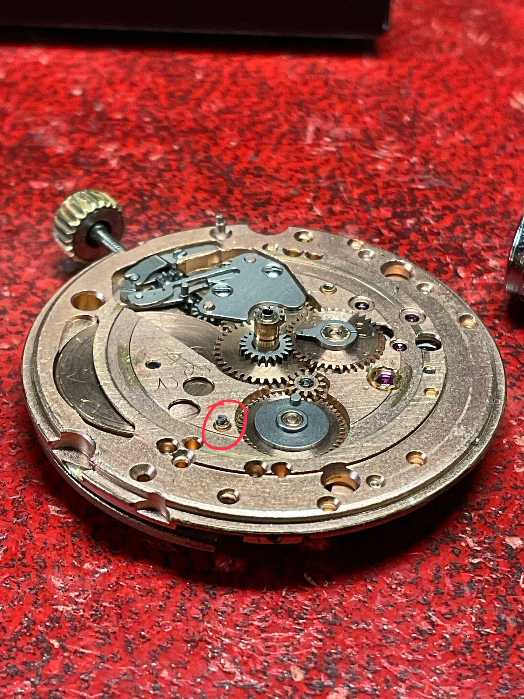

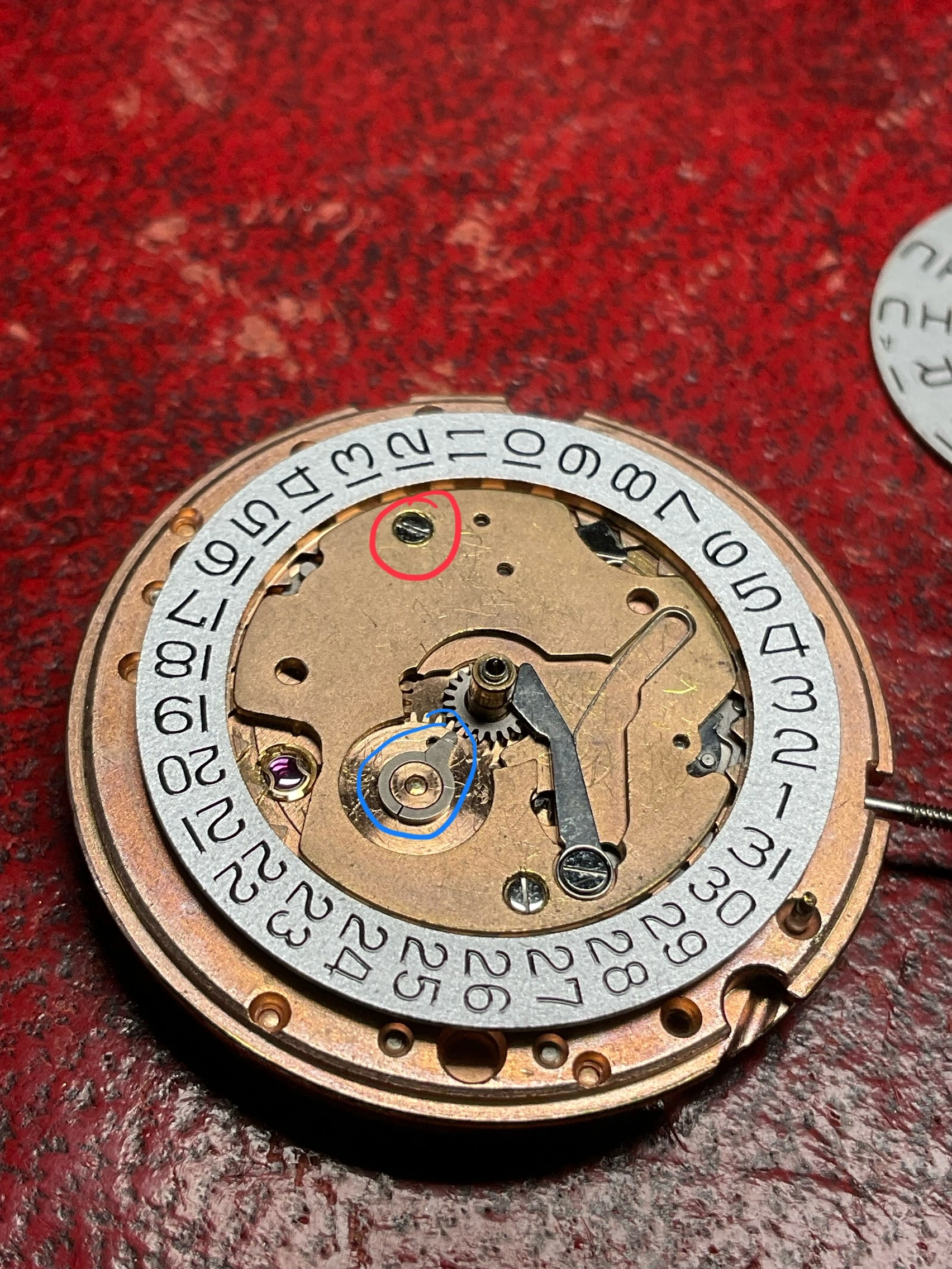

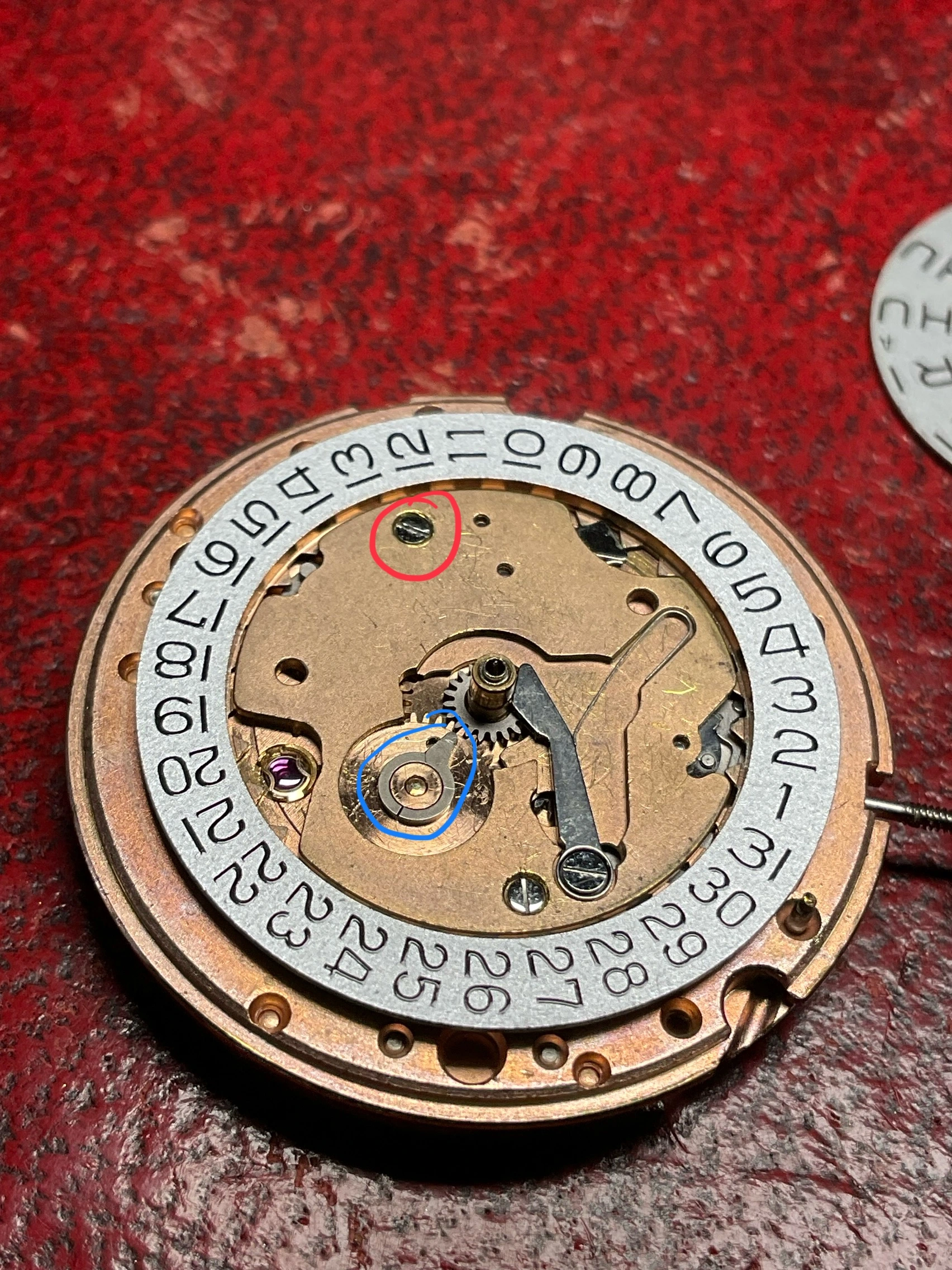

This is the first time working on a day date and it wasn’t as difficult as it looks bear in mind I’m a complete amateur lol but have always been hands on I always give everything a go what could go wrong lol . after receiving I removed the movement from the case and carefully removed the hands and dial, under the dial I removed the day wheel which is very easy to remove it’s just held with a little pressure from that spring I was taking about earlier revealing the top cover plate that holds the date wheel in place a screw head had completely snapped off I didn’t get a picture but once removed you can see the snapped screw only a very small portion of the screw was poking out and luckily I could get my tweezers and carefully unscrew it
This snapped screw was causing slight lift on that cover putting pressure on the day wheel and then touching the back side of the dial causing it to get stuck.

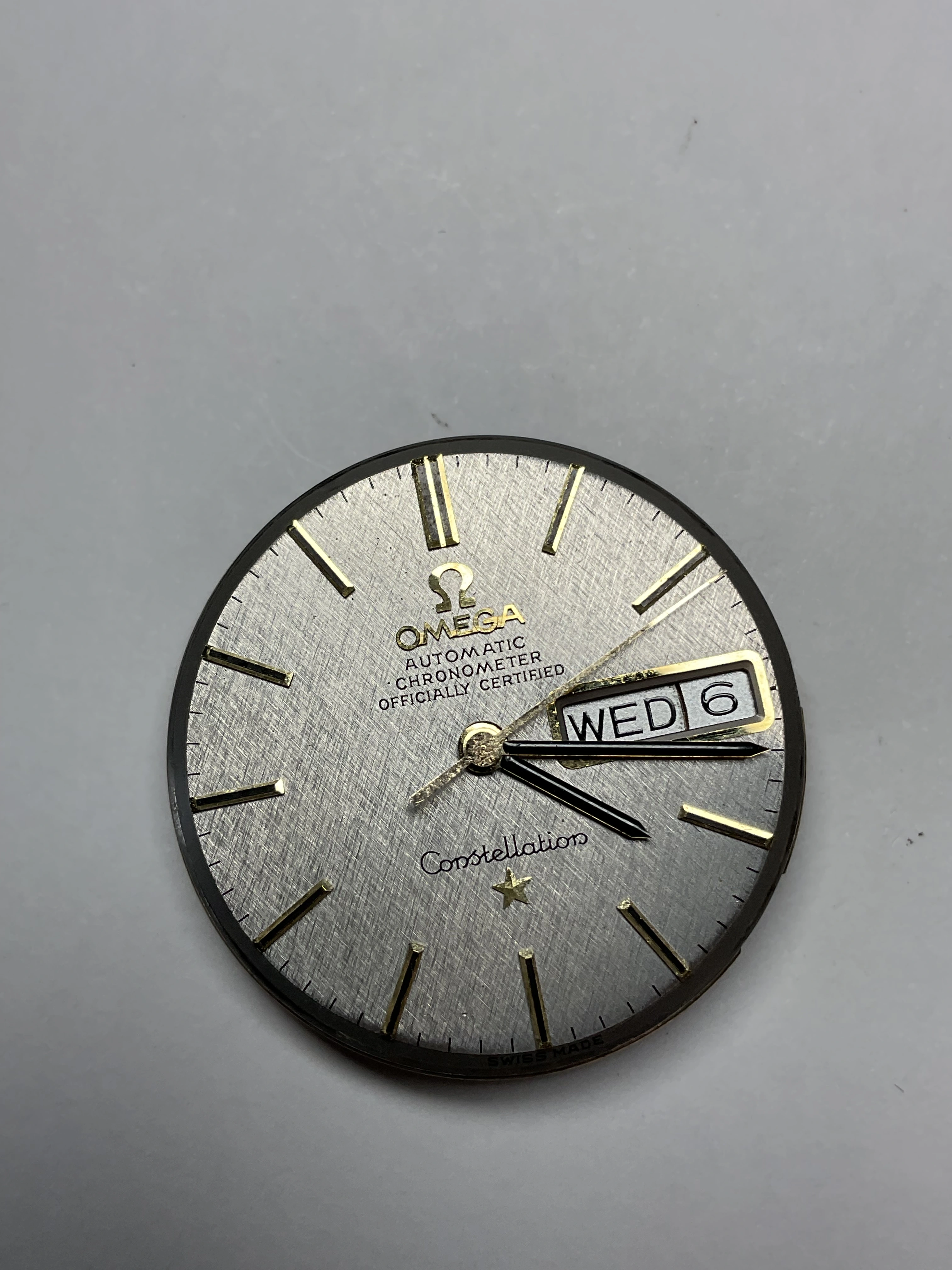

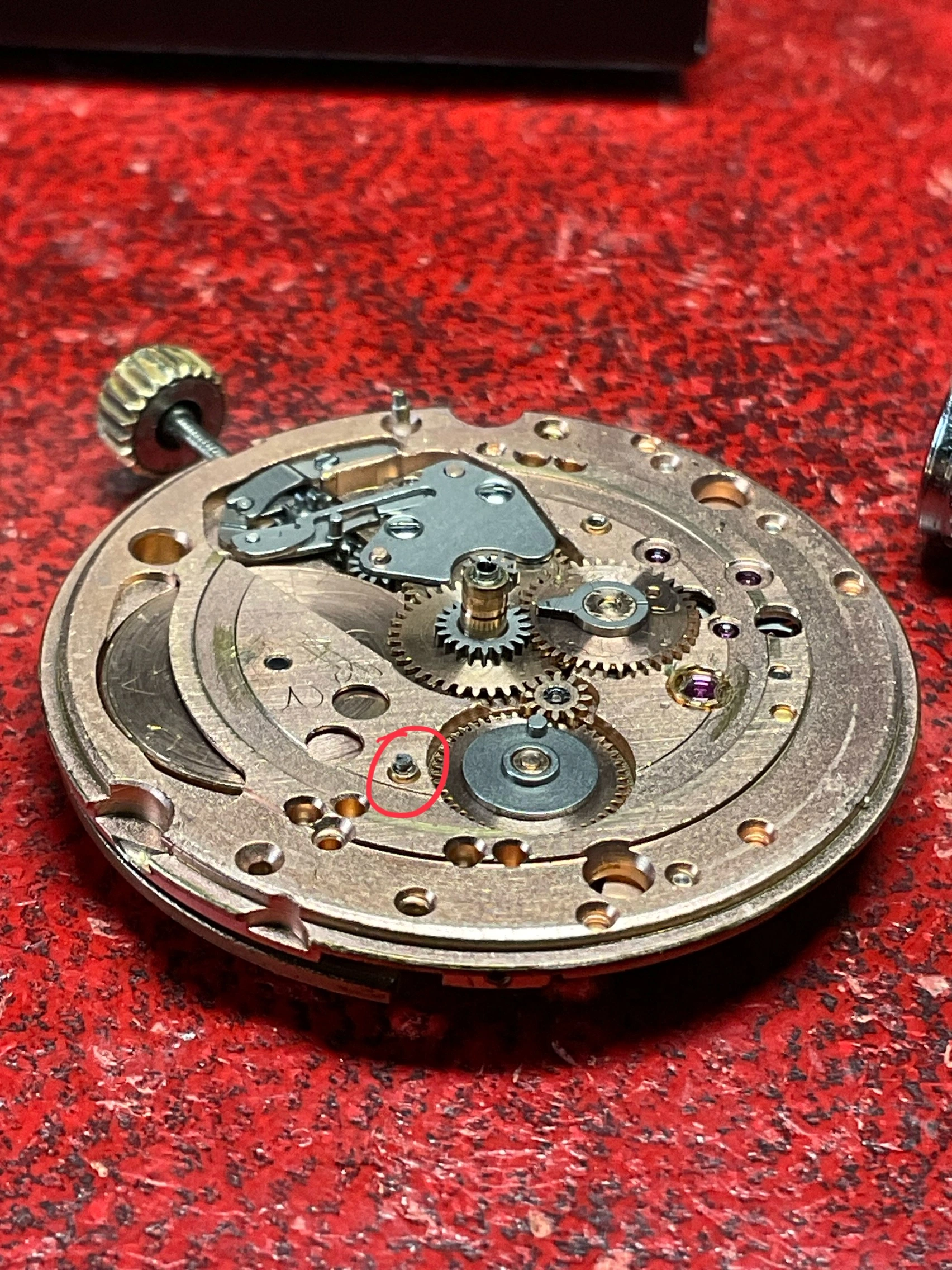

After finding a replacement screw and putting it back together with the dial off to test the operation of the day n date wheels and flicking over at 12pm the day was miles out to the date and wasn’t flicking over at the same time after a little research there is a little hand this gear that turns (circled in blue ) this is what flicks over at 12 it’s quite tight and took a little trial and error turning it backwards and forwards to get it to align with the date but got it bang on and they now both flick over at 12 on the dot.

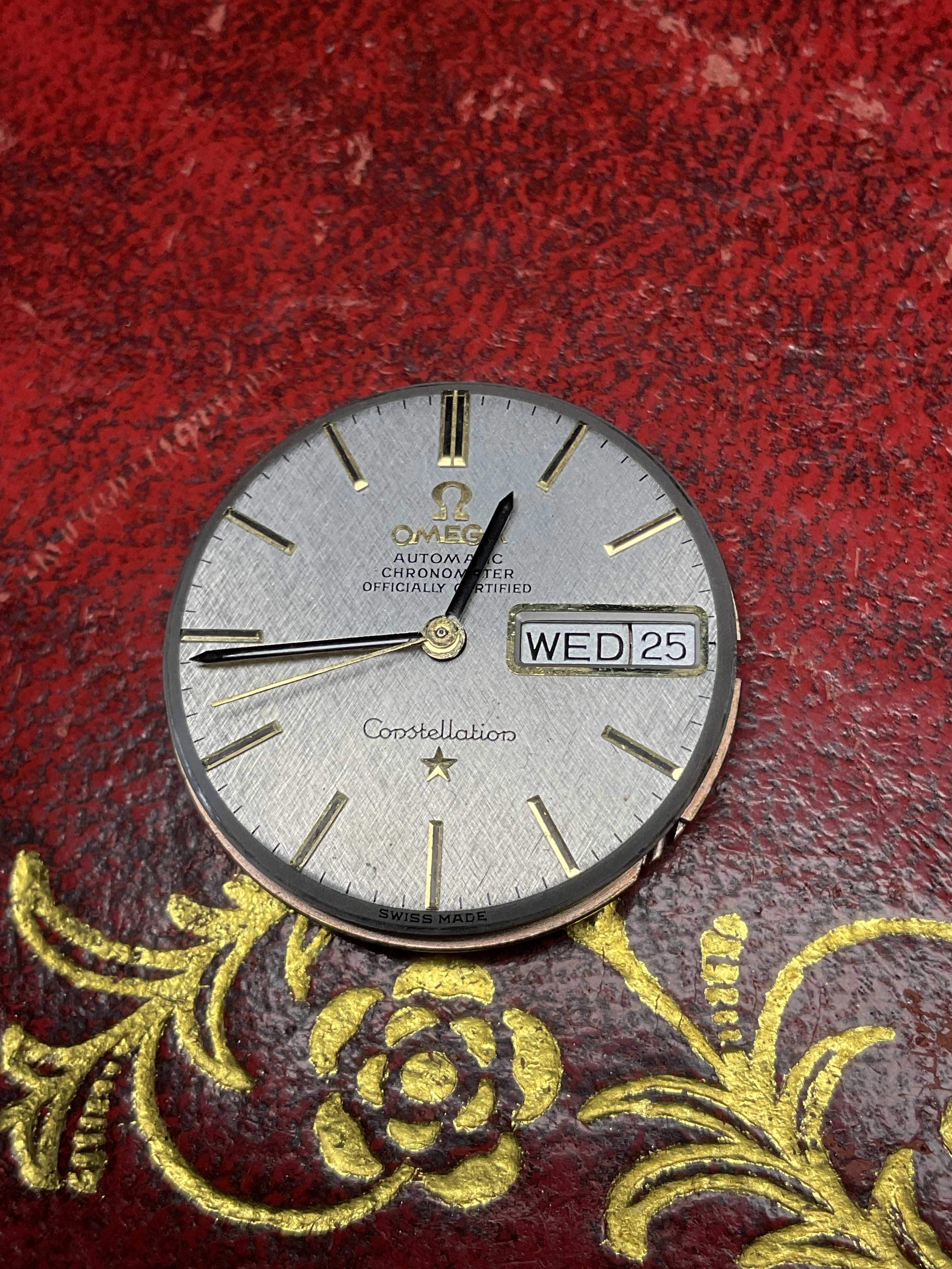

Fitting the dial and hands

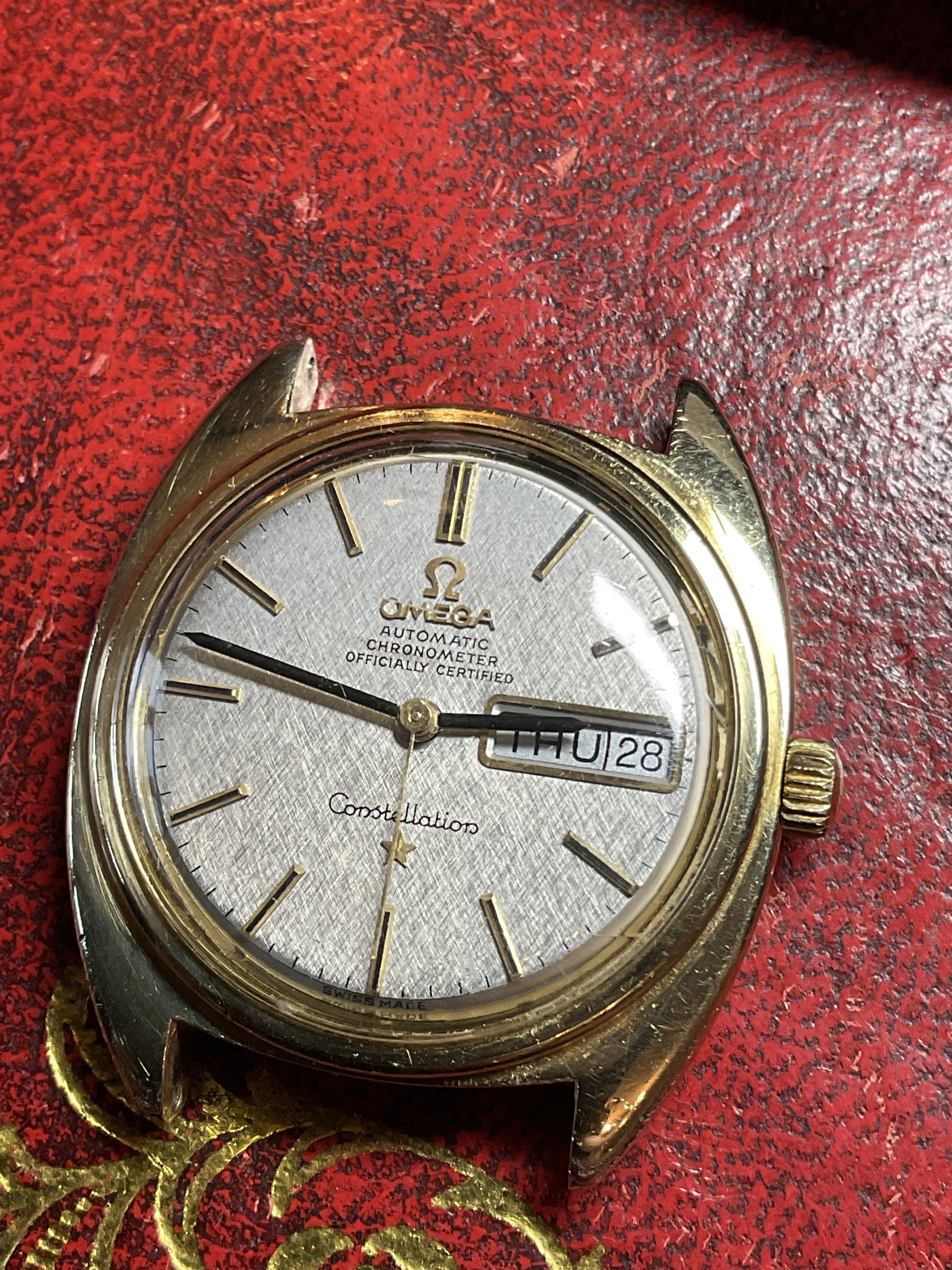

And giving it one last test checking all flicks over at 12 before putting it back in the case

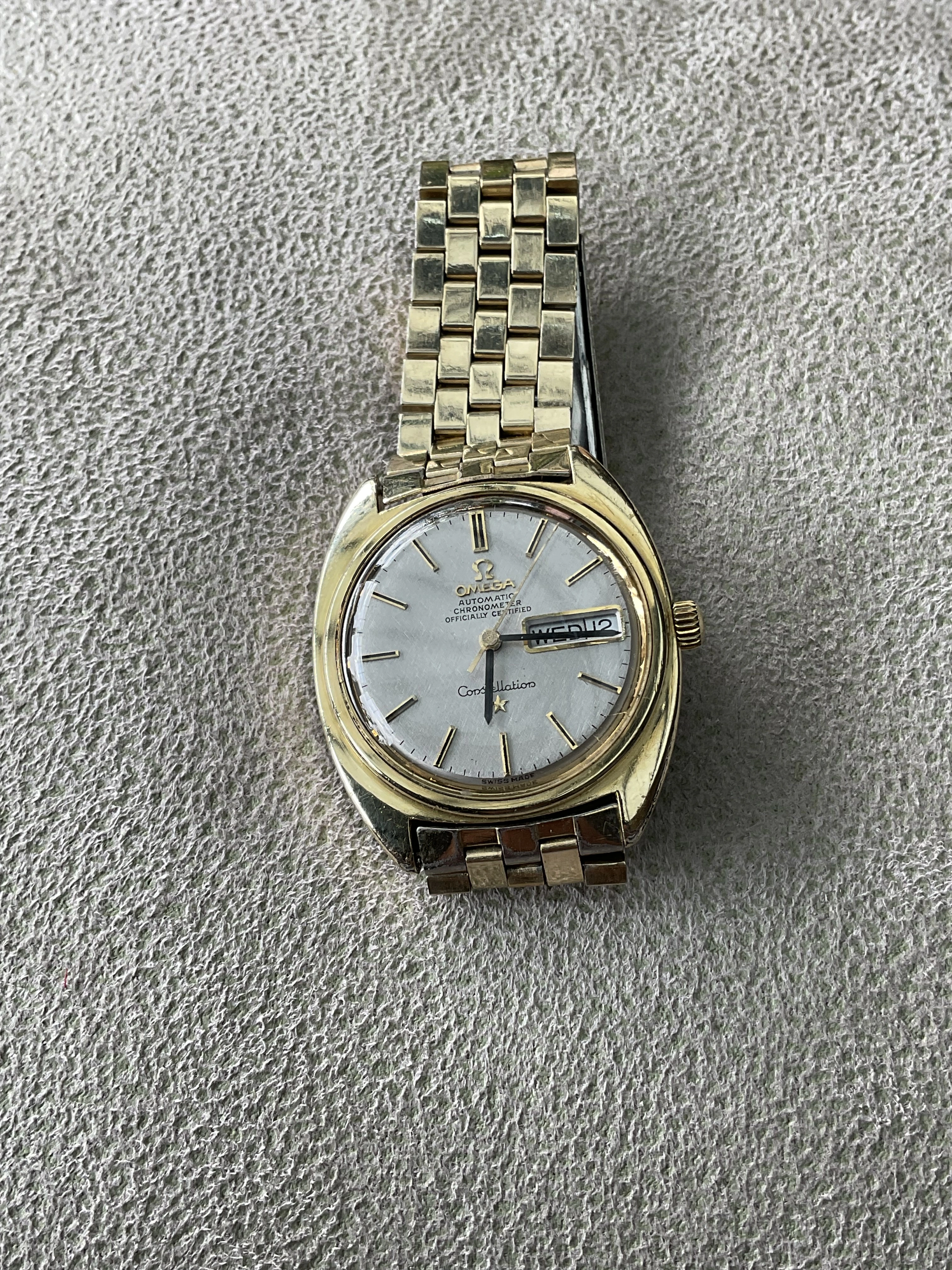

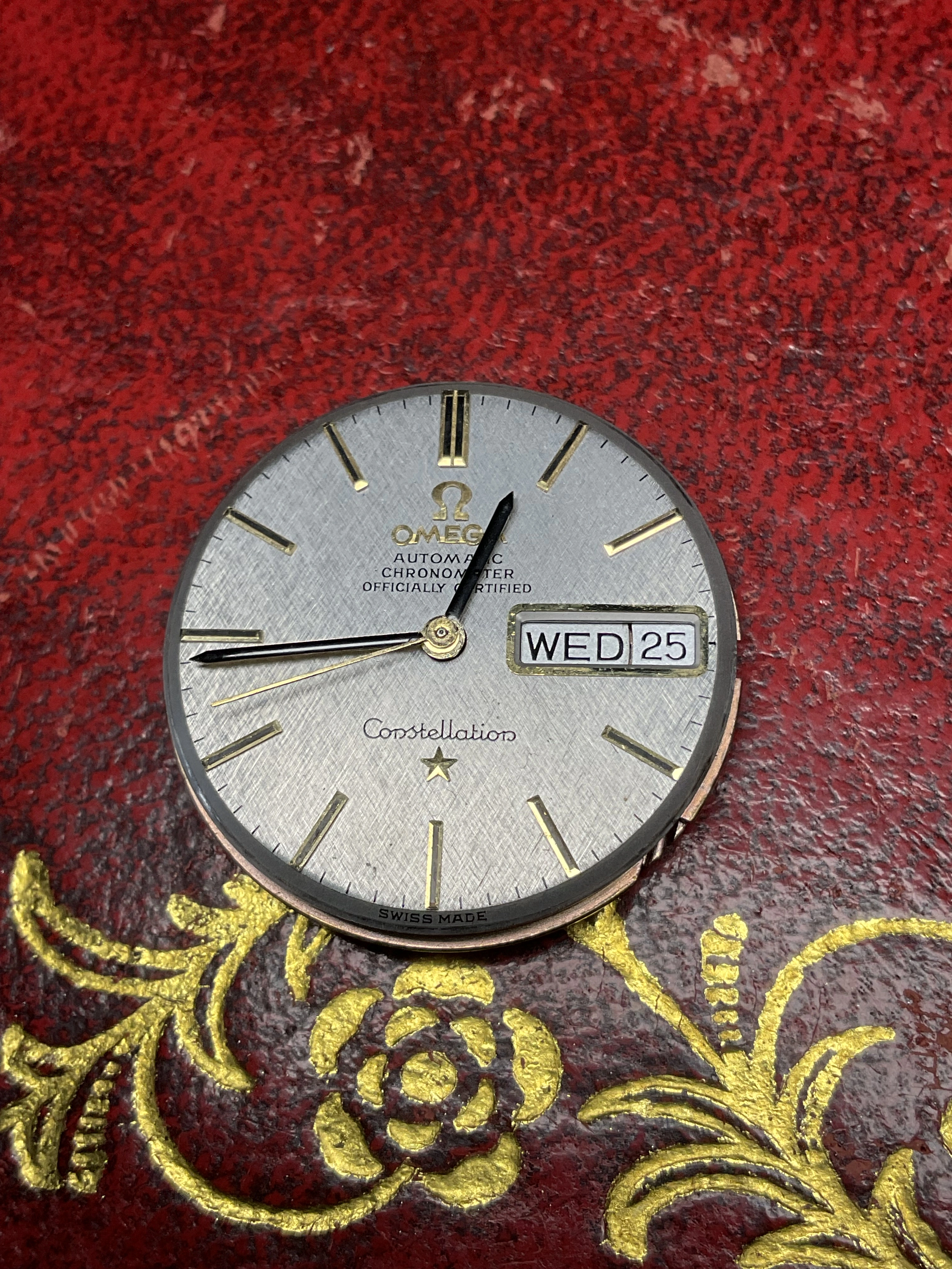

It’s now all back together and working perfectly it’s on a nice original brick bracelet which I’ll attach a picture later.
