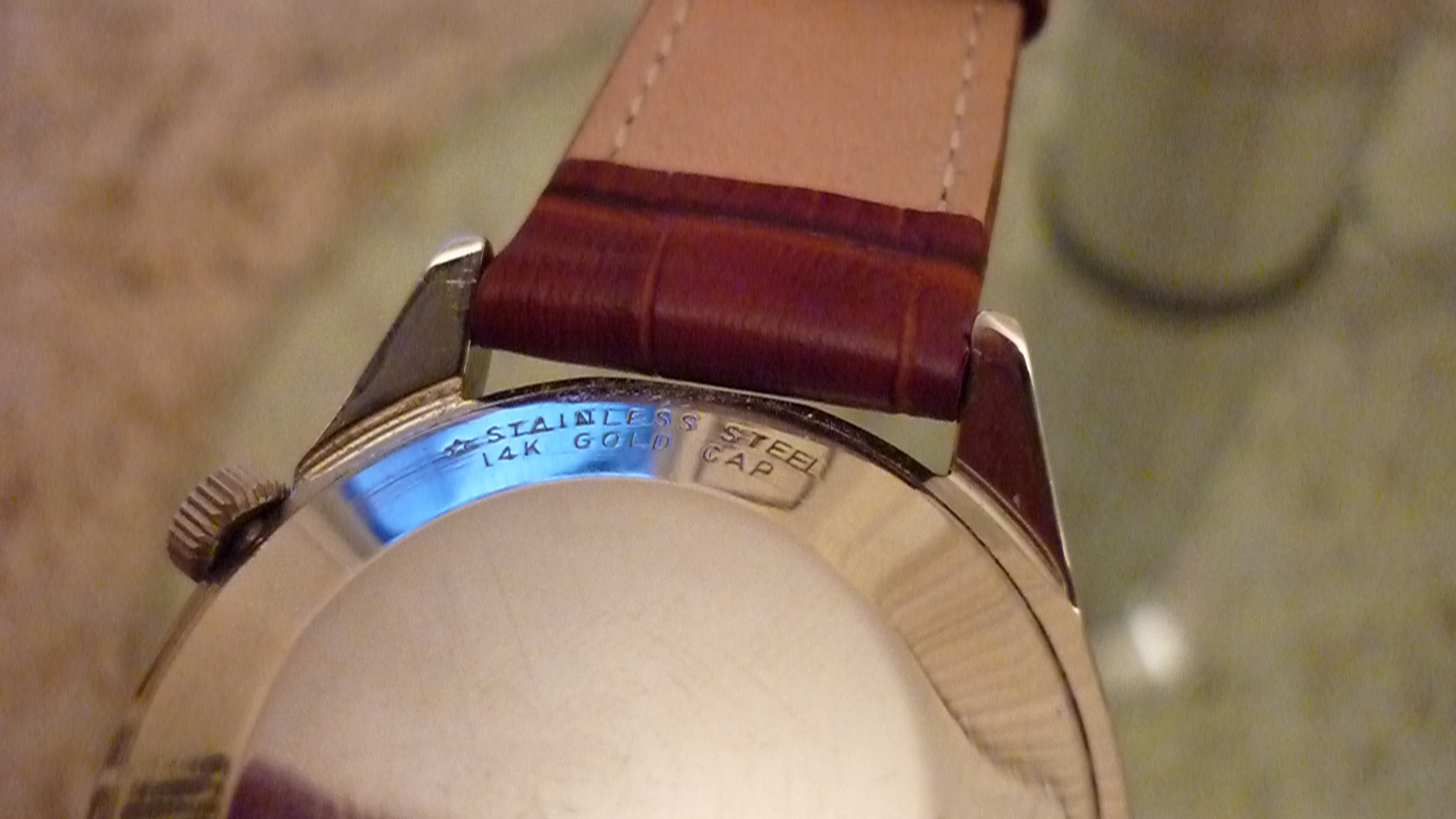

    Not long ago I picked up this 1967 LeCoultre Memovox, cal 911, recently serviced by Zaf Basha. (Coincidentally, this is also a birth year watch for me although I didn't realise it when I bought it.) So, I thought it deserved a little write up and, of course, a few pictures.
    A Bit of History
    The Memovox was developed in 1949, following the development of wrist alarms by other manufacturers which since the first one in 1914 had been beset by problems. The first JLC Memovox was the manual wind cal 489 & was available to the public from 1951. Cal 489 was in production between 1950 & 1958. There are plenty of different case materials, dial furniture and sizes, but they al have the characteristic double crown arrangement. The bottom crown is a traditional winder and time setter. The top crown winds and sets the alarm time.
    [Edit: Cal 489 was available in both shock protected (Parachoc) and non shock protected versions. The shock protected versions being classified as P489.]
    In 1953, cal 814 was introduced as an iteration on cal 489 - with design changes that were probably introduced to facilitate better mass production. [Edit: Cal 814 was also produced in a P814 version, as well as a K814 version (designating the alternative Kif shock protection). In between cal 489 & cal 814, 2000 transitional movements designated cal 601 were made.]
    Cal 814 was produced until 1964, when it was replaced by cal 910 (non-date) and cal 911 (date version). These were produced until 1979 in large numbers - 75,000 cal 910/911's were made in total. These were all manual wind movements. [Edit: With the 910/911 movements, only the Kif shock protection system was used & the use of the K designation was dropped - although I'm not sure exactly when that was. You can see on my watch below that it still carries the K911 designation.]
    My Example

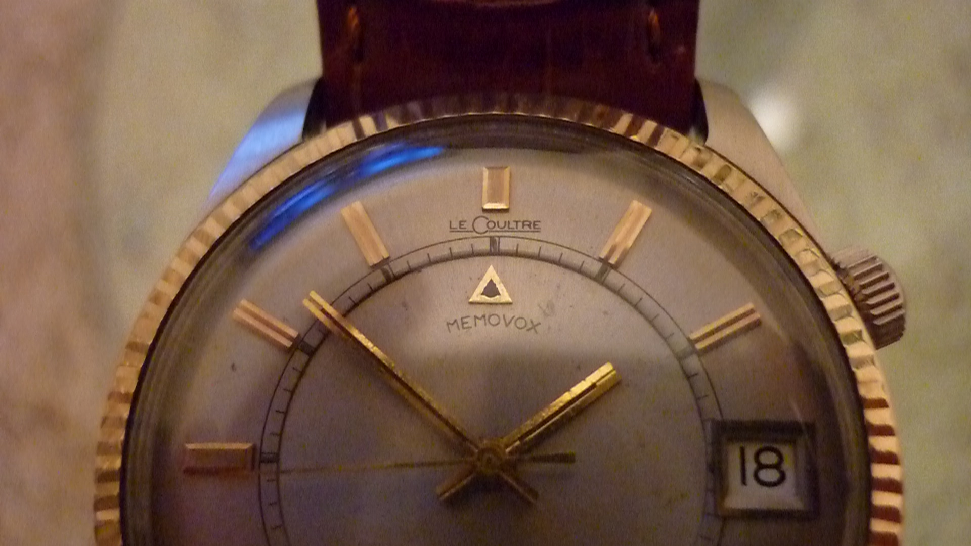

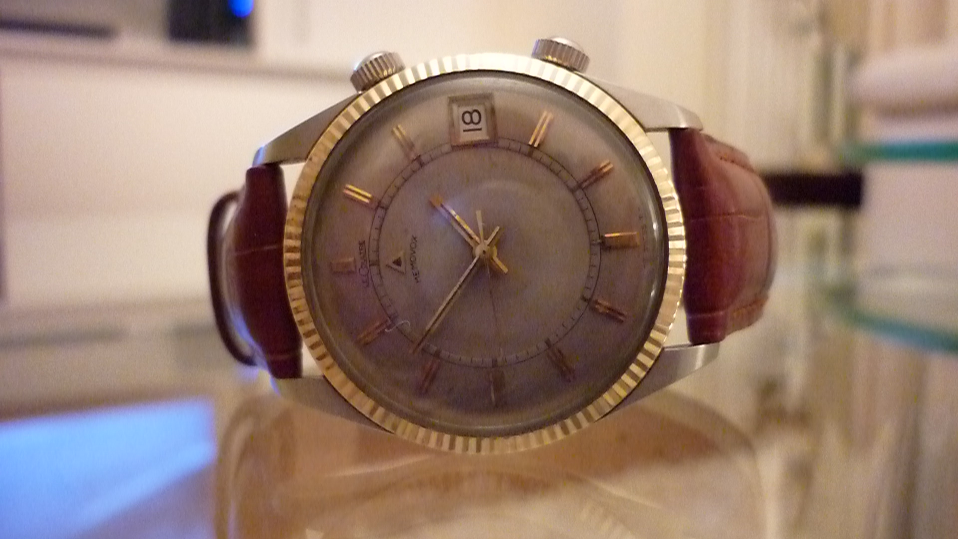

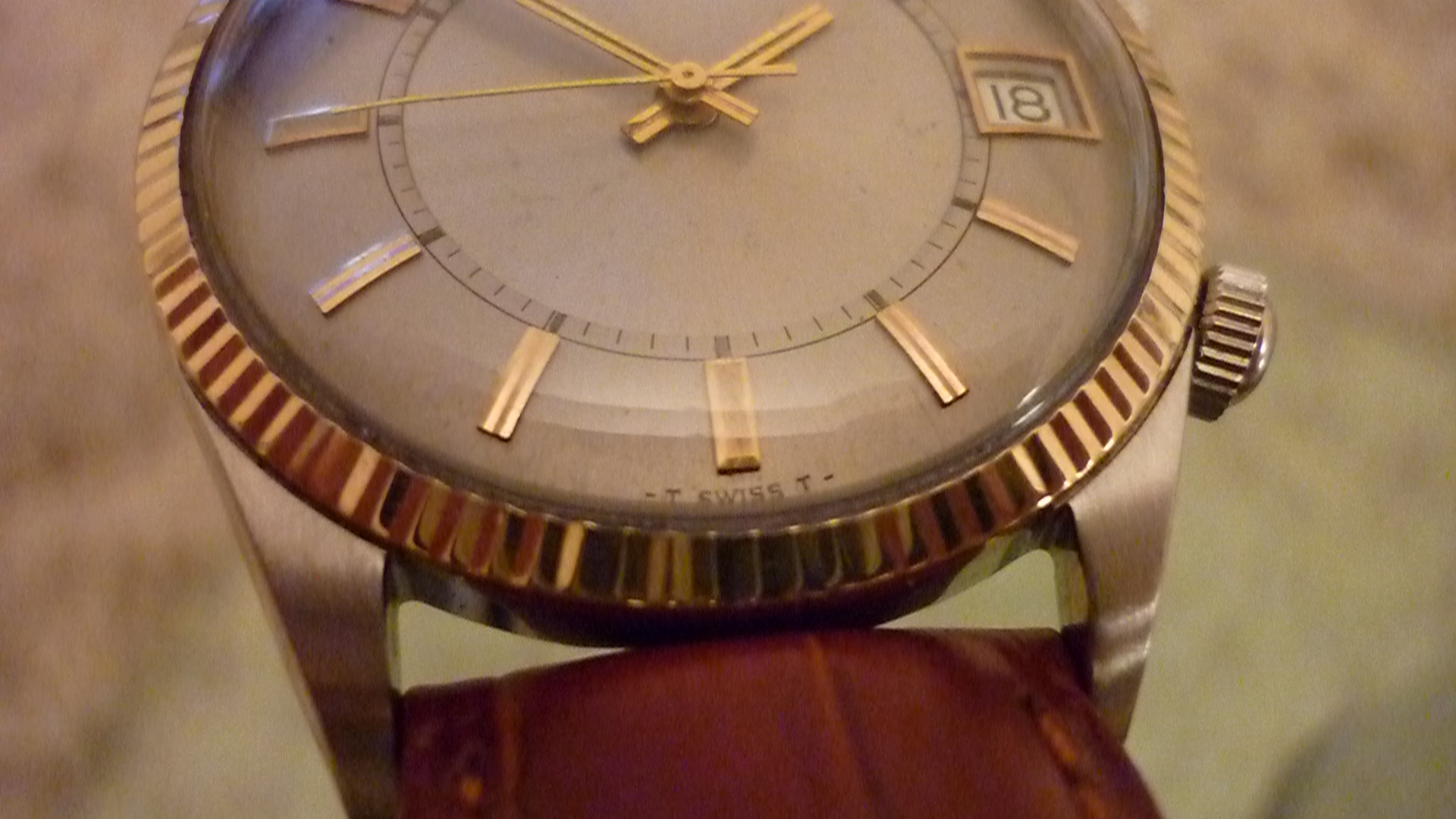

    This particular watch has a serial no dating it to 1967 & is in a stainless case with a slightly unusual 14k solid gold bezel which adds a bit of jazz & light reflectivity to the case. It has a diameter of 35mm excl crown(s) and is 41mm lug to lug & a smoke grey dial which is showing some patination.

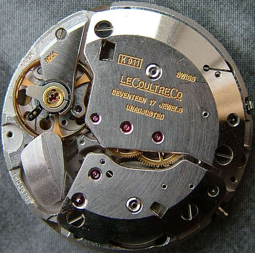

    P1040829.JPG P1040831.JPG P1040833.JPG P1040835.JPG P1040838.JPG K911 caseback.jpg K911 movement.jpg

    A full bi-directional rotor version appeared in 1969, being cal 916 (over 32,000 movements produced until 1978). [Edit: It was produced as a Kif protected mechanism only & the K designation was not used. I haven't seen one myself, so does anyone have a 916 they can post a picture of to confirm that ?]
    The 916 was a date version movement, which required a redesign of the alarm mechanism to allow the rotor to swing freely through 360 degrees. It also ran at 28,800 beats p/hour, compared to the 18,000 beats of all the previous calibres and is often called the Speedbeat, for obvious reasons. This movement developed into cal 919, then cal 918 - which was still used up to 2005 in the Master Compressor series. Cal 918 might have been used a bit longer, but I don't have the catalogues between 2006-2009 to check ! The current MC Memovox is the "Tribute to Deep Sea" which uses a cal 956 and is a lovely update to the original and rare 1959-61 Deep Sea model.

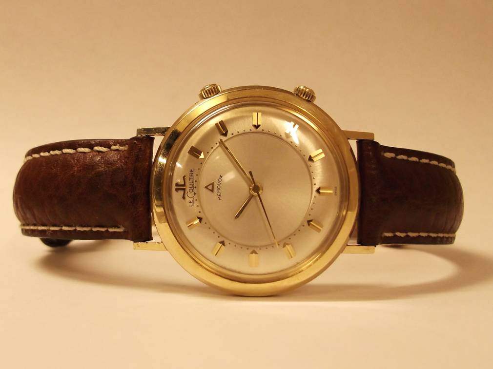

    Yes, thanks for the very nice write-up. I love these older Memovox watches. Here's my cal 814 10K gold filled "Golden Heritage Time Reminder." The flyer I have indicated it was a product of Vacheron & Constantin - LeCoultre Watches, Inc., Division of Longines Wittnauer Watch Company. LeCoultreMemovox1.jpg

    You don't see too many of those fluted bezels on the Memovox pieces. Very classy, and kind of reminds me of the rolex watches from the 80s.

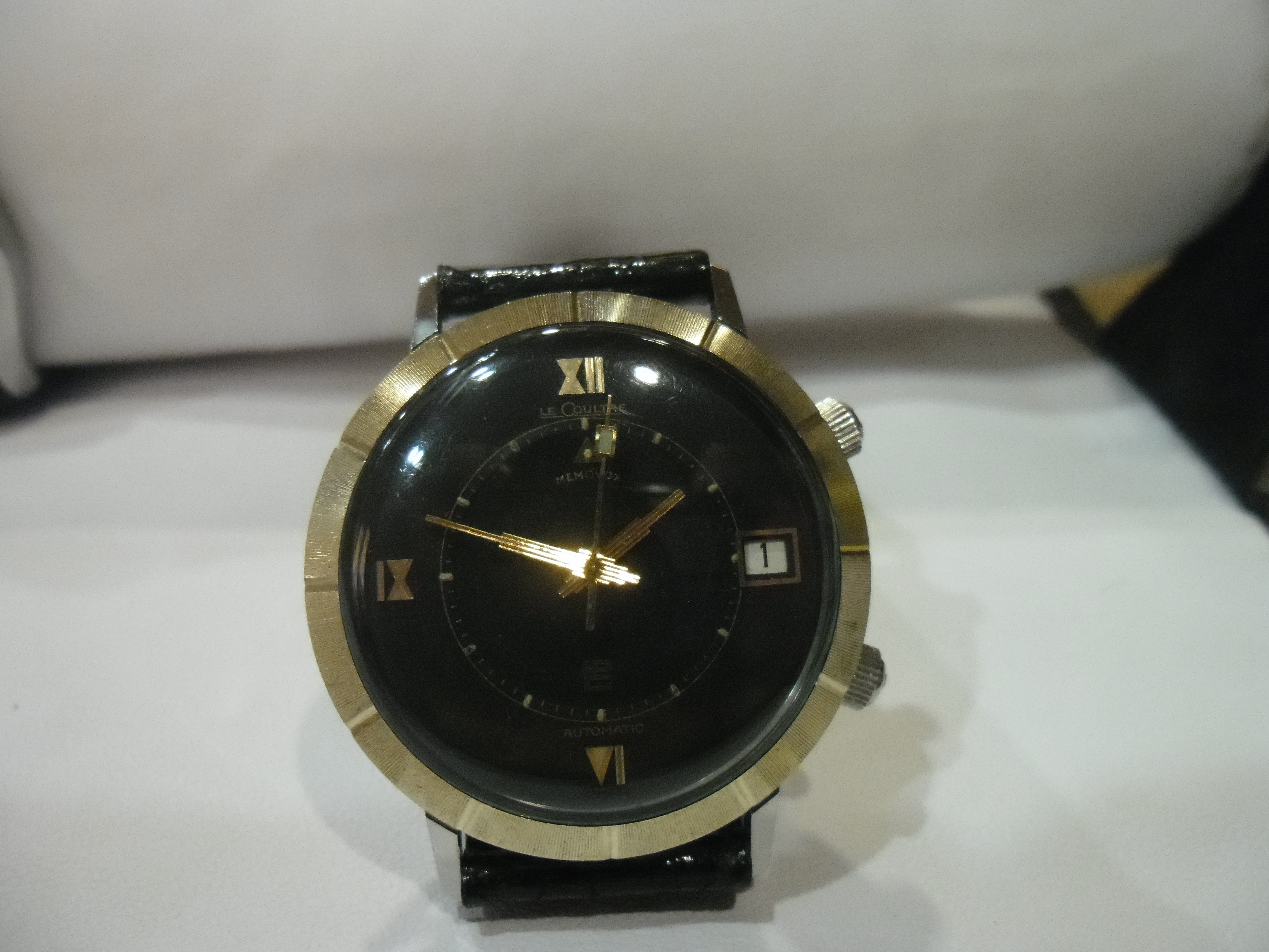

    In your question "if anyone has seen the same example but w/Cal. 916" it happens to be the owner of one of these, I believe, rare examples. Does anyone knows the value of this watch? Thanks JLC Memovox HPG Cal.916 (b).JPG
