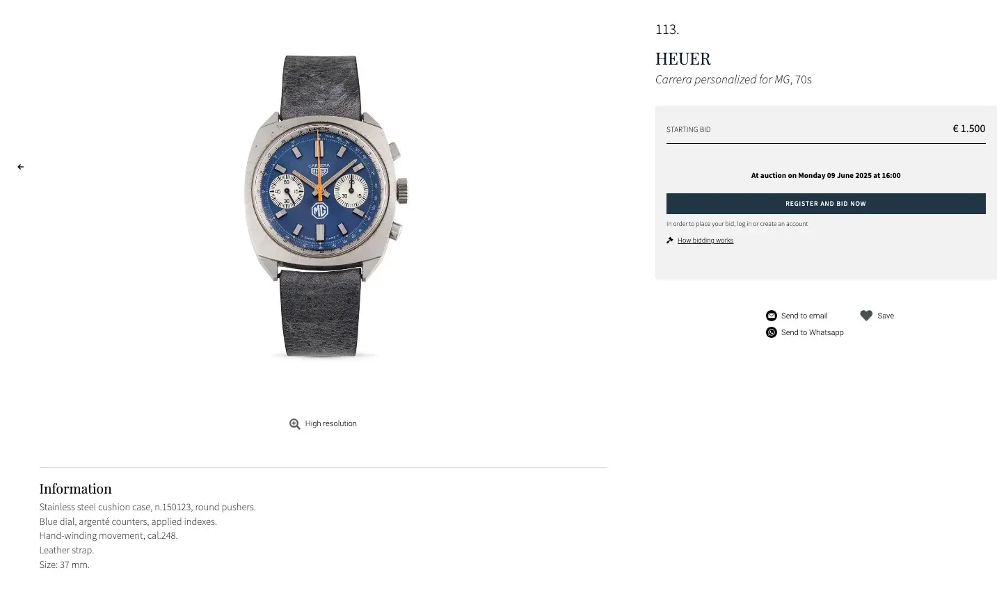

Hi Forum friends!
Auctions are always fun, and sometimes we get excited…
BUT -

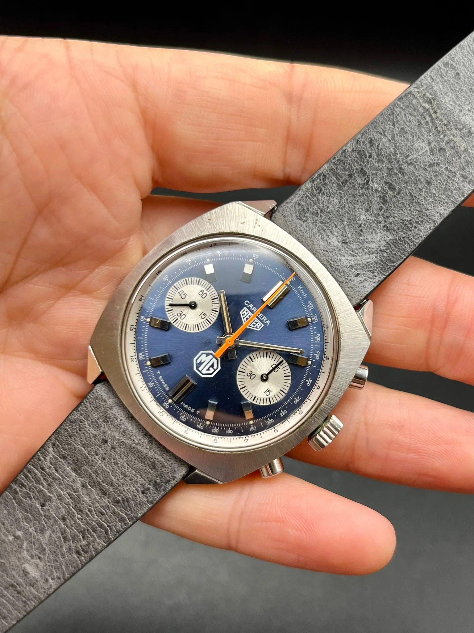

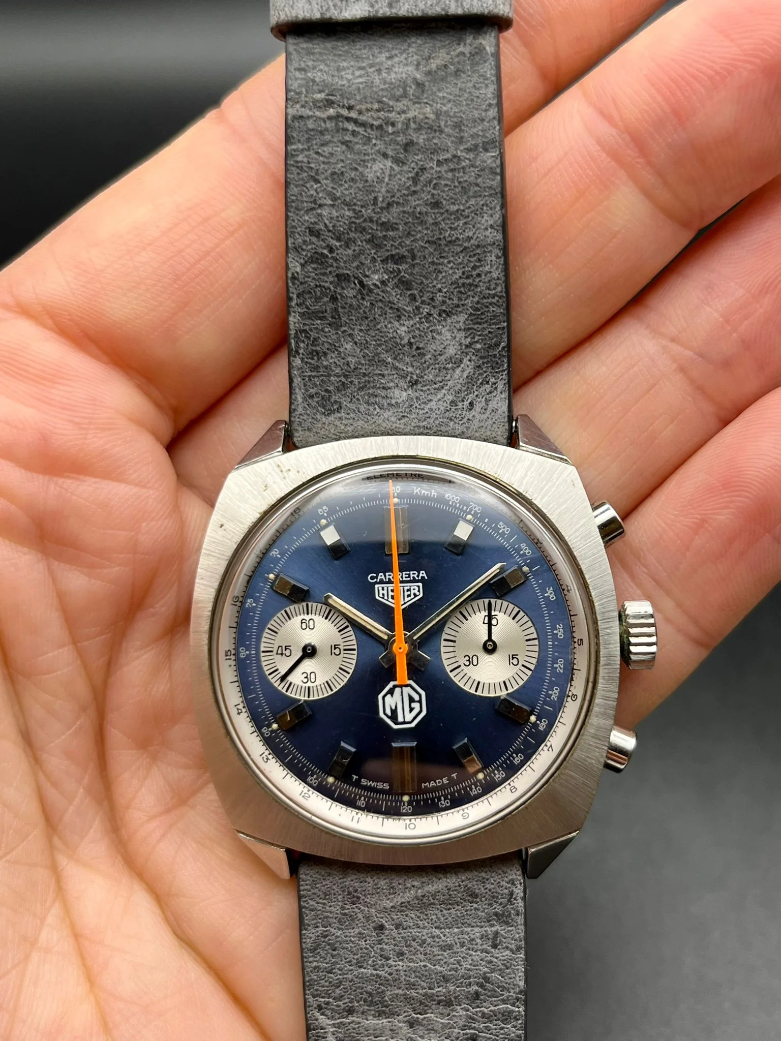

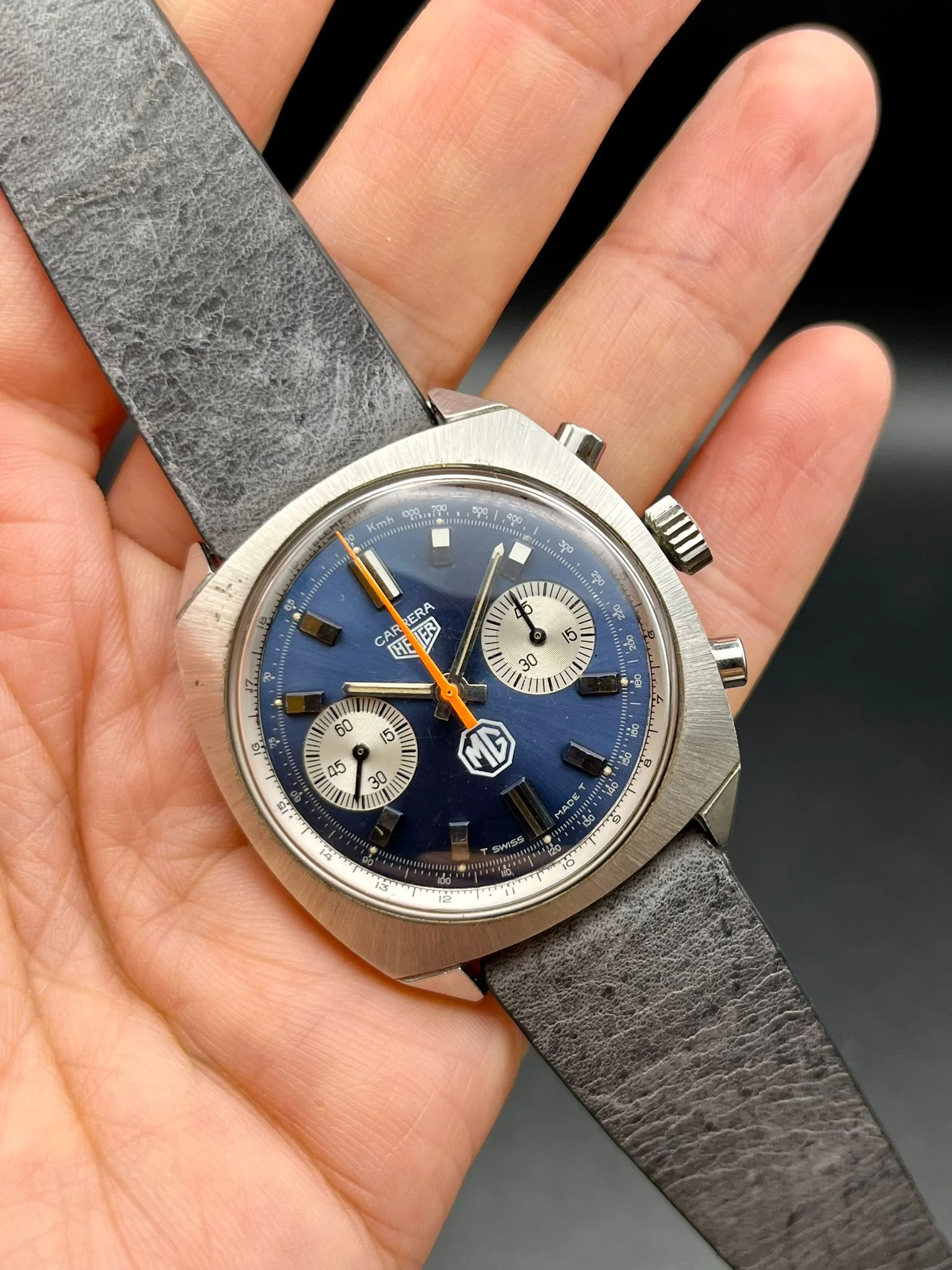

If you are looking at this watch, and might be tempted to try and win it - AVOID this one!
It is an assembled watch with a fake dial!!
And it has been around for a few years...
Stay Frosty Gents!

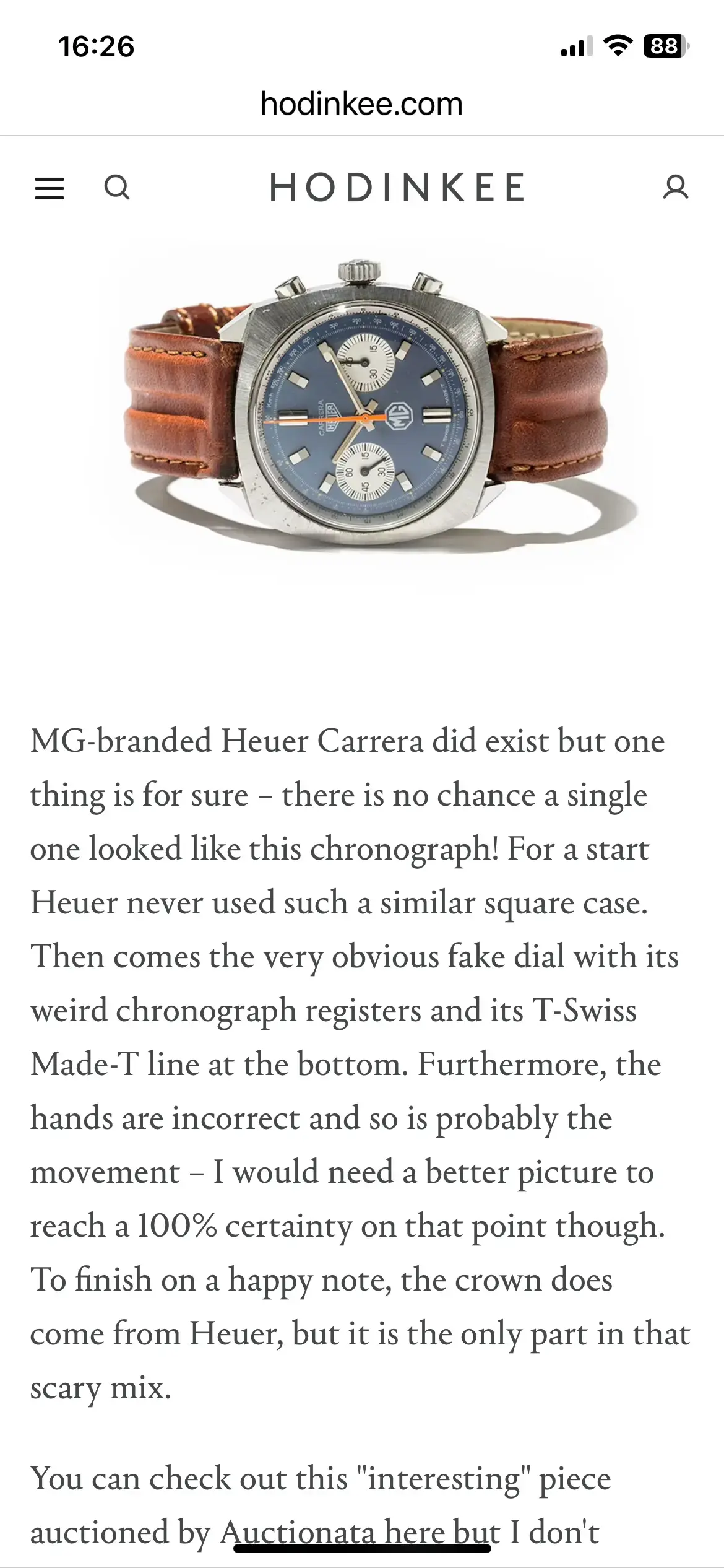

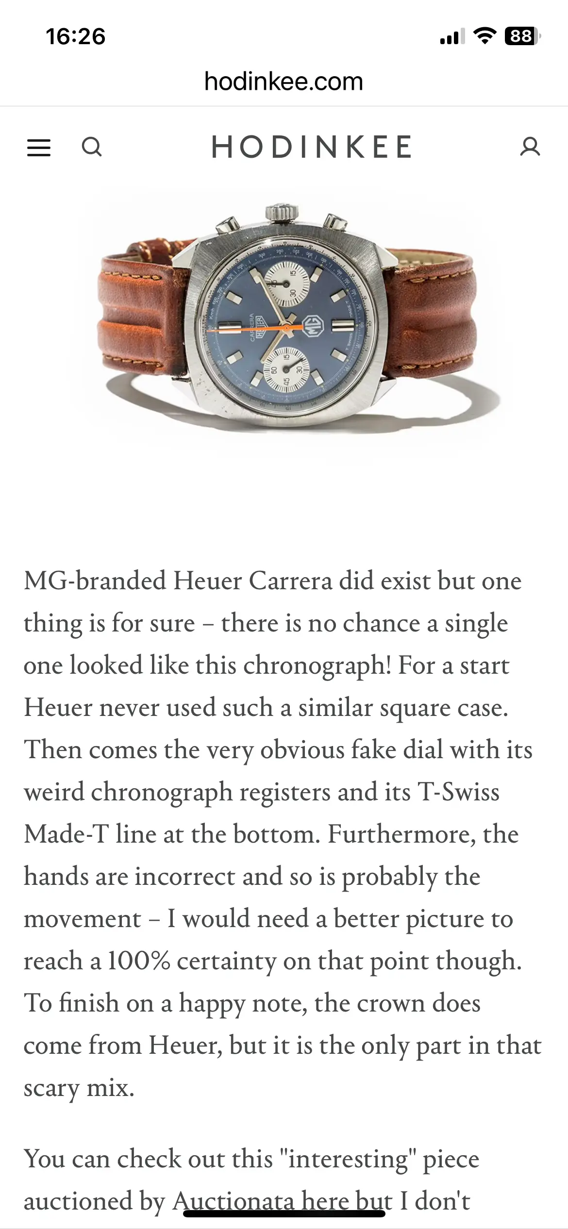

Nothing much to tell Jochen....The dial does not exist (as a Heuer)!
2,629
5,911

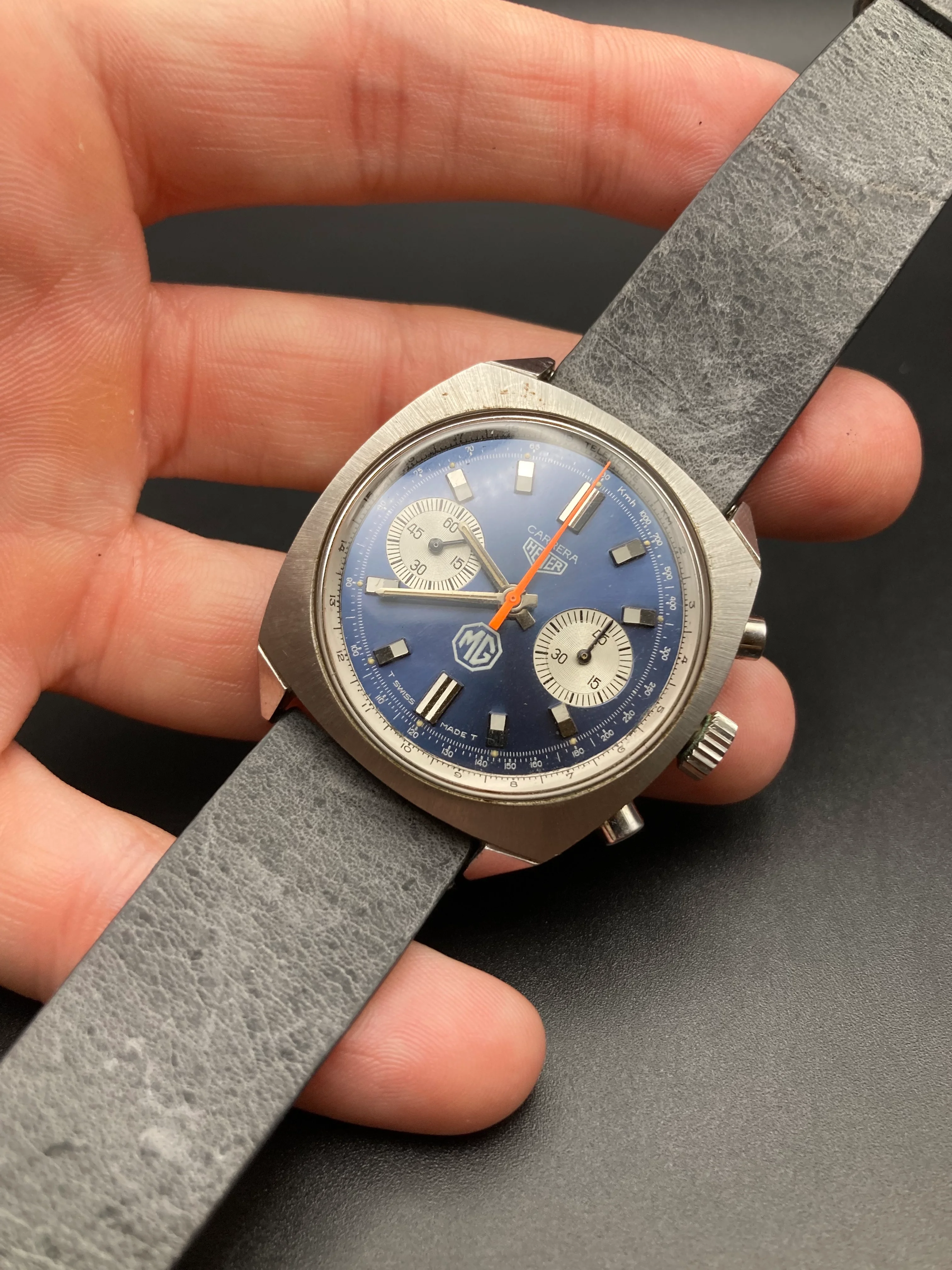

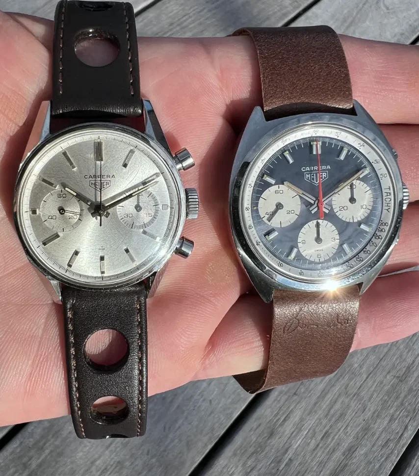

Does T SWISS MADE T exist on these?
Nope...
They have another way to show...
There is one reference (maybe more...?), that has a similar text, the 510523.

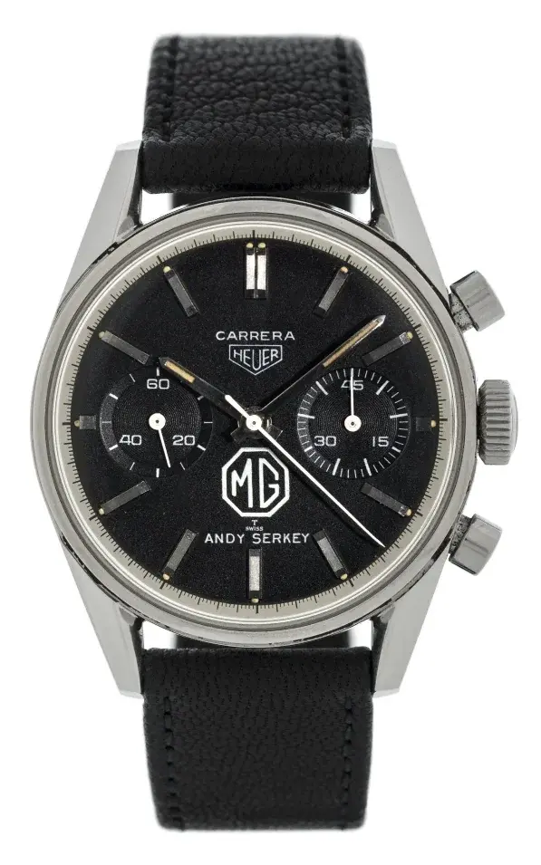

And here is an MG (Thanks Rich Crosthwaite for the lovely pictures!)

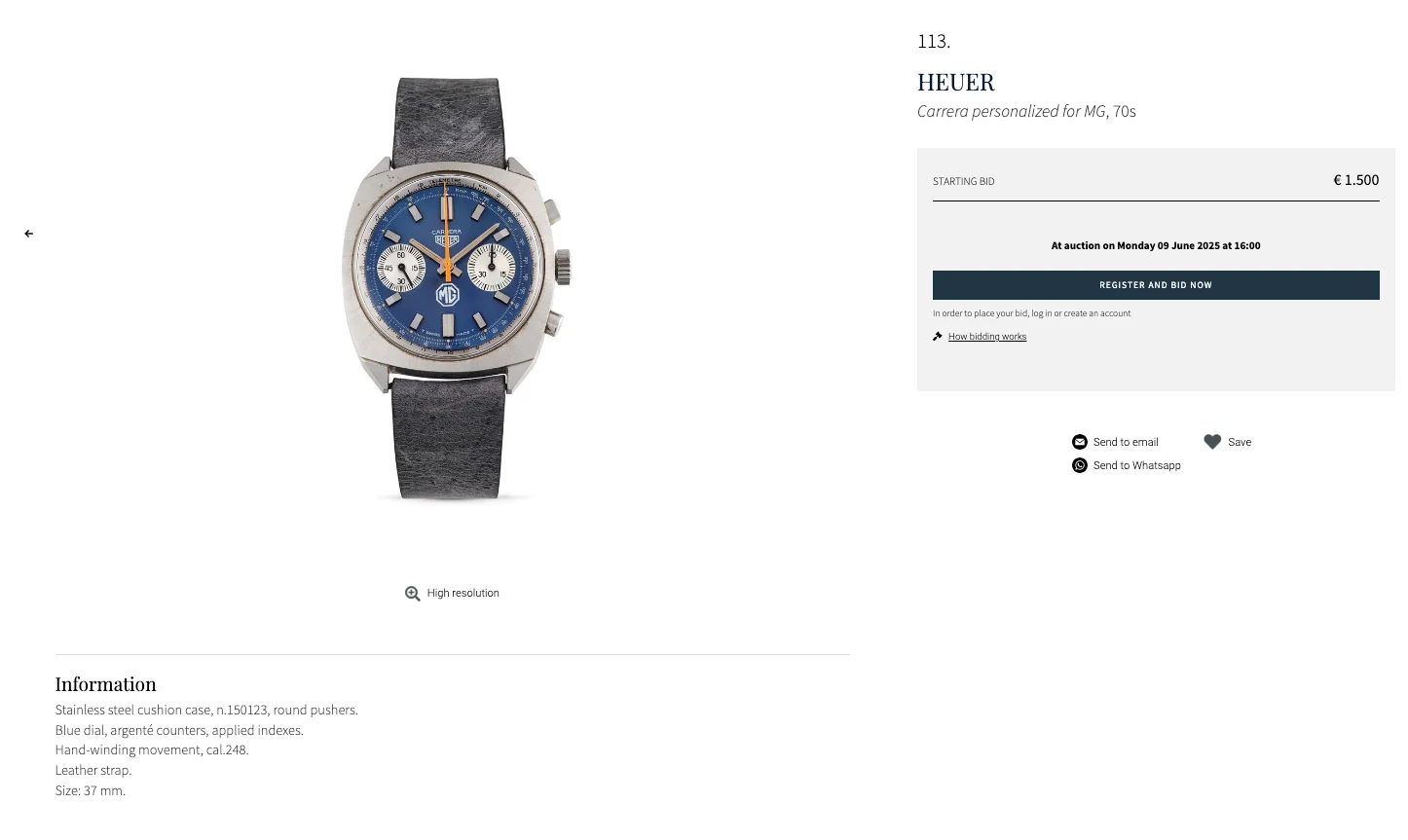

Well...
Somebody wanted the watch - for 2000€ / 2300 $ incl premium!!
