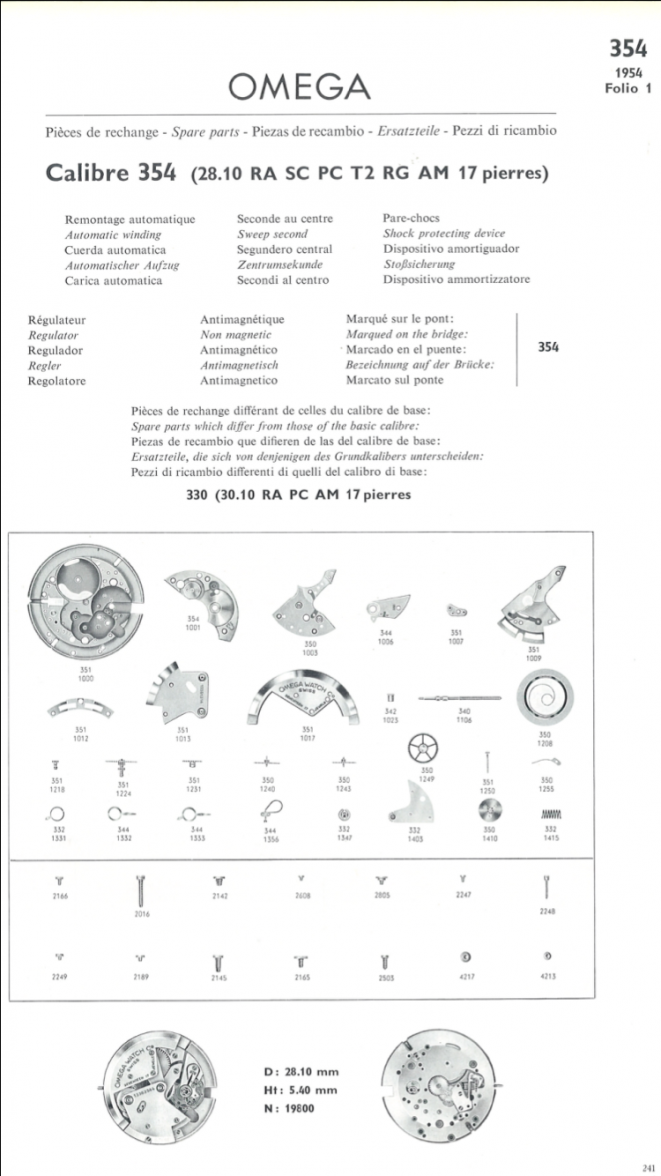

  3. Bill Sohne Bill @ ΩF Staff Member Oct 13, 2018
    3,846
    8,939
    Hi @UncleBuck and @padders
    I have to disagree with your statements ....
    28.10 is part of the movement designation ....
    The 354 is a 28.10 based movement it’s complete 28.10 naming convention is as follows
    28.10 RA SC PC T2 RG AM 17 jewels ...
    (And you now know why omega went to a 3 digit naming convention ..... ). It’s a mouthful .
    As ref take a look below at the Omega Material list below ...
    @Vanallard you did ok in my book !
    Good hunting
    Bill Sohne

  5. Bill Sohne Bill @ ΩF Staff Member Oct 13, 2018
    3,846
    8,939
    Hi @padders
    I still disagree with what you stated . The 354 is part of the 28.10 movement family . It a technicality correct id and omega cross-referenced documented it.
    @Vanallard only referenced Marco Richon’s AJTT . It was fine for Marco to use 28.10 RA SC -354 .... it’s fine for me and is correct he did nothing wrong . You should at lest acknowledge that it is.
    Yes, omega moved to the 3 digit naming convention for ease of use ... going forward ...
    And yes it’s easier and less complicated to just say 354.
    Ok??
    Bill

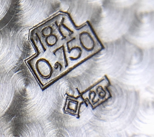

  7. Vanallard Nov 11, 2018
    1,403
    4,859
    Another interesting piece of information recently shared by a fellow member. The
    Poinçon de Maître (pictured - stamp with no. 28) on the inside of the caseback indicates that the case was manufactured by Patek Philippe in Geneva.
