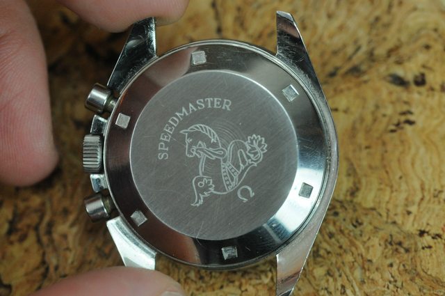

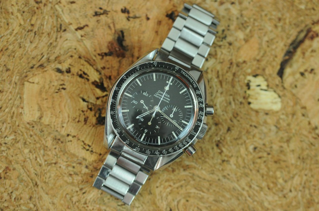

    Hey guys,
    Not sure if this one has been discussed, didn't find it.
    Anyway, a few pic. A bit beat up, but nothing wrong with that. Dial appears ok, hands alright though seller states chrono second hand is not original. Case a bit dinged but sharp, movement, hmm, looks ok. Seller says doesn't run as reliably while chrono is running. Is that indicative of a major problem? Caseback looks *very sharp, too sharp? DON bezel.. and 29m serial by the looks of it, or is that 23m? 29 would be too high.
    What else needs saying?
    Edited Feb 6, 2015

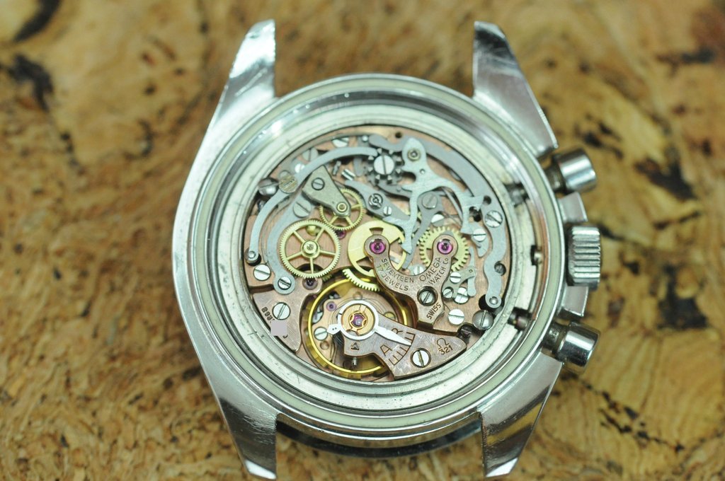

    Let's see inside the case back.

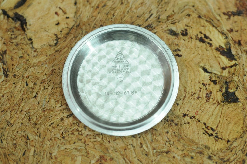

  3. oddboy Zero to Grail+2998 In Six Months Feb 6, 2015
    9,217
    23,880
    Inside caseback

    It might be better in person, but on the picture, the dial's doing nothing for me.
  5. dougiedude Carpe horologium! Feb 6, 2015
    7,152
    74,096
    No lume drags it down alot for me.
    Prettier dials exist, just gotta be patient!
  6. TNTwatch Feb 6, 2015
    2,876
    1,950
    Movement could be 26m, but dial does look bald.
  7. 250scr Feb 6, 2015
    936
    1,486
    Not bad, but not 4 that price

    Case back is suspiciously pristine, wish there were more pics of the rest of the case, it looks polished but tough to see overall condition. Crown, chrono hand look like service replacements to me. 6oclock register hand looks odd in pic, probably just bad lighting.

  11. pascs Feb 7, 2015
    1,634
    5,657
    The movement has a dark unpleasant colour to it (due to moisture?) and also has a part missing
    [​IMG]

    No mention of 516 endlinks, which in my experience generally means later replacements.

  14. Archer Omega Qualified Watchmaker Feb 7, 2015
    26,440
    65,428
    Just a screw - not a biggie.
    Cheers, Al
    JohnSteed likes this.
  15. pascs Feb 7, 2015
    1,634
    5,657
    I thought there was a brass piece under the screw which was missing but realise now its part of the plate which is there with the screw hole in it
