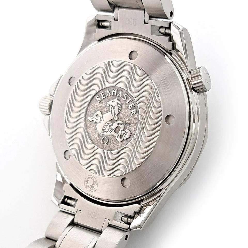

I am in the process of buying a Peter Blake 2254.50 and I have a doubt about the end-links.
On the picture of the watch (see attached), the writing "903" is at the center of the end-link, not the small gravure on the side of it, as I am used to seeing it.
On my Electric blue 2255.80, the "903" appears differently, as expected.
I have seen many other add of the Peter Blake with the same writing, but can not help thinking that it is not genuine.
Does anybody know if there are different writing for the end-link ref, or is this completely fake?
Thank you!!

It is 930 not 903! That pic isnt really definitive, you need a shot from the front but yes there are fake 930 end links out there. My guess though is that those are alright. The fakes are I think a solid block and that has the segments you'd expect to see. These models were in production for around 9 years and there is some variation in dials, clasps and bracelets.
