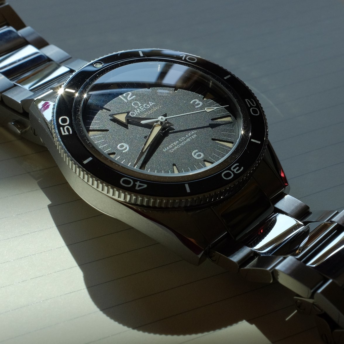

    I have not paid a lot of attention to new releases since I purchased my Speedmaster '57 Replica 3594.50 in 1999. I came across this watch recently and I like everything about it from the movement and the anti-magnetic technology to the polished surfaces, the bracelet micro-adjustment, the lume, and even the white second hand. It wears a bit heavier than my Speedmaster and it took about a month before I was very comfortable wearing it. Regarding performance, it started out gaining 2 seconds per day and over 5 weeks that drifted up to 6 seconds per day. The day to day variation is very small and I don't really know if it's done settling in or not. I've gotten into a routine of setting it 20 seconds behind on Sunday morning and expect it to be approximately 20 seconds ahead the next Sunday. Unless the rate goes much faster, I'm fine with +6s/d. I plan to wear this Seamaster full time for the next two or three months and then switch off with my Speedmaster, which is now being neglected except for winding it every day.

  2. BostonCanuck Aug 24, 2017
    75
    77
    That's a fabulous picture of a fabulous piece. Love the contrast of the light across the dial and shade on the bezel.
    It nicely highlights one of my favorite features of this watch, namely its recessed hour indices.

  4. José9 Aug 24, 2017
    77
    129
    Awesome picture of one of my favourite watches. Thank you for sharing!

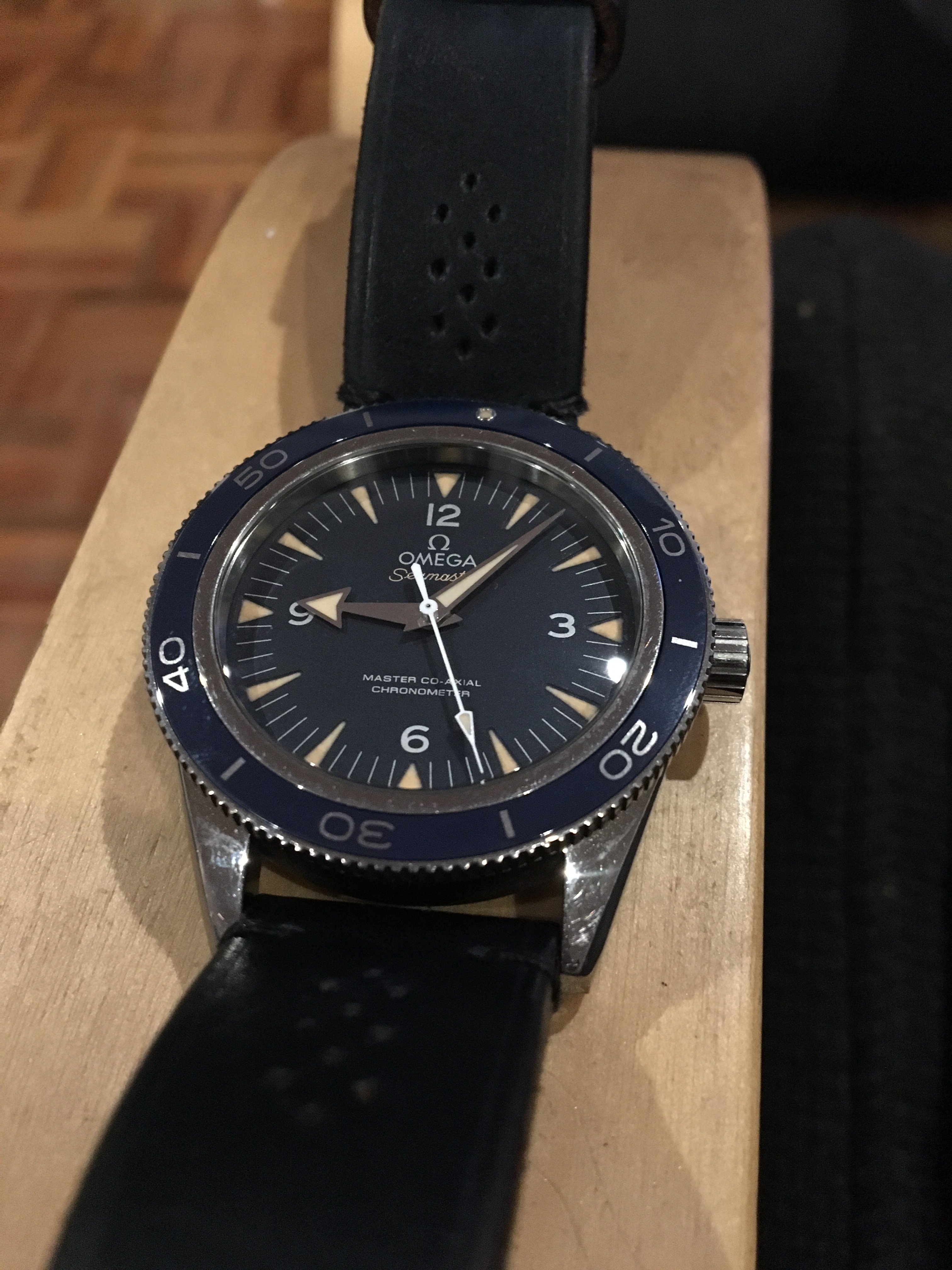

  14. Morrisdog Sep 6, 2018
    138
    796
    A561927F-EA4F-4C74-A17D-C6621291D6D2.jpeg I love mine!! I have now had it for 3 and a half years. Remains my favourite! It’s still maintains very accurate time.. now only gaining about 5 seconds a week.

  15. Archer Omega Qualified Watchmaker Sep 6, 2018
    26,463
    65,604
    There's no "perhaps" here...there's a "definitely" involved though...
    Doc Savage and Davidt like this.
