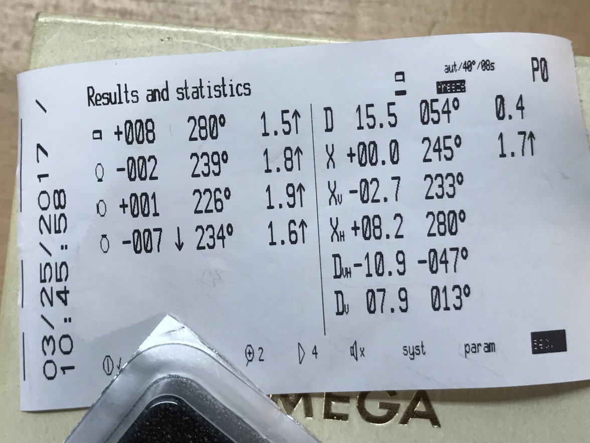

Thankyou @watchtinker . I will make some enquiry.
When you say 'quality' of work done, what technical information would a watchmaker typically include in such a report?
Thanks.
Jonathan.
Hi Jonathan, a simple rate report in six position, which includes measurement of amplitudes and beat error, is quite indicative of the quality of the work done. Some time ago, in a sale post @Varnado provided a simple example of the slip which should accompany any service:
I hope this may help.
Regards,
Maurice

Ahhh... yes that looks very technical to a novice. I will make some enquiry. STS are very helpful, I'm sure they will oblige.
Thankyou Maurice.馃憤
