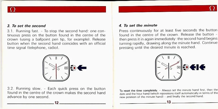

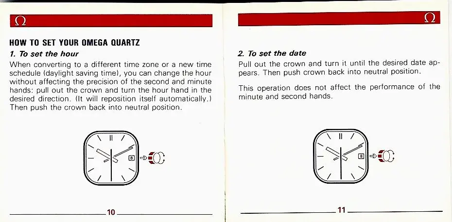

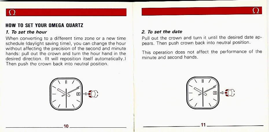

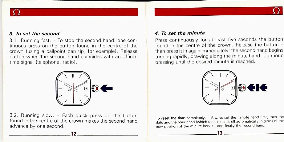

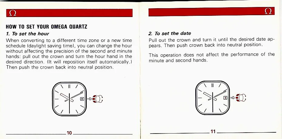

Turning of the crown only sets the hour hand. To set minute and second, you need to push the button in the center of the crown for 5 seconds, release, and quickly push again. The second and minute hands will advance. Do a search on Youtube on "omega 1342", you will get a number of videos explaining how to set the watch.
