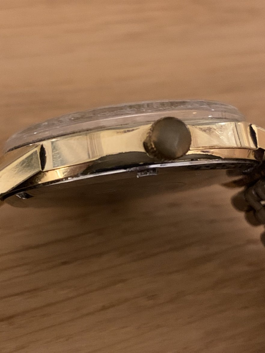

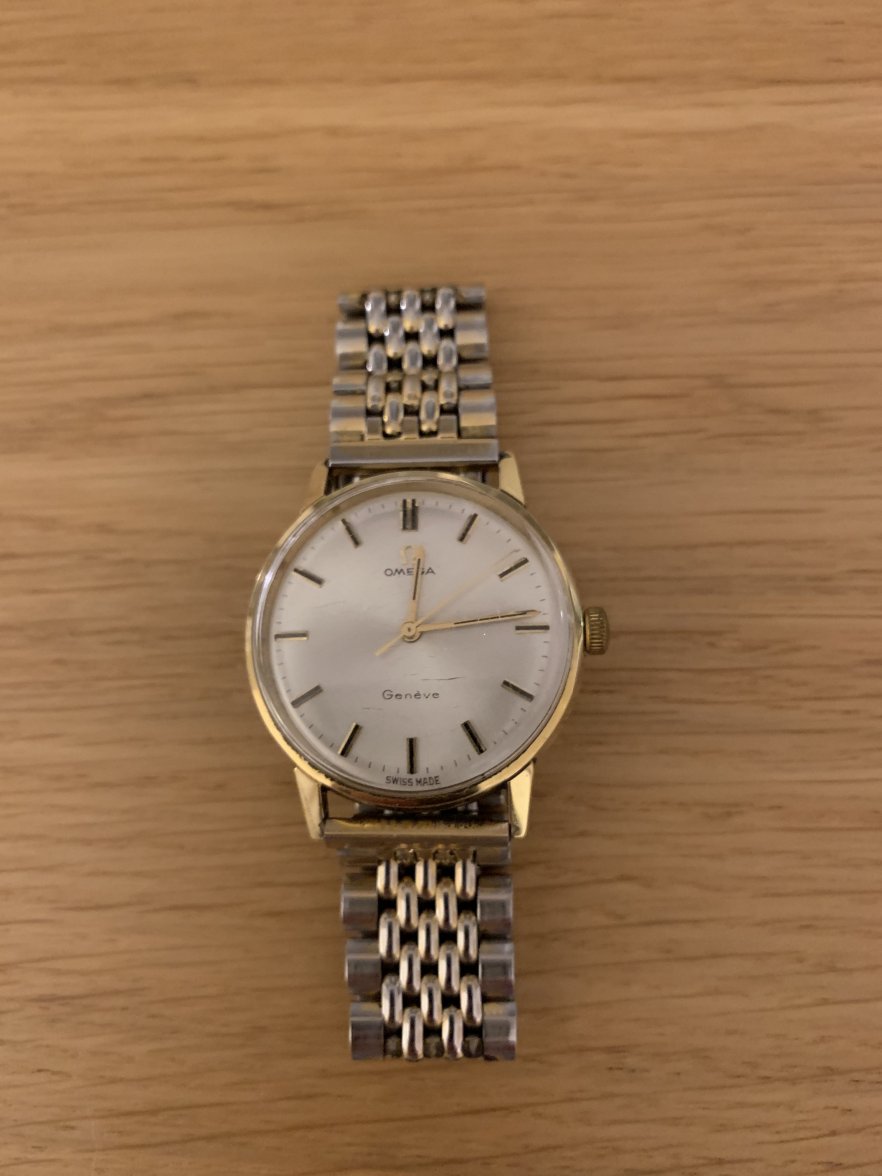

This is my late Dad’s ‘68 Seamaster Geneve. The watch that started my Omega interest as a kid. Would love to have it restored. Unfortunately, the case has had a lump taken out of it next to the crown (presumably during a botched attempt to open the case) - is damage like this even repairable? Anyone know of a reputable restorer in NE England?

That’s just wear to the gold plating and brass case beneath it. Not really reparable at least cost effectively.

I have sent a couple cases/bezels for replating to http://www.replateit.com/ in Canada and have been very pleased with their work. You can send the photos in for a quote, my guess is that the repair would cost ~150GBP. Well worth it IMO if you intend to keep the watch.

After some googling, found this guy in Bucks:
https://www.watchcaseworks.co.uk/
Anyone have any experience of using him?
I have. He did excellent work replating a case for me. If it's possible to graft on a bit of gold cap (which I have some doubts about), I think he'd be the man to do it but it wouldn't be a cheap job.
