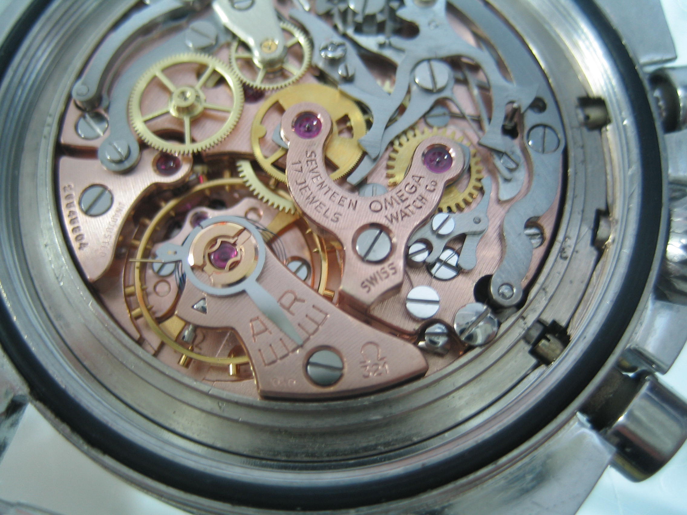

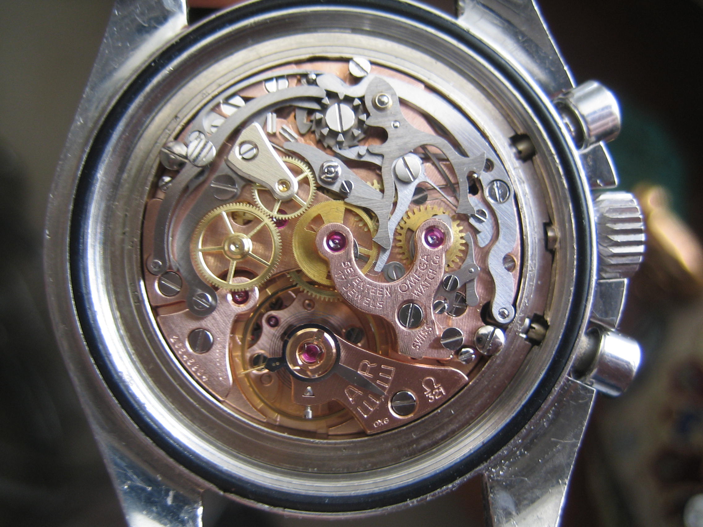

  1. 250scr Jan 7, 2015
    936
    1,486
    Hi, I would like to know if the movement pictured is a correct movement for this 145.012 and if you see any missing parts or if something does not look the part. Thank you
  2. Barking mad Prolific Speedmaster Hoarder Jan 7, 2015
    4,502
    63,784
    Is the serial number on the movement 26mil? If so looks correct. Very clean and shiny.
  3. 250scr Jan 7, 2015
    936
    1,486
    yes it starts with 26. do you think it's too shiny considering it's age?
  4. Barking mad Prolific Speedmaster Hoarder Jan 7, 2015
    4,502
    63,784
    Probably just been serviced. All of the screw heads look good.
  5. 250scr Jan 7, 2015
    936
    1,486
    Ok great, so this movement in your opinion is one that you would not worry about then as far as correctness and completeness? thank you
  6. mozambique Jan 7, 2015
    746
    412
    Too shiny may be a bad thing for the case, but as far as the movement goes, I would say its a very good sign indicating recent service
  7. dsio Ash @ ΩF Staff Member Jan 7, 2015
    26,748
    32,464
    Looks pretty good and clean clean on the movement side at least
  8. Archer Omega Qualified Watchmaker Jan 7, 2015
    26,337
    65,027
    Or it's never been serviced. I would lean towards that personally. I can't see enough detail of the balance jewel to see if it still has oil in it or not.
    Unless you have proof it's been serviced recently, I would assume it has not.
