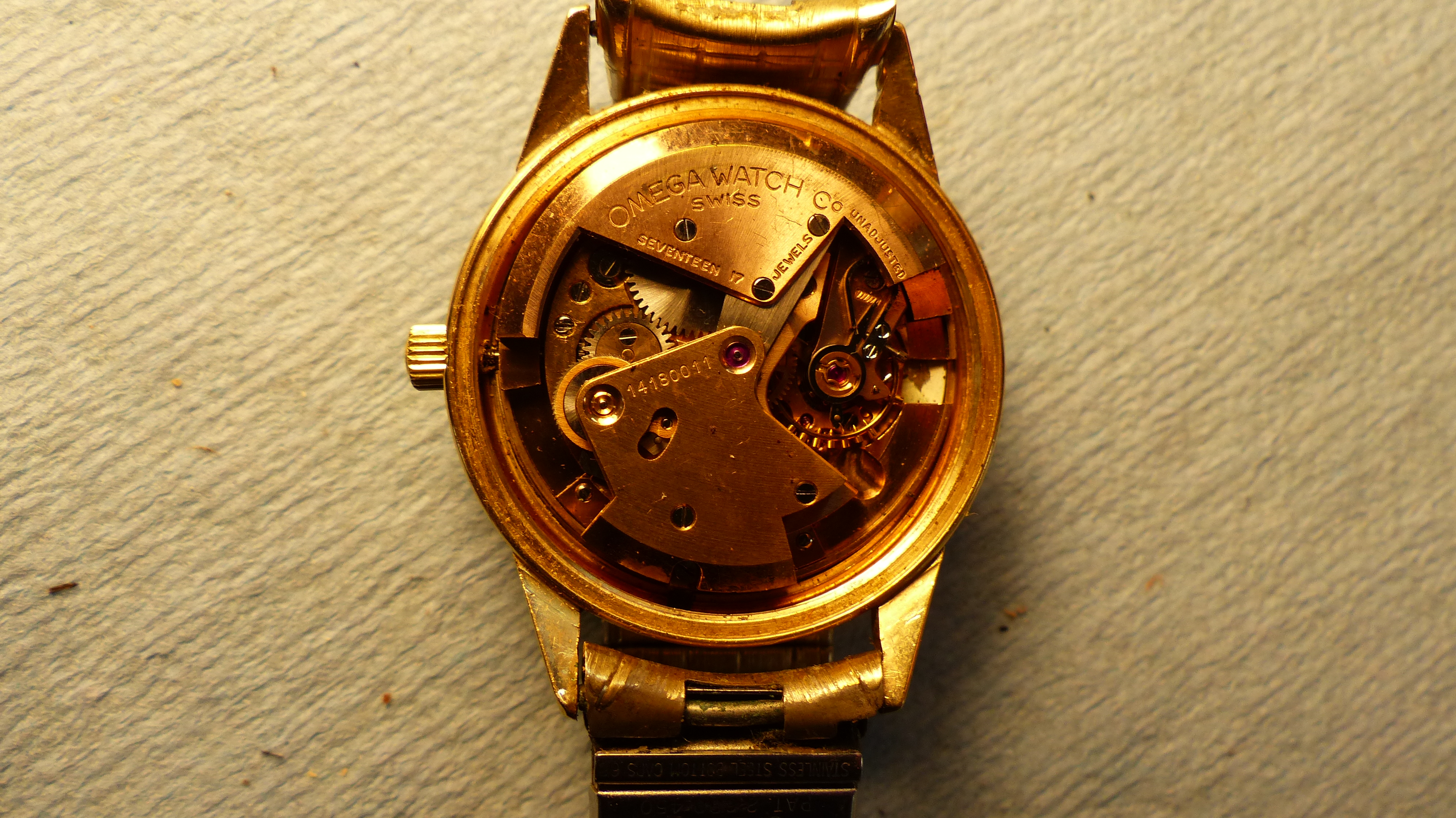

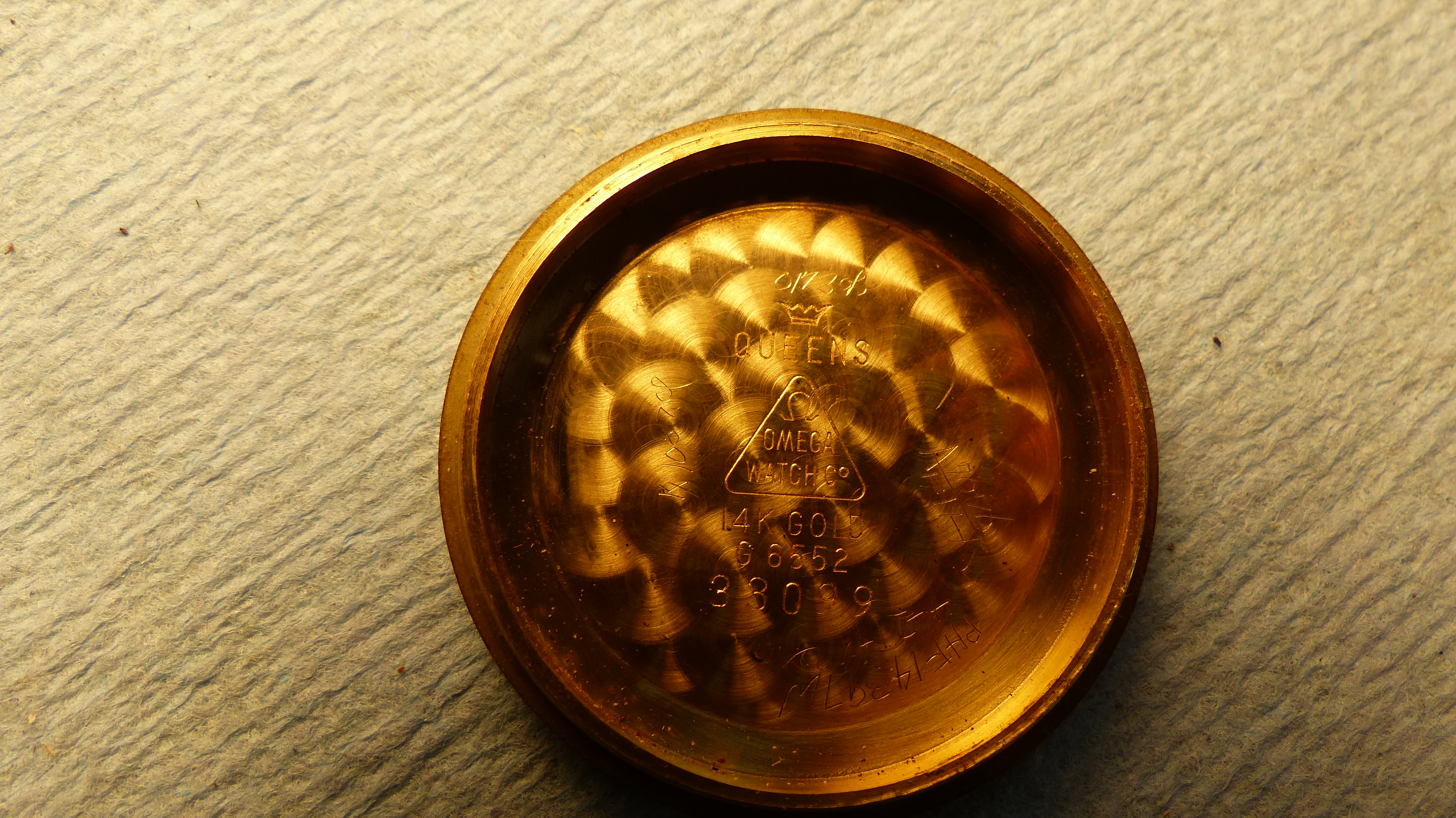

So I’m the 647th guy this year with an old Omega watch looking for some help. This watch was passed to me through the family and I have no idea as to its history. We were not a family that could afford Omega watches

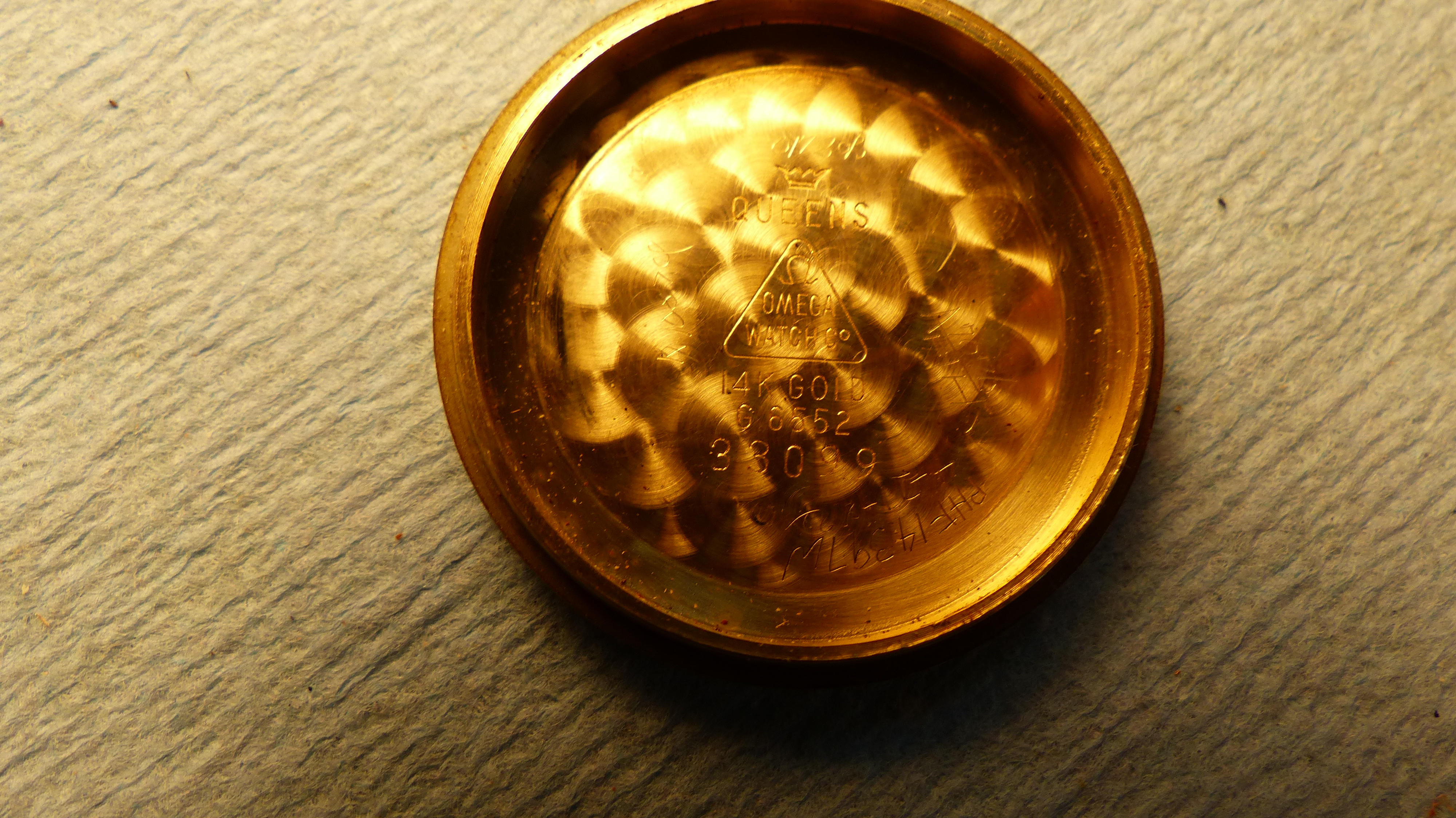

I have the back off and have figured out the model is a G 6552 and the serial number 14180011 dates it to 1954. But the inside of the case back has all sorts of marks and engravings that mean nothing to me. Is there a source to help interpret these markings? All I can figure is that some are engraved dates of when the watch was repaired or serviced, much the same as luthiers do. But what is “Queens”? Is there a name for this model other than G 6552?
Any help would be much appreciated. I would like to get it serviced but don’t want to spend hundreds of dollars on a $65.00 watch, if you know what I mean. Thanks everyone.

This particular watch does not have a meaningful reference number. It was shipped by Omega to the US as a loose movement and cased by the Queens Watch Case company in a US-made 14k gold case.

The hand-etched markings are from watchmakers who have serviced or worked on this watch over the years.

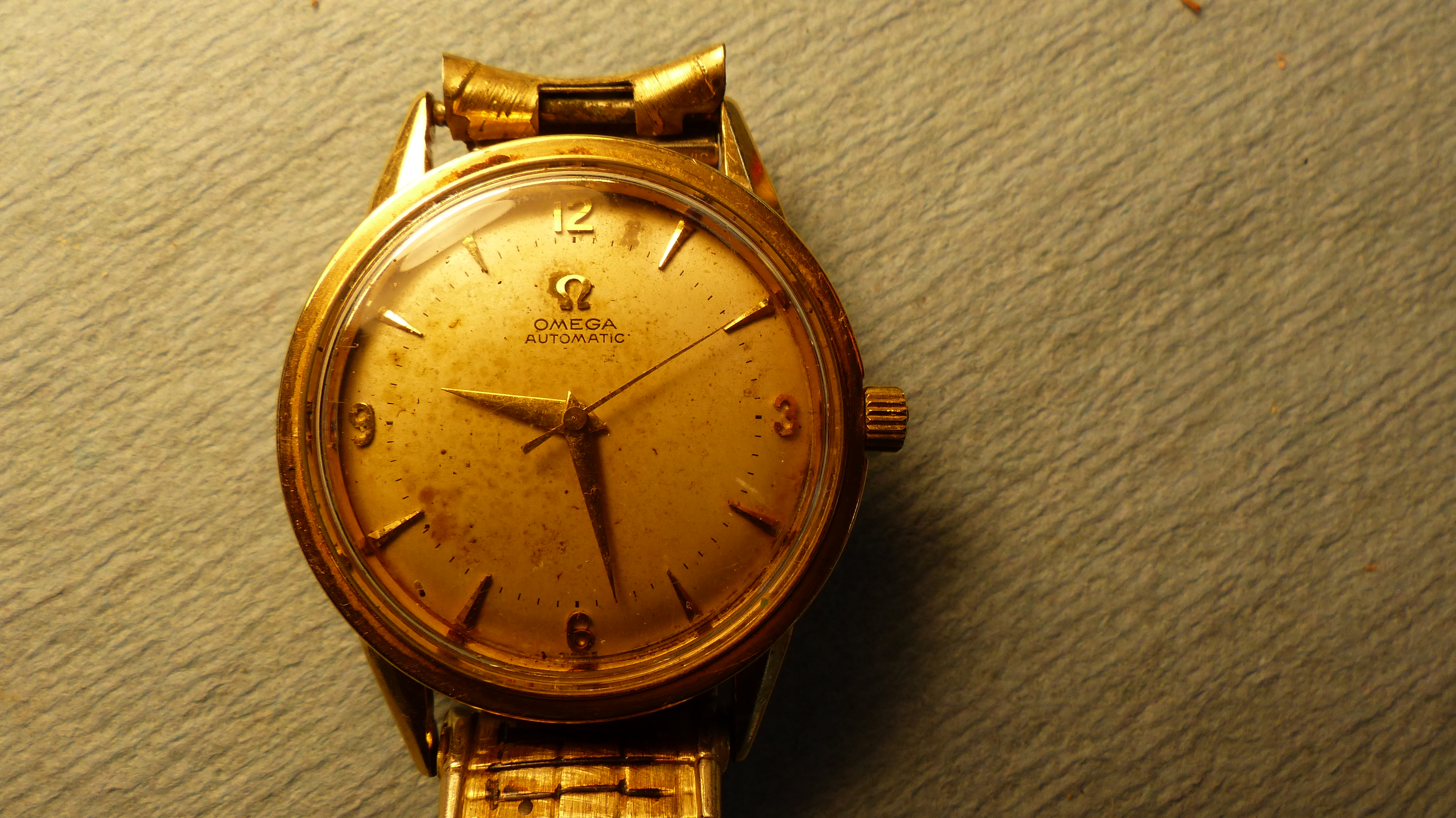

For me, that watch would be a keeper. Definitely worth getting serviced. Solid gold, after all…

Looks nice - I’d swap out the bracelet with those odd endlinks and put it on a nice leather strap.
So, did Omega make a lesser quality movement, like many companies do, to sell to companies like Queens? Is this watch of any value beyond the gold in the case if you can't identify or date the movement?

I don't know for sure, but there are a lot of reasons for the practice of selling loose movements to other countries for domestic recasing, mostly owing to customs regulations. I would definitely not assume that the movement was of lesser quality. It still has Omega's name on it; there would have been zero incentive for Omega to put their brand on something of lower quality than their competitors.

It is a totally authentic Omega watch with the same movement as in all-Swiss models. The movement has a standard caliber number and the movement serial number gives a production date. It doesn't have a standard reference number and is not identical to any particular Omega reference, but the value will be comparable to a similar all-Swiss reference, just slightly less.

And it's a very handsome watch. Someone in your family was not screwing around when they picked that one out.

The movements were the same as they'd put in their own cases. The reason for exporting just the movement was usually mundane financial - import duty on the case calculated on the gold value, and price of gold in Switzerland vs. the United States.
This is a nice watch and should have another chapter to its life.
