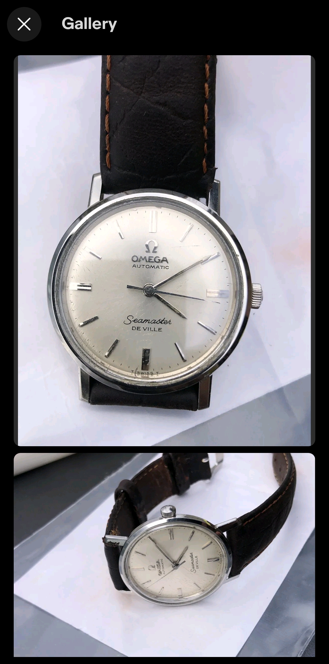

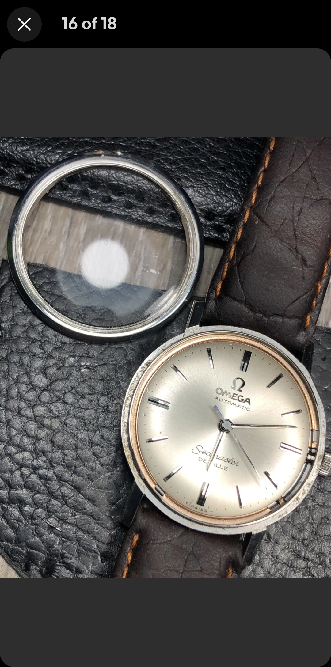

Hi,
I was hoping for some opinions. I was looking for a mid size boys for my wife. Seen this but some stuff adds up & doesnt add up. Is it real or not....? Seller is selling as mens full size, which I dont think it is.
So I think its a mid size, 67x cals wer used on boys & ladies. 55x wer used on mens.

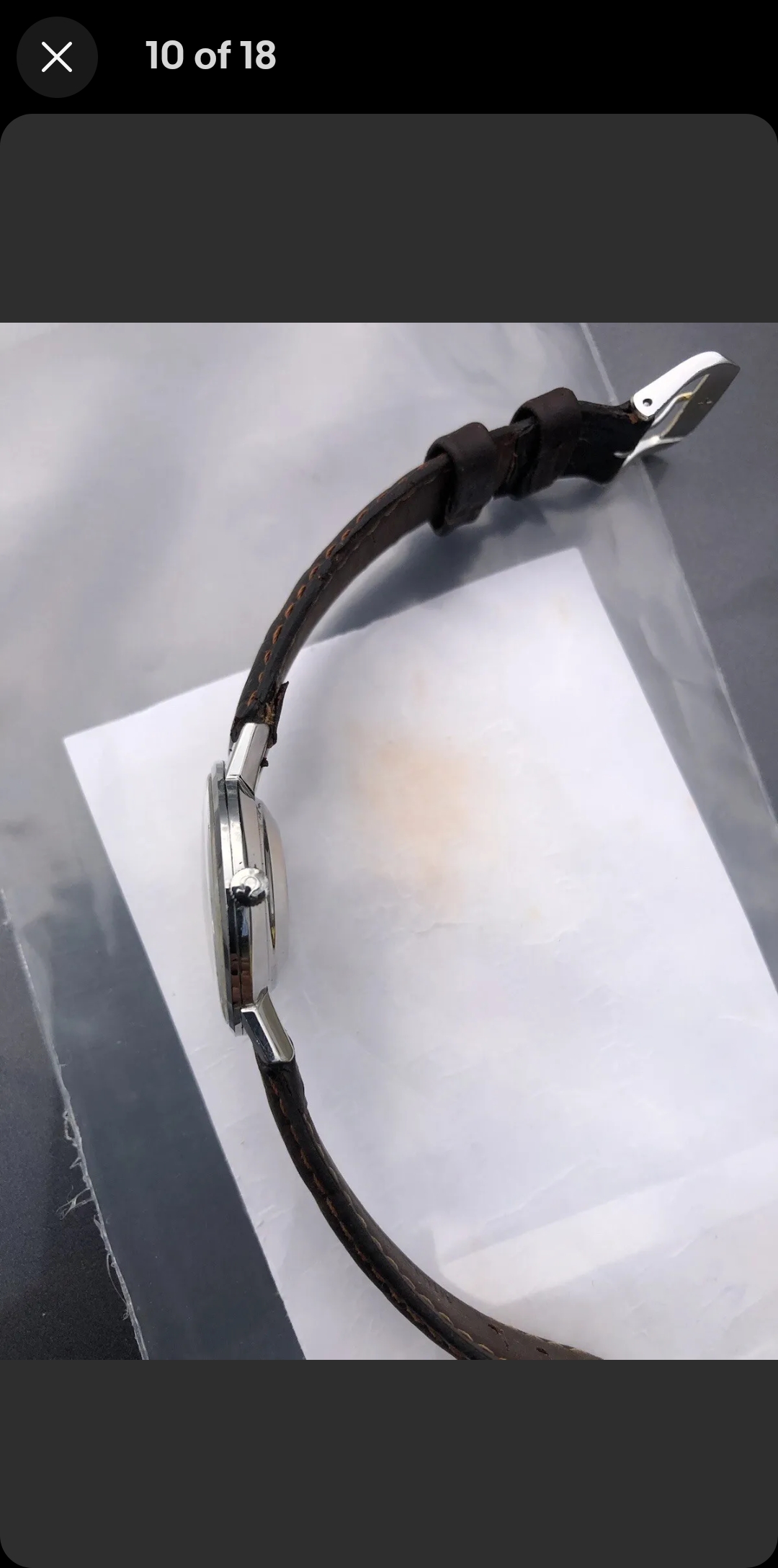

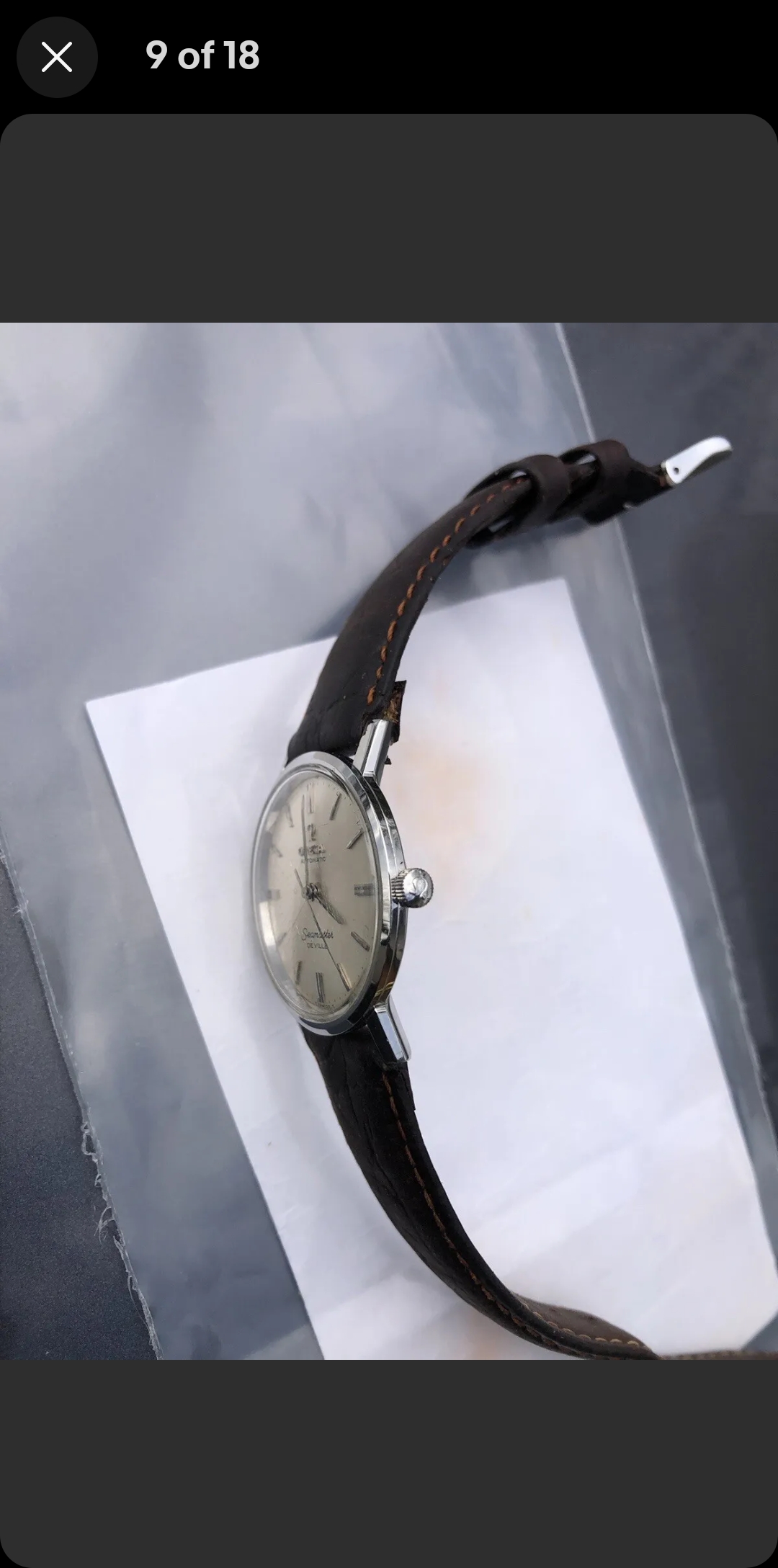

Size wise the ladies was 29.5mm, boys 32mm & mens 34.5 without crowns. But the sell lists as 33mm? 18 Strap looks really tight at the lugs.

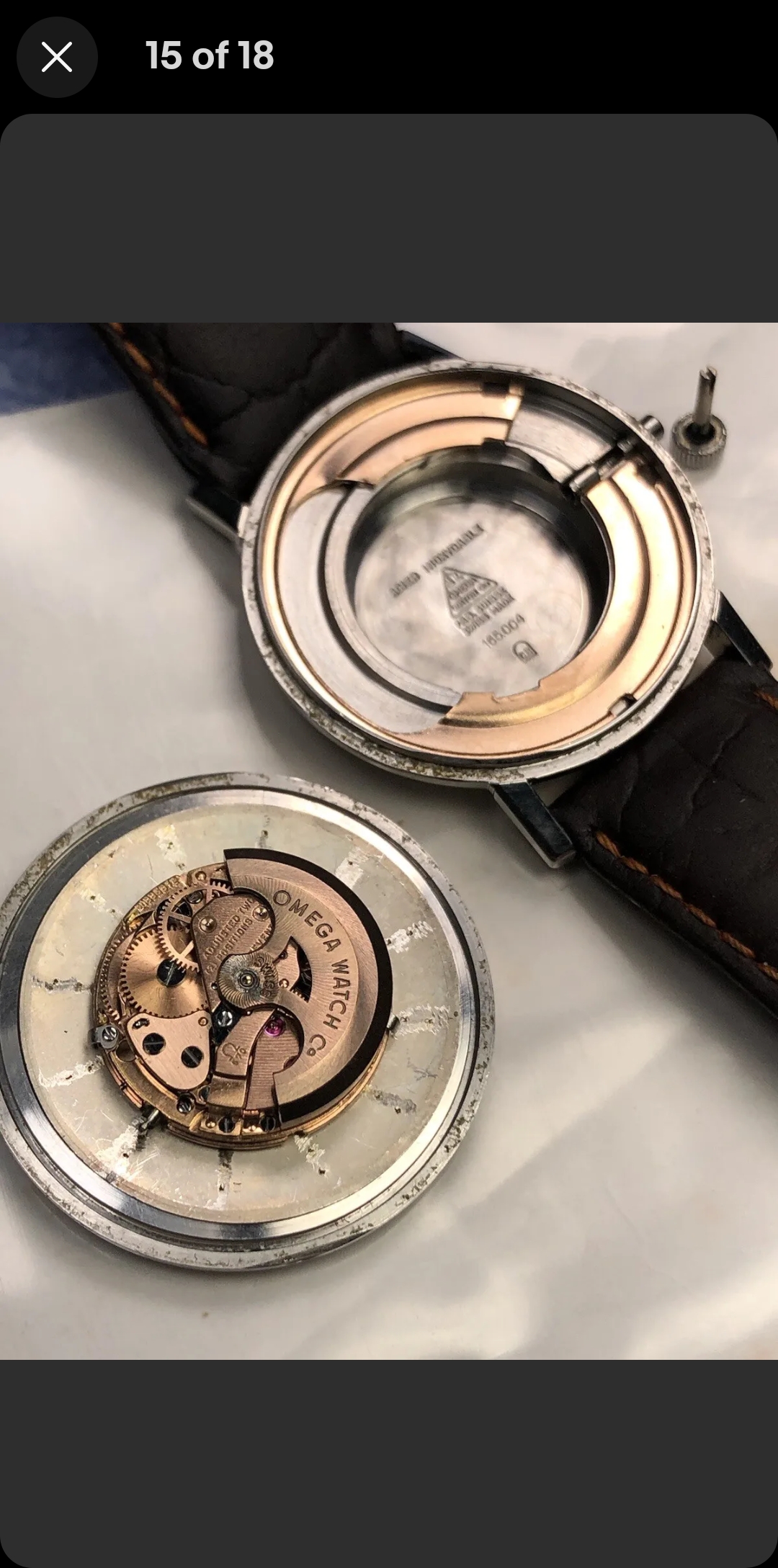

The back of the dial looks to have been ground down at the indices?
I think the watch is 1963ish or franken?
Any opinions or advise welcome.

Very much real but its a mid-sized 32 mm case rather than the more typical 34.5 mm size for De Villes

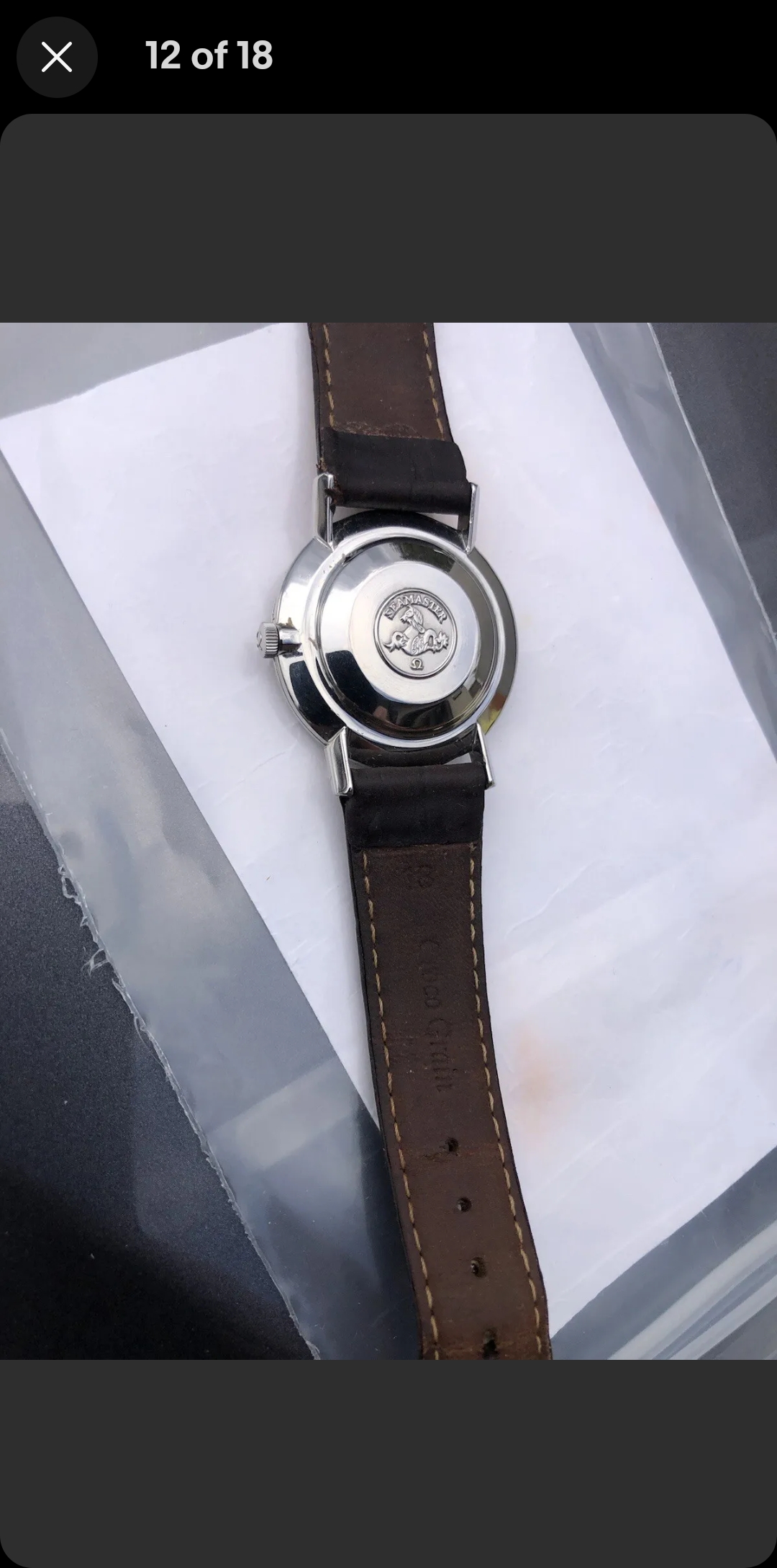

You can see the reference 165.004 inside the case-back. With that reference number, you can find a lot of information using Google.

Can I ask..... why would the indices look ground down on the rear? Would somebody remove them, polish them & solder back on?
Its in such good condition, I was thinking redial. But I think the dial is at the very least partly original?

The grind marks are normal. When the index markers are mounted to the dial, the exposed legs on the back side have to be removed after being "riveted".

It is real, I have the same model, but in 14K. In gold it is ref. B6617. The lower printing is fading on my dial and I have been looking for a dial from a stainless or clad version (one from a gold version costs as much as the watch), but didn't know the reference number. Thanks to you I now do. By the way, there are a number of men's dressier watches from this era that contain smaller movements to keep them slim. Fun fact, the cal 670 is based on the manual wind 620....which is found in many dress watches.

This is a Seamaster de Ville belonging to the Seamaster line, and not a De Ville. 😀
