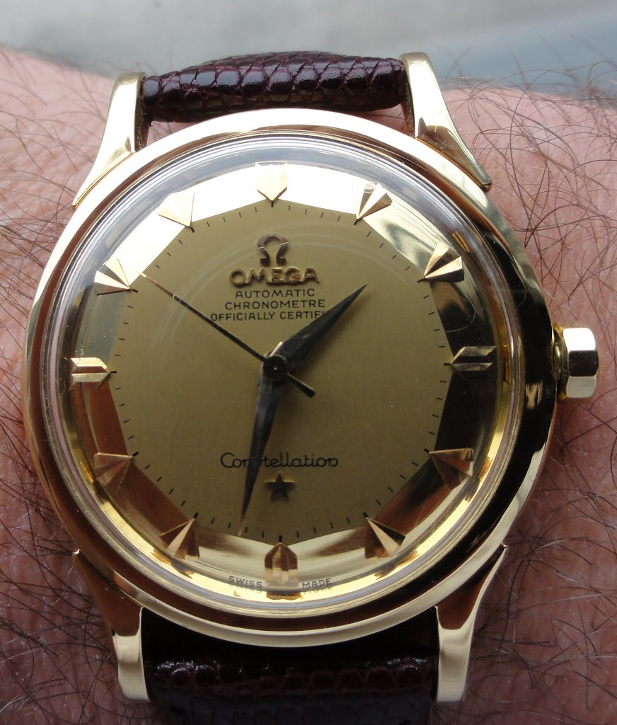

    18K Constellation with gold dial (ref. 2799 from 1954)
    Not all have the OM!
