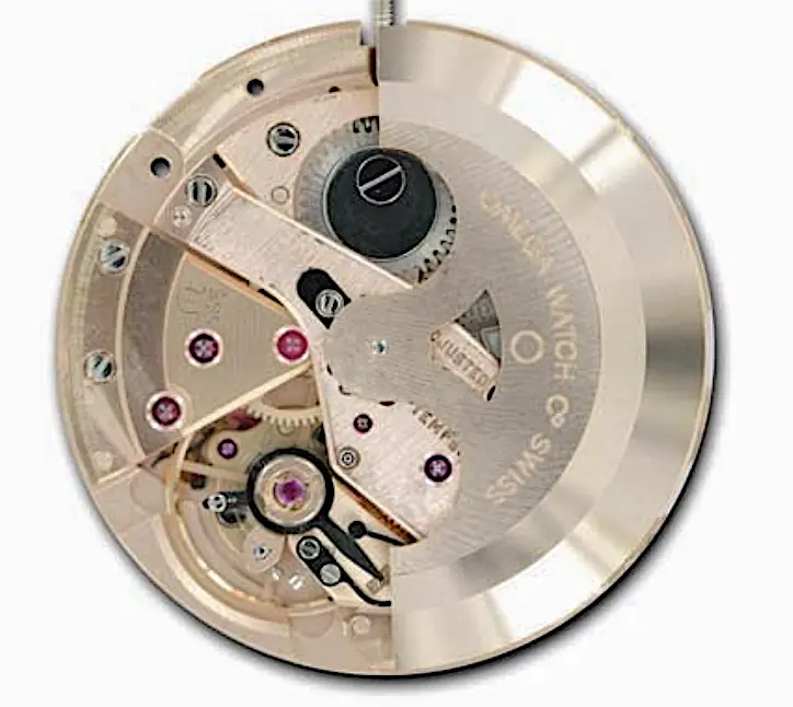

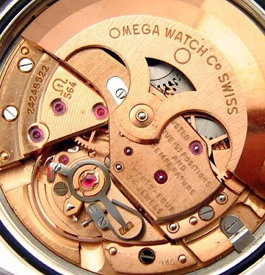

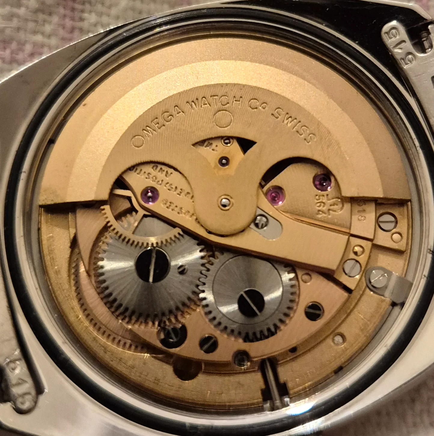

Hi everyone,
I have a question about vintage calibers. On the 564 calibre, we can fini different models of rotor. On the pictures, you can see 2 models and it is real 564 calibers. Could you tell me why ? It depends on the serial number ? Production date or other thing ?
Thank you !

Many of the 500 series movements had parts that were interchangeable between models. I suspect there are differences to to replacement rotors being substituted during repair work.
The Omega Tecg Guide shows this style.
There could have been variations in production runs, but I can't confirm that.

It’s been suggested that the rotors with the circle under the word ‘watch’ are service replacements.
Also, a watchmaker once told me that the rotors with the less elaborate pivot point (last of your pictures) are from later production movements, whereas the more elaborate/raised pivots are from movements early-mid production. I don’t know if this is true or not but it’s what I was told.

It's possible. The serial number on the second picture begins by 3xxxxxx. On my constellation it's the same.
On the other it begins by 2xxxxxx.

Also, keep in mind that for a long time, parts were available for everyone and much cheaper than today. The whole auto winding module including the rotor could be easily swapped.
This can explain the variations that don't follow the chronology of the serial numbers.

Let’s be definitive where we can.
The ‘simple’ rotor appears on later Constellation movements - from around the end of the 60s.
If it is in an earlier movement it is a replacement.
Less definitively, it is now commonly thought that the circle symbol on a rotor defines a service part but to my knowledge there is no written evidence to prove this point.
Replacement rotors are not usually an issue with collectors but a simple rotor does look wrong on a watch that didn’t have one originally. ( mainly because they are not as attractive as the earlier rotor style)

Thank you for your reply. It seems to be difficult to have the truth but I understand, it seems to be a good analysis. But if you have to change rotor, I think you don't have the choice. If Omega stopped to produce the first style of rotor, you have to use the last, it's still a 564 caliber despite everything.

IIRC, at one time the rotor and bridge would be replaced as a unit, so yes, a replacement rotor would be the new less attractive version.
Nowadays watchmakers can use the old rotor with a new bearing, so best of both worlds.
