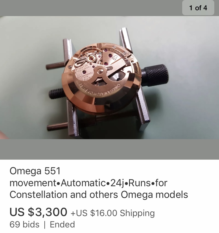

    Curious what folks think of this: https://rover.ebay.com/rover/0/0/0?mpre=https://www.ebay.com/ulk/itm/333000122106

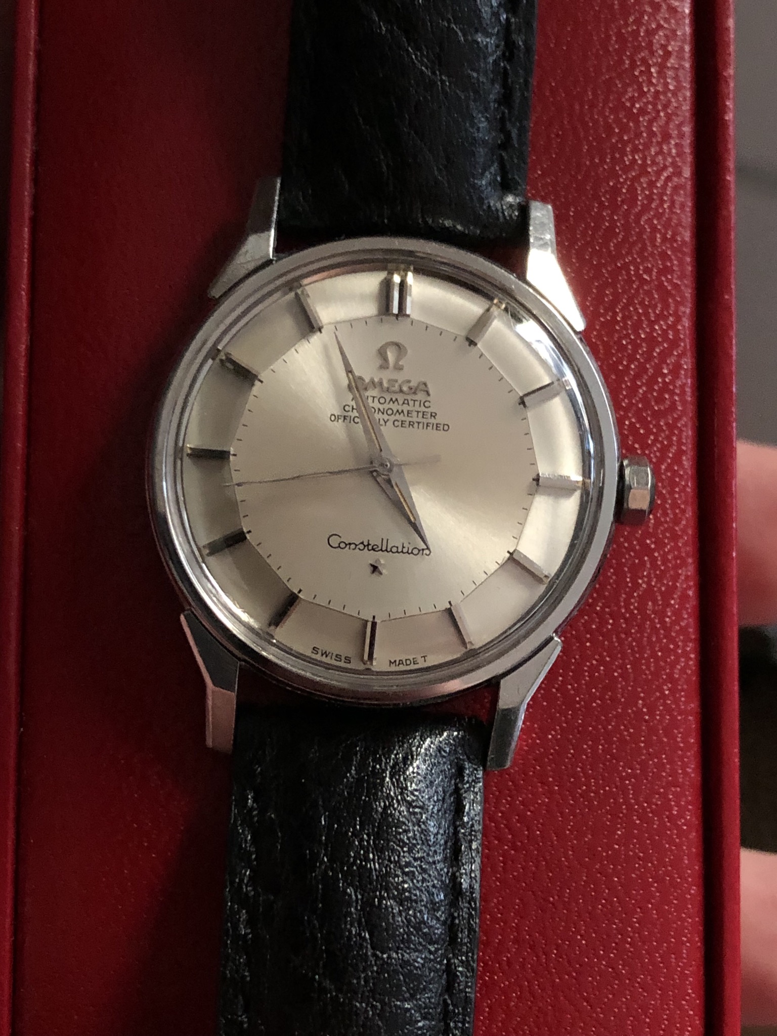

    Backstory: I’ve got a 167.005 pie pan Connie that used to be my late grandfather’s (his Omegas — and a love for Omega, and watches, that I also inherited from him — deserve their own thread at some point, but that’s for another time) and I’m thinking this could be a useful buy just to have backup/spare parts in future years in case something breaks? But maybe I’m wrong?
    Here’s a pic of the Connie:
    And here’s a pic of what’s currently inside — which I’d like to see keep ticking for a long, long time! (NB: please ignore the incorrect service crown. This photo was from before I got that changed out; it was right after I finished getting the movement serviced last June so I could wear it at my wedding this past November.)
    Worth having a backup movement for it?

    Nice Constellation.
    A lovely memento of your grandfather.

    I think it isn't a bad idea to have a parts movement, as long as it isn't clapped out, especially for an heirloom watch that you may intend to pass on to the next generation.
    Parts from the mid-500 series are getting harder to find, and one day donor watches will be the only resource, so having a parts movement is a form of insurance for the future.
    Your Grandfather's watch looks pretty good, and with regular servicing, a little care and a ready supply of parts, who knows how long into this century it will continue to beat it's little heart away :)

    One thing I should mention here is the serial # of the one you are considering to buy. It has 17 mil serial # stamped on it and only good for earlier case ref like 14381. If you swap the whole thing into your watch, serious collectors will frown on you.

    Yes, I should have perhaps mentioned that a parts watch is good for everything except the train bridge, which contains serial and calibre number. If that was a problem, re-jewelling would be the only option, in my opinion, if the integrity of the watch was to be maintained.

    Looks like it didn’t actually sell for that. It’s since been re-listed.
