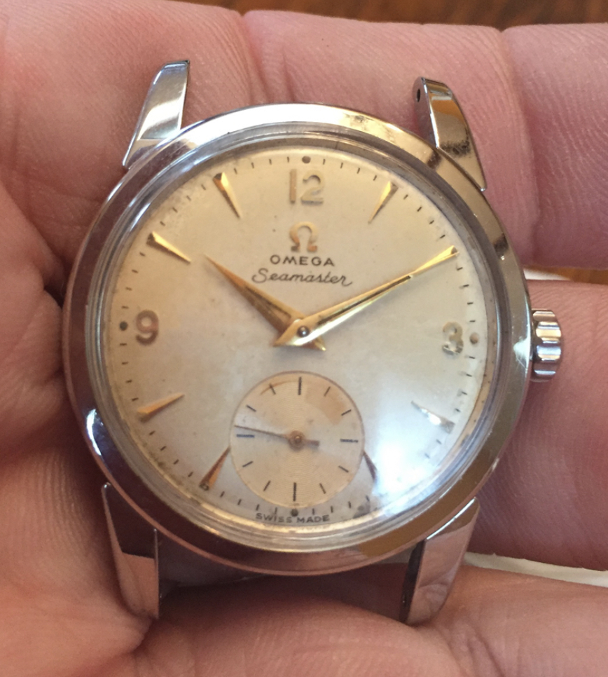

I'm reaching out to see if I can get some advice from you guys about a vintage Omega Seamaster. I came across a Seamaster dated back to 1957/8 Seamaster. Manual wound cal 420.
The seller was stating the dial is original, unfinished. But I discussed this with a local vintage watch enthusiast. I was told that this watch is likely re-dialed because the front might not be period correct. Since the "S" is not "hanger" style.
Since I'm looking for a vintage Seamaster with everything original unpolished( ok with light polish). Should I stay away from this one? What's your thought if it is re-dialed?
Any help would be greatly appreciated!

I believe you have a completely original service dial. These are dials supplied by Omega when they performed service on a watch. It might be the same as the dial it came with, but they are generally "close enough".
Beats the heck out of a crappy refinish, though! If the price agrees with you, I would buy it.

Although the coat hanger S is typical for this period, the wide bottomed S is also seen.
I believe this is original dial, not redialled or service dial.

I too can’t see anything wrong there at all.

Watch looks good. One point of information: that’s a cal 410, I believe. Cal 420 is a centre second manual wind movement.

Dial is fine, crown is incorrect and should be the clover crown but not a major issue.

I too can’t see anything wrong there at all. Even the crown is correct for the model.
+1 regarding originality of the dial, but are you sure about the crown? This one looks like a generic replacement to me, no Omega logo whatsoever (edit: or has it been worn off completely)? I have seen a few of those bowler hat style crowns on them, even more with what looks like a clover crown with a few extra recesses. I do believe both are fine for the ref, just figured it’s a bit late for an unmarked crown. Happy to stand corrected though. 😀
Regarding price: Check eBay, use the advanced search for sold listings of that ref. It’s not uncommon and there are a few examples around. Those manually wound cal 410s and 420 go for less than their 501 or especially bumper siblings. 500-700$ sounds about right I’d say.

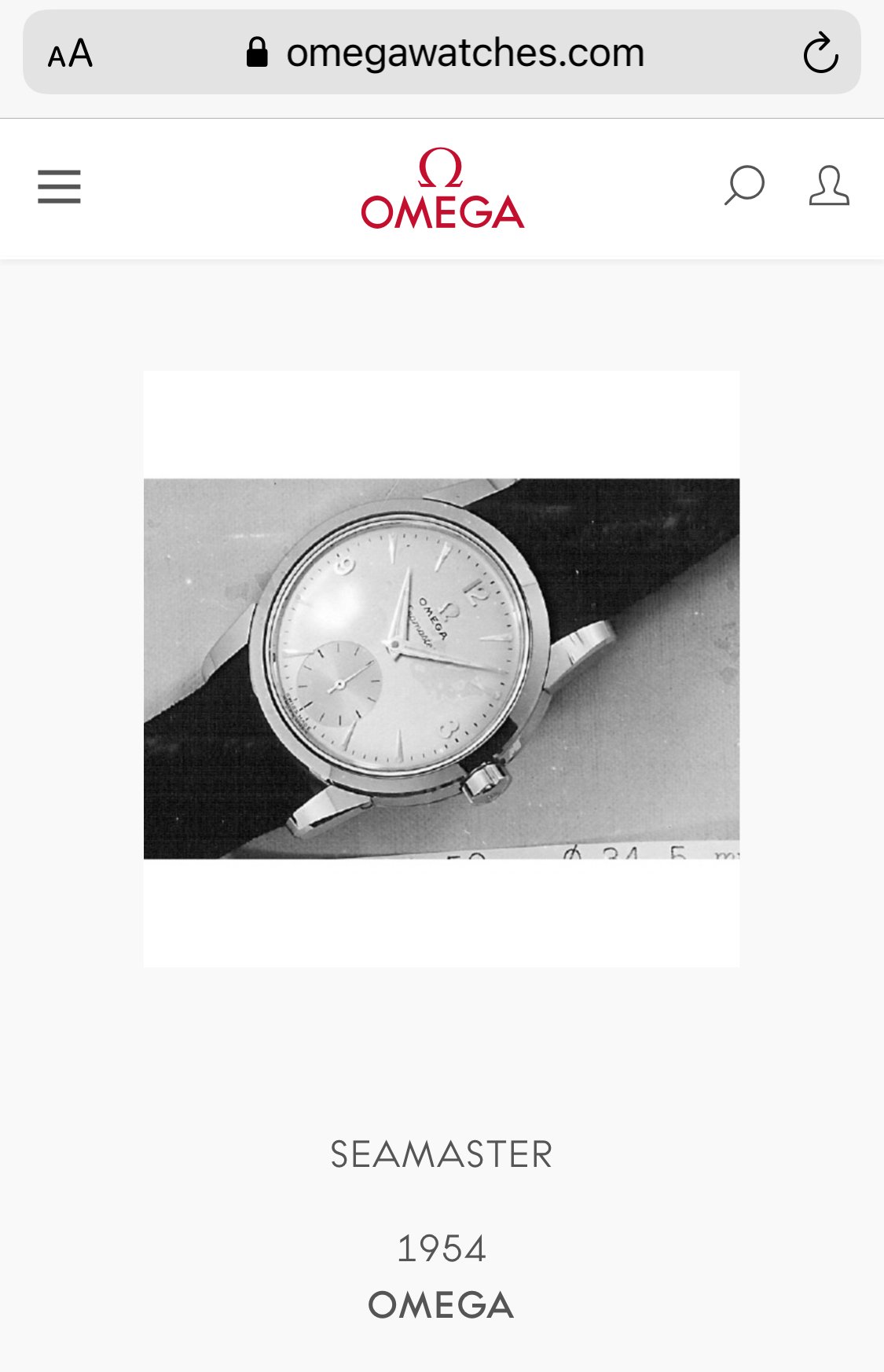

You could be right and certainly happy to be incorrect but the Omega vintage DB shows clover:

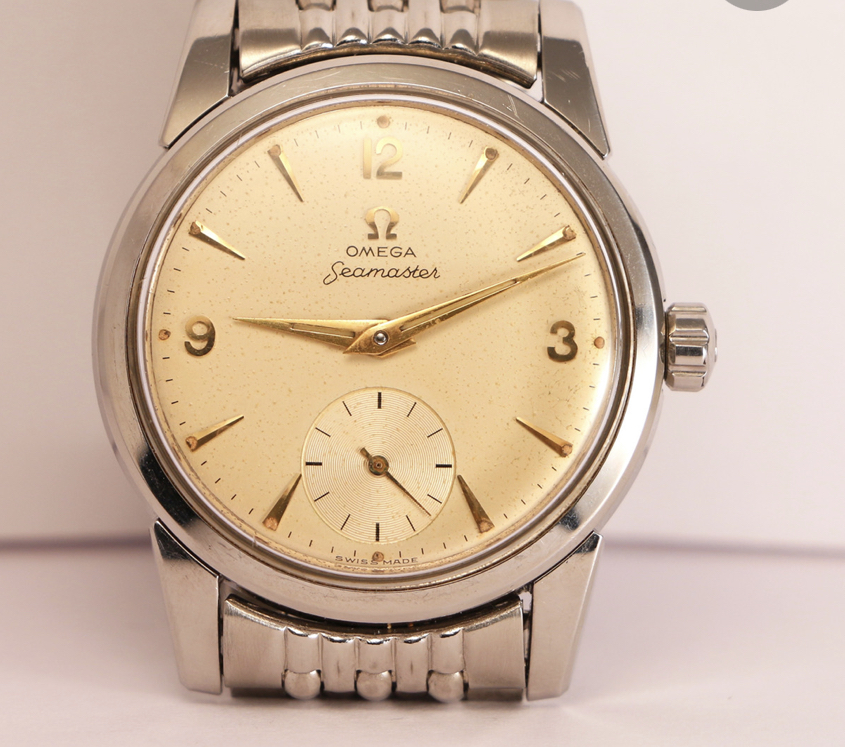

No you are right I’ve had second thoughts about the crown. I vaguely remembered that the clover type isn’t always seen here but I agree this one is dodgy. When I checked my similar 420 model this is what I found…,.
Yeah, I’d think the clover crown isn’t incorrect, but rather uncommon on the ref. Haven’t seen many examples with it, by far the most common is the one @padders showed in the last picture. Here’s another one:

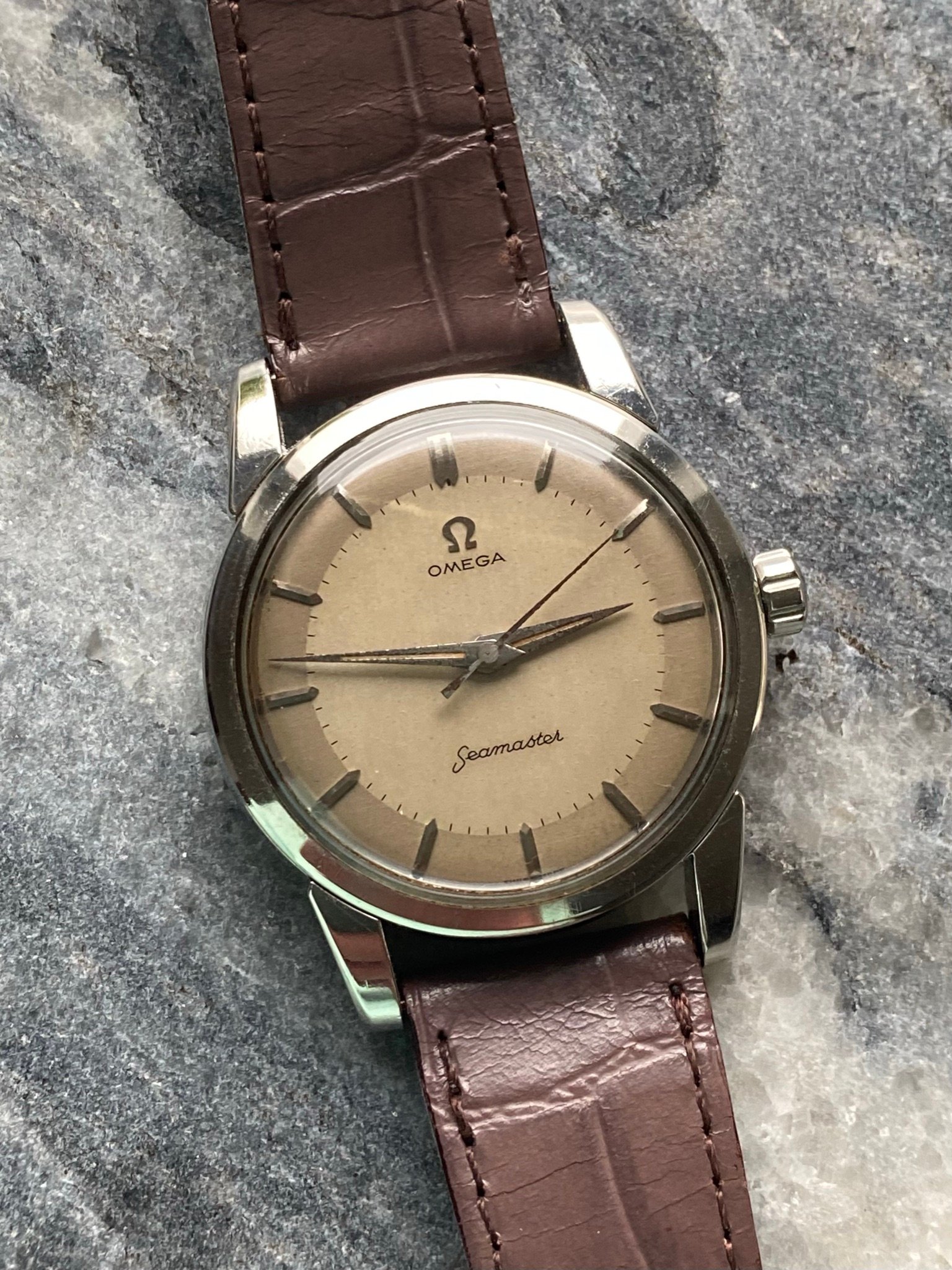

Most, if not all, of the untouched (e.g., unpolished, unserviced, hardly worn, etc.) examples of 2759/2761 refs I’ve seen have had the odd “almost clover” crown. I’m not surprised at all to see clover crowns on these as I imagine it was impossible for watchmakers to source the original one given it was only used on this one, relatively uncommon reference, whereas the clover was used on most Seamasters of the era. Same could be said for the bowler hat crowns given those were pretty common in the years before this watch was introduced.
I have no idea how to “prove” this, however, and as usual with Omega there probably is no correct answer but rather a “most correct” answer.

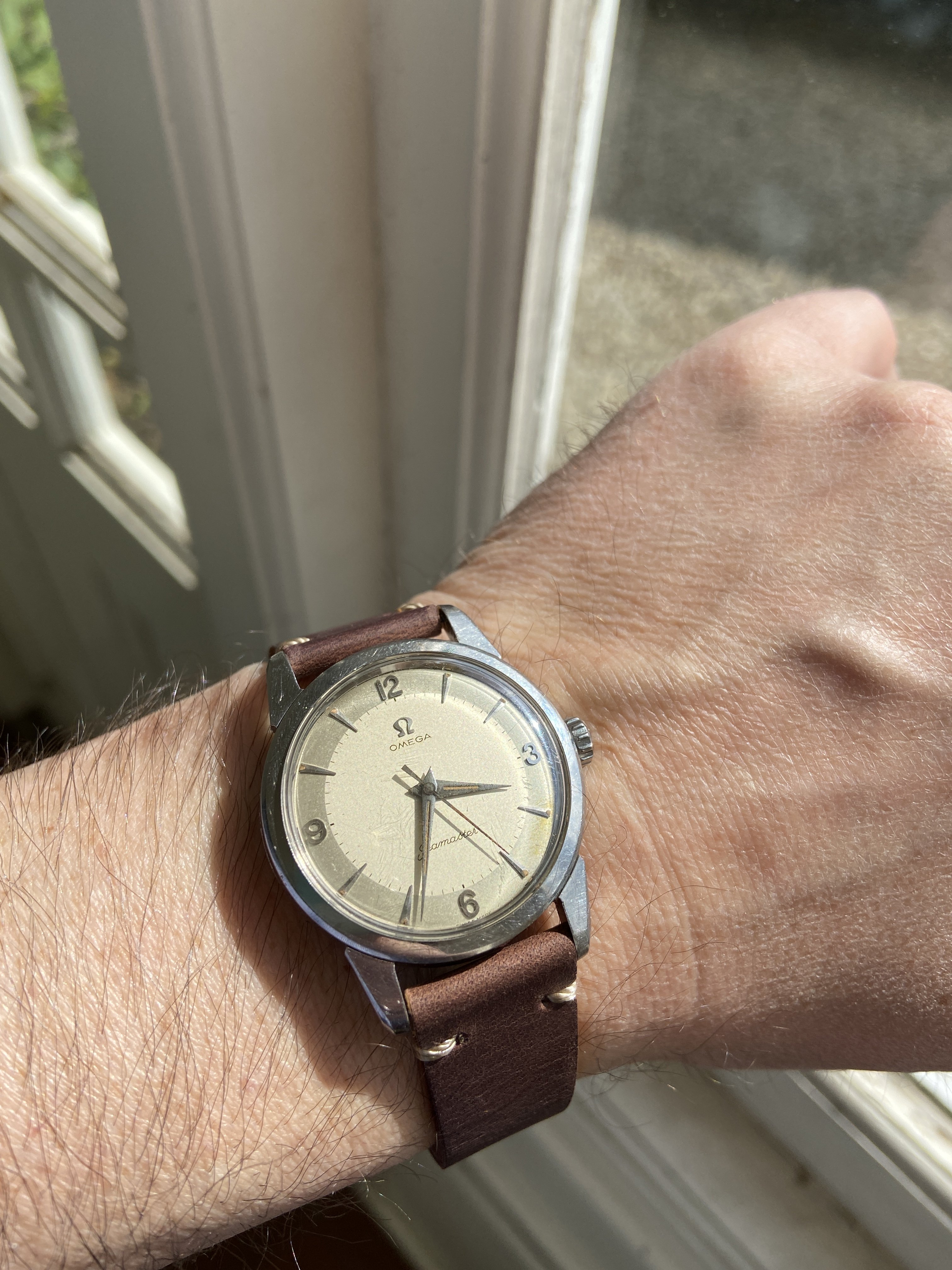

Here’s my old one by the way.

That bowler is an omega crown. You can make out the logo being mostly worn off. It could be original or an early service replacement.
