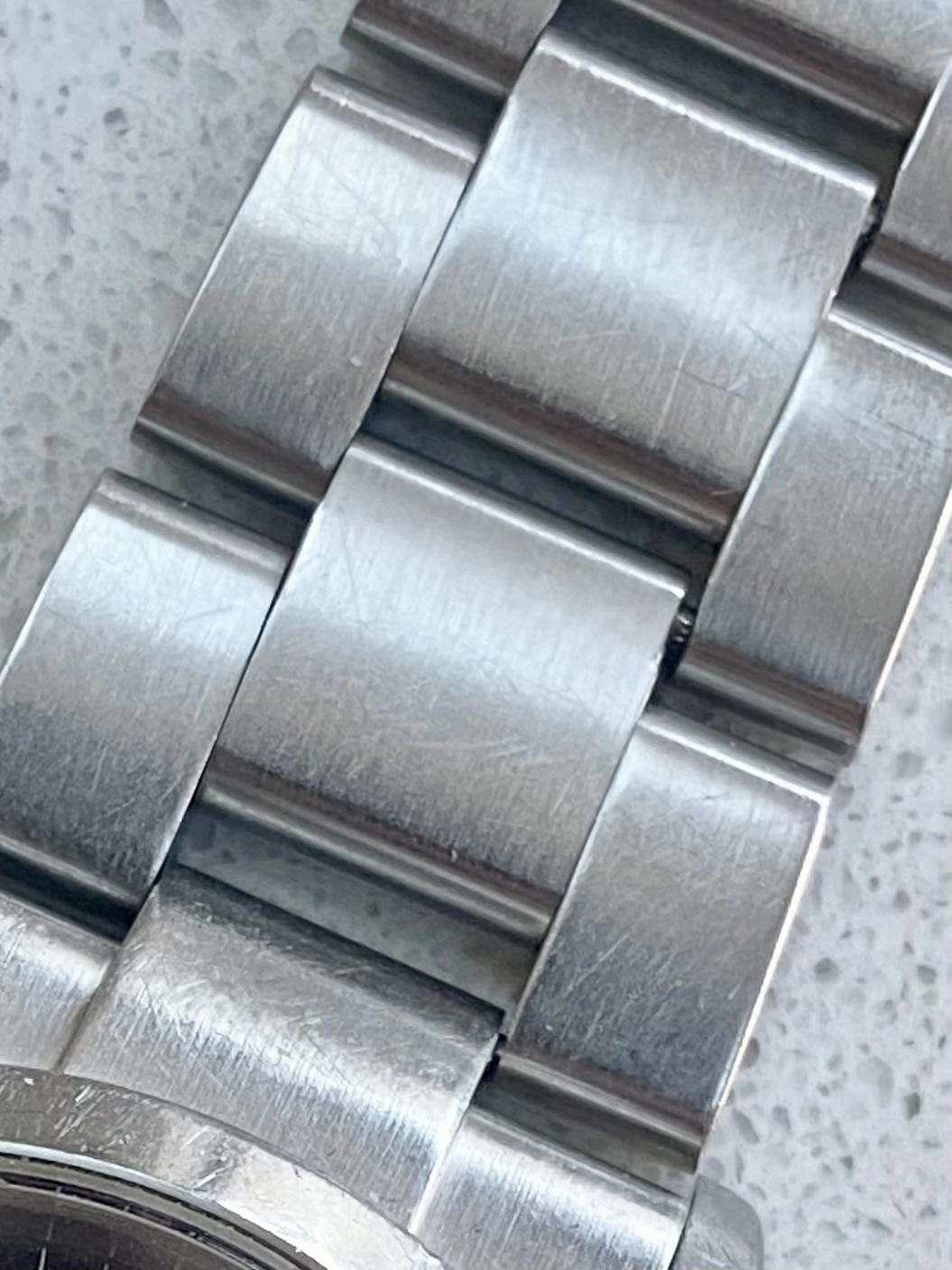

I have an Explorer 114270 with 78690 Oyster bracelet. Some of the centre links are worn at the corners from rubbing against the outer links.
Obviously a full bracelet replacement is an option but is there a way to refurbish these links?
Could they be laser welded and if so, does anyone know of anyone performing this work in the UK.
I guess replacing these links could also be an option but there are 3-4 that have significant wear and the same again with minor wear so I’d probably end up with a full new bracket and just the original clasp which I guess would cost the same as a new bracelet.

Rolliworks does that repair but you’d have to send to Miami. They repaired a 78360 of mine that had this kind of wear. They do it by laser welding.

They charge hourly for laser welding; so it will depend on how much needs to be done. You’d want to have the bracelet re-pinned and tightened + damaged links repaired. You can ask for a quote, Michael Young in HK also refurbishes bracelets. There may be others out there that do it, but those are the two main guys. TBH, I’d check with Rolex for a replacement but they may require a service as well.
Here is how rolliworks charges for repair: $300 for tightening and $98/hr for laser welding. In the case of my bracelet, it was $600 for repair.
BR-OY-PIN - Bracelet Repair - SS Bracelet Repair. Remove stretch. Laser welding billed at $49 per 30 mins. This time will be tallied and added to invoice after work is done. No cost courtesy Polish (or no polish) as instructed by customer. Avg Turnaround time 3 (UOM = hr)
LASER-OY B-R Hour - For BR - Laser welding needed to complete band repair - Repair damage to inside of links - missing steel - laser weld and fill most damaged pieces - file flat and refinish to original Center - 0 hrs Ends - 3 hrs (UOM = hr)

I have never used him, but there's also Vintwatches in Germany. You can see an example of how he adds material by laser welding (@15:38):

There’s a company in the UK called SwissRefurb which gets good reviews and seems to do both re-pinning, polishing and laser welding.
From what I can gather the costs are comparable to Rolliworks so I might look at them.
