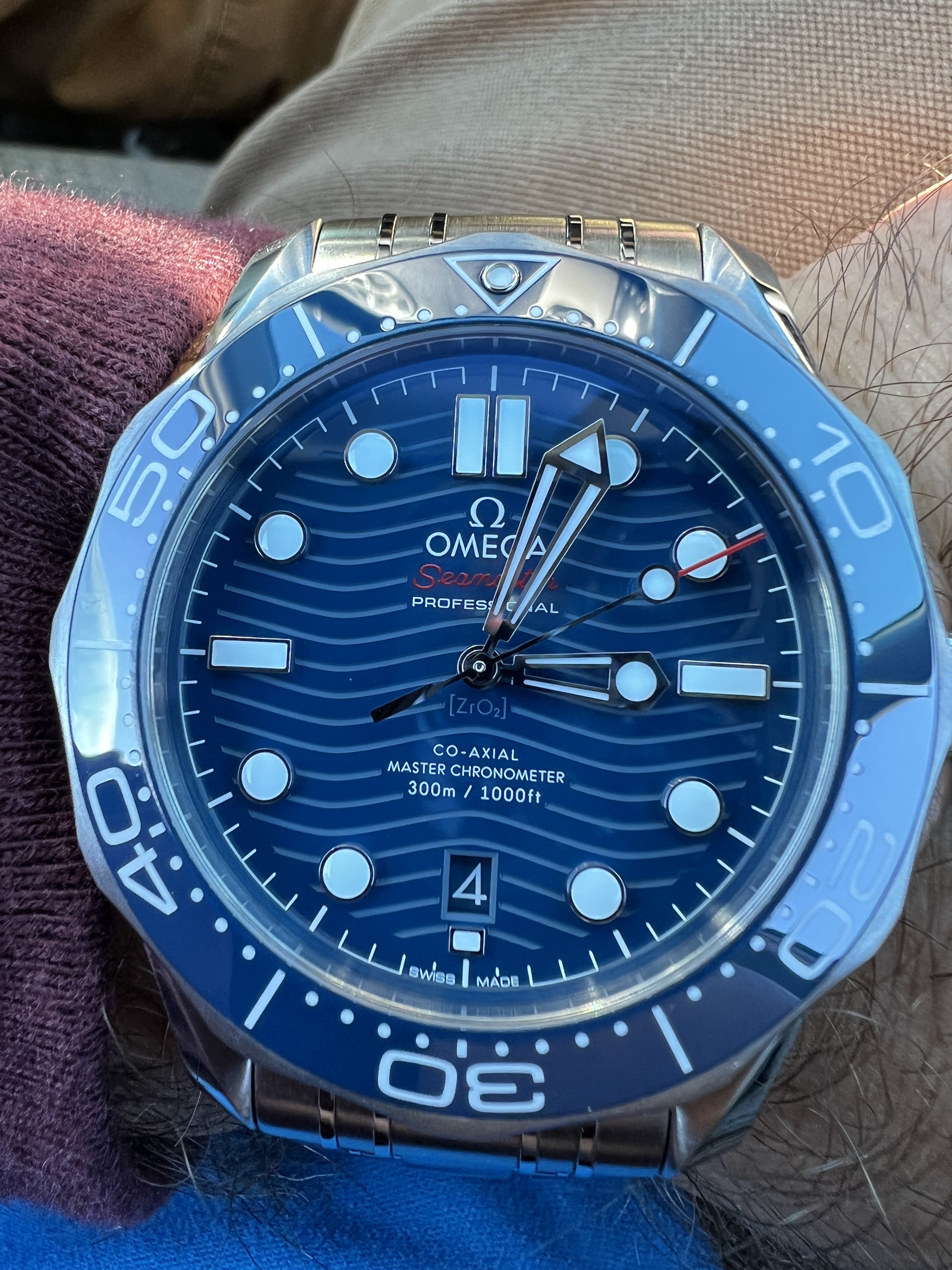

Found out last night my watch didn’t automatically change the date from the 3rd to the 4th. I changed the time out of the “danger zone” and used the quick set date and it had no problems changing from 3 to 4. However it won’t do it automatically when I move the hands/movement to midnight. It will automatically change the date on any other day except when it is on the 3rd. What should I do? Very disappointed as this is my 3rd issue with this watch and I have had it for 7 months. It is the 2018 Seamaster 300m.
1st issue: arrived from omega with lint under the crystal. Sent it off to get it out.
2nd: clasp pushers got stuck ant the watch was literally stuck on my wrist, I had to get that replaced.
And now this! Love the watch but this is ridiculous.

It sucks but the only thing to do is have it serviced again. Silver lining: it's getting all its problems out while still under warranty?

Not likely, at least in the US. Looks like a defect with the date ring, which was unnoticed and will be replaced.

There is no danger zone for setting on that movement.

Danger zone for that movement according to the manual is 8pm to 2am.

US law does not require the replacement of a watch upon demand. The chances of them doing it are very small. US warranties are full of "repair or replace at our discretion" and that's what you agree to.

Suggestion. Set the time ahead 12 hours to the correct time, and the calendar should change at midnight, not at noon! Sounds stupid? I’ve known it to happen!
