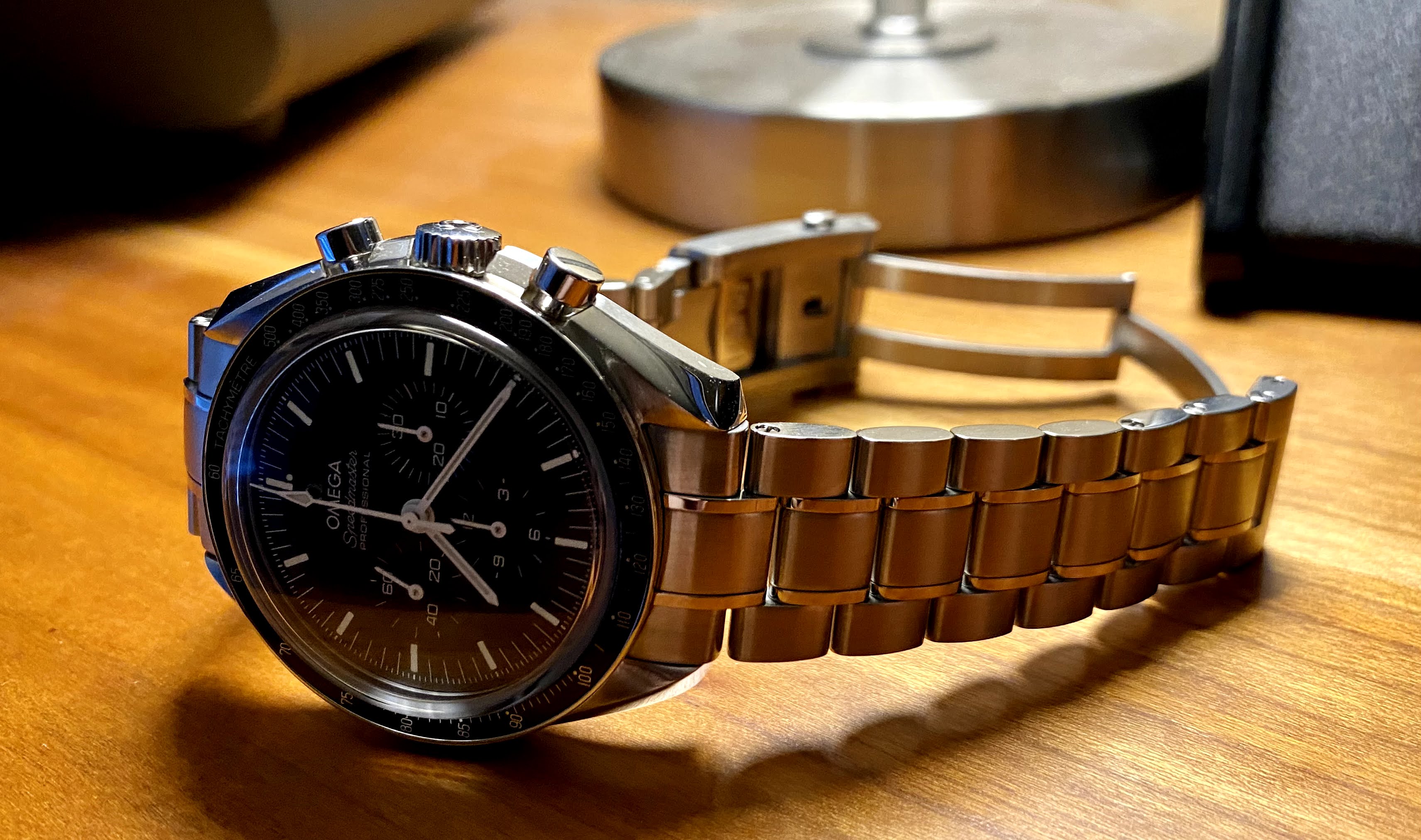

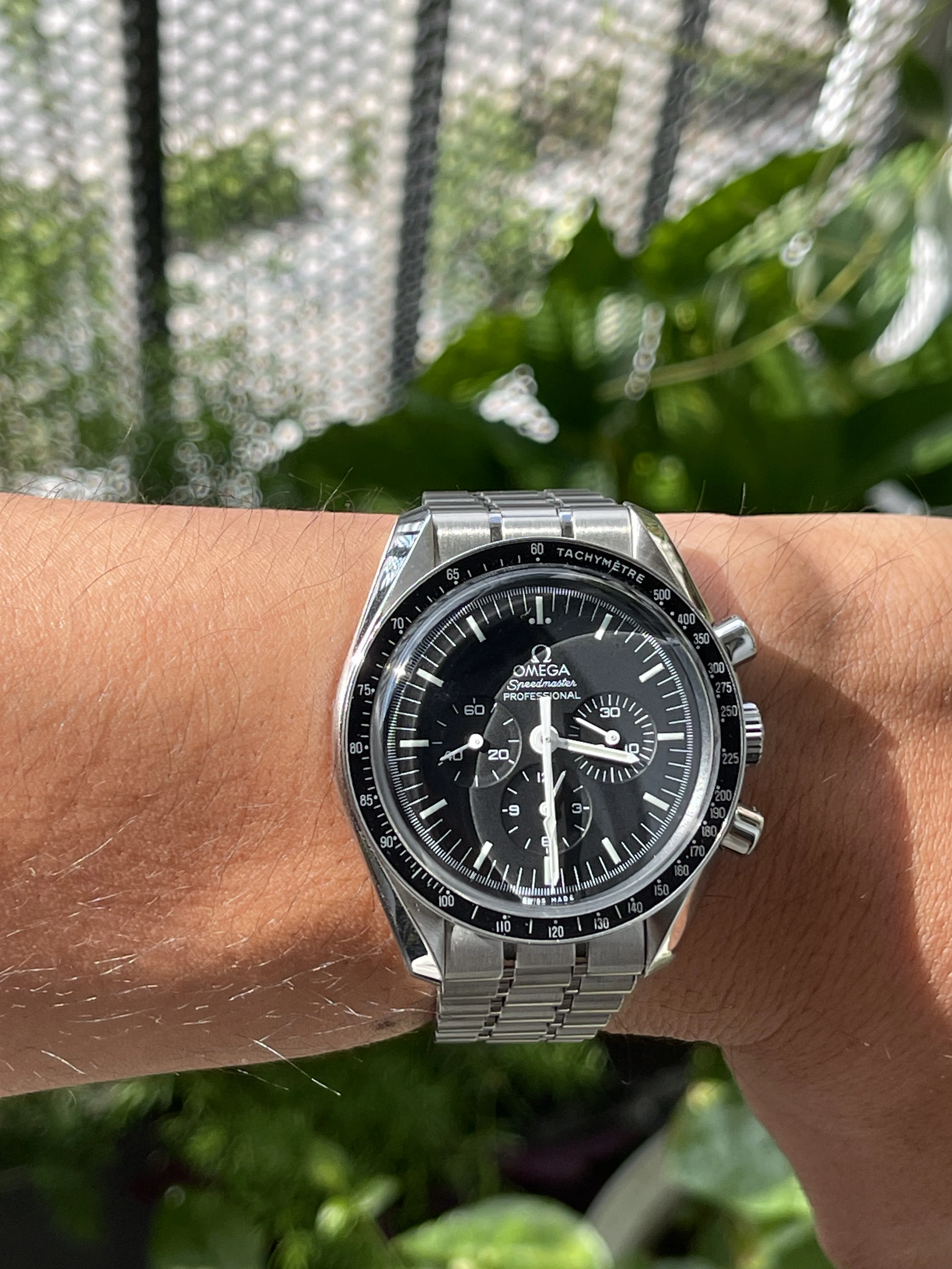

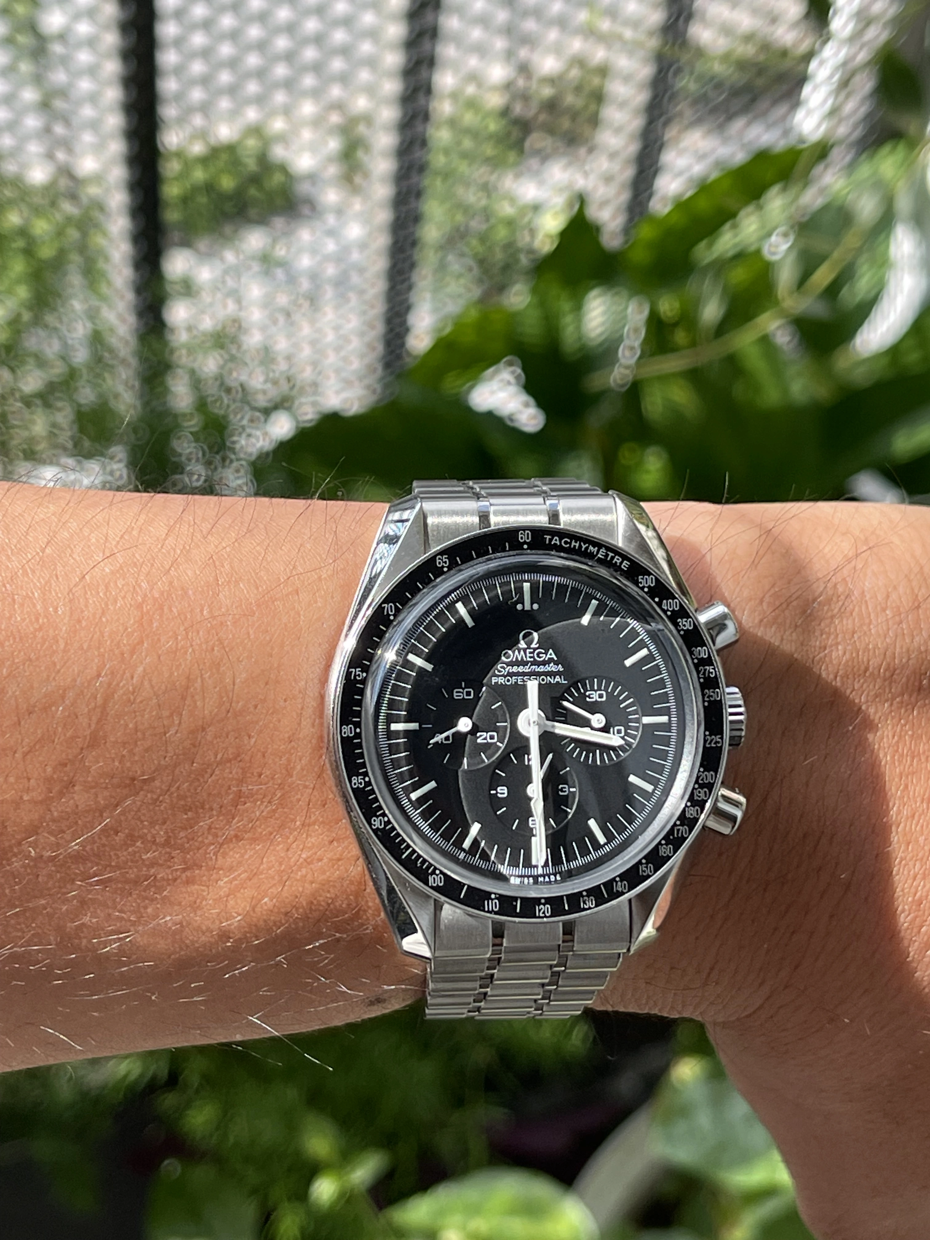

Yep, no problems. I have a 3861 bracelet on a late-2019 1861 watch, nice tight fit with the 1.8mm stock springbars.

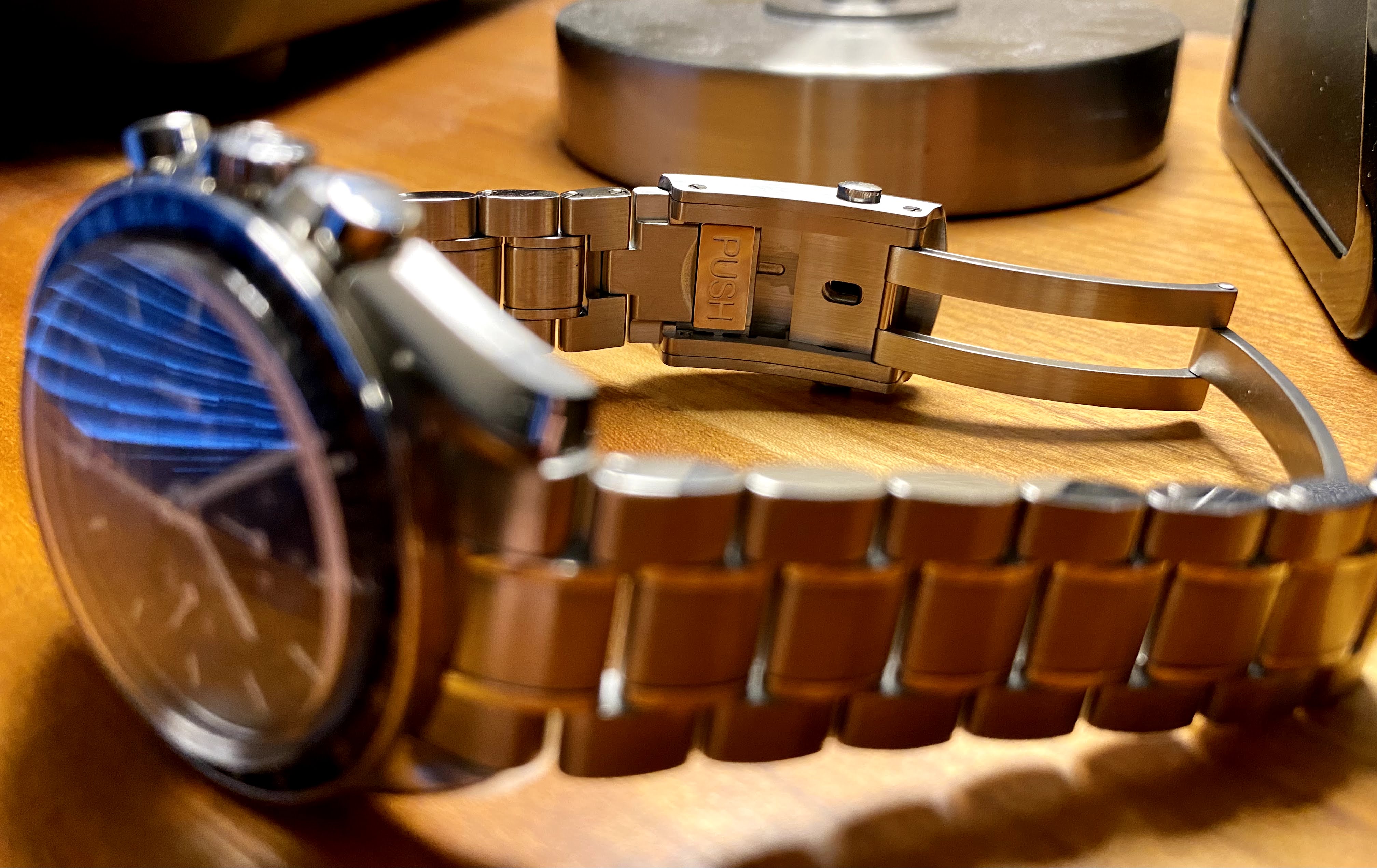

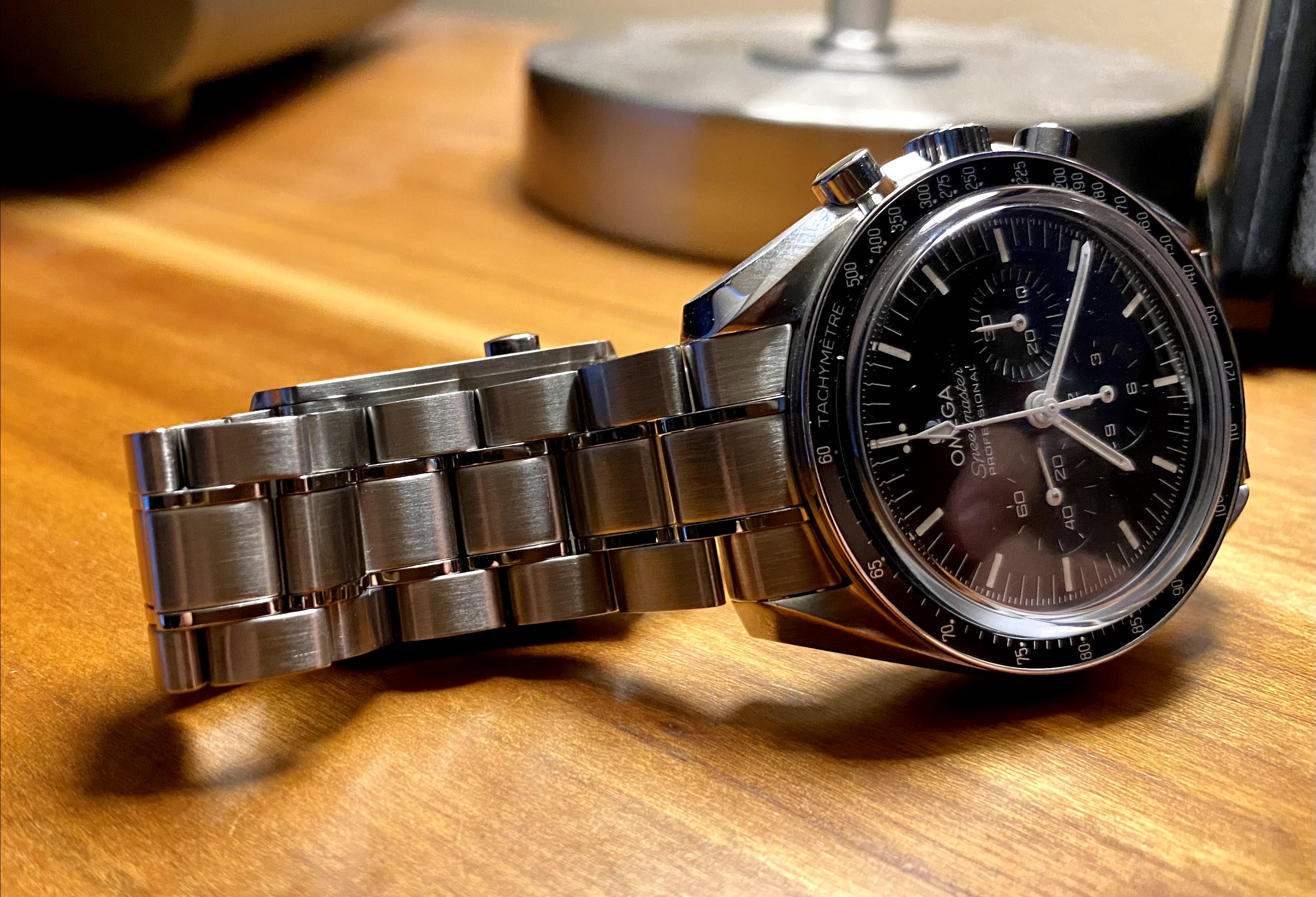

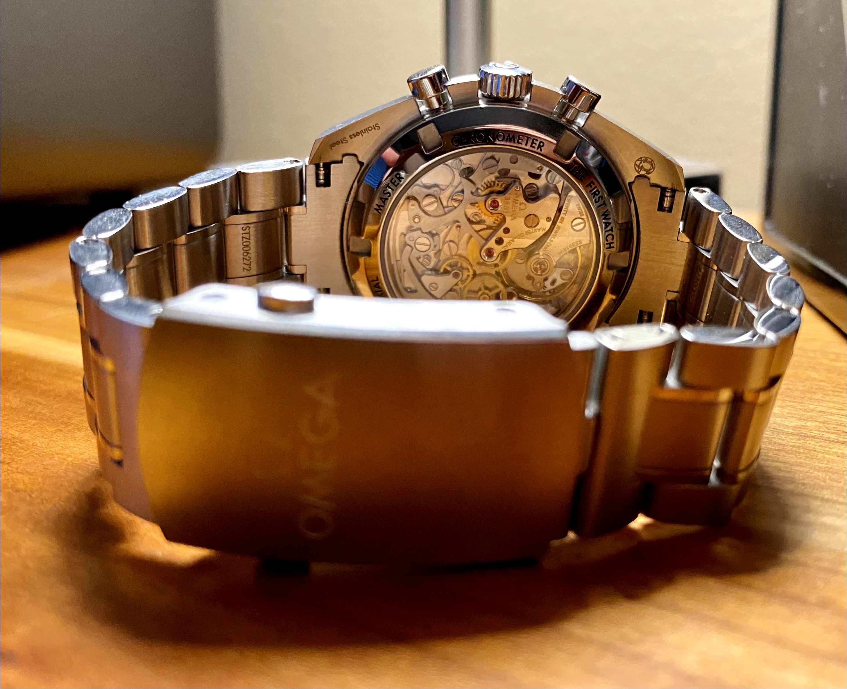

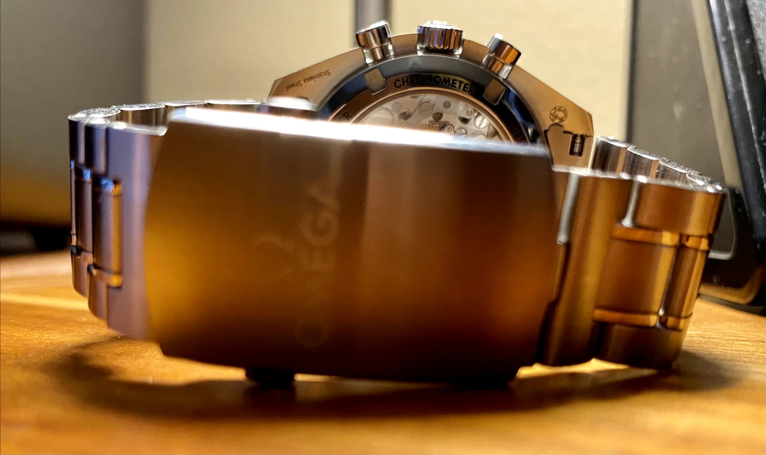

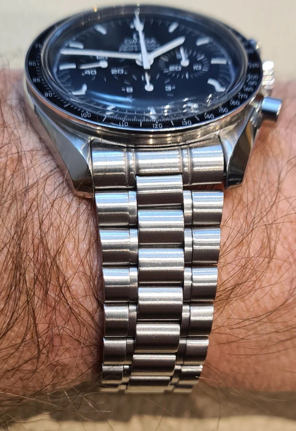

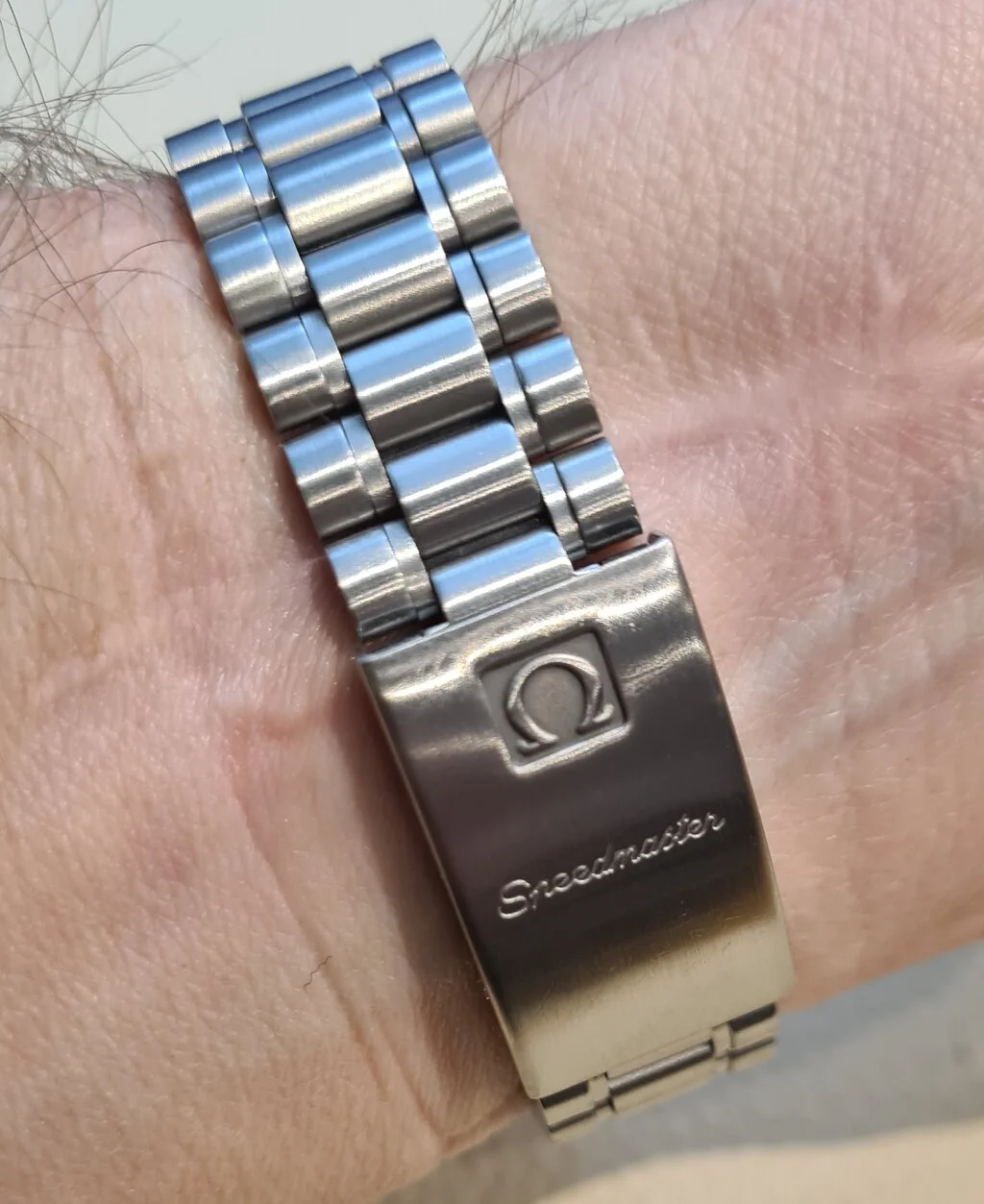

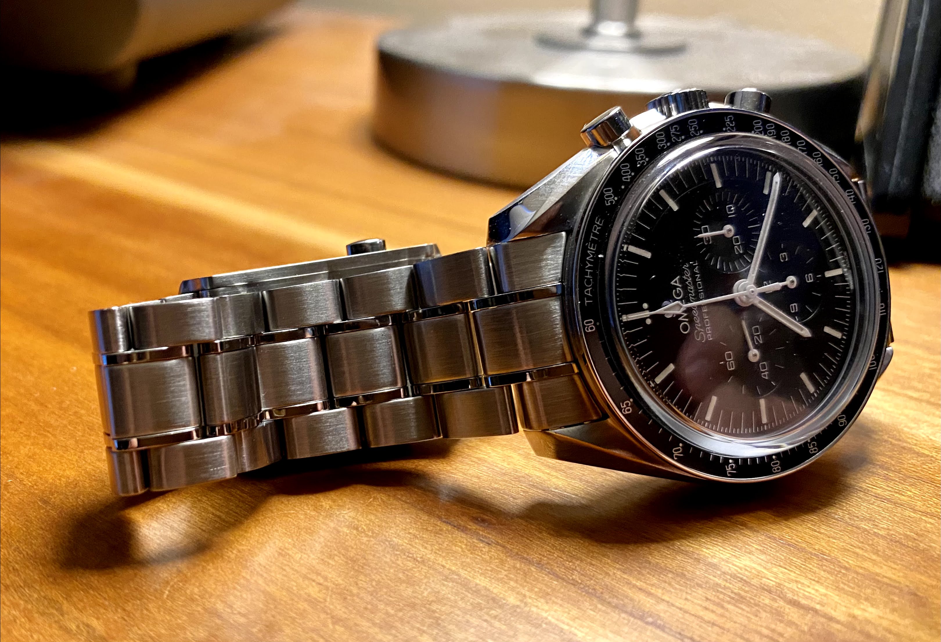

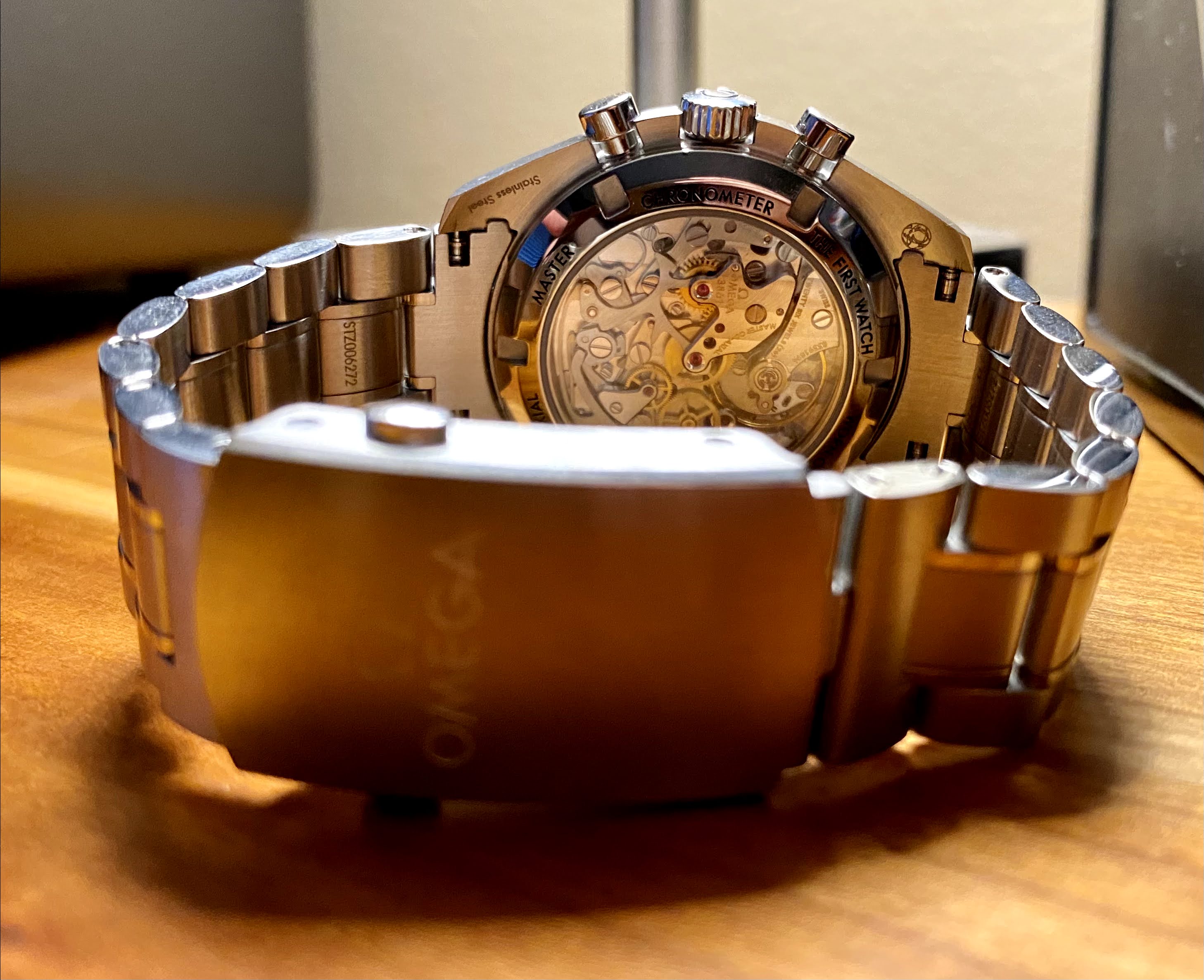

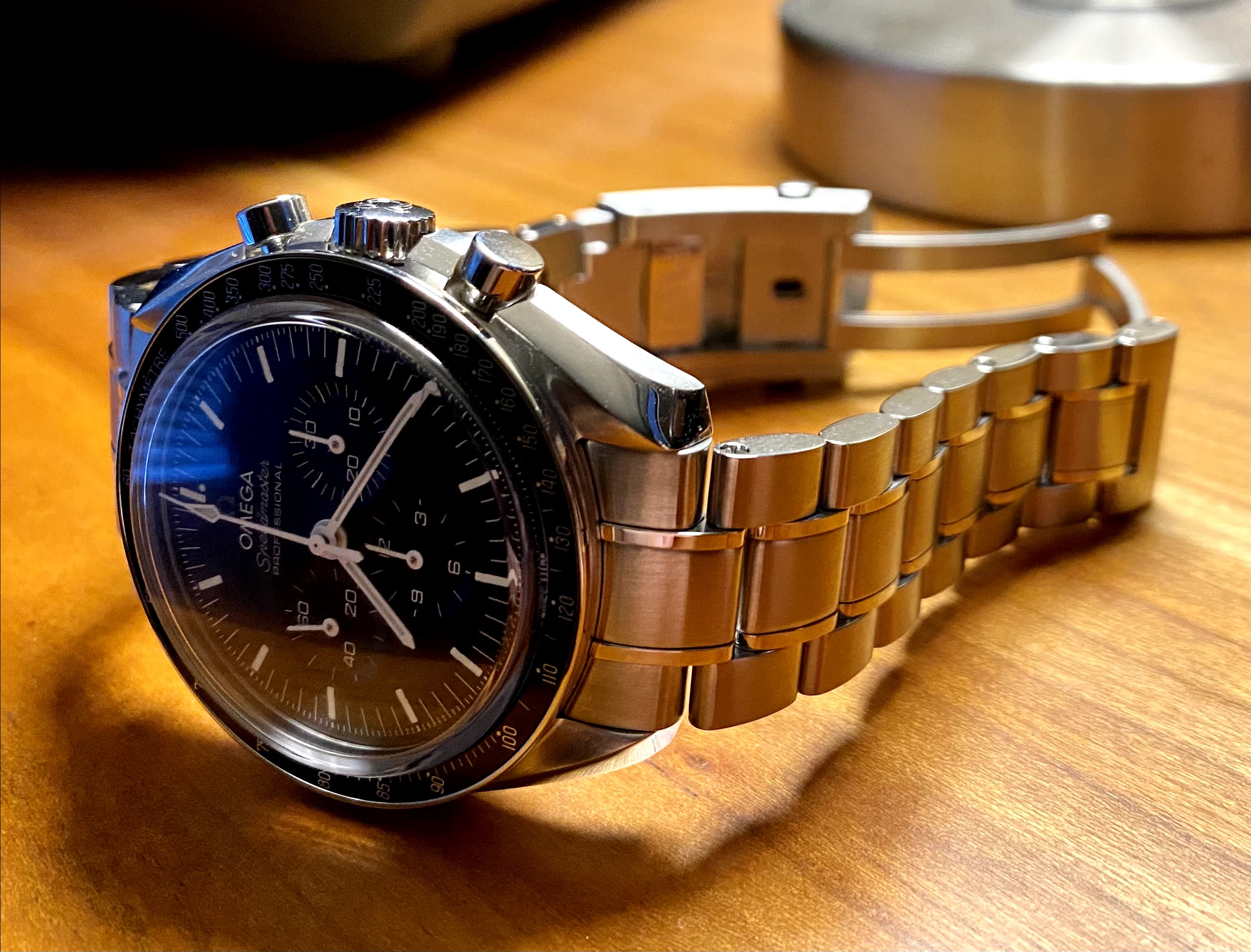

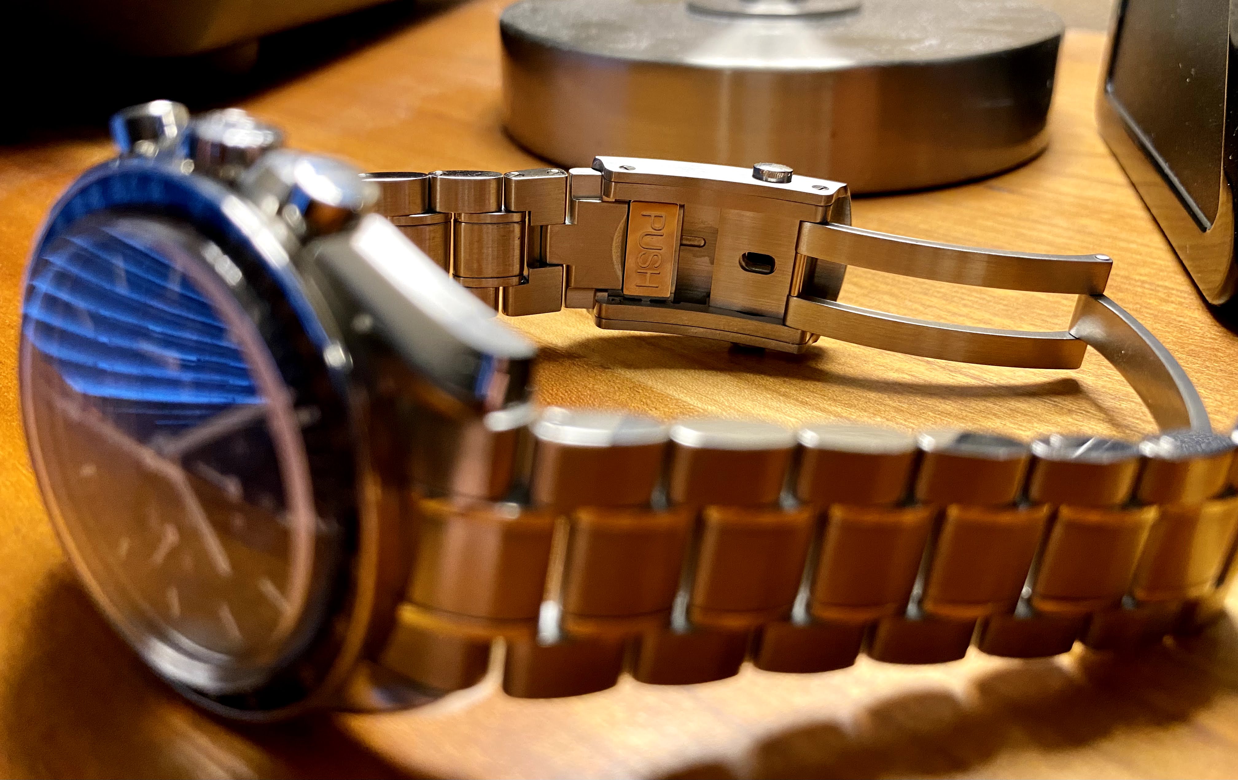

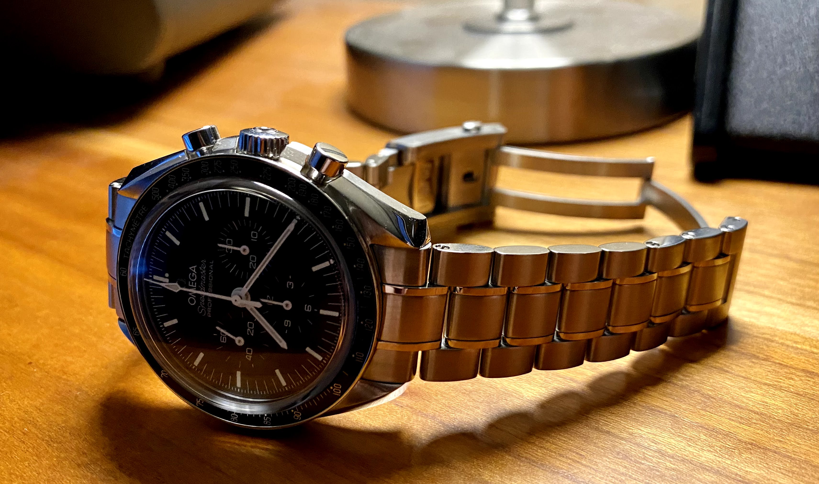

I just returned from my local OB and they fitted the Omega Speedmaster "Rising Sun" bracelet on my Saphire 3861 without issue. I think it looks great and it confirms that the older bracelet will fit on the newer Speedmaster - at least the one for the special edition Speedmaster with the adjustable clasp. Here are some pictures and one of them has the reference number in it. My OB ordered, sized, and fit it on my Speedy Moonwatch.
Also curious if your OB dealt with tabs like Rocketeer61 did:

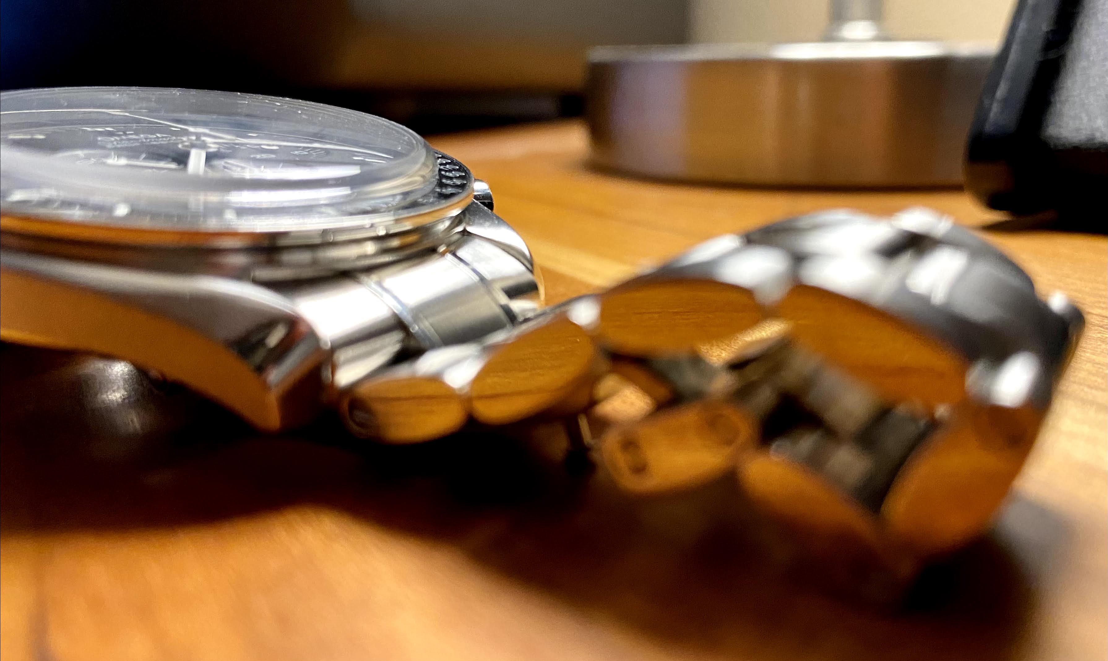

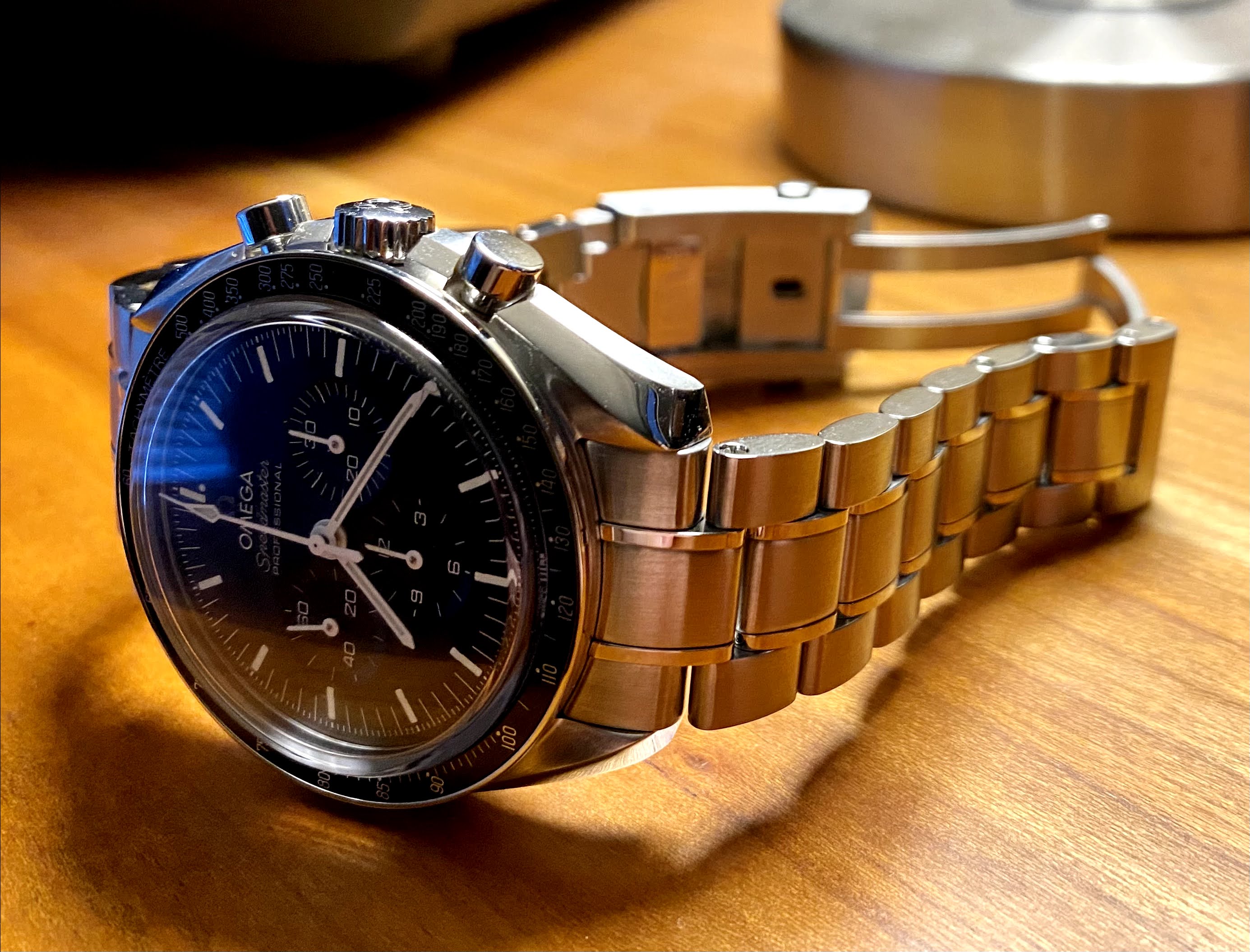

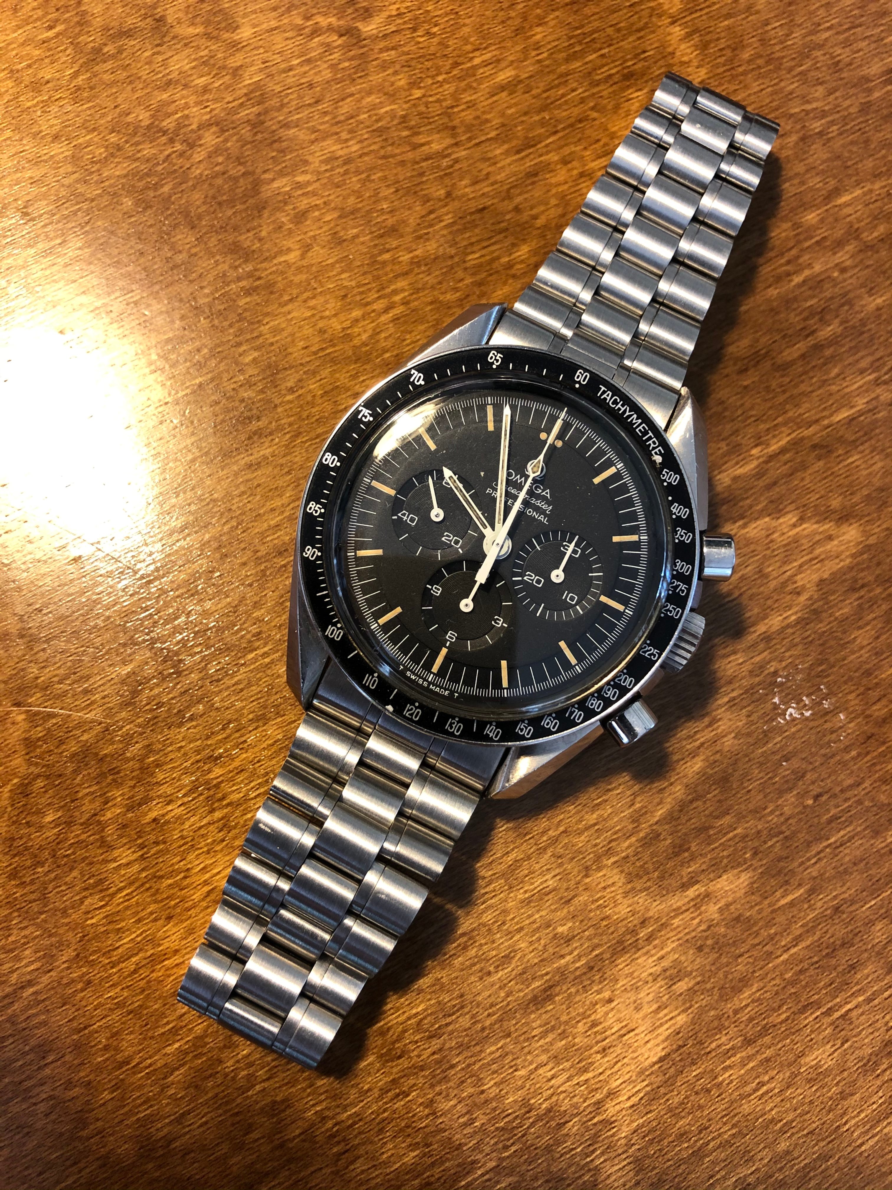

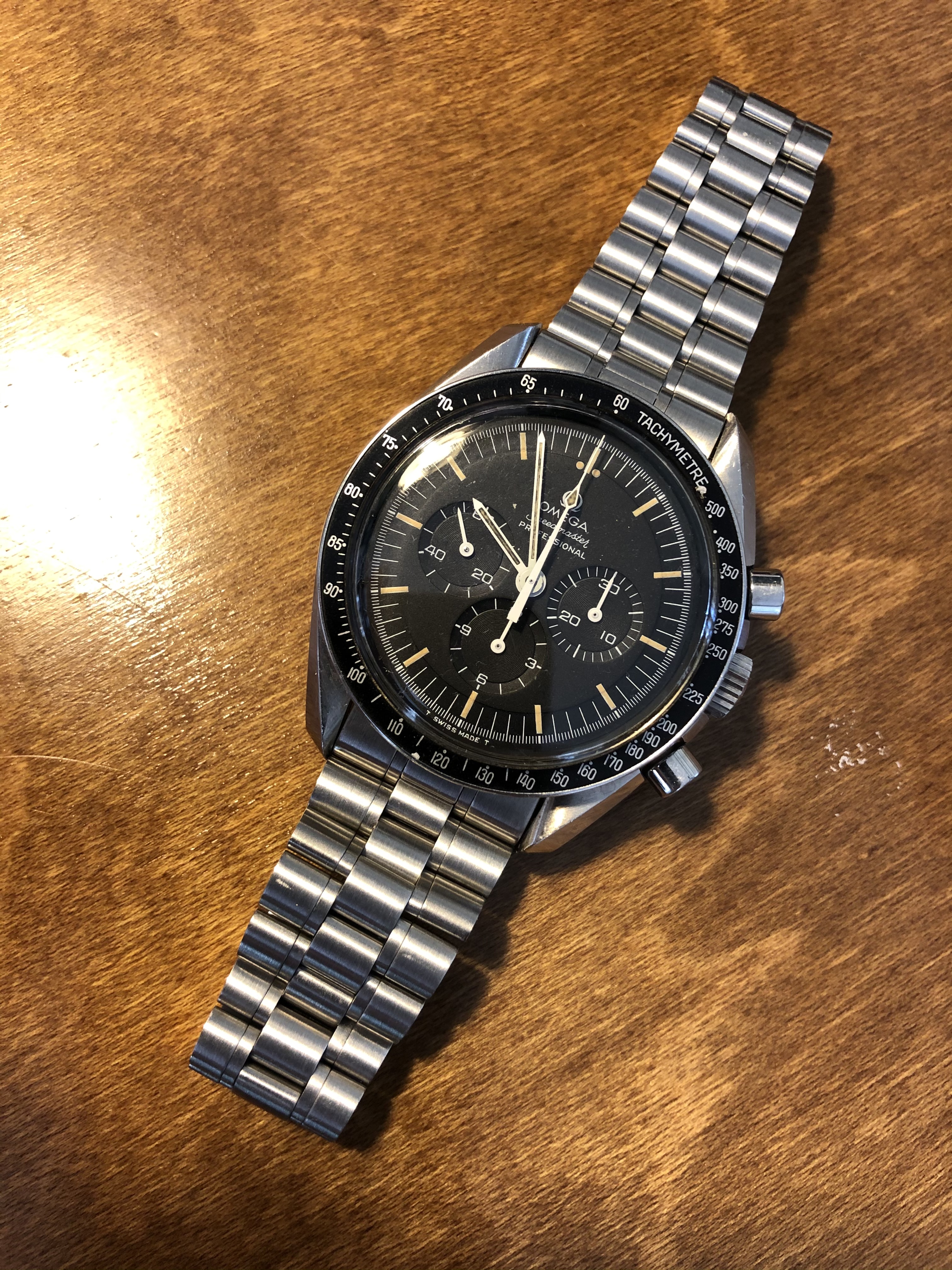

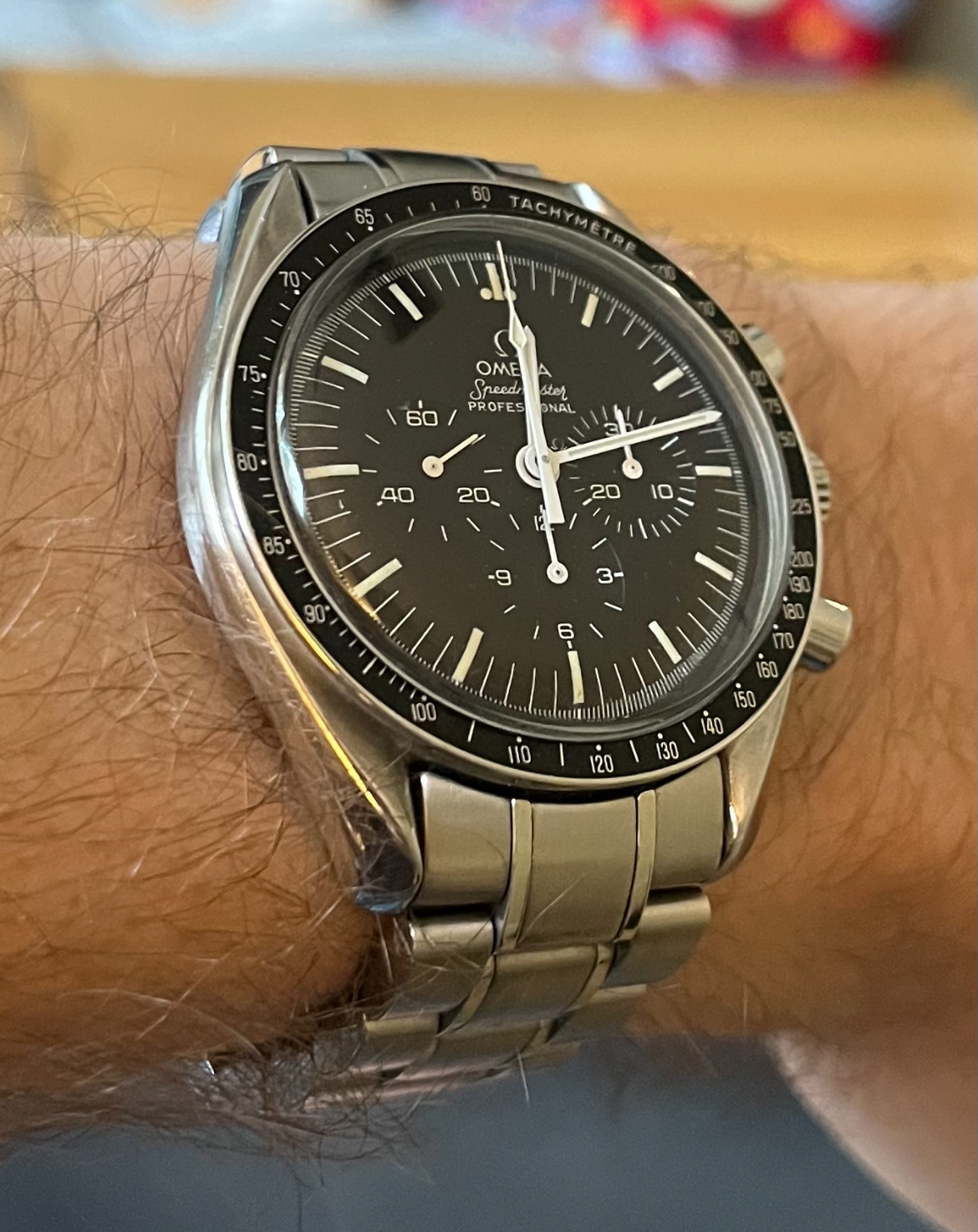

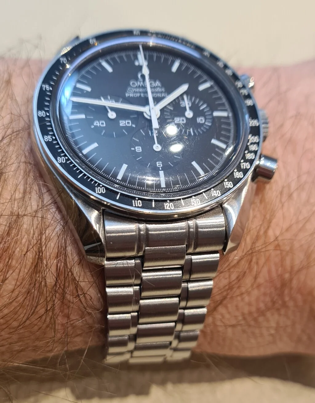

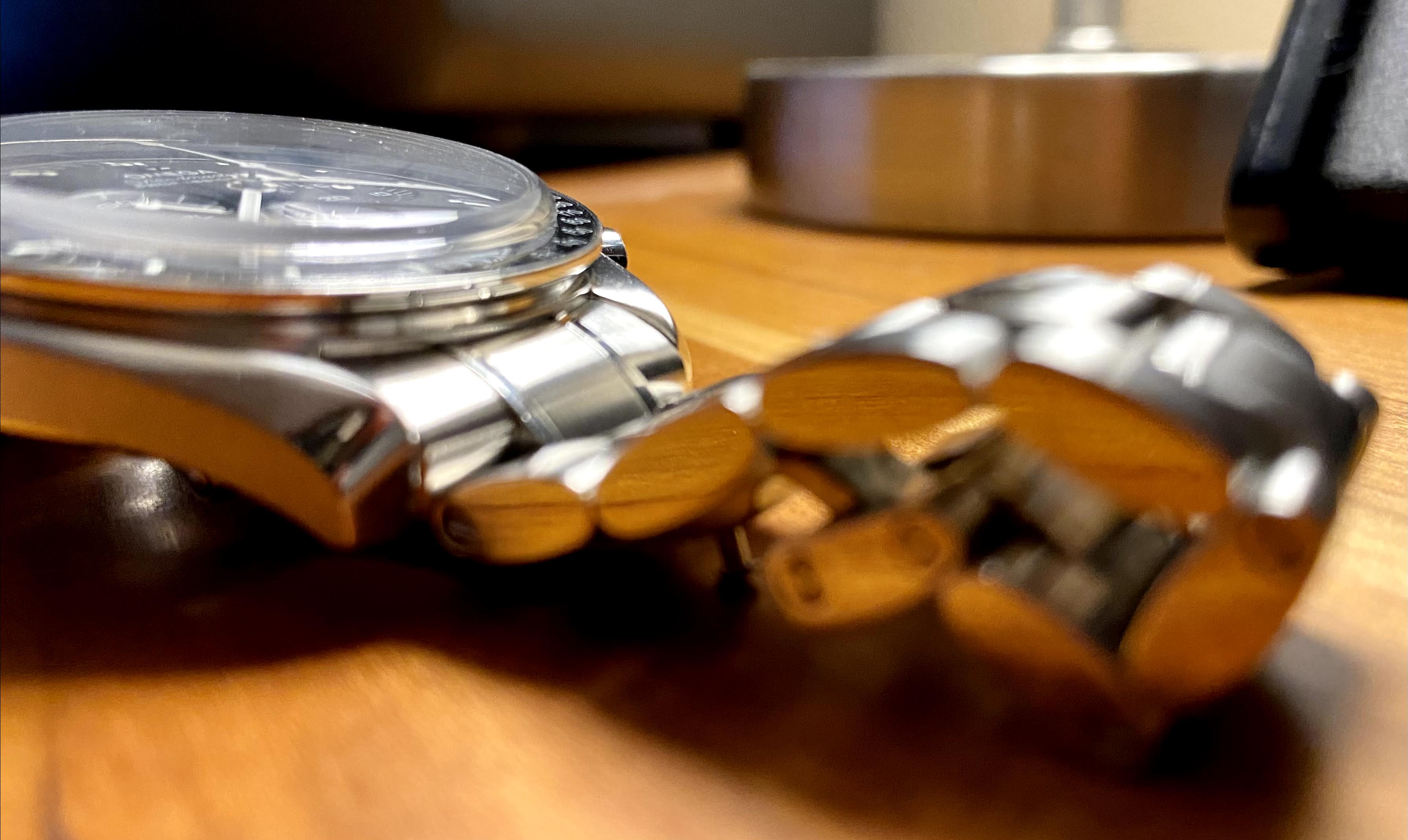

My 3861 has the 4196 bracelet from my 2020 mfg. 1861. It had a Forstner band on it but after swapping the two everything fits much better. I had to remove the tabs from the 1861 bracelet's end links to get the springbars to line up with the 3861's holes but after that everything went together. It was weird-it looked like the pins should snap into the holes in the lugs but they just wouldn't. There is a bit of play between the curves in the end links and the curves in the case but nothing too serious (see pic).

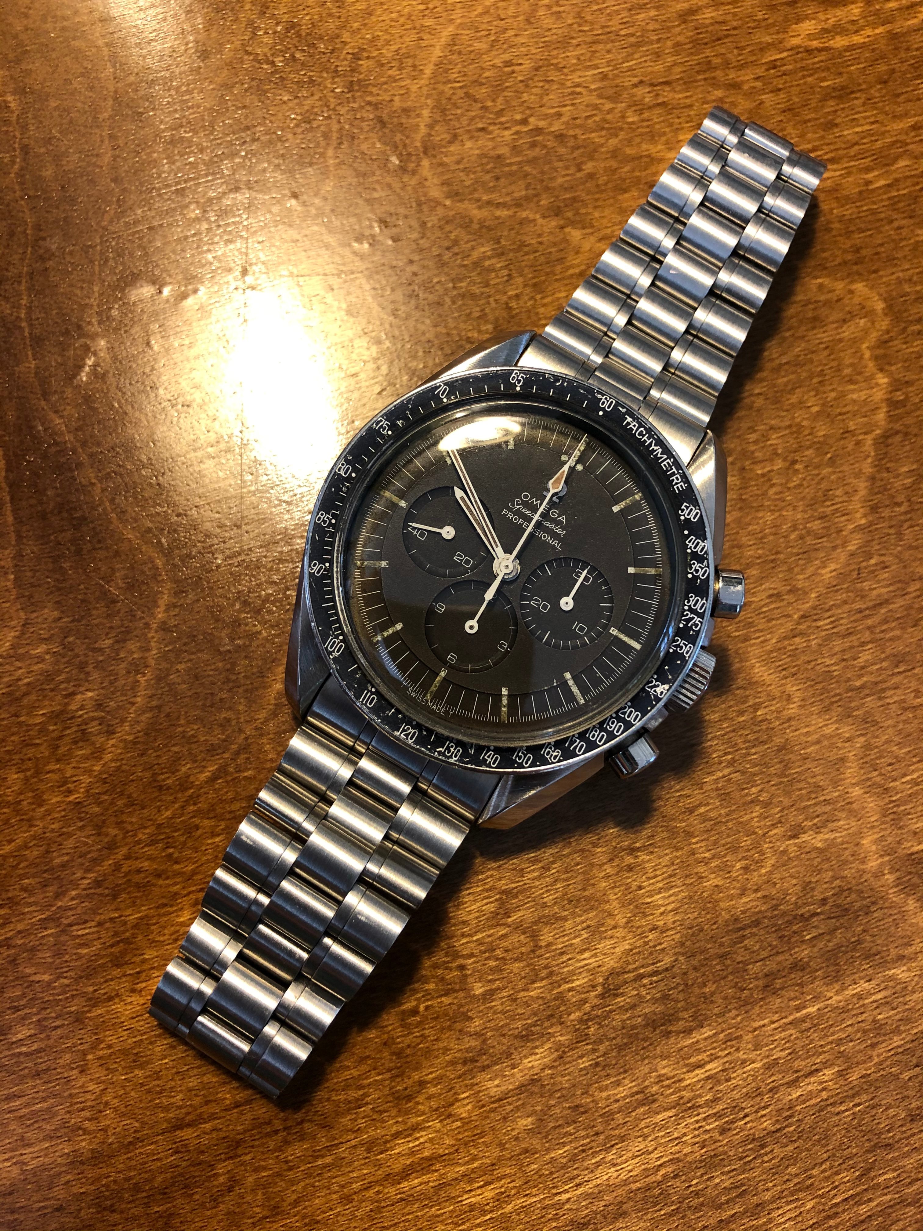

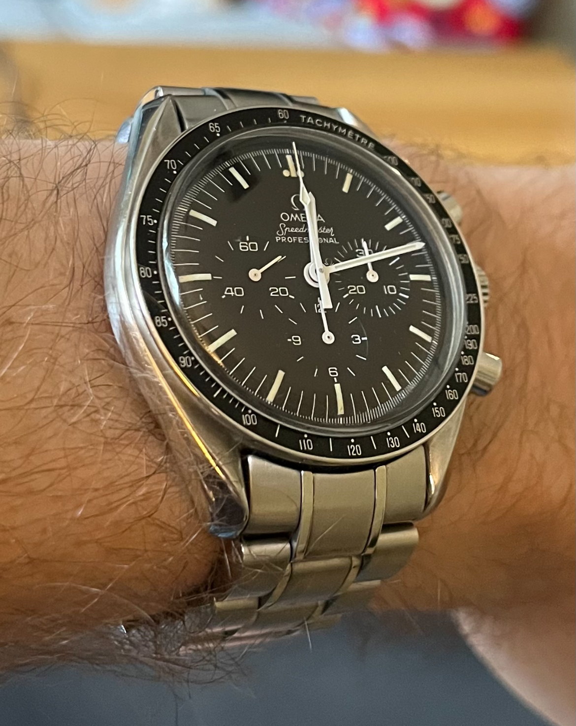

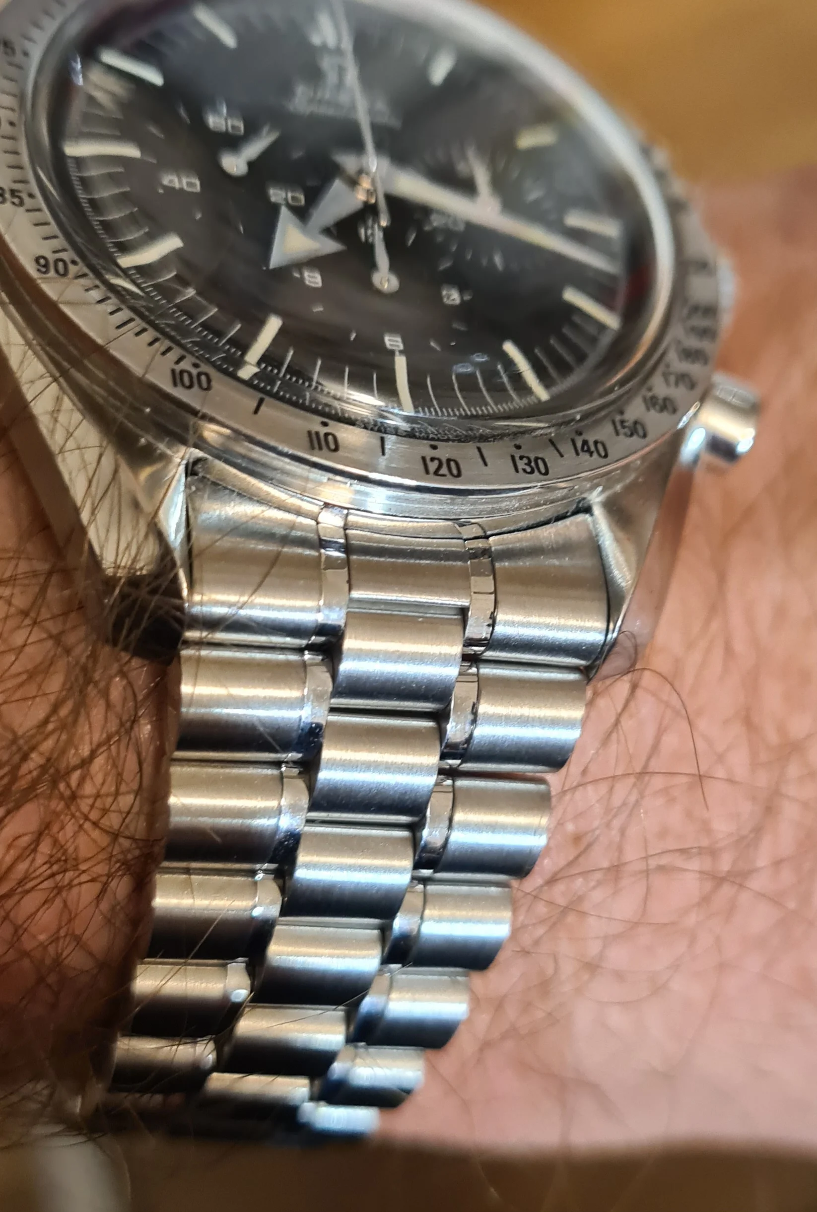

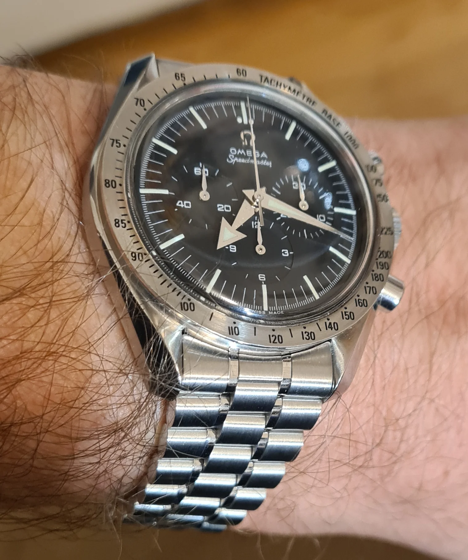

Here is my Tokyo Olympic Speedmaster bracelet (same as your Rising Sun bracelet) on my vintage 145.022. Using spring bars designed for this bracelet, the end links are not flush against the case:
I really dislike the end links on my bracelet wiggling and chalked this up to putting a modern bracelet on a vintage watch—until seeing G-Web’s pics. Just curious, @G-Web , what was your process fitting the 3861 bracelet to the 145.022; do your end links have extra wiggle/give like mine? Did you just use the spring bars that came with the 3861 bracelet? Yours look like a great fit.
The 3861 bracelet also fits my 105.012 and 145.022. Sweet.

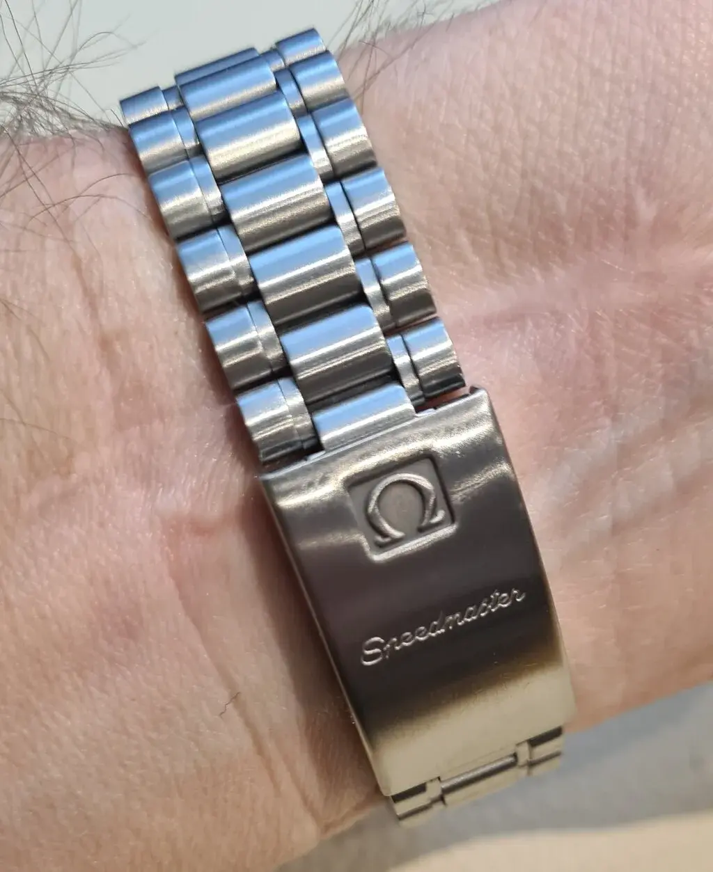

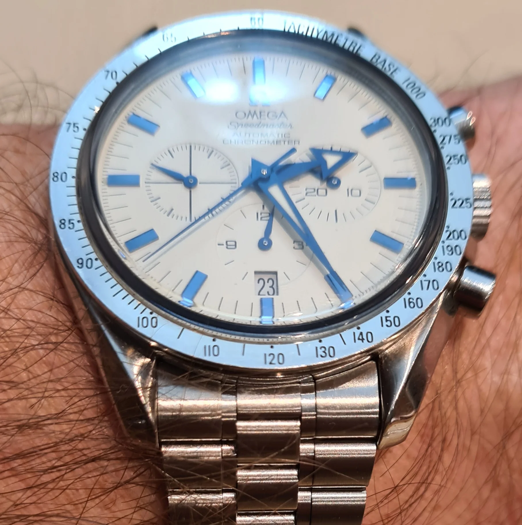

Based on your post, I purchased a new 020Z017488 bracelet for a Speedmaster from 2001 and successfully installed it. There is no gap between the end link and the case. It fits perfectly. I will soon be installing a 1479 bracelet with 812 end links on another Speedmaster, also from 2001.

Interesting that the bracelet was made in Italy (fitting for Tony Soprano)! Looks great.
Guessing you used spring bars that came with the 020Z017488?

Exactly, I used the pins that came with it.

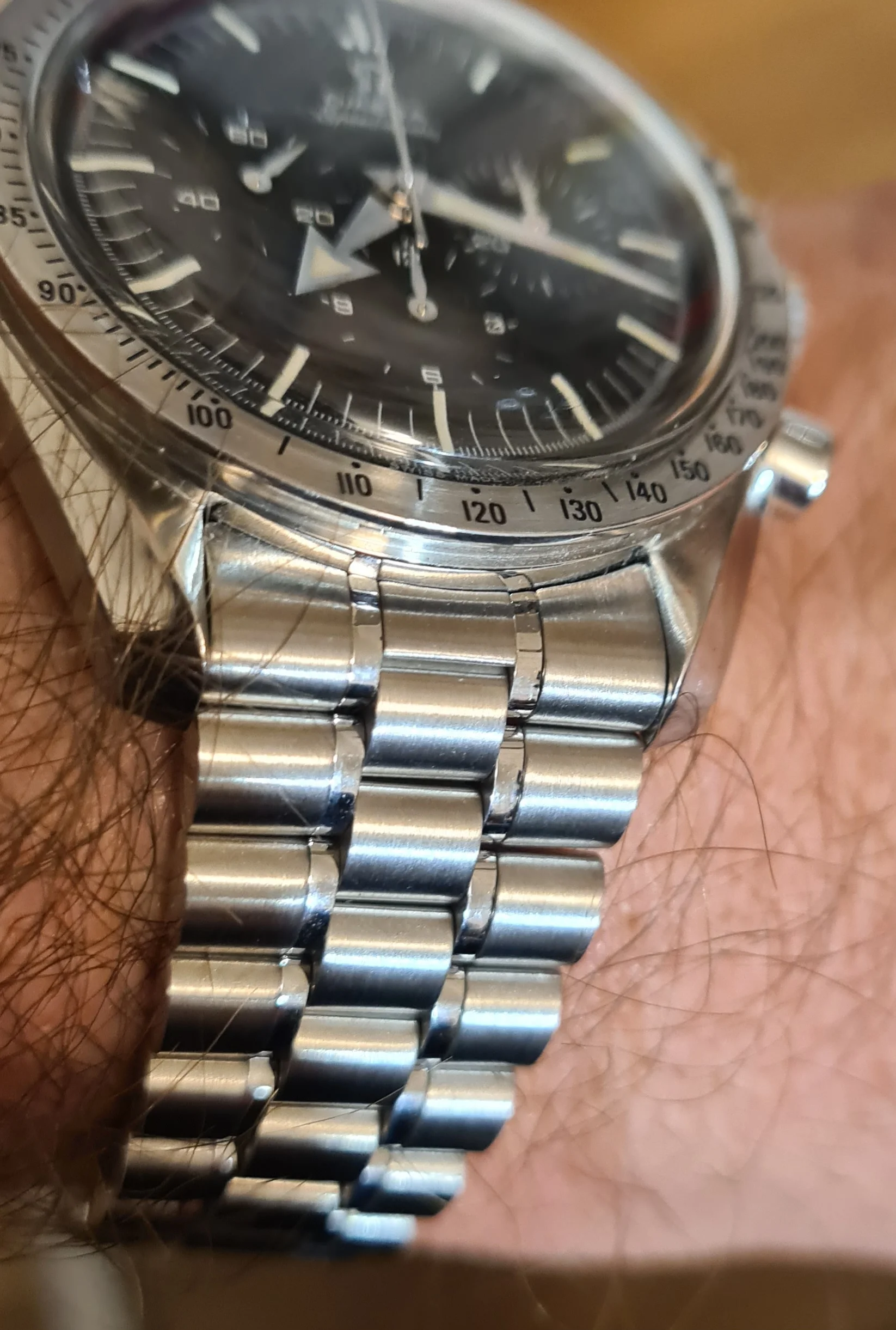

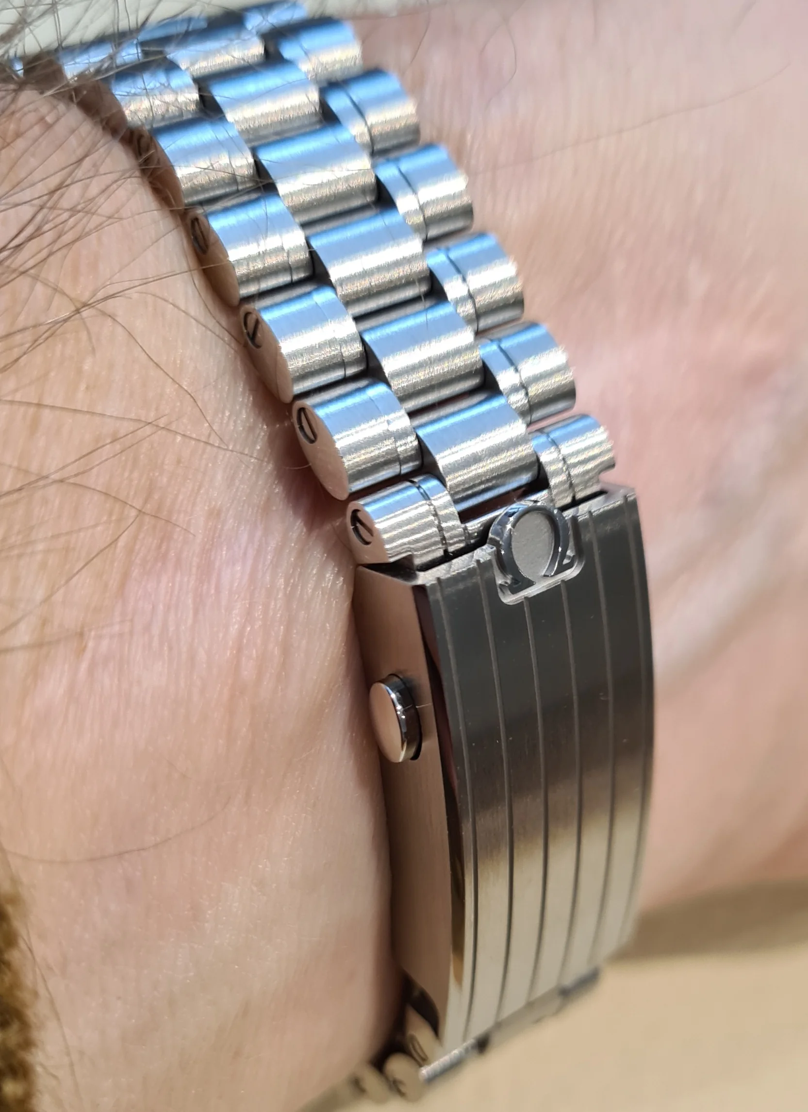

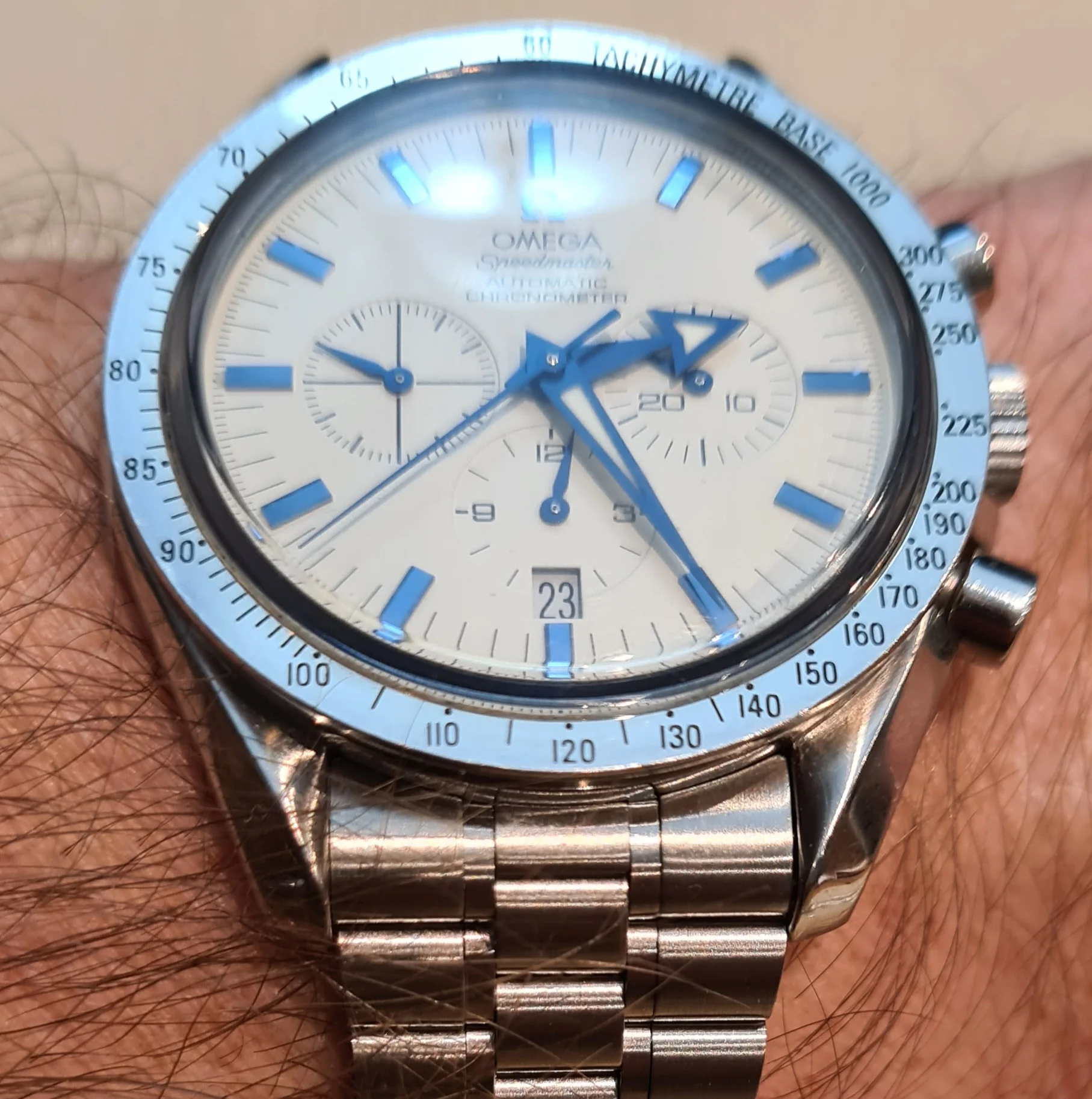

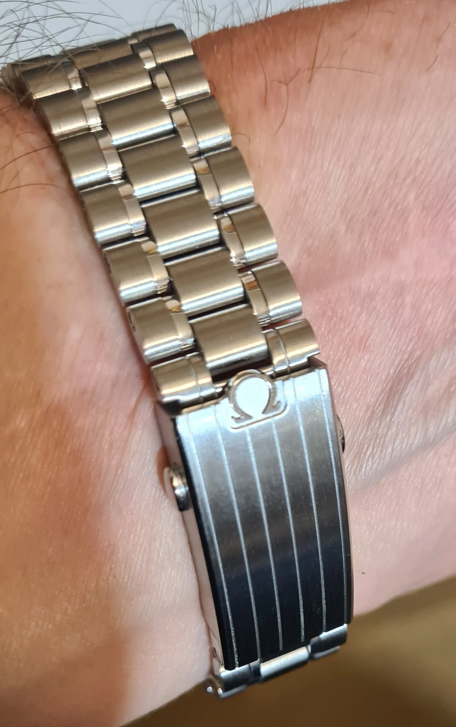

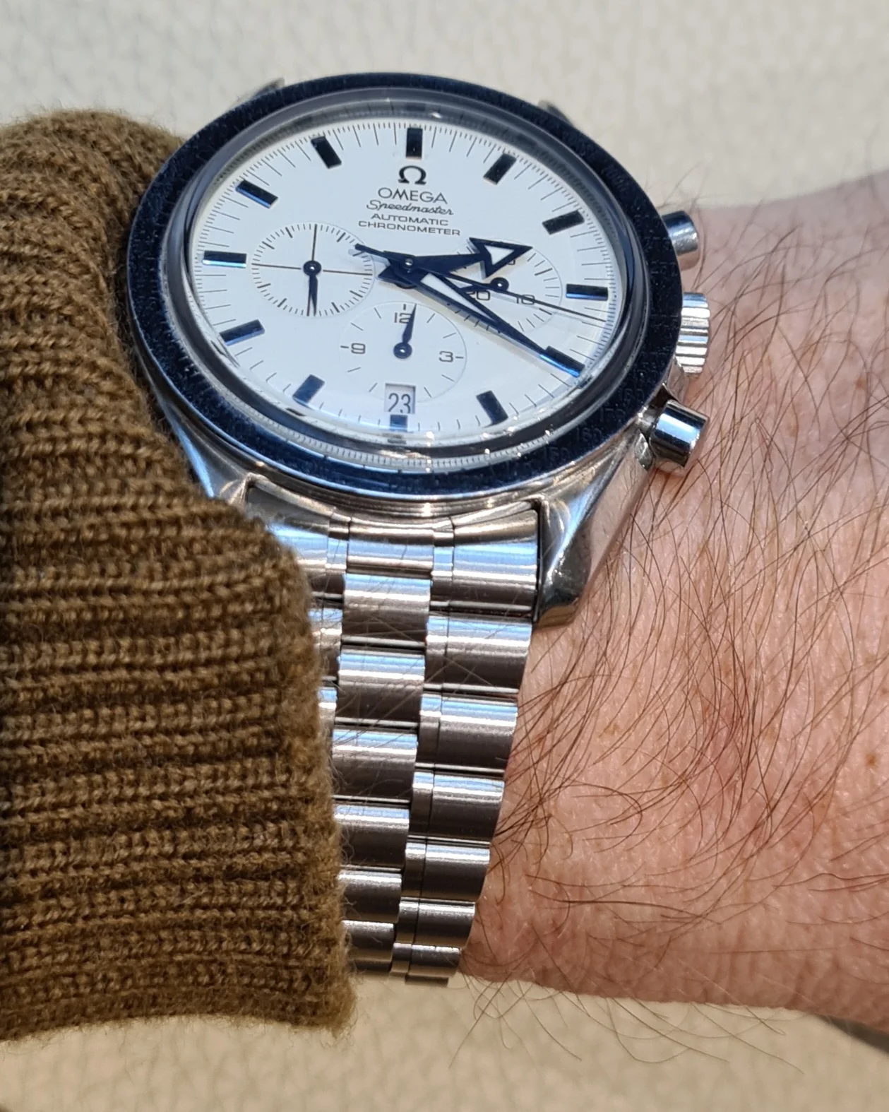

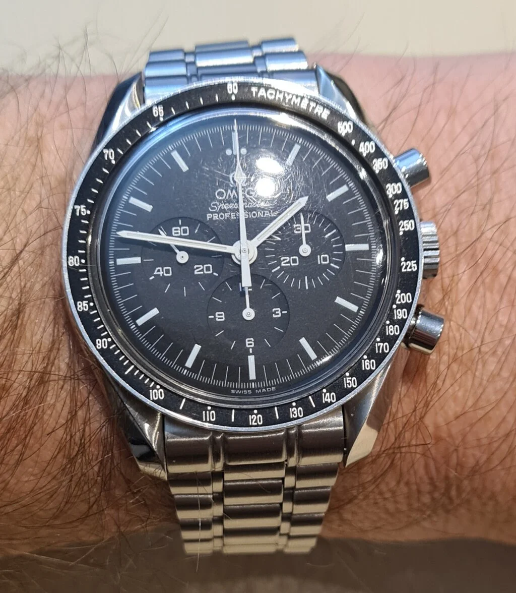

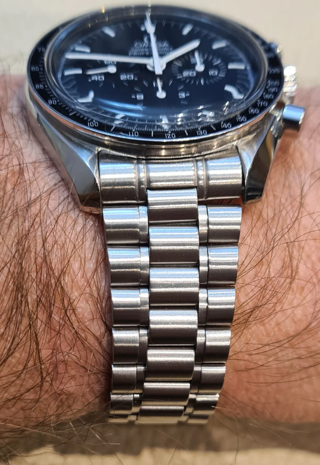

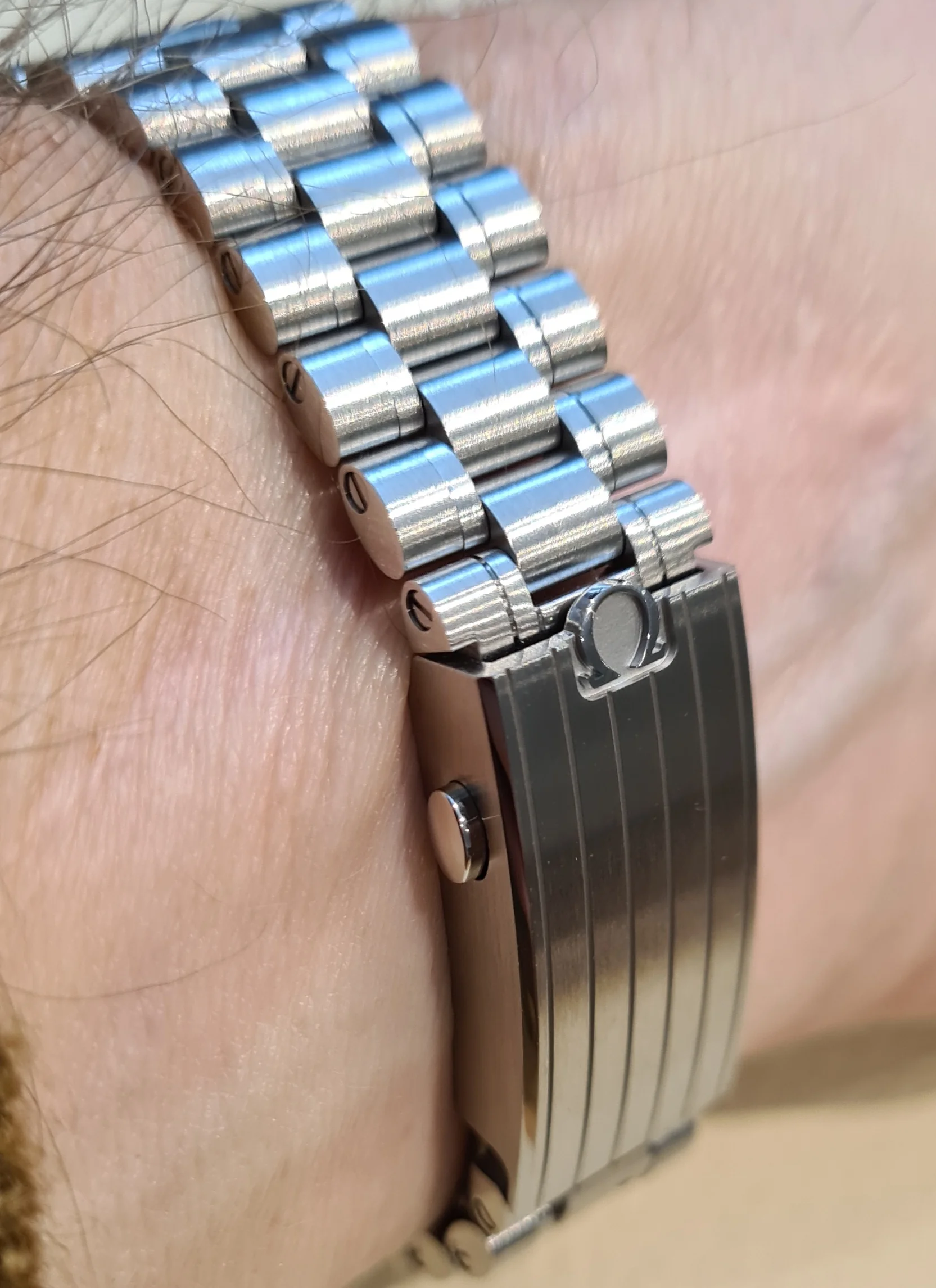

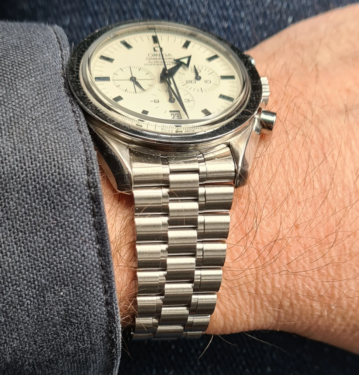

I always found the strap that was delivered around the year 2000 very unattractive because the protruding end links make the watch appear unnecessarily large. I also find the polished middle links a little kitschy. The matte strap has more of a tool watch look. It also looks much more delicate in real life than in photos. It is thinner and narrower than I had assumed. I am very satisfied; the watch looks much better.

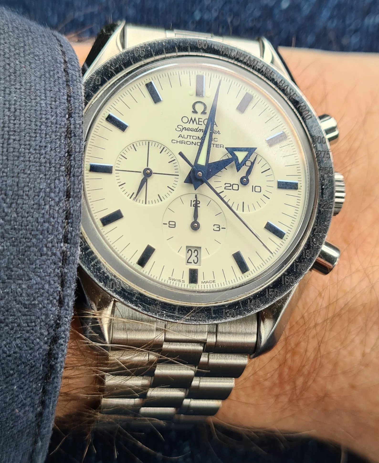

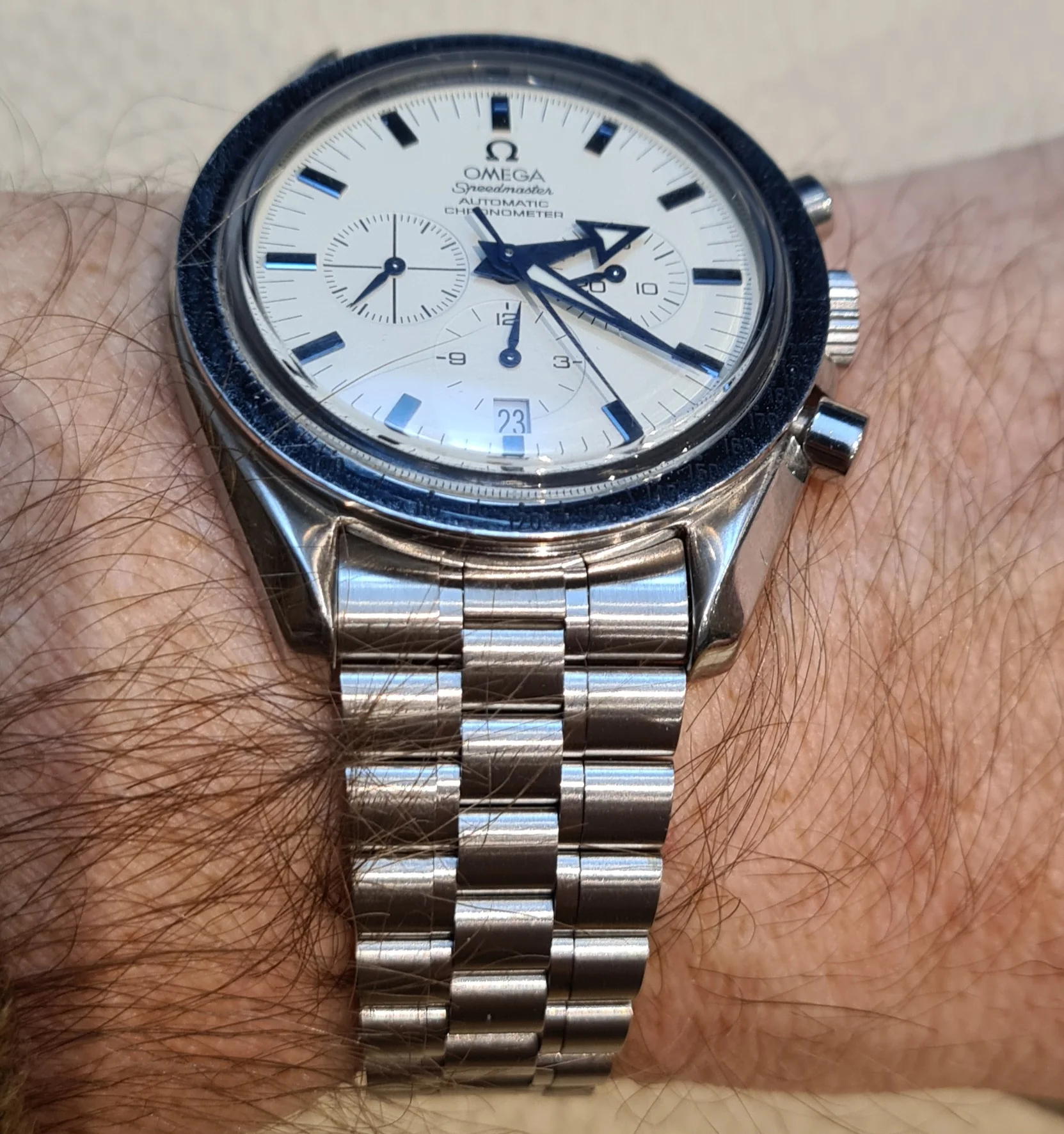

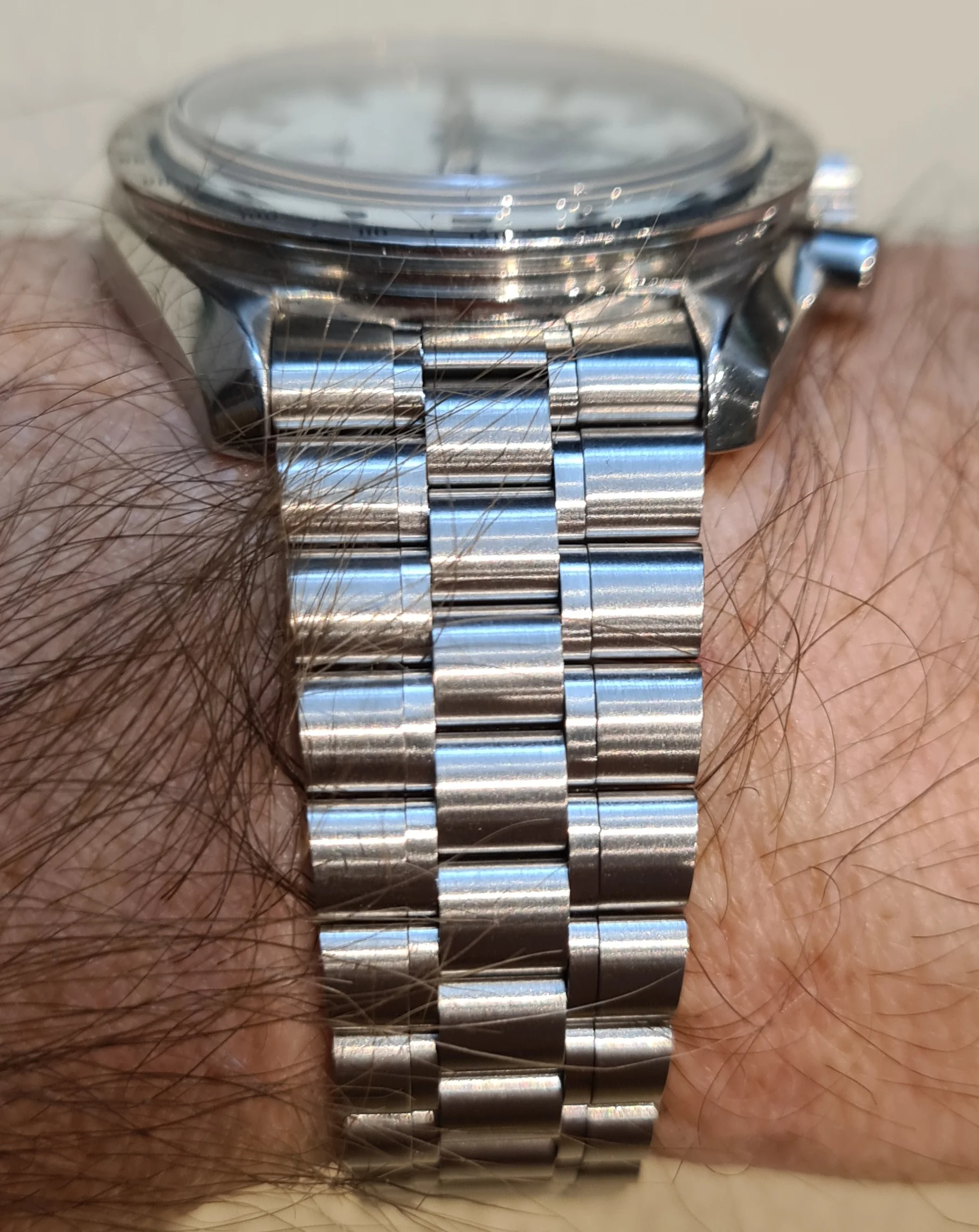

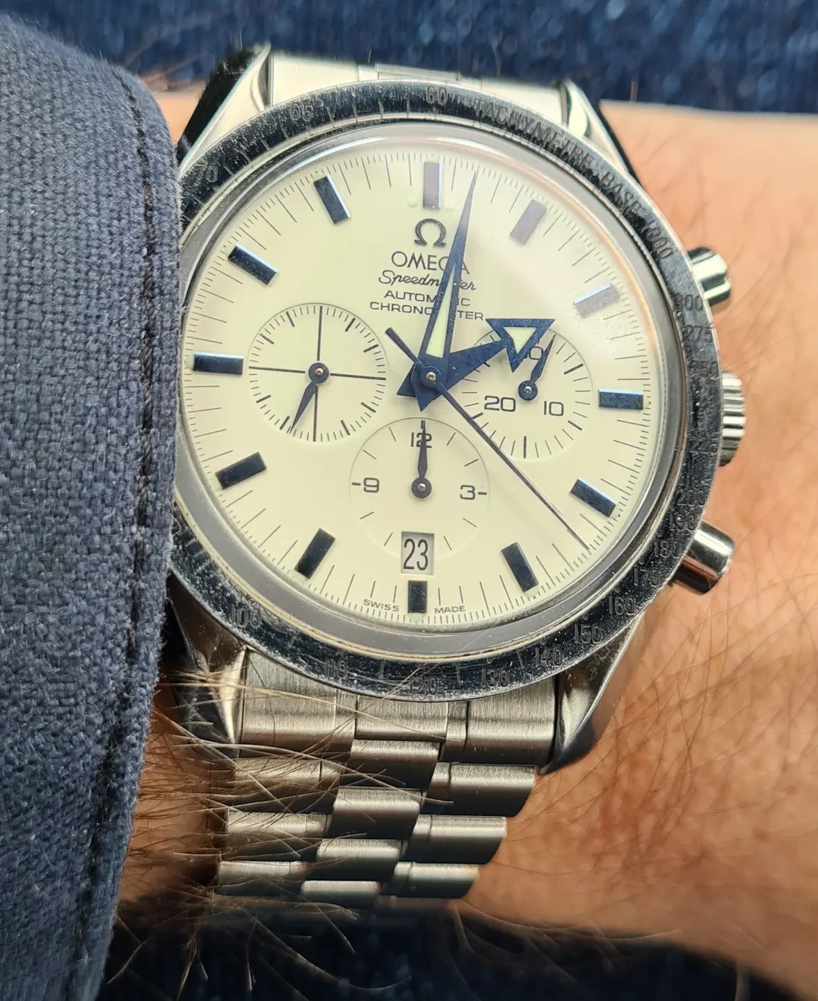

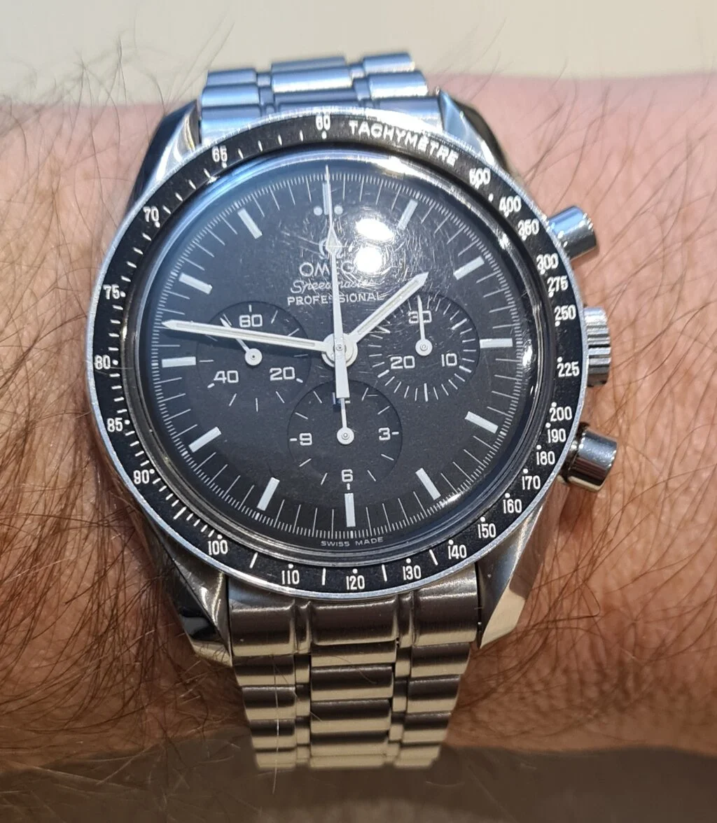

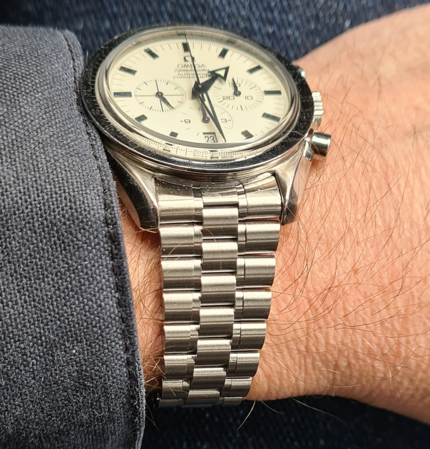

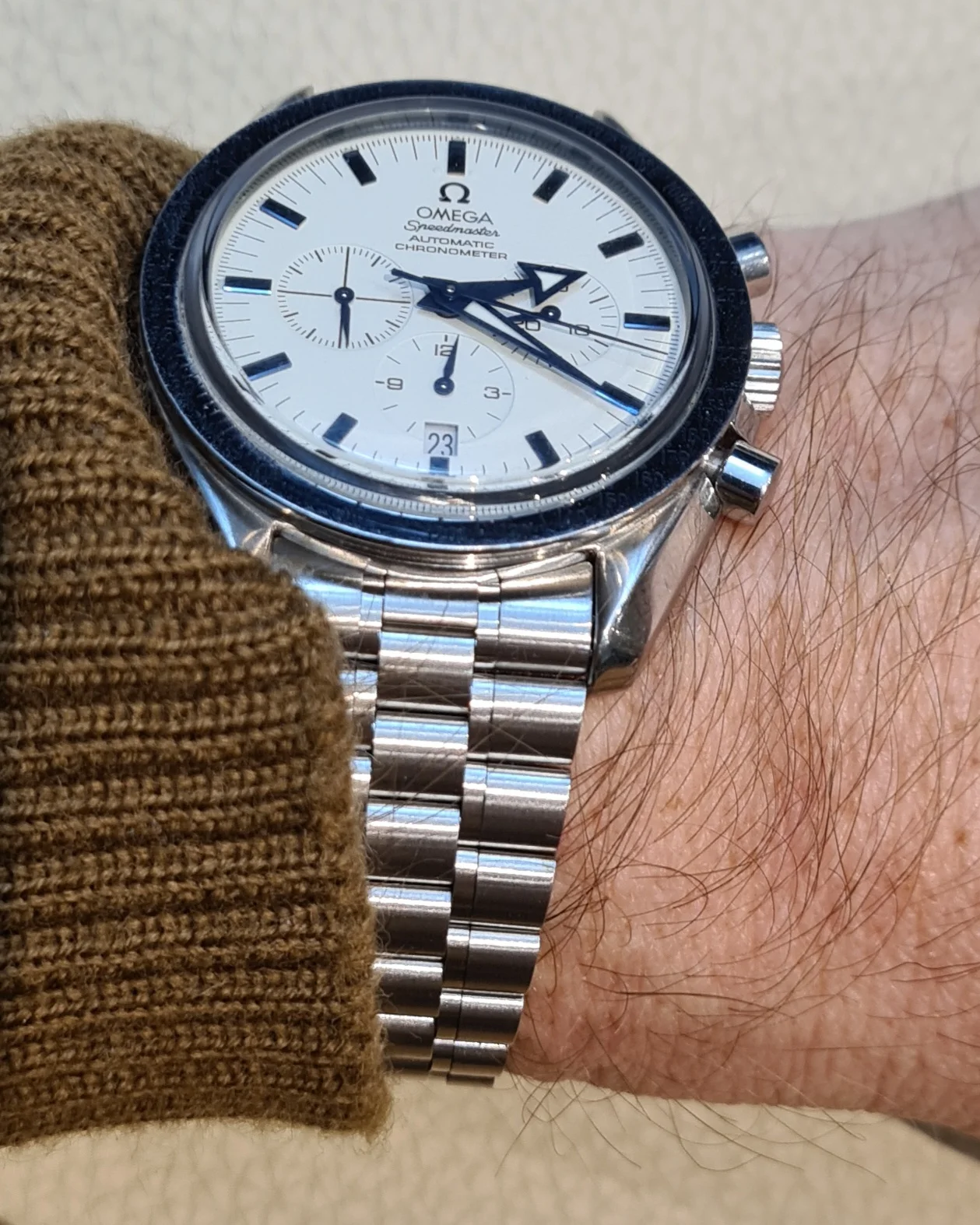

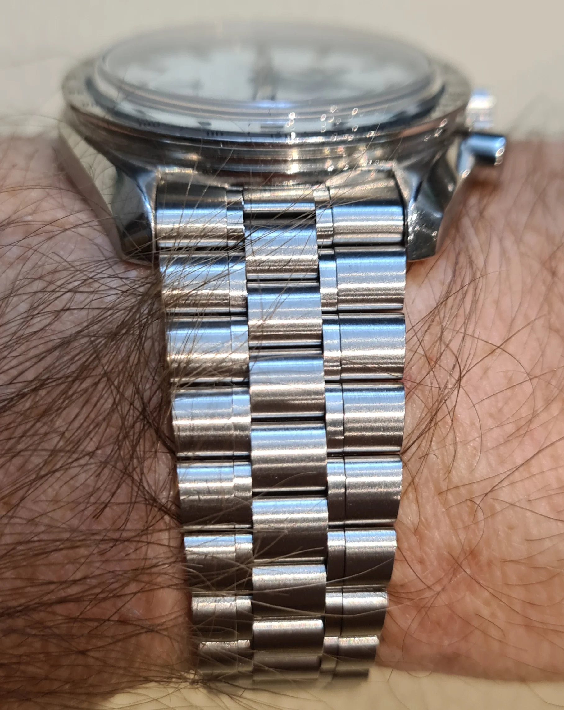

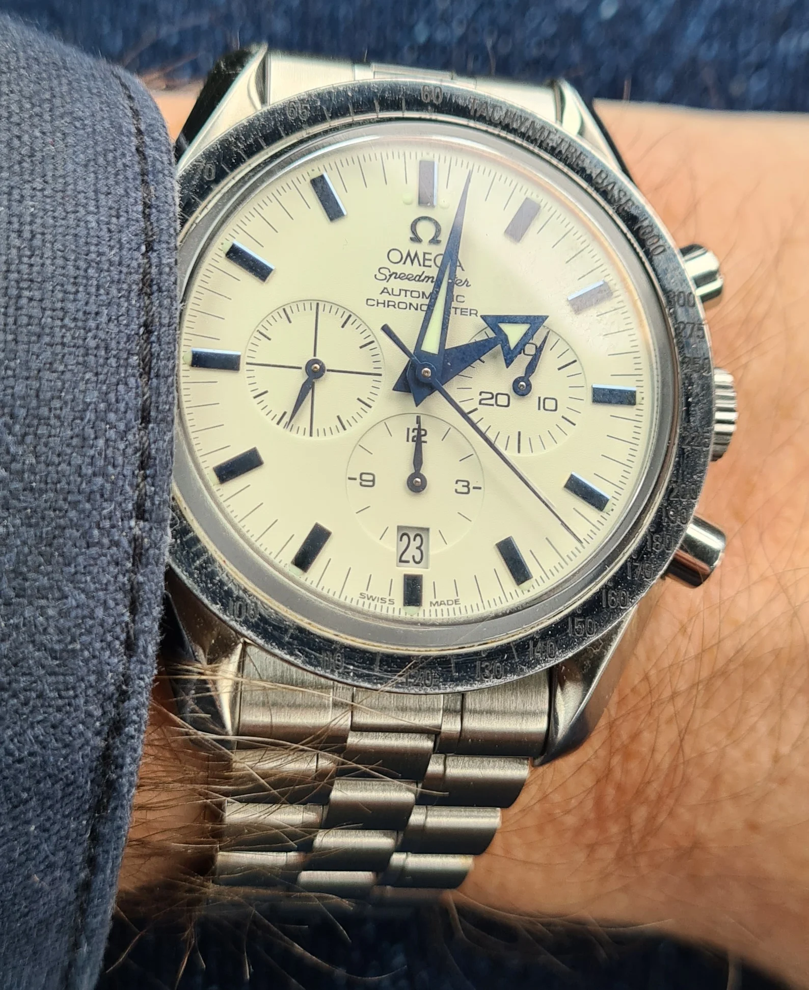

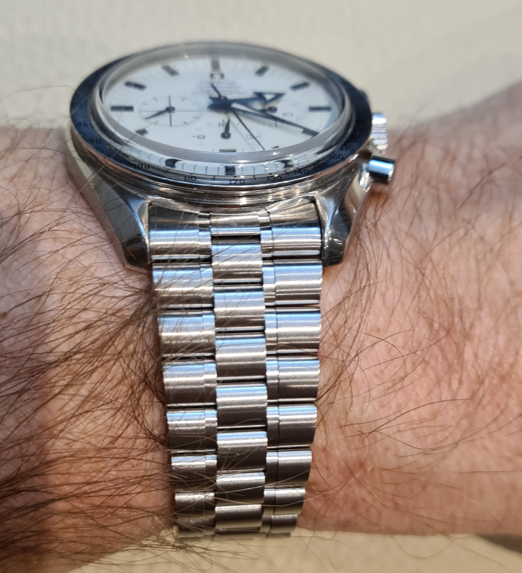

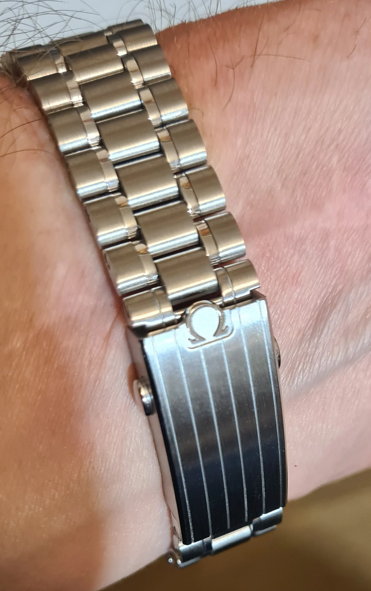

Hello, fellow lovers of beautiful straps. Here is my 3570.50 from 2001 with Hesalite glass and a new old strap. I found the original strap very unattractive when I bought it and replaced it with a leather strap.
Now I have been able to purchase a beautifully preserved original strap 1479 with end links 812. However, the end links had to be ground down a little at the mountings so that the spring bar would snap into place in the case. Now it fits very nicely. No gaps, no rattling.
The strap is very similar to the current brushed strap on the Speedmaster, but the middle link is slightly wider on this version.

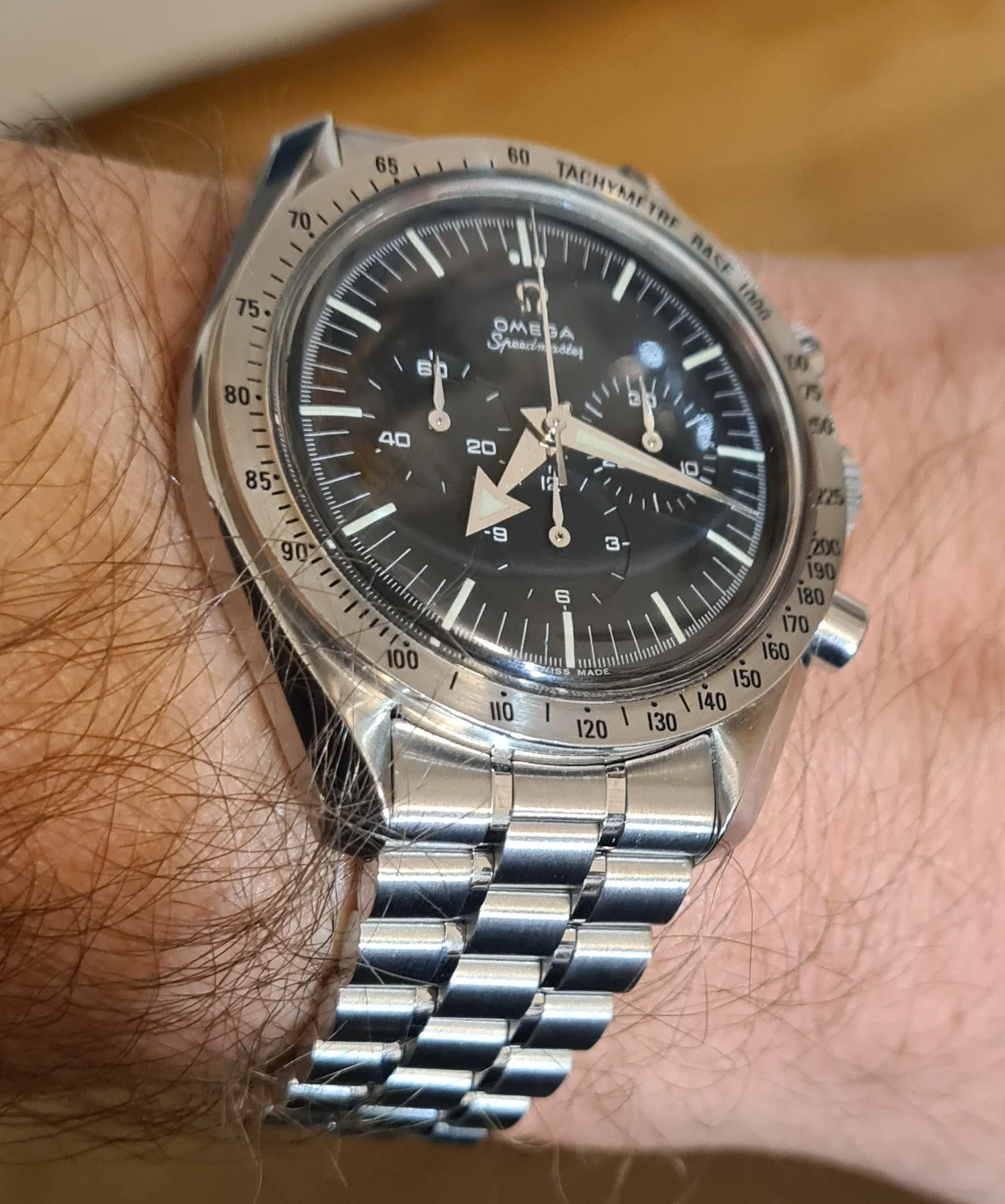

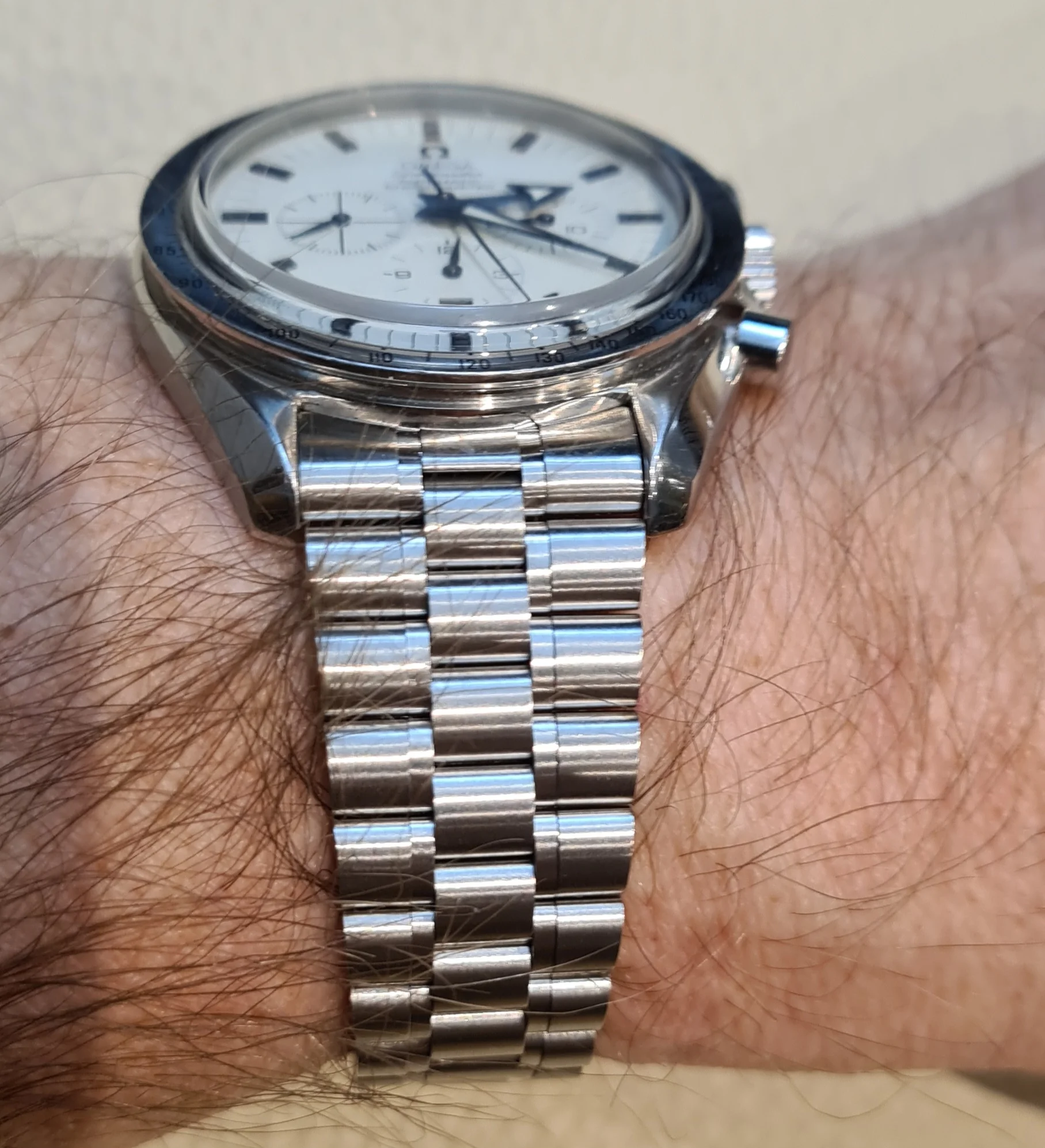

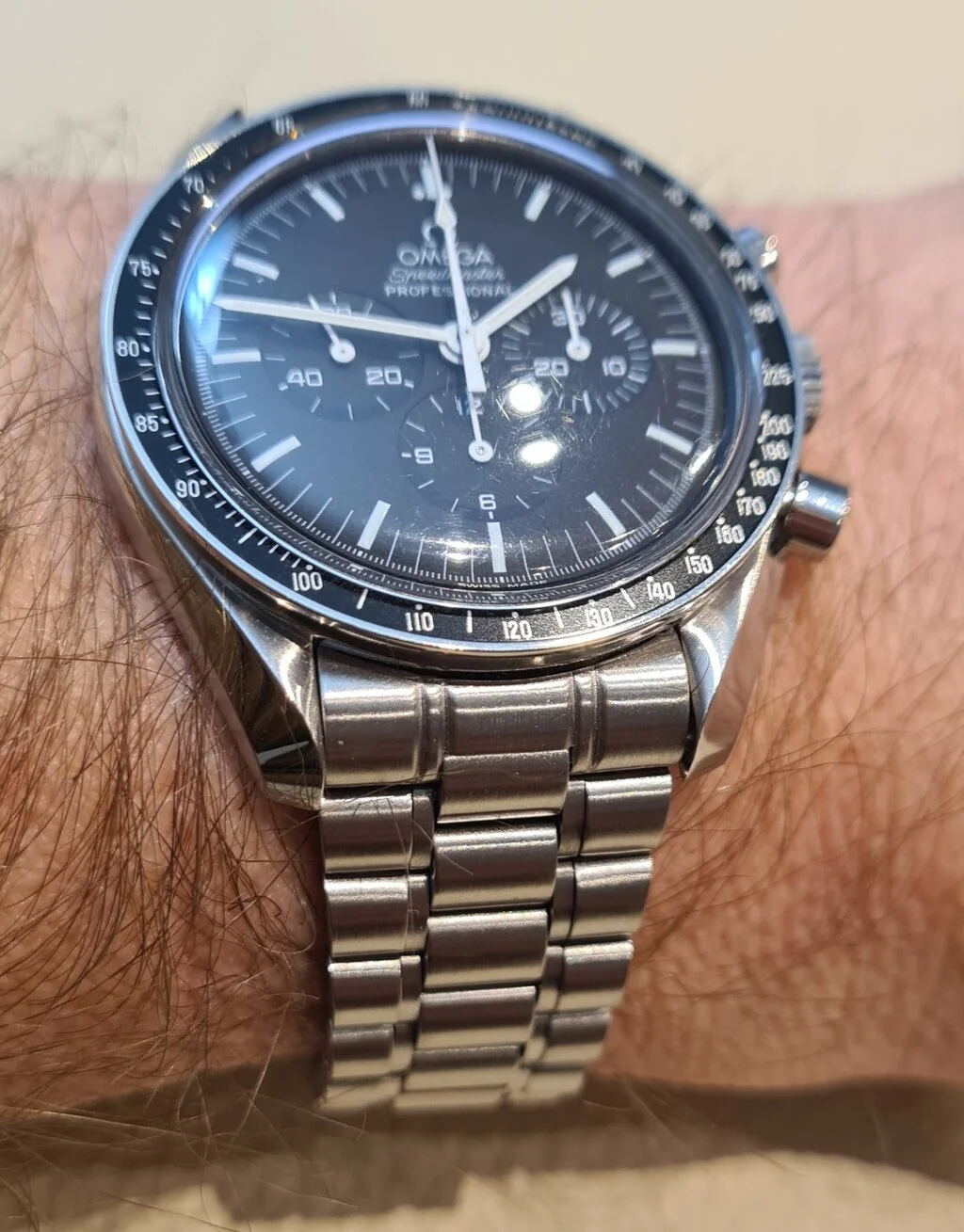

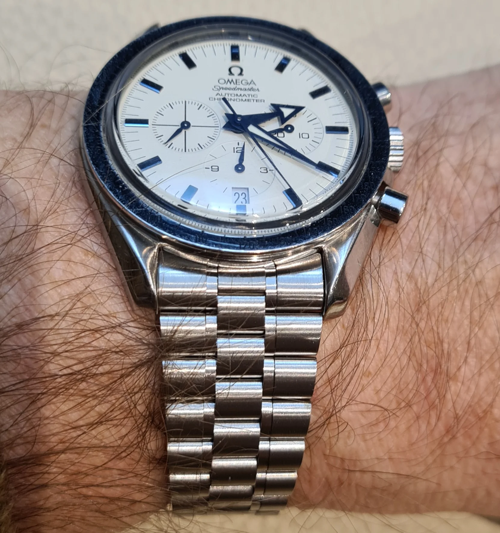

Hello everyone, here is a new episode of “Old Speedmaster, new strap.” Here, I have fitted a new strap from the current Speedmaster with sapphire crystal. The strap differs from the one posted above in that it has narrow polished links. Part number 020Z017493 / €820. It goes well with the polished hands of the Broad Arrow. The lugs fit perfectly, no rattling. Best regards.
