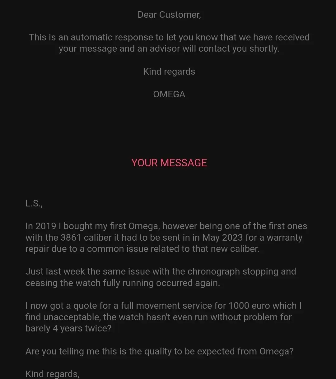

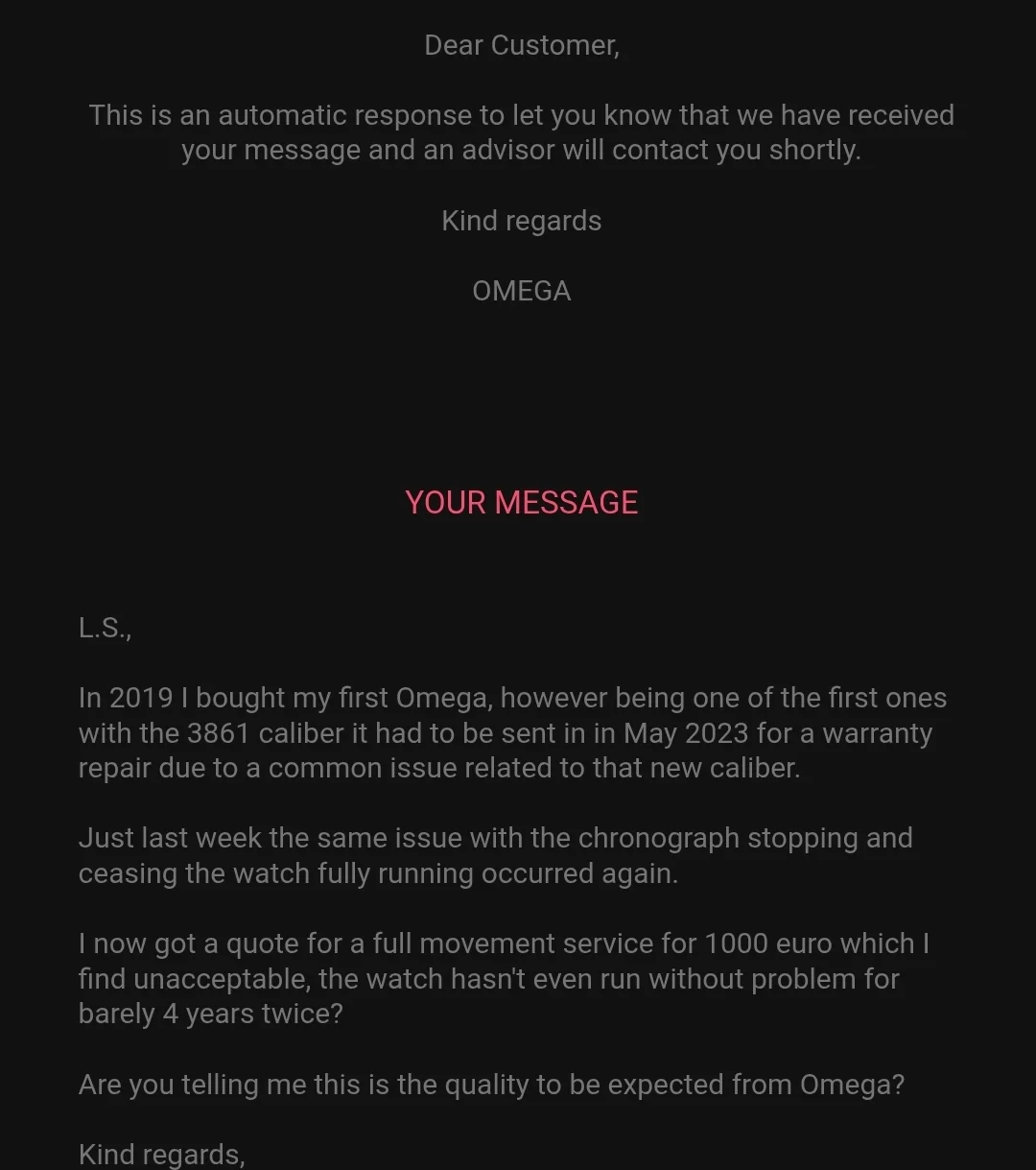

Reviving this thread again, today my 3861 chrono stopped working again within 40 min after the warranty service performed 3 years ago. I must have some bad luck.
So, got a message from my AD the watch is out of the service warranty period and requires a 1k service, I sent this mail to Omega, let's see how they will respond;

Hope so!
