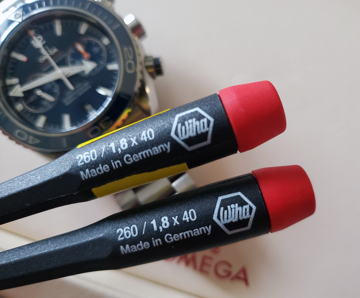

Try the Wiha 96018 on Amazon. 1.8mm works perfectly

I second the Wiha 96018. I just added a half link and the screwdriver worked perfectly. I took the first screw off and it remained nicely wedged by the blade. Wow, I thought I could rattle the pin out and just put the attached screw right back. Wrong, the pin was snug. Of course after taking the other side off one of the screws flew off and it took almost 20 minutes to find it. LOL
