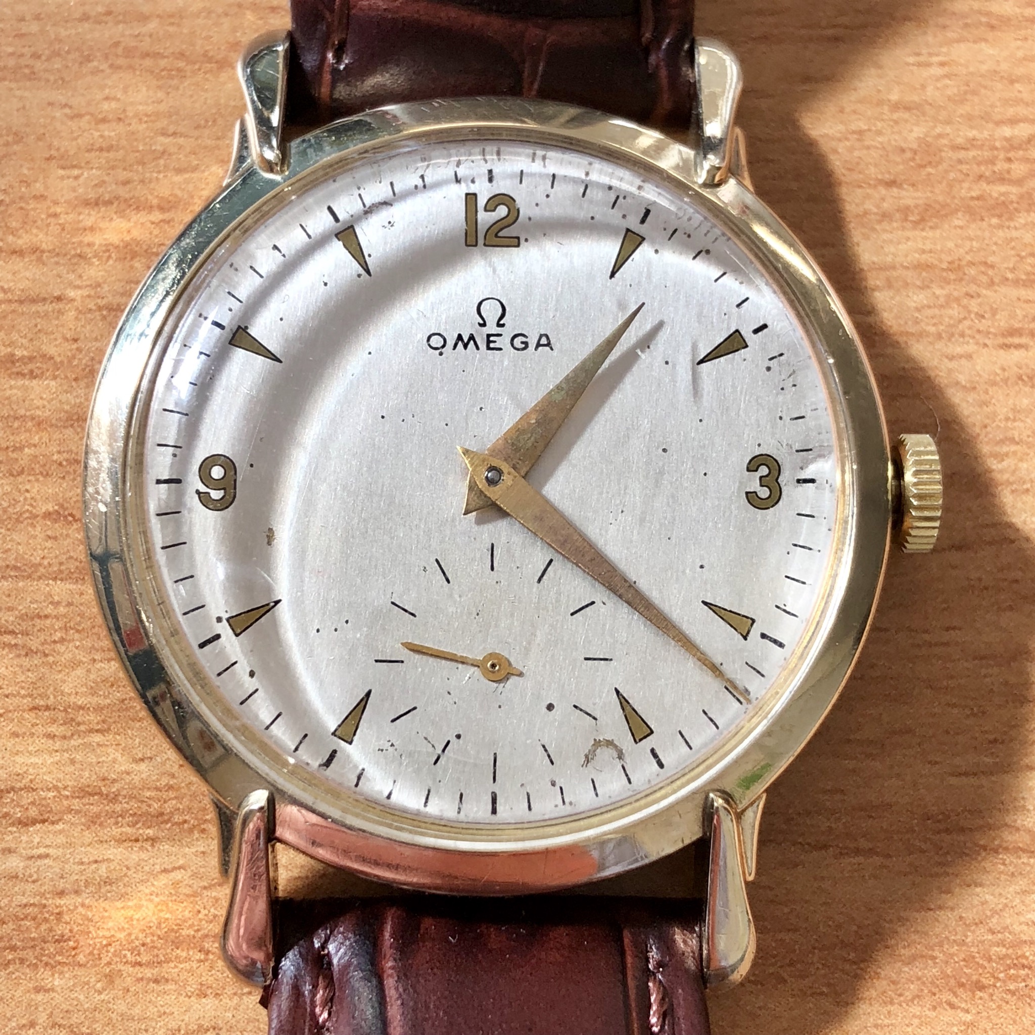

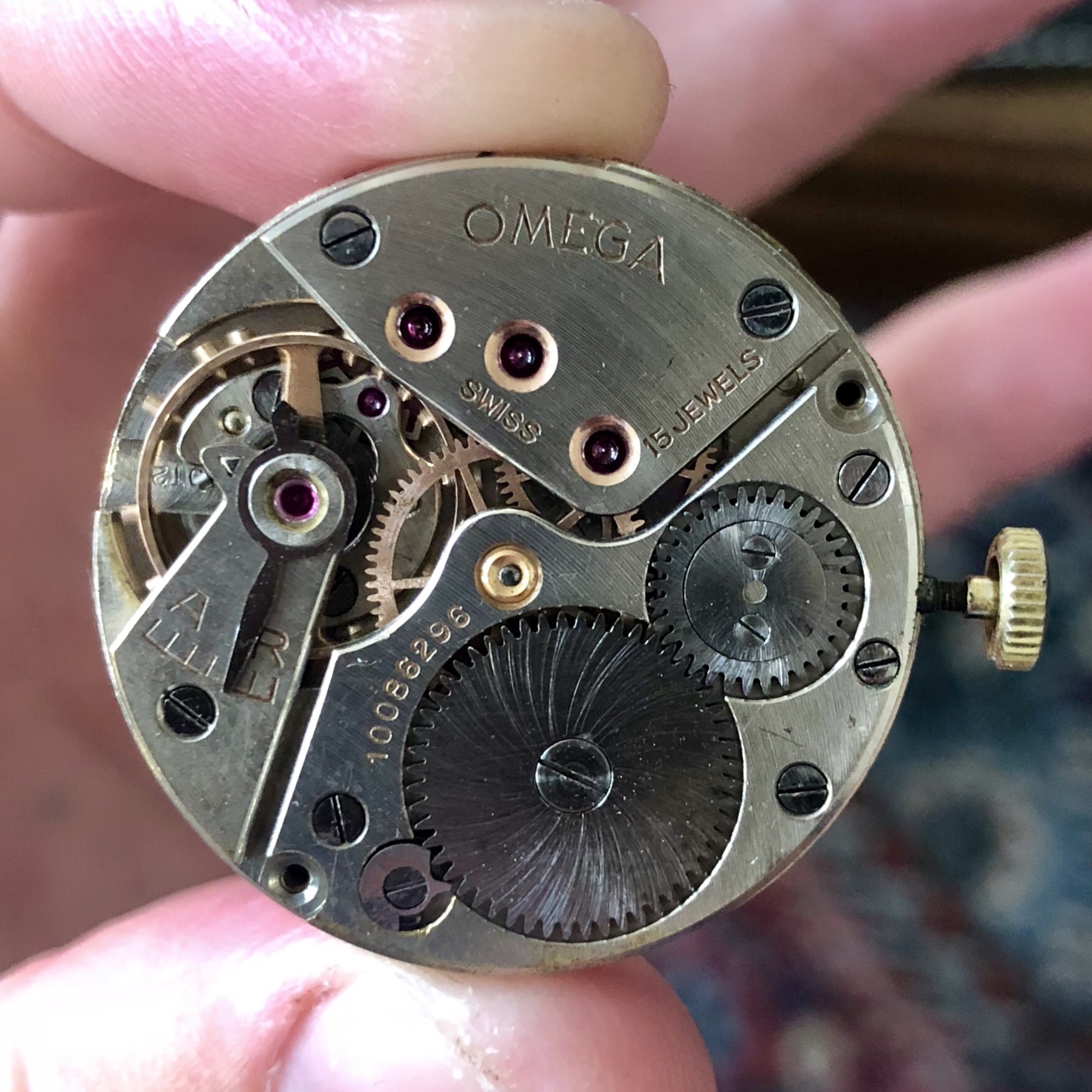

    Hi guys, I’m just querying more than anything and your knowledge would be much appreciated.
    I’m very inexperienced with watches, only what I’ve read on the internet and chatted with a mate about... clumsily I dropped my watch and, according to my watch-mender, have broken the balance staff. He explained to me that he would rather replace the whole balance as it is easier than the staff on its own. From what I gather, a balance would be quite expensive, given I’d probably have to fine a donor. My question(s) is... is replacing the staff particularly difficult for someone else to do? Are they easier to source? and would it be a much cheaper job than replacing the whole balance?
    I should probably just trust my watch-maker but thought I’d enquire anyway just out of interest. I have a picture of the watch before it broke so might not be too much use! Thank you anyway in advance.

    You do well asking. Any qualified watchmaker, and even some dedicated amateur ones, can replace a balance shaft.

    DO NOT use a watchmaker who makes a suggestion like that! If the hairspring is good, and the roller table is there, have the wheel re-staffed. Easier to replace the balance complete? If a “watchmaker” made a suggestion like that, it is because he doesn’t have the tools, the training, or the experience to do what is really not a difficult job. But DO NOT try it yourself!

    Exactly! That is a job that any watchmaker should do. It is not a difficult operation but requires a minimum of tools and skills that any watchmaker shoud have.
    Replacing a complete balance is recommended when the staff is not availlable for example (I replaced recently a complet balance for a Piaget 9P1 because unable to source a balance staff => but I kept the used balance because the other parts are in perfect condition and reusable).
    I believe that the watchmaker offered you the easiest way for him (I do not judge him or whatever).

    The watchmaker should source the staff - that's simply not your job to do. He/she will know the differences between staffs...things like Incabloc or not are critical to getting the correct staff for the watch, as not all of these watches are the same.
    Changing a staff is a pretty straightforward job for any competent watchmaker. If it came down to making a staff v buying a balance complete, then I would likely suggest the new balance is the way to go, because getting a staff made won't be cheap if the watchmaker is really charging for his time properly.
    BTW for most modern watches you really don't have a choice but to replace the balance in many cases - Omega does not sell balance staffs as separate parts any longer, so if you have a broken staff on a modern watch, a new balance is really the only economical way to go.
