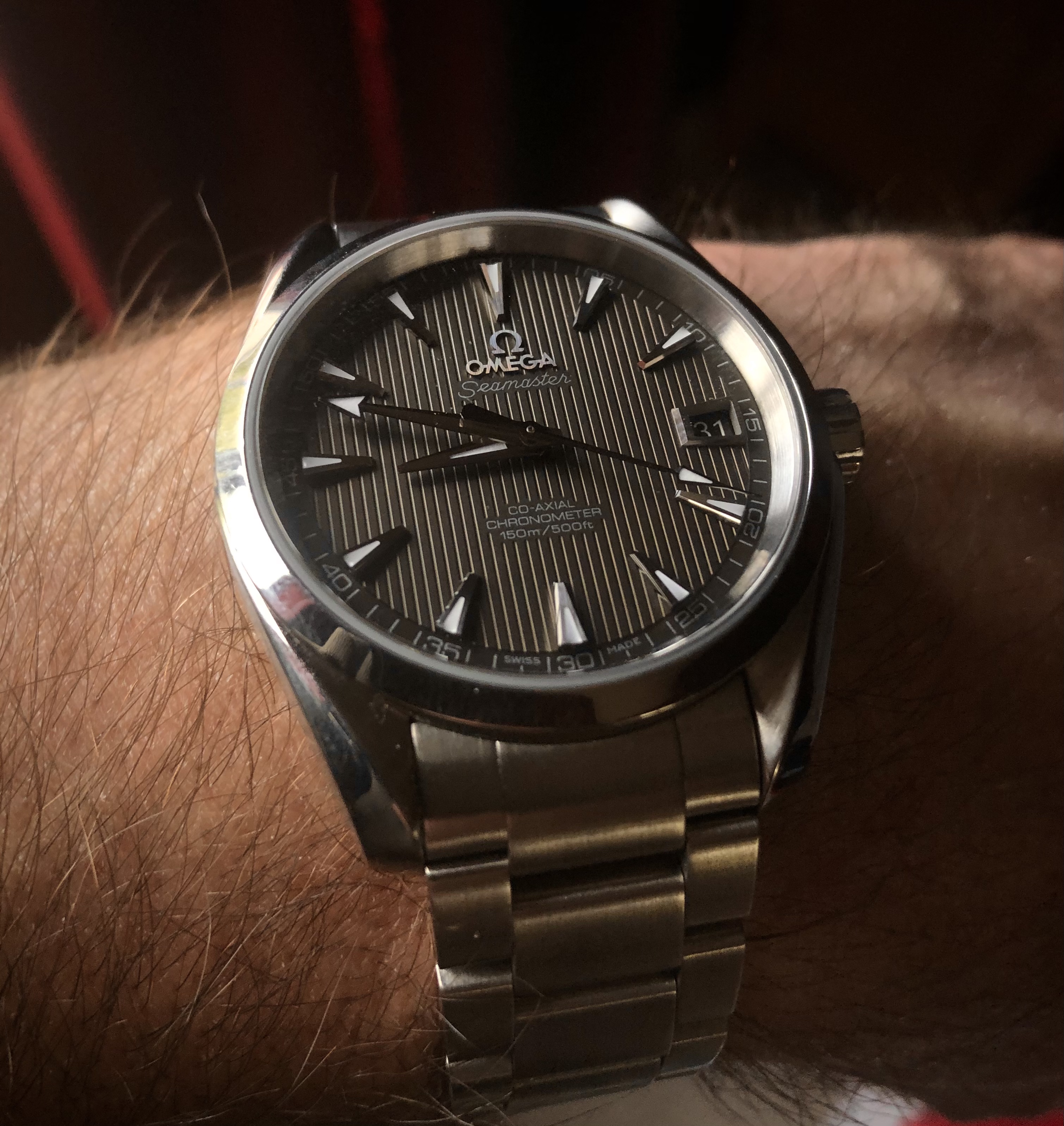

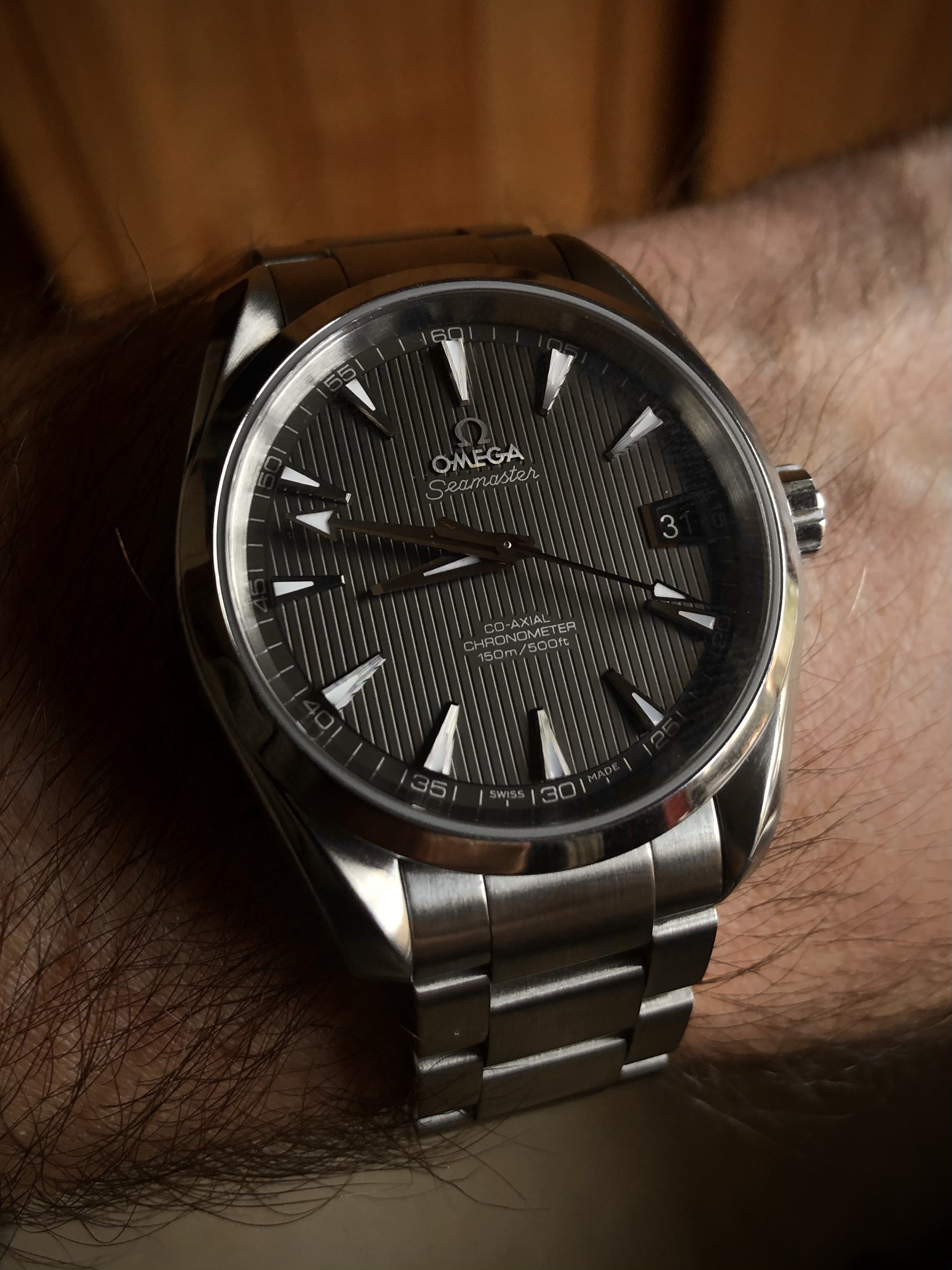

I have the 38.5mm, but the photos should give you an idea of the grey dial in more real-world lighting.
Wears very comfortably (at least on my wrist)
Haven’t run an accuracy test recently, but from memory it’s was gaining about 3-4 secs/day, maybe less

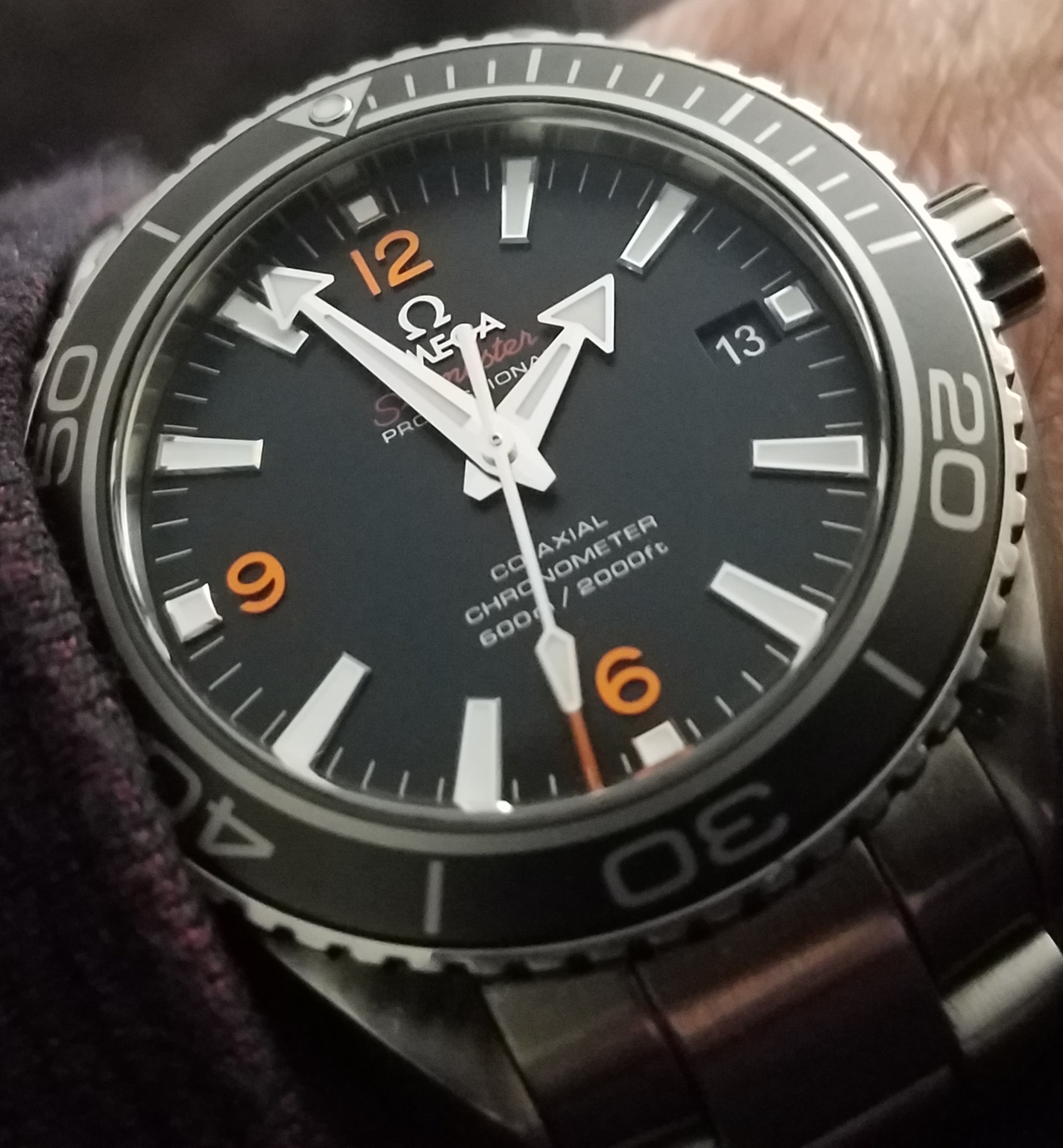

My 41.5 8500 blue AT is +1 no matter what. Rest it this way, rest it that way. Wear it. Winder. As long as it is wound. +1.
My 41.5 8500 PO is +2.5-3.5 no matter what. As long as it is wound.
