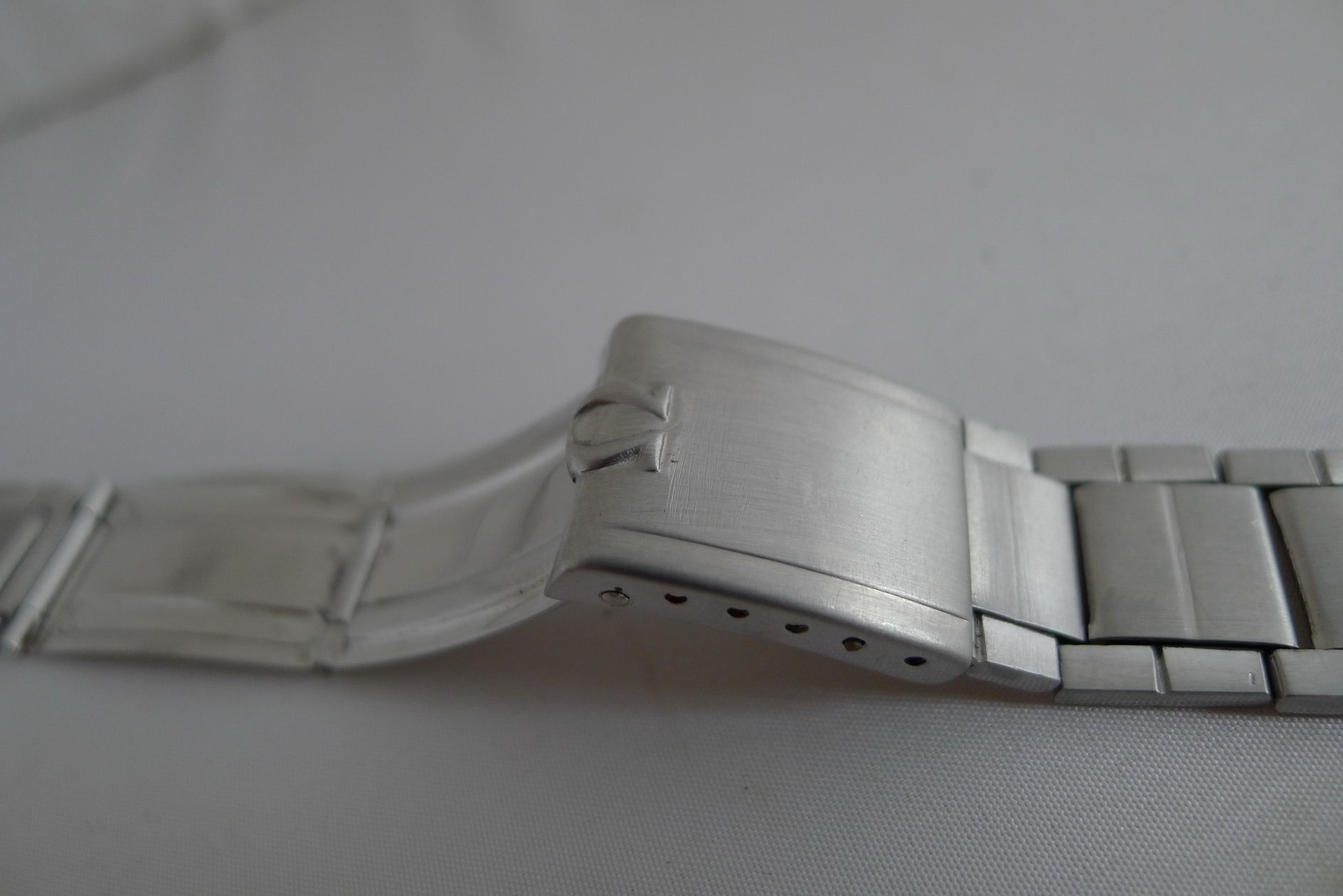

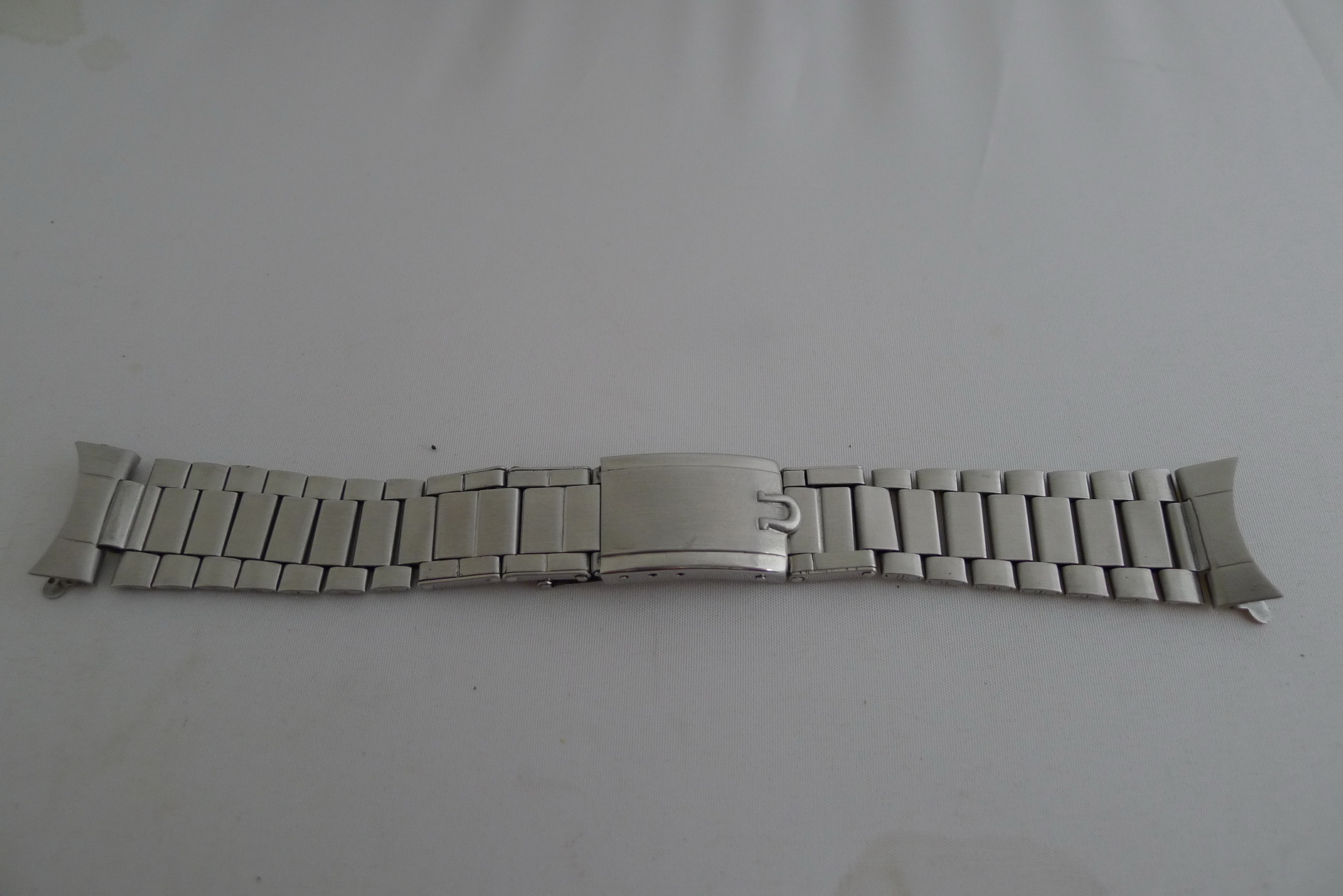

Who would be our go to guy for repairing this poor attempt at getting to the springs?
42332
42333
Not done by me, I might add.
(date stamped 2, 60 - so fits in with Gino's list above)
Good news is that tucked safely behind that clasp are another two double links 馃憤
42334
So three one end and two the other. My limited knowledge leads me to believe that's a full set.
The other two definitely need some springs

It will probably flatten OK but will still show a slight crease no doubt.
Open that part of the link too far and they tend to break which I found out once. Just be careful. Why don't you try the repair yourself, it is quite satisfying and rewarding knowing you can open and shut the springs without fear of breaking them, I still wince when I test the springs on a 7912.

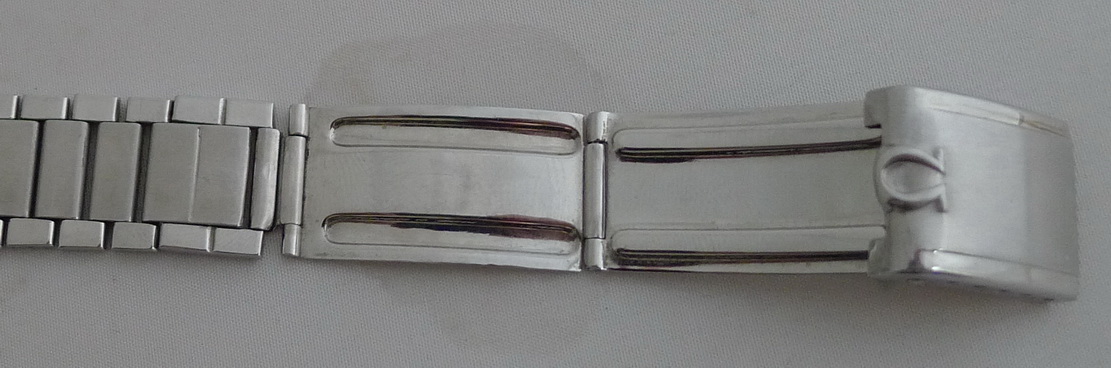

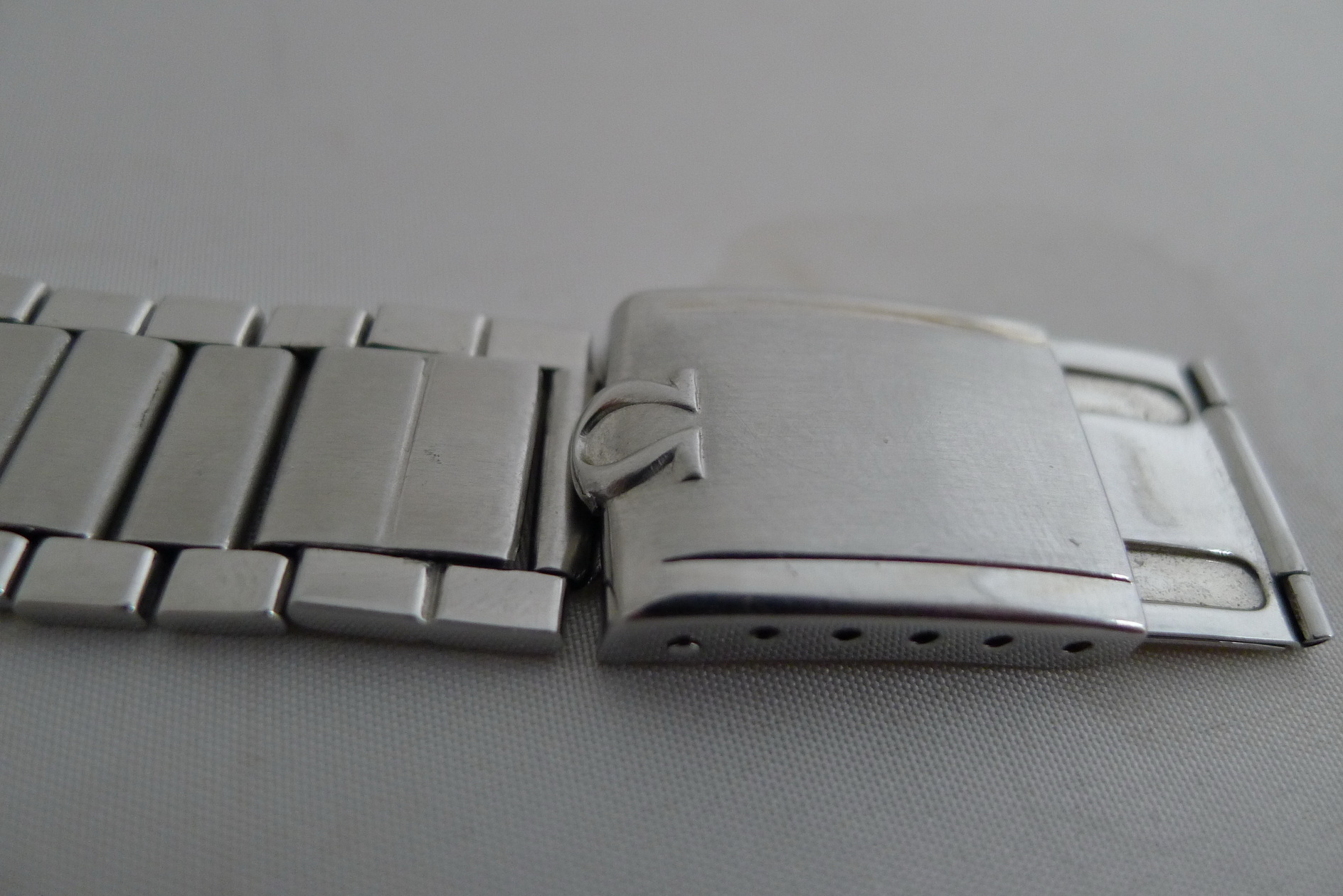

Where does this type of clasp fit into your three marks? I believe this is also classed as a 7077?
42330
Ian
I have had a couple of this type before and from my research I think they might be ladies bracelets from the early 60's, possibly mens, but almost certainly they came after the previous 7077's, one of mine was dated '62. The over all dimensions are slightly smaller than the 7077's we know.
Of course I am happy to be corrected if anyone has proof to the contrary.

Gino,
42330
Ian
My thought on this is that we cannot talk of 7077 but rather of a similar clasp for another contemporary line of Omega watches (with the 7077 has in common only the upper part with the Omega logo) .
Tipically we found it with end links n掳 4 (18 mm.)
Ciao, Gino
3,532
7,563
Ciao, Gino
With the #4 end links it was most probably meant for a Seamaster or similar I guess 馃

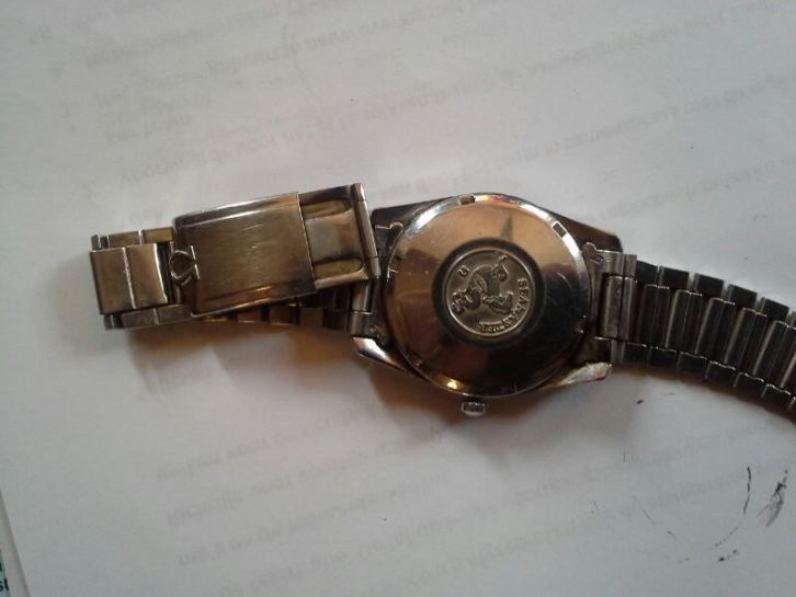

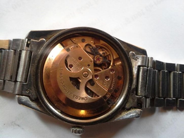

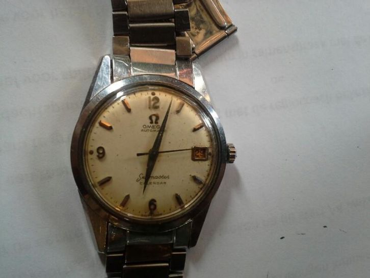

Funnily enough I just picked up this old rust bucket this very afternoon.
Sellers pics:

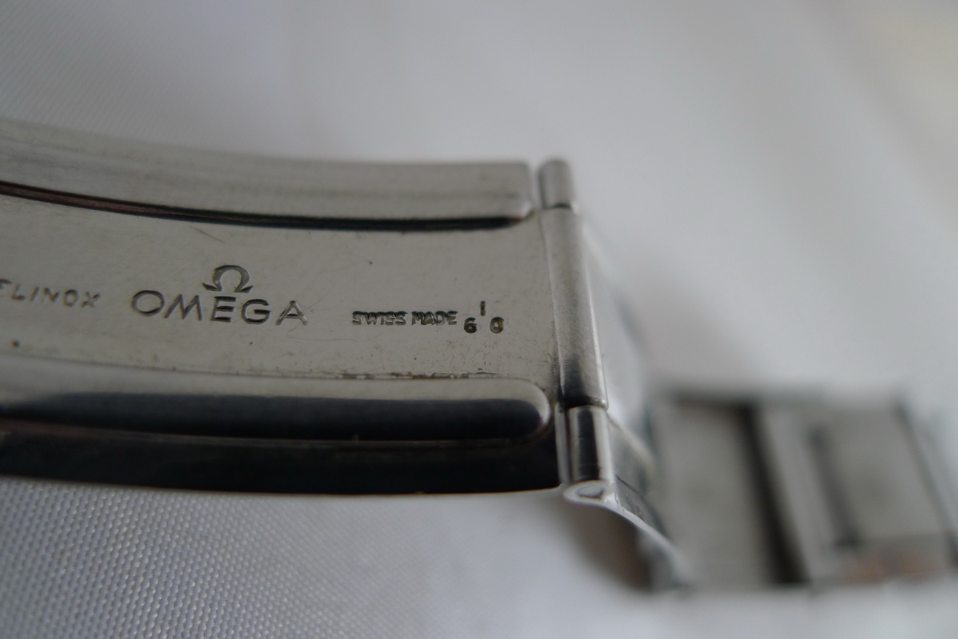

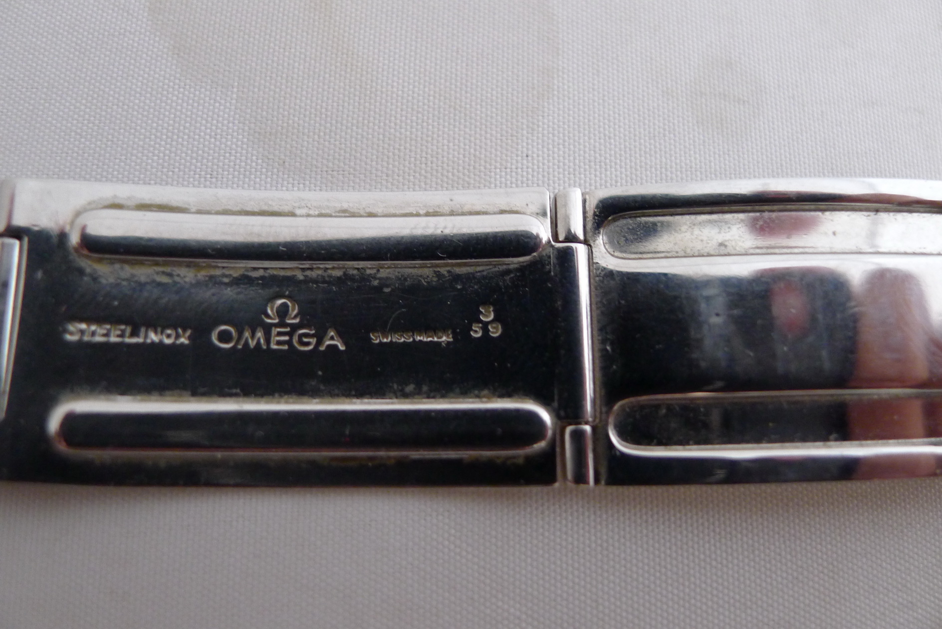

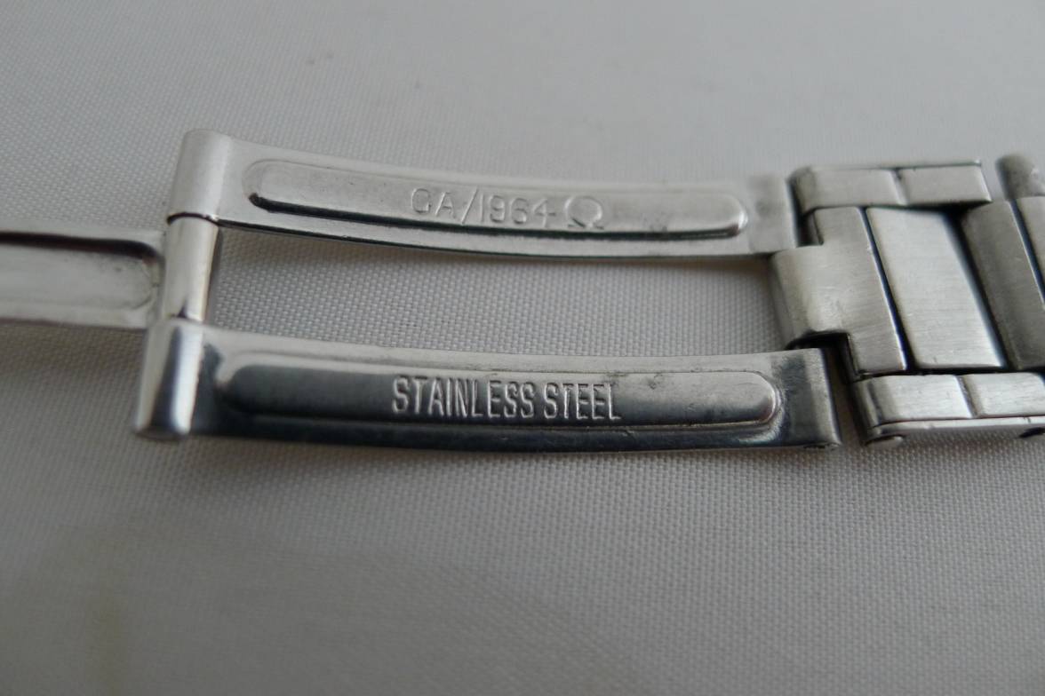

Hello , I have been checking my bracelet box , in fact I have 3 7077麓s
One dated 3/59
another one dated 1/60
and the third one with the incription "CA1964".....
Here are some pics (I have to clean them....馃榾 :
