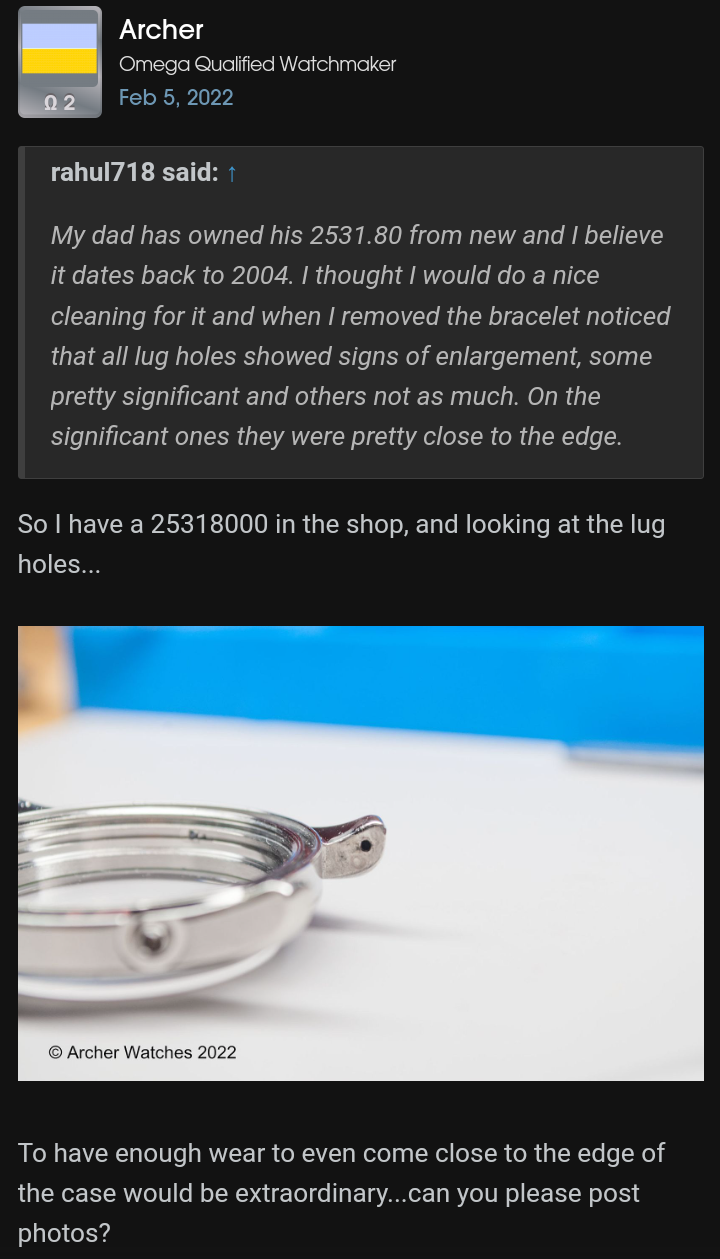

My dad has owned his 2531.80 from new and I believe it dates back to 2004. I thought I would do a nice cleaning for it and when I removed the bracelet noticed that all lug holes showed signs of enlargement, some pretty significant and others not as much. On the significant ones they were pretty close to the edge.
So I have a 25318000 in the shop, and looking at the lug holes...
To have enough wear to even come close to the edge of the case would be extraordinary...can you please post photos?
