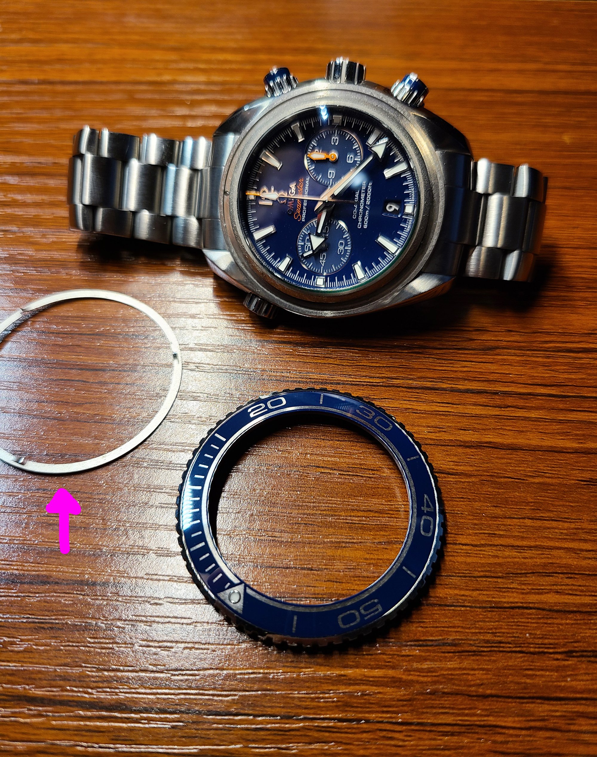

Hi all,
Bought a watch from ebay and it's passed the authenticity check.
They noted the bezel rotates both ways and I understand some watches do, but I'm not sure if this one should.
It's a 2012 232.30.46.51.01.001
Obviously I don't want to inherit a big problem

Should be unidirectional, but the real question is when it was last serviced as that would solve the problem anyway by Omega.
2,477
3,867
Should only rotate counter-clockwise. Assuming it's genuine, the tabs on the bezel clickspring are either all bent or broken off and needs replacement:
Easy to fix?
5
If you can get a certified Omega watchmaker to source the part, it's a 5 minute job.

Good luck! Make sure it's someone who's done it before and has a tool to remove the bezel. Avoid those quick fix kiosks where they might just pry off your bezel with a blunt knife-lookin' tool which will likely end up damaging your watch case and could warp the whole bezel.
