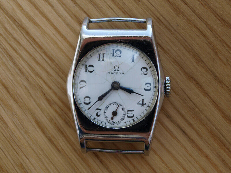

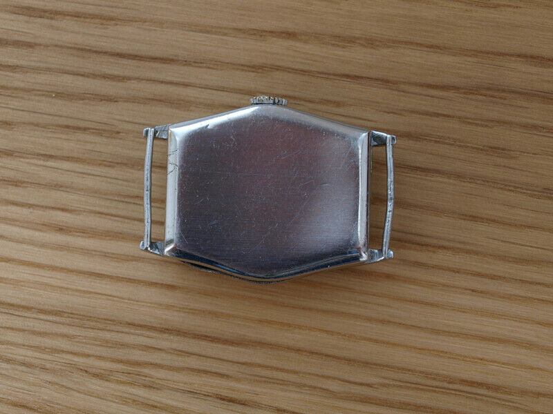

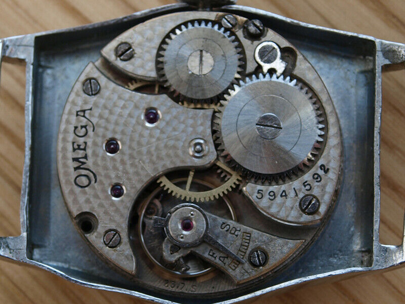

Yes, the 23.7 S movement from 1918-23! Thanks for your input. The movement is numbered 5941592. I am not sure if it is in it's original case - the case back interior is stamped:
"PURE NICKEL
CHROMIUM
PLATED
SWISS MADE"
If anyone has any ideas on whether the case is original, I would love to know. I would also love to know if it is possible to narrow down the movement to a specific year instead of the ranges I have found online (in this case, 1918-23).
