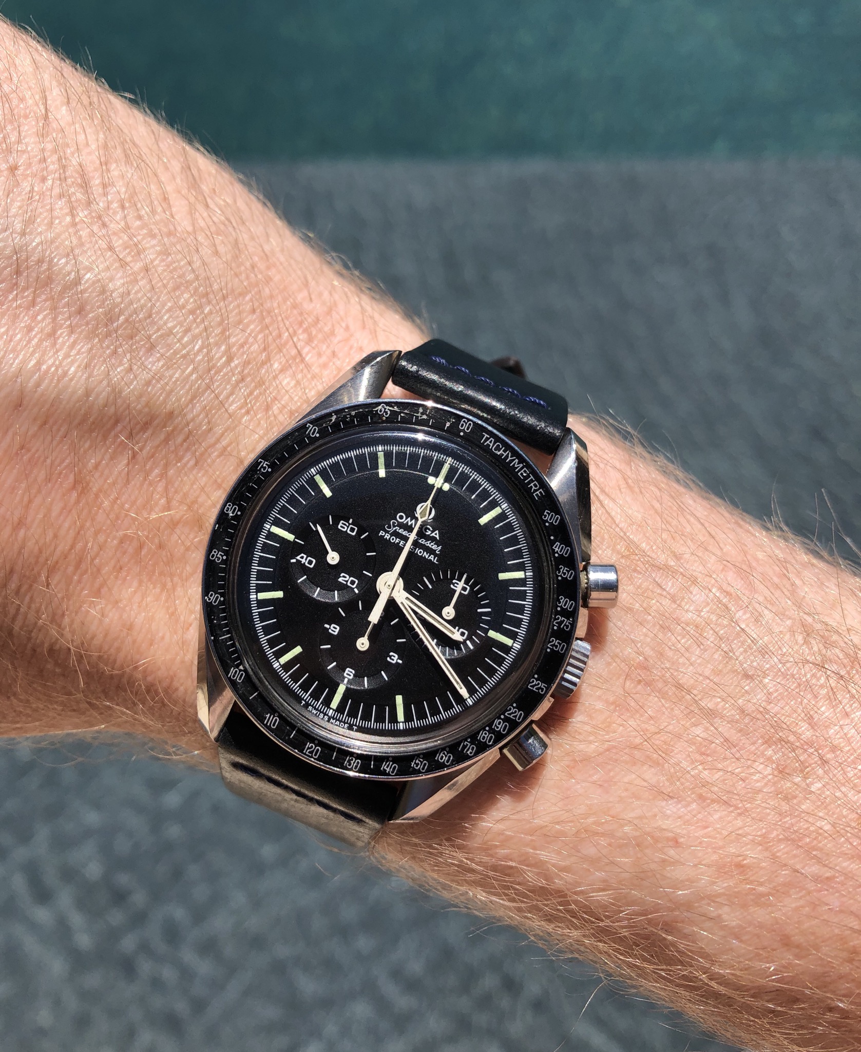

Still, I'd rather speculate on this watch returned to the shop somewhen later the year for whatever reason 馃榾
Well, it's a family piece ... @cstoitsis - can you cast light on the question?

I have confused with Premoon and the moon landing date in my head. It's correct what you wrote, this serial is from the first quarter 1970, I have a -69 with a very close serial that is from March 1970 馃槈
The watch has been regularly serviced since new.
My father does not recall a bezel change.
The watch was built first quarter of 1970.
My father purchased it new Dec 1972

Totally agree. The 220 bezels were used only for a few month between serial 3059 (end of 1970) and 31004xx (beginning of 1971). It is (at least for me) the rarest of the three main bezel types (DON, DNN, 220). Many of them were changed from Omega because of the 220 error. I would value it minimal like a DON variation of not higher.
Just to be sure. Does this mean that watches sold within this period could have been sold with either a 220 or DNN? Not all were sold with 220?
It appears the 220鈥檚 where made as a batch, but serials are not necessarily in order.
@Cal_321 at this time 220鈥檚 are only worth slightly more then DNN鈥檚 far below DON鈥檚.
The production was, DON, 220, DNN. Basically the 220 was the first batch of DNN s.
So this means that 220 are spread out within this serial range amongst some DNN? With the 220 being the first but not in serial order.
Please see a very detailed discussion on pages 123-124 of Moonwatch Only.

This is why I opted to snag a 220 for my 30593xxx Sept 70 Speedy. It was available and I got it for a reasonable price so I thought why not?? At the very least it makes my watch a bit more interesting from a collectible standpoint and being a Rolex collector I鈥檓 hoping that the Omega crowd starts catching on to it as a cool variant.
I think research via extracts show they are clumped together by date. Serial numbers are not fully sequential.
very close to mine which has a 30.592.xxx serial.
You're right, unfortunately. Not discovered and underestimated yet.
