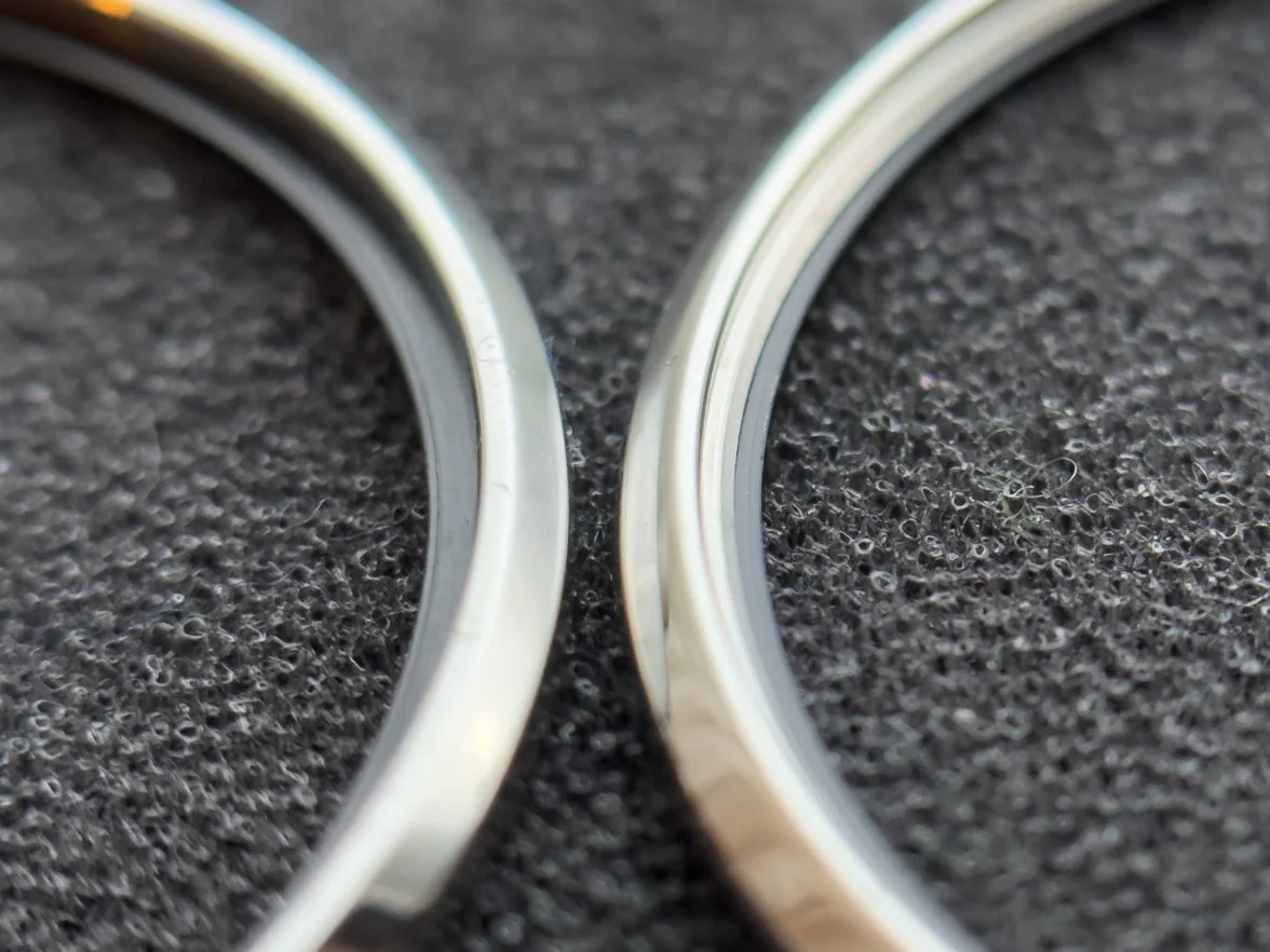

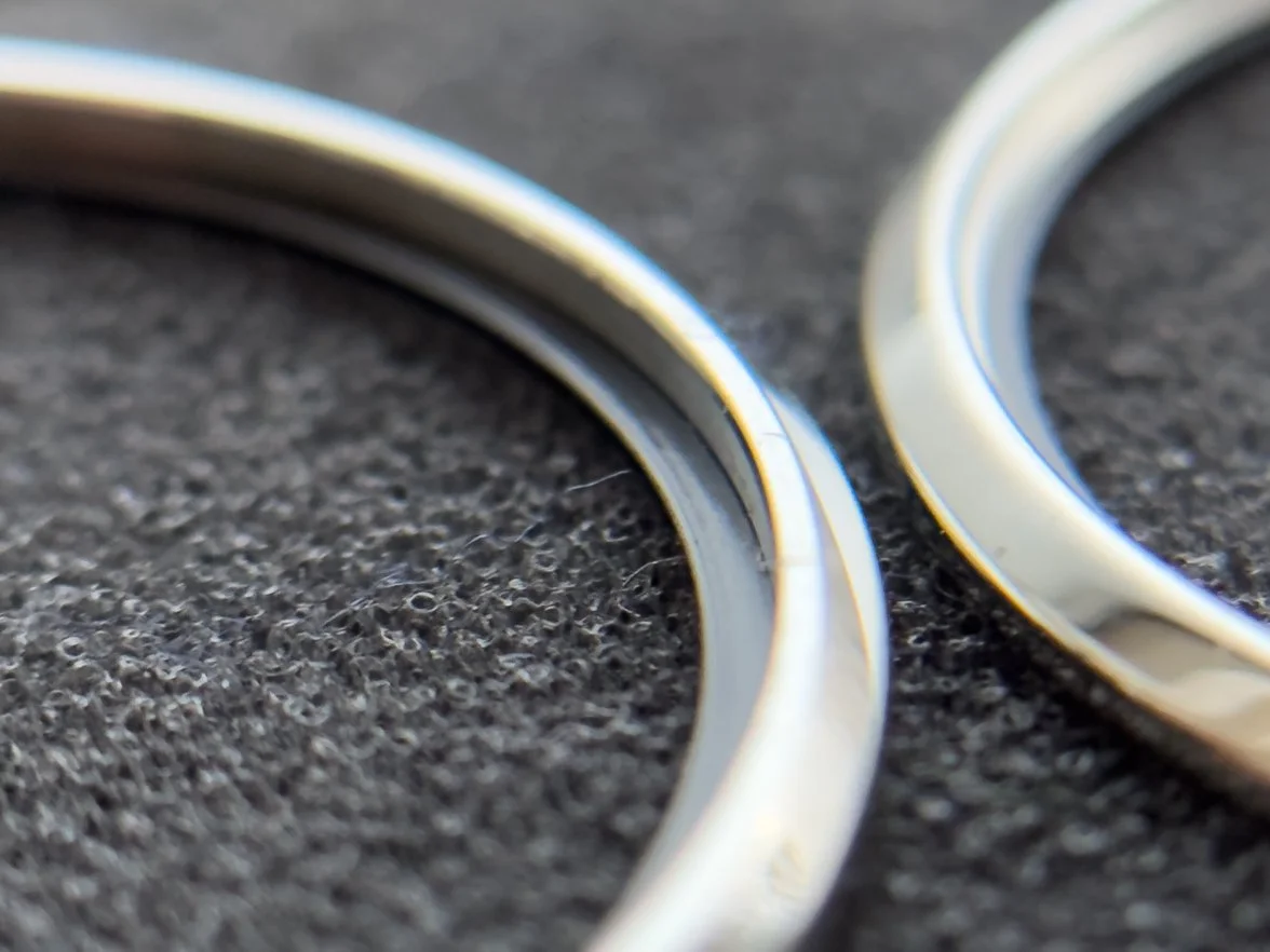

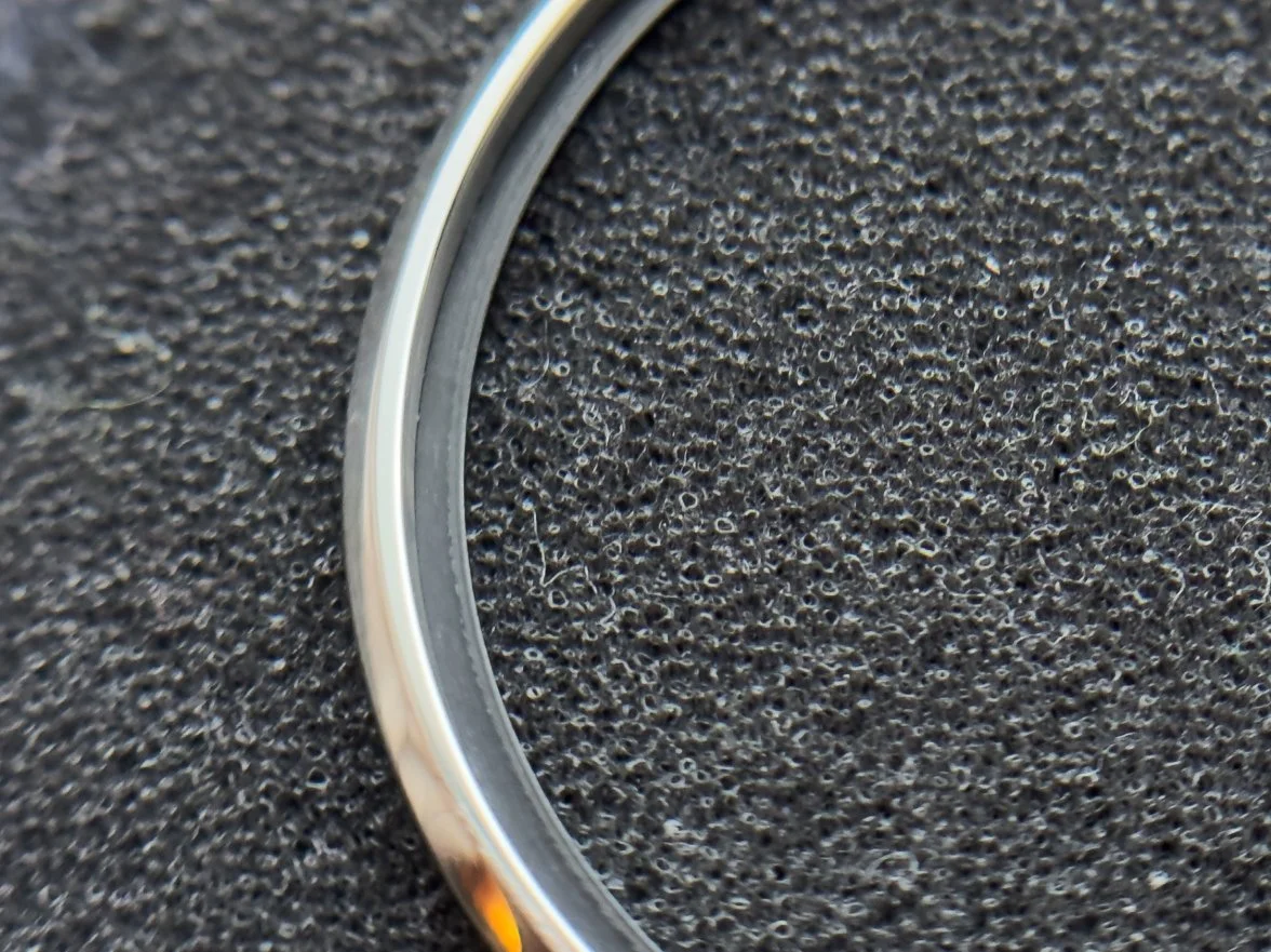

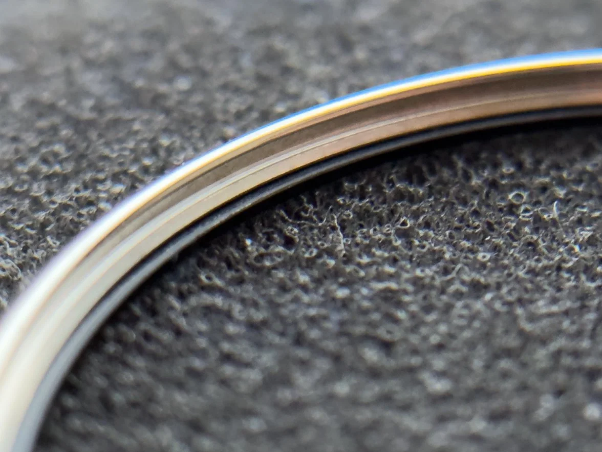

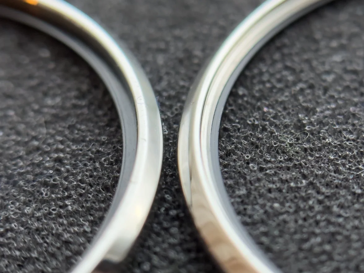

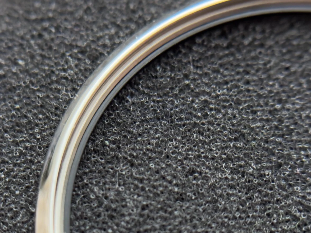

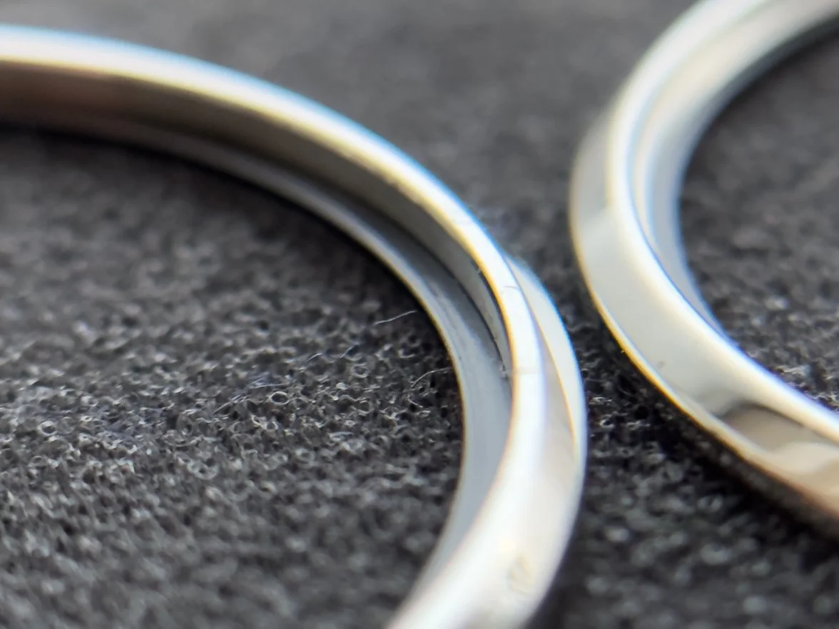

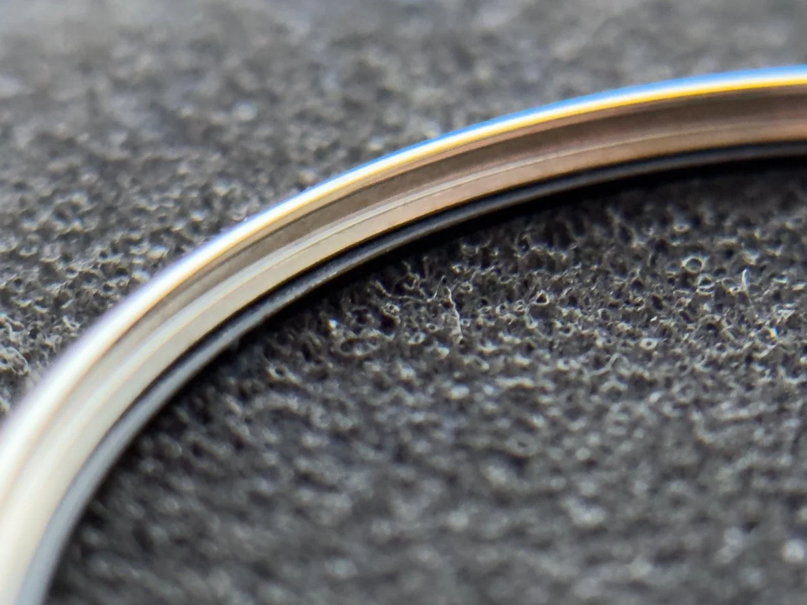

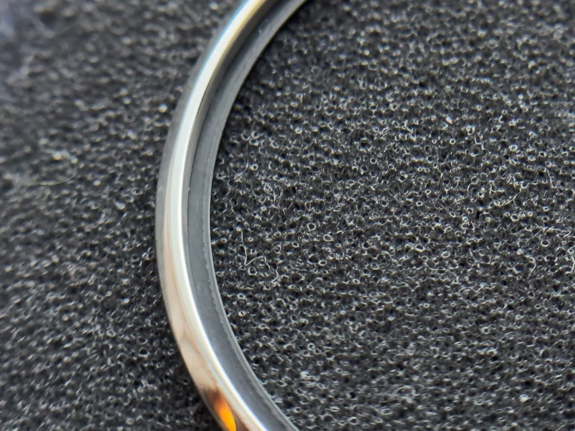

The bezel from a 1861 case will not fit the 3861 case. The bezels are nothing alike and the 3861 bezel requires a spacer to attach to the case, whereas the 1861 bezel does not. Below are pictures of the underside of each bezel to show their differences.
1861
3861
Both side by side
