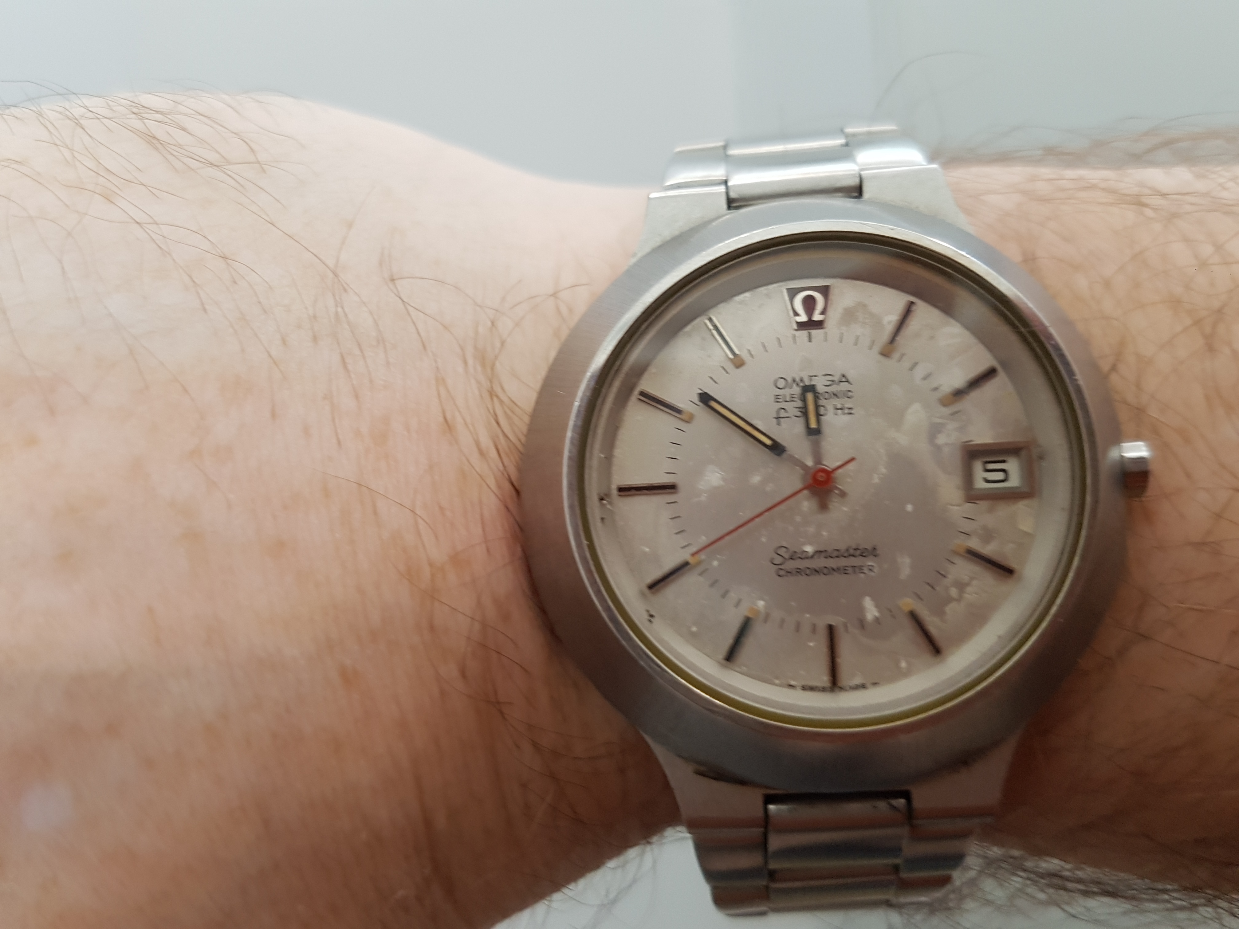

    Hi, I bought a 1972 Omega Seamaster Chronometer Electronic F300 198 0018. When opened it up it had a LR43 battery installed. The watch isnt running. I replaced the battery with a brand new LR43, same result. Is this the correct battery for this watch?
    Thanks

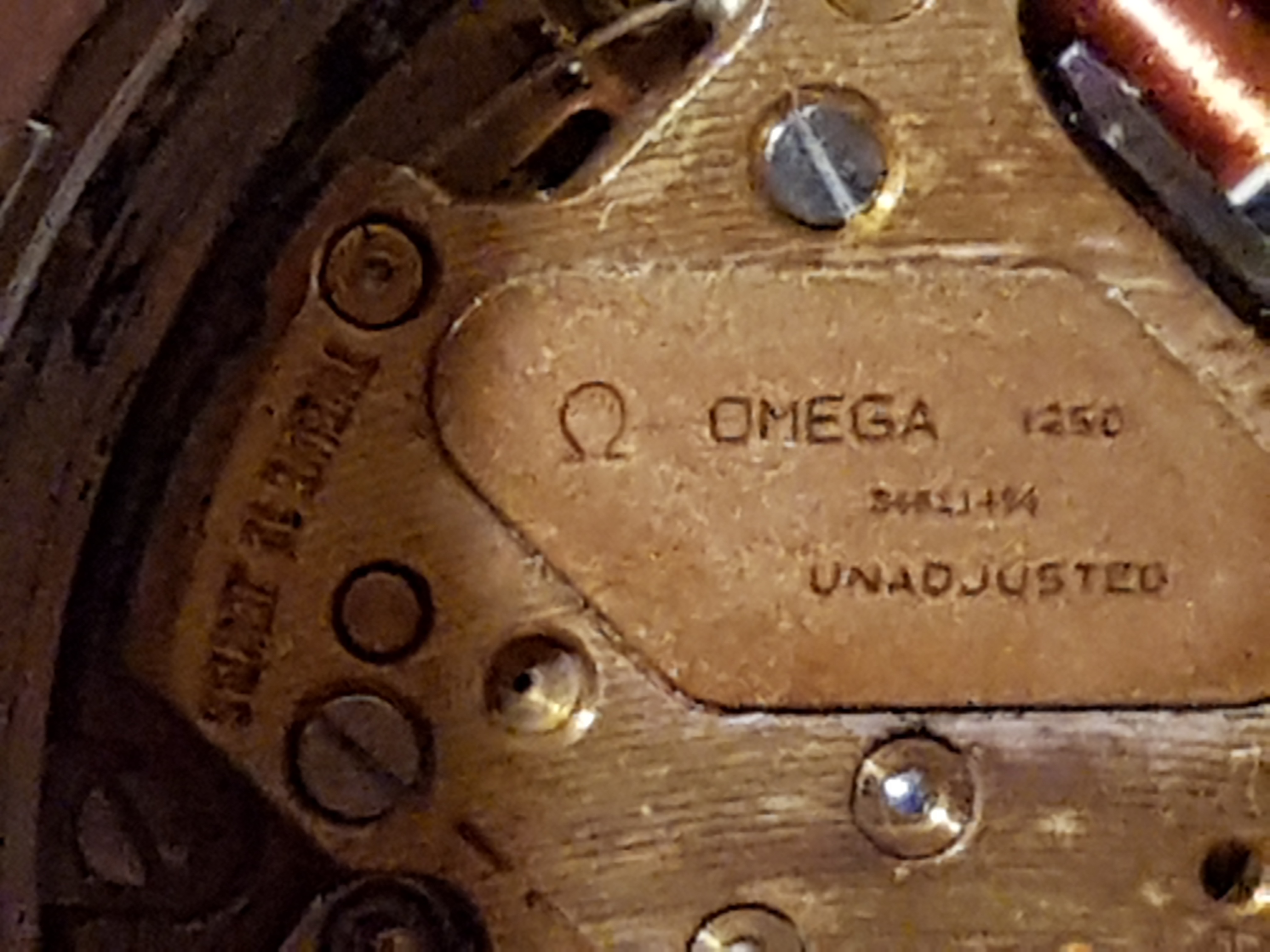

    Excellent, thank you! I opened the watch up and it looks really clean inside, so I hope the correct battery starts it up.
    The case is in very good condition. Think it just went flat many years ago and was put back in its box. It still has its red dot near the case back.
